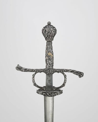

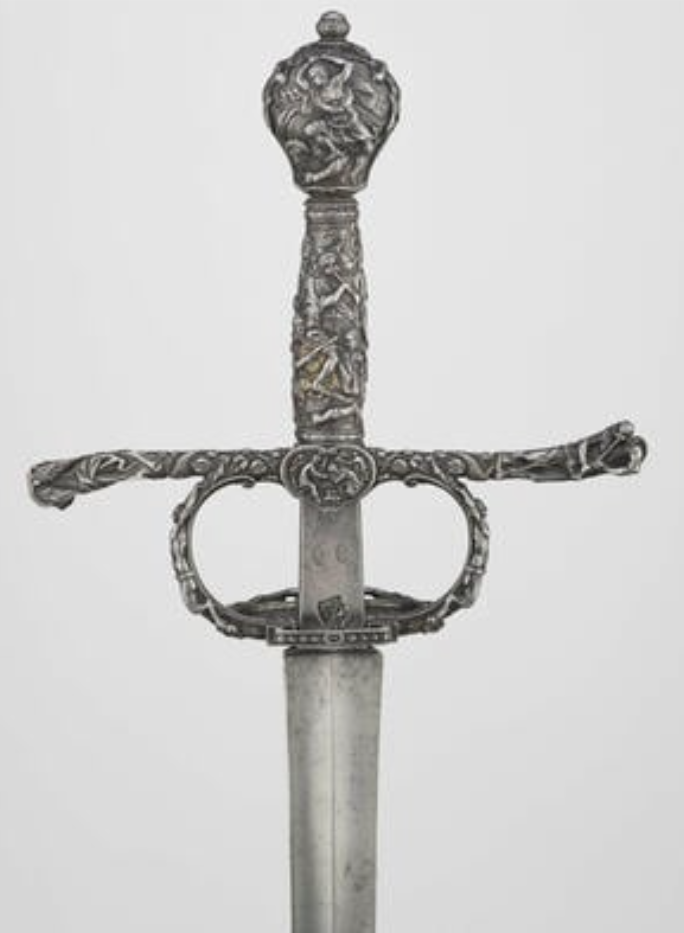

Hello all,
I am wondering if anyone knows anything about the a sword in the Royal Collection (Queen's Guard Chamber, Windsor Castle), listed as RCIN 62994. (see listing here: https://www.rct.uk/collection/62994/rapier)
Per the above linked site, this sword is claimed to have "belonged to John Hampden (1594-1643), one of the leaders of the parliamentary opposition to Charles I".
The hilt is attributed to being designed by sculptor Benvenuto Cellini.

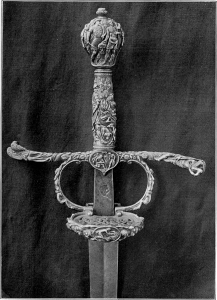

This sword is also depicted in Fig 37 of Gardner's "Armour in England From the Earliest Times to the Reign of James the First"
I am curious if anyone knows anything about this sword, the sculptor, and the accuracy of attributing this to a date in the first half of the 1600s. A few months ago, I posted a sword in my collection with a hilt that has some similarities in decorative technique (although not the same motif) and it was generally thought that such chiseling of steel would not have been seen on something from the 16th or 17th centuries.
I know museums and armories can get dates wrong, so I figured I'd come to the actual experts here
As always, thank you for your expertise,
-Rob

The swords description says "This sword, with its superbly sculptural hilt, was once thought to be the work of the Florentine goldsmith and sculptor Benvenuto Cellini. As with the 'Cellini Shield', the tradition was refuted when historic arms and armour came under more serious scrutiny in the last quarter of the nineteenth century. " They also say that John Hampton's ownership is "tradition". This seems to cast some doubt on its providence before the late 18th century.
Cellini was an amazingly talented renaissance man. Artist, warrior, engineer. Caught up in the politics of his time. His Autobiography is a fascinating work, although I am sure he put himself in a very flattering light. He produced a salt cellar that I thought was amazing as well as his escape from prison. To me I can see why it was said to be his work stylistically.
It is a pity that one can't quite make out the makers mark or that there isn't a picture of the whole sword.

According to Norman ("The Rapier and Smallsword 1400-1820; 1980, p.327) "...in the last century (19th) a large number of more elaborately decorated weapons and pieces of armor were attributed to the famous sculptor-goldsmith Benvenuto Cellini (1500-71). All are now ascribed to different schools and craftsmen".

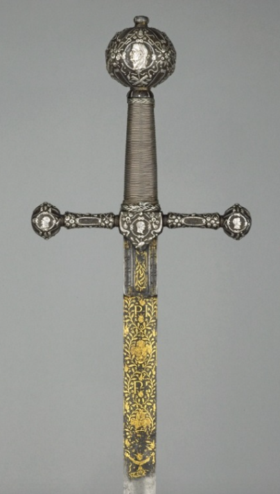

In "Wallace Collection" (plate 113. p.264, A511) there is a silver encrusted sword made for Prince Henry, Prince of Wales about 1610-12. The elaborate relief carvings are magnificent work, and the sword is open hilt rather than with typical guard systems of rapiers etc.
What is notable is that the blade has the unicorn marking of Clemens Horn, Solingen, (1586-1631) being that Horn was maker of some of the most prestigious blades of late 16th into early 17th c. for royal personages of those times,some of them being,
"...Prince Charles and King James I,and JOHN HAMPDEN,"
(#65 at Windsor).
It is noted in the Windsor description that the hilt of Hampdens sword is by an anonymous artist...but likely of course they suggest that the work is of the Cellini school.
It would seem that the artisan of this sword for Prince Henry Prince of Wales c. 1610 was following this convention.
Given that these swords were of the same period, of similar high stature with blades by Clemens Horn, perhaps the 'tradition' developed with the chain of provenance ultimately ending up with another Prince of Wales, George IV who finally received this sword in 1807.
The sword certainly was in good company.

Good Lord, the mark is a unicorn! I don't know why I couldn't make that out. I ended up screenshotting it and rotating to all orientations. I am always humbled by Mr. McDougall’s research and have learned from him yet again by reverse engineering the process somewhat. Thanks Jim!
The Wallace Collection Vol II mentions that the globular pommel was popular in England but not proof of English manufacture. Later the discussion of example A597 says the style was popular "....1580-1680 when the fashion seems to have been brought to the country by foreign craftsman (cf. No. A511)." A511 being the prince of Wales’ sword. The first attached photo is of this sword’s forte and hilt. It shows the ostrich feathers and the PH monogram. I personally believe this hilt, a gift from Charles Emanuel of Savoy, to be in baroque style, while Hampton’s hilt with the elongated figures seems to be in the style of mannerism. The difference in styles, themes, and improbability of being sourced from the same geographic region would on the surface make the hilts seem unrelated other than of course the Clemens Horn blade.

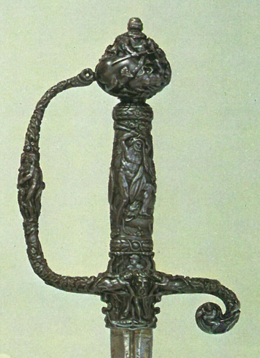

Here are some blades that Norman references in regard to the Hampden hilt. First are a couple of hilts in the Wallace Collection that are stylistically related in components.
https://wallacelive.wallacecollectio...ype=detailView
This is the one we have been looking for! Norman claims (P. 189) this is from the same workshop as the "so-called Hampden sword".
https://collections.vam.ac.uk/item/O...apier-unknown/
Sadly, the Victoria and Albert Museum also has this hilt being from an unknown workshop. Though they do say France as its place of manufacture. The blade appears to have pierced work. It is amazing how such artists can fade into the mists of time so quickly. I wonder if they felt unappreciated by their patron during their lifetimes?

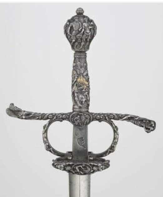

Thanks again I.P! I had to dig into the archives, found my well weathered old copy of "Arms and Armor Annual" (ed. Robert Held, 1973),
In "English Swords 1600-1650" John F. Hayward, (V&A; Sothebys),
I think we have it!
ROBERT SOUTH,
"...the only hilt so far attributed to ROBERT SOUTH is that of Henry Prince of Wales (this sword we are discussing) this follows the fashion ofv the 17th c. but is of higher quality. Another hilt that can be attributed to South is the sword of James I with blade by CLEMENS HORN in the Windsor Castle armory. It is not unlikely that SOUTH was the importer of the Horn blades and that all the hilts originally furnished with such blades CAN BE ATTRIBUTED TO HIM" !!!
Further noted, South was the leading cutler during first half of 17th c. was appointed cutler to James I, and held office under Charles I. His name first appeared in records of cutlers company 1603.
It seems that some of the sources we have been citing somehow missed this important attribution by the late Mr. Hayward. Looks like ROBERT SOUTH is the artisan we're looking for.

Returning to the original post and question by Rob.
What artisan made this hilt ?
The tradition attributing this hilt to Benvenuto Cellini (d1571) is of course incorrect, but of course the neoclassical and Biblical themes may have inspired the maker, who it appears was likely Robert South. He was leading cutler appointed to James I and later held office under Charles I. He was highly esteemed first half of 17th c. but it seems curious that while producing work for the Royal House, he produced this hilt for Hampden who was apparently Parliamentarian during the later troubled times. Perhaps that would put the date of this sword earlier c. 1605-10?
Hayward (1973) Arms & Armor Annual, "English Swords 1600-1650" also notes South was likely the importer of the prestigious blades from Solingen maker Clemens Horn.
Hayward also notes little is known of South, but in 1603 he was a member of the yeomanry of the Cutlers Co.
In these highly detailed and high station regalia type swords it seems these kinds of themes and subjects were well known. It is unclear why this hilt would be attributed to Cellini, though perhaps the theme detail was from work by him.
It would take much more research into the works of Cellini to discover why South close this theme.

With these pages from Southwick and Bezdek, it seems these records are about the sum of what is known about South. In looking further into the sword we are discussing (OP) the questions remain, if South indeed fashioned this hilt, where did he get the inspiration for the themes?
Why was this hilt presumed Cellini? Did Cellini produce hilts? or was there some other work which might have inspired South to follow this theme?
Next stop, checking 'Boccia & Coelho' to see if any work by him shown there.
Then, WHY the tradition that this sword belonged to Hampden?
It is interesting that he was the cutler to both James I and Charles I.
South was furnishing swords to Parliamerntary forces.
We know South was instrumental in convincing Charles I to begin the German swordsmith enterprise at Hounslow Heath in 1629, as this was South's own home neighborhood. In 1632 he was granted a mark for his blades by the Cutlers Company.
As a cutler, and dealing in blades and mounting, it is curious that South would have been the one who created this delicate art work. Others creating silver hilts etc. were often jewelers and goldsmiths, yet South seems focused on the supply of swords.

You bet I.P. ! and likewise thank you for these images and more intriguing ideas...pomegranites etc? hadnt noted these details.
Found this:
from "Swords and Daggers" John Hayward, 1951, p.5,
"...during the first half of the 17th century, a number of hilt constructions were developed in England that were peculiar to this country."
further,
"...the decoration of these hilts was executed in silver and gold encrustation and damascene, often of high quality. Some of the 'damaskers' mentioned in contemporary English documents were probably foreigners, but there is good evidence, for example in the Royal Wardrobe Accounts, to show that such native CUTLERS AS ROBERT SOUTH AND THOMAS CHESHIRE were supplying work like this kind in the early 17th c.".
I checked Boccia & Coelho ("Armi Bianche Italiene", Florence, 1975) and found no evidence of Cellini work on hilts. Reading his biography however, thus guy was one of the most dynamic, scandalous characters ever.
So it seems that the elaborate work in these hilts is quite likely by South.

From: "A Rare English Sword from Plymouth Colony", Anthony D. Darling, Arms Collecting, Vol.20, #2:
from a sword excavated at the Edward Winslow house property, 1898.
It is noted in Norman (1980) that in its earliest form this hilt style is found in Europe from c.1490 to mid 16th c. It reappeared for a time in England briefly in the 17thc.
"...the fashion of a simple cross guard occurred as a result of a large number of Knights of the Bath created by James I at his coronation in 1603. It was usual for a sword of antique type to be used in the Bath ceremony. The finest of this group was made for Henry, Price of Wales, and bears his crest. This sword can be dated prior to his death in 1612. At least one undecorated example of this type is known. It is shown in the portrait of the First Earl of Doune, in the rones of the Order of the Bath.c.1605. the example illustrated in this paper from the Tojhusmuseet has a cross guard about identical from the Plymouth sword hilt".
I would note here that South was bound to Thomas Cheshire in 1603, who was officially cutler to Prince Henry, Prince of Wales, and son of King James I.
The sword for Henry was once thought to be a gift to him from Louis the Dauphine in 1607 , but as noted by Mann (Wallace Coll. 1962.. p.263) this seems unlikely.
It does seem this hilt style is of vintage form as noted, and distinctly English as shown in the Plymouth sword example relating to these spherical pommel forms.
What puzzles me at this point is, why would such a sword of this regal stature be associated with John Hampden, who was a Presbyterian cousin of Oliver Cromwell, staunch Parliamentarian often at odds with the Royal Court. It seems entirely contrary to such context , and clearly South was entirely and officially to the King.
Interestingly South was instrumental to establishing Hounslow in 1629, which was later taken by Cromwell's forces. Aylward (1945, p.32) notes that "Cromwells New Model Army, apart from what it could get from Hounslow was supplied with Dutch (German) blades".
This was of course 1642, Hampden was killed 1643.
Not sure if even a tenuous connection could be made with this.
Thus, the Cellini connection seems entirely fanciful, and unsupported, and the Hampden 'tradition' seems questionable at this point. Why a 'firebrand' of Parliamentary background and prominent command would have a sword clearly of the cutler of the Royal Wardrobe ?
Admittedly there are differences in the so called Hampden sword of OP, the pommel taller, the quillons slightly alternated and the rapier ring guard, but the manner of decoration and styling ring closely to these English swords described.
