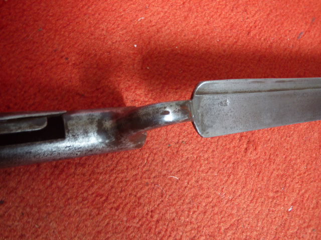

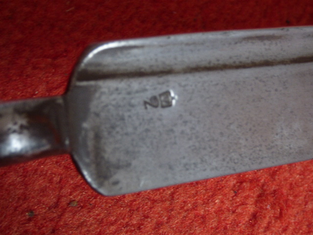

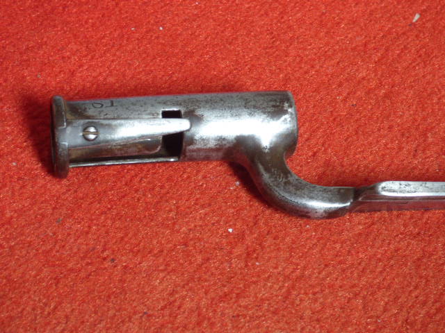

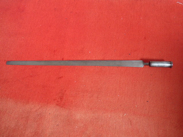

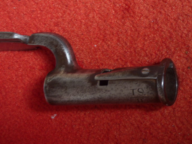

I recently was bequeathed by a friend, now sadly dead, a most unusual socket sword bayonet. Overall its length is 81.5cm, with a blade of 69cm, and that despite the loss of its point. The blade is back edged with a narrow fuller for 3/4 of its length just in from the back. The blade has a single mark - a crown over the number '2', a standard British government acceptance mark. The socket is marked '11' and '81' which suggests Company 11, rack number 81. I have been able to discover that it is probably a Pioneer sword converted into a bayonet, hence the extreme length. What do the edged weapon experts think?
I have no information as to its provenance, my friend had never mentioned it and his family know nothing about it.
Neil

In my opinion it looks like a bayonet for an Indian Brown Bess. The spring on the socket seems to be pretty standard for that type. Maybe EIC?

I have no expertise on bayonets, but have a couple of references I was able to dig out.
As 10th has noted, that spring catch is exactly right for EIC Brown Bess c.1800-1805 ("Collectors Pictorial Book of Bayonets", F.Stephens, 1971. #31).
However this is entirely an anomaly, and that catch is most of what corresponds to the EIC example.
There is the recent book, "Socket Bayonets" by Graham Priest (2016) which is an intriguing insight into these bayonets which offers information not in the venerable old references.
One thing I notice in the markings on the socket......supposedly 11 over 81, in accord with rack numbers often seen, however.....these characters look more like Roman numerals II rather than 11 (note serifs).
The '81' also seemed more like letters than numbers.

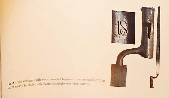

In the Priest book, I was astounded to see the example 98 (p.51) shown as a bayonet from a British volunteer unit from around 1790(?) .
LOOK AT THE CHARACTERS! very similar, looks like an 18 (it is noted only 18 made).
This bayonet obviously looks nothing like yours, but that marking is compelling.
In this period 1790s in England, there was a great deal of worry about French invasion, and there were numbers of militia, volunteer units formed, for which records are pretty scarce.
With the key element of the EIC type spring catch, it is tempting to think this might have been some sort of innovation in accord with the many changes in firearms design etc. of the time.
The view mark is in accord with the crown over numeral used 1796-1820 (after that letters were added, Robson, 1975, p.191).
It is unusual to see a back fuller on a blade, which seems entirely out of the norm with the triangular socket bayonets, and I am unclear on what sort of pioneer sword might be source for a host blade, or why one would be used for a munitions grade bayonet. There was however a great deal of artisan 'for the cause' work with people in various trades doing other work unrelated to their trade.
Could the '18' (?) be letters for some local unit, S.I. and the II the unit number? Then the MOST unusual blade shape.
These are the pieces of the puzzle, and all we can do is speculate at this point. One thing for sure, this is an anomaly with potential for some remarkable history!

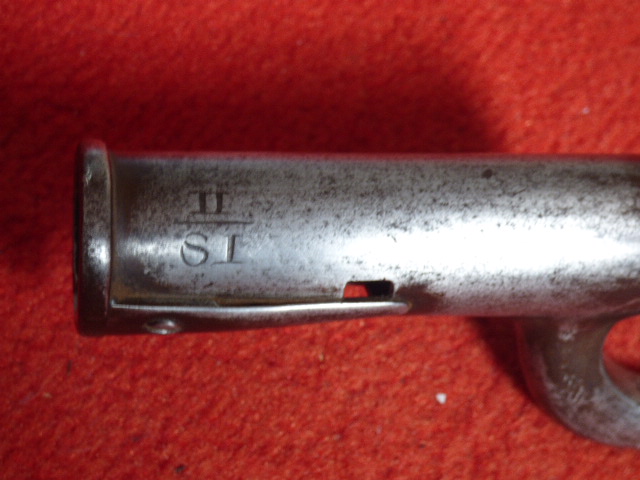

Could it be that the number at the socked is II/SI and not II/8I?

That's what I was thinking too Udo. As I noted in my post (#4) the markings on the British volunteer unit bayonet are remarkably similar. In the late 1790s into early years of 1800s there was a distinct paranoia in England about possible French invasion. There were units of the army and artillery positioned along the coasts, and bolstered by various groups or units of militia.
It would seem possible that this might be markings from such a unit, though only some sort of corroboration from accounts of such units, which are apparently pretty scarce. The presumed numerals 18 seem more like an SI as the '8' character does not close and cross as it should, but remains open like an 'S.

In my photo archive I found pictures of a percussion carbine with a lock signature "2. Scinde Irregular horse", a unit of the EIC in India. I am by no means a specialist of British troop markings and have absolutely nothing of helpful literature - but could i t be that II/SI stands for "2. Scinde Irregular" (or "Infantry")?

That honestly checks all the boxes! Indian issued matches the spring clip, EIC issued would match the non-standard repurposed blade, and the inscription explanation is as close as we are likely to get. We'll done!

It is a compelling notion to think this bayonet, seemingly corresponding to the EIC bayonet type (with spring catch) loosely might be of this connection.....II=2nd SI=Scinde Irregular.

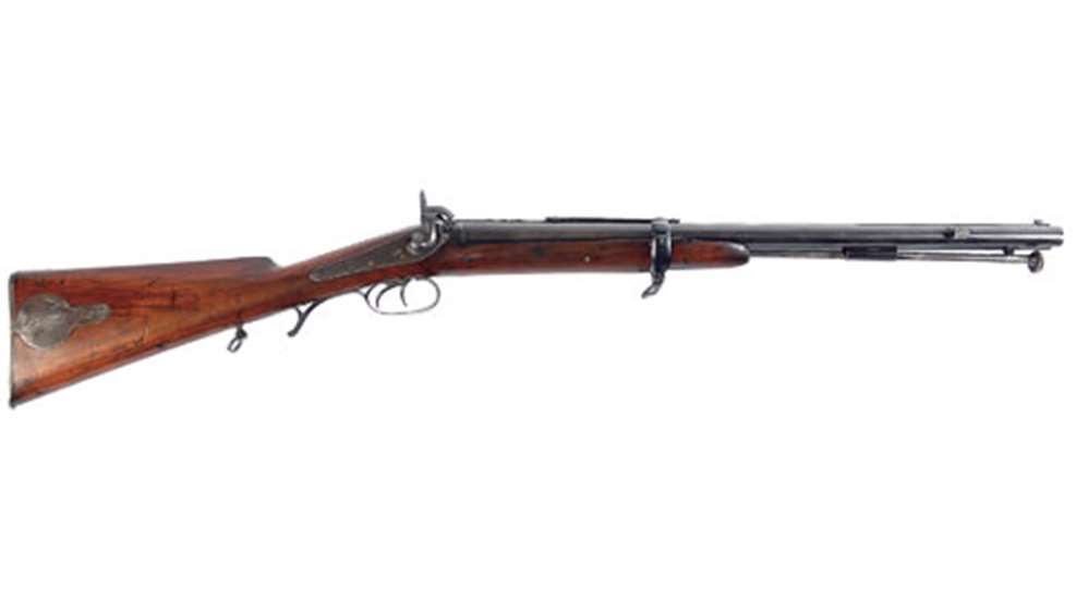

Gen. John Jacob (1812-1858) formed Scinde Irregular Horse and was in command of Second Scinde Irregular Horse (known colloquially as 'Jacobs Horse').
While as I mentioned, the cavalry often used carbines such as the 2nd Pattern Victoria percussion carbine or the Paget carbine of Napoleonic period.
Jacob developed the 'Jacobs Double Barrel Rifle' in 1856 which had the unusual sword bayonet, which was as long as the carbine itself.
These are extremely rare , as few were made and they were never officially accepted for use in the Indian army.
However it is noted "a number of variations are encountered in the RANGE of Jacob's bayonets, and it appears that some volunteer regiments adopted the rifle and bayonet for use" ("The Collectors Pictorial Book of Bayonets", F.Stephens, 1971, #61 (p.37).
