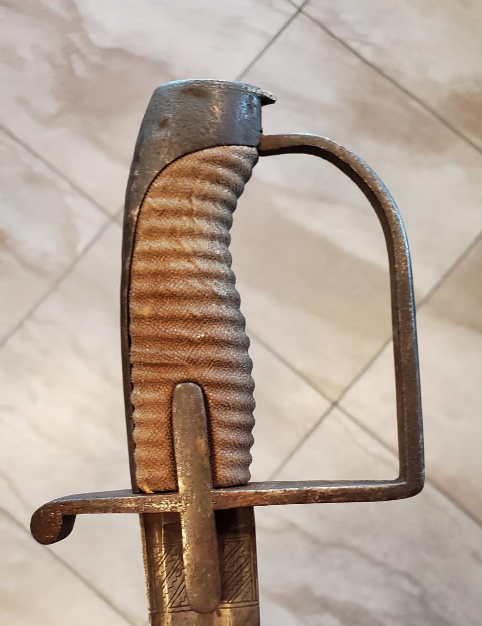

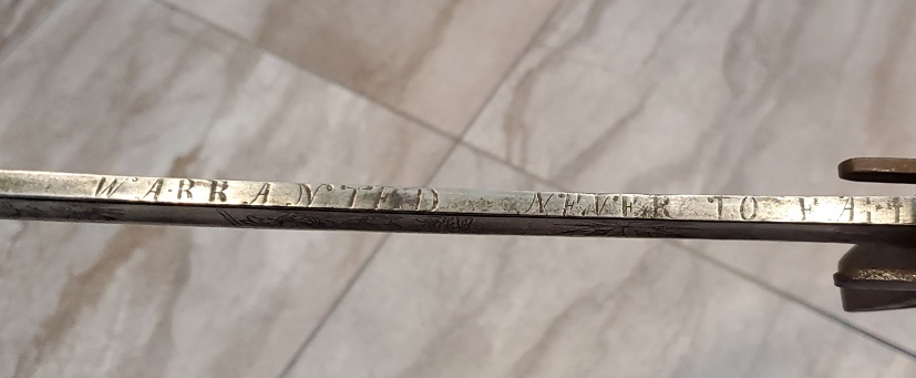

Chaps,
What have I just bought, ricasso marked Gill's and GILL British Manufacturing ?? Is this an old Victorian copy as I can't see Gills writing this on there blades.
phil.reid is offline   Reply With Quote
Old 23rd March 2024, 04:23 PM   #2
Posts: 10,867
This is pretty phenomenal Phil!
A British dragoon sword with the relatively rare triangular knuckleguard in the semi basket hilt. Clearly all the components are old and original however what is baffling is that this blade is later than the hilt.
This is an entirely correct Thomas Gill blade typically seen on dragoon officers swords of 1788+ and the inscribed forte is exactly the format he used .
Thomas Gill was in business as sword maker 1778 until his death in 1795.
His family continued the business into early years of 19th c. as per Brian Robson (1975).
He was a fierce proponent of the superiority of the British blades over the ever ubiquitous volume of German blades that dominated supply to British cutlers.
This led to his vehement contest of blade testing with his blades and three other British bladesmiths against the German blades (typically brought in by JJ Runkel from Solingen). This became known as the 'sword scandals' in the latter 1780s and led to his adding the word WARRANTED to his inscription on the blade.
The WARRANTED term was also added on the spine of cavalry blades on his 1788 model examples.
This hilt however is generally held to be British dragoon c. 1755, into perhaps 1760s, however does not seem to have prevailed into end of 1770s .
This example might be one of Gills earliest swords though! as there is no defined date etc. ending those hilts which certainly might have remained in use in certain cases.
What is needed is an example of Gills earliest blades, and did he use this dramatic 'advertising' panel at forte in his earliest work? contrary to the typical convention of British makers with block letter name on spine of blade.
You MAY be onto to something here Phil!

I forgot to add the forte inscription. This was distinct Thomas Gill, who was quite a promoter, and so much so he pretty much infuriated his competitor James Wooley.
He was the one who began emblazoning 'WARRANTED NEVER TO FAIL' on his blades, a convention soon followed by some of the other makers after the 'sword scandals'of the 1780s.
This sword is truly an anomaly, as I mentioned, these hilts were a munitions grade type of half basket dragoon sword distinctively Birmingham, and most typically seem to have been by Samuel Harvey about 1755, into possibly 1760s. The form does not seem to have been overly prevalent as there were of course other types. Thomas Gill, who is not recorded as making swords until 1778, even if perhaps several years earlier, still seems a gap.
As always, it is hard to define how long certain hilts remained in use, and if they might have been refitted later from stores as required.
I have one of the Black Watch style basket hilts of c. 1750s and these were turned in c. 1783 when infantry mostly no longer carried swords .....mine seems to have been refitted with a M1788 light cavalry saber blade. I have seen I think 2 other examples like this which suggests it was not entirely unusual to have earlier hilts remounted with newer blades, though unclear what circumstances.

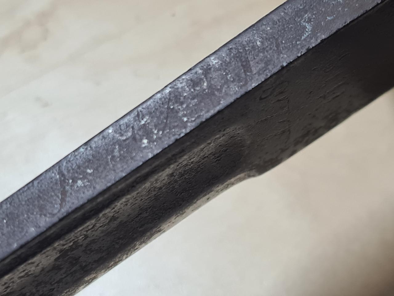

G and GG stamps on all my Osborns, not a GILL stamp

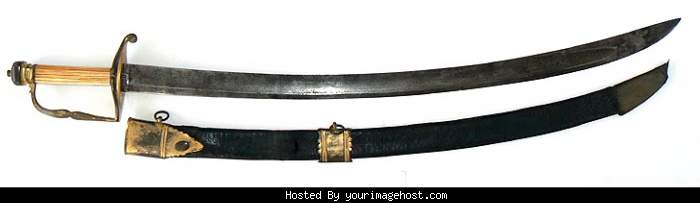

Hello Jim and I forgot to give a nod toward Phil Read in my last post...Anyway out of interest I looked at https://uk.video.search.yahoo.com/yh...2a&action=view
Which is a very entertaining view by Matt Easton who compares two Spadroons of the Napolionic period and talks about sword design of this form in the context of 1896 ...What I found interesting was the style of Ivory hilt on one pattern being compared which esentially parallels in the hilt to the first sword I show on this thread (see post 5 above.) ... and which is by John Gill...that also includes his catchphrase Warranted Never to Fail...I thought to include his debate on the pros and cons of each as relevant to the Gill form. Thus members may look this up ...
Regards, Peter Hudson.
Peter Hudson is offline   Reply With Quote

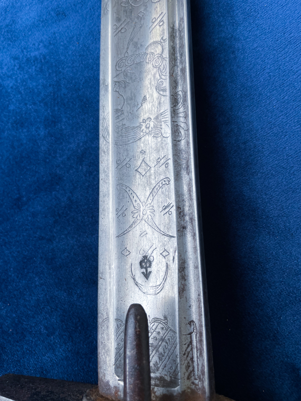

All the Thomas Gill Snr marked swords I have seen are clearly marked with his name and branding. Even on a smallsword where there isn't much space on the blade, he manages to get his message across
But I haven't seen any use of letter stamps. Only Henry Osborn and on a limited series of swords Sammual Dawes appear to have used the practice. And then predominantely on swords intended for commercial sale rather than government sales.
Tho Gill's Warranted never to Fail (1796 Pattern light cavalry sword):
Name:  1796 Light Cavalry Troopers Sabre by Thomas Gill 07.jpg
Notice that there isn't an ordinance board stamp, so it could be private purchase for a Yeomanry troop or similar.
Three generations of Gill:
Elizabeth Gill (widdow of John Gill) - 1796 LC Officer named to Oldham Yeomanry Cavalry (OTYC).
John Gill - 1796 LC troopers sold to Dutch service.
Thomas Gill - 1796 LC troopers.

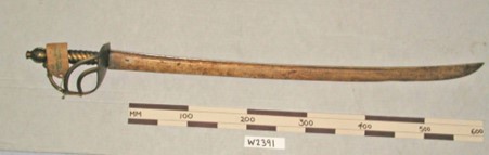

Auckland War Memorial Museum has an 1751 pattern British infantry hanger with a Gill blade. As with the OP's sword this hilt predates the blade, by the time Gill was making blades the use of infantry hangers was finished or all but.
toaster5sqn is online now   Reply With Quote

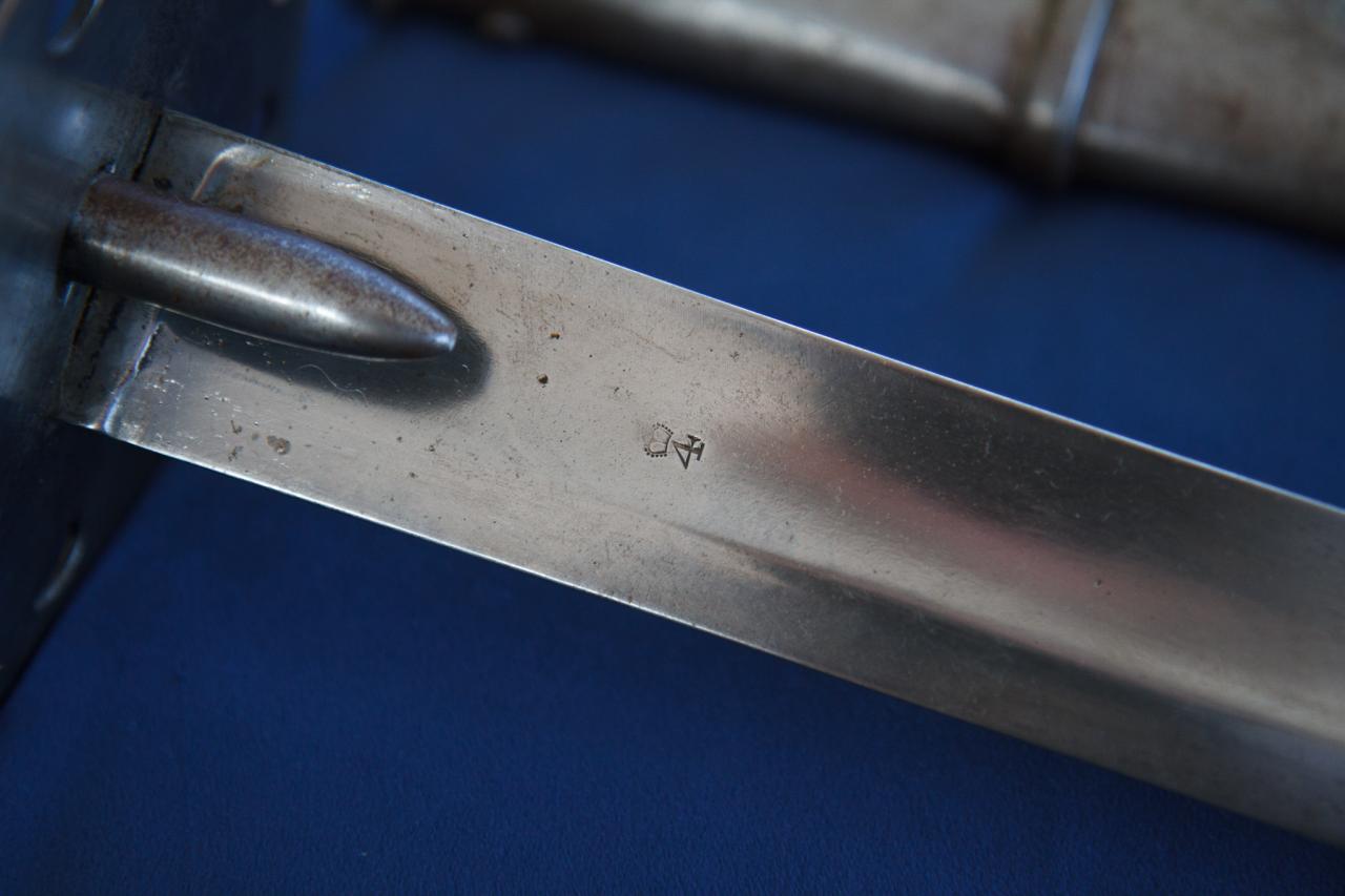

Hi Robert, thanks for sharing this sword; very pertenant to the discussion. From memory the blade was marked I. Gill, which was how John Gill marked blades of his production (I the latin equlivent for J).

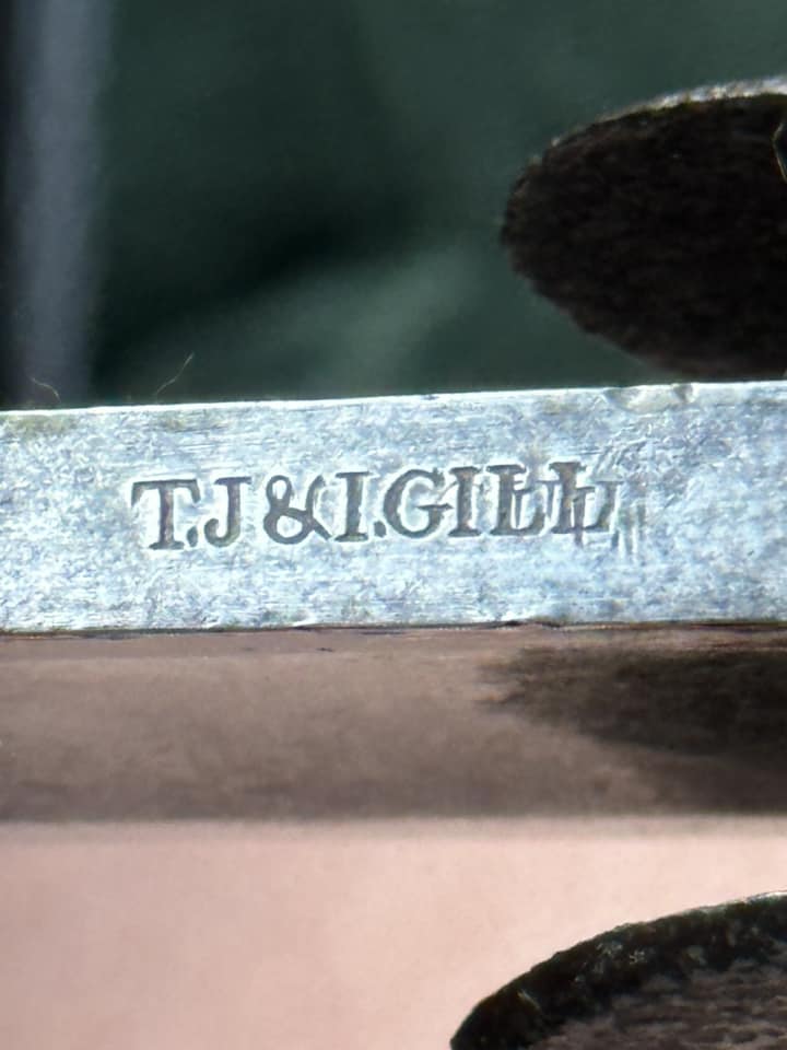

When Thomas Gill Snr died in 1801, the business was taken up by his three sons, Thomas Jnr, James and John. They operated in partnership until March 1802 when it was disolved. At this time the business continued to sell swords but it is not known if they produced new blades or simply sold pre-existing ones made under Thomas Snr.
Below is an example of one such blade, and to my eye it looks like the original makers name has been over stamped:
Of the three brothers; while they all intermittently sold swords, only John continued to produce sword blades until his death in February 1817, marking his blades I.Gill. This helps dates the production of that blade to between 1802 and 1816.

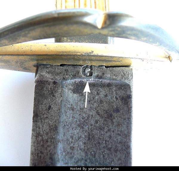

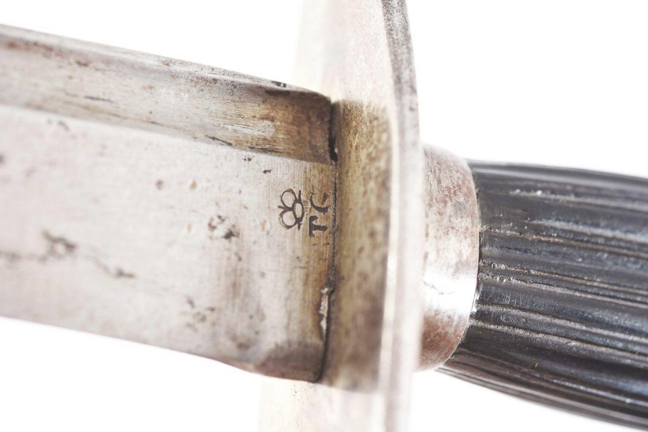

G'day Phil,
I have seen a 1788 pattern heavy cavalry officer's sword marked to Gill with exactly the same format as yours. On the ricasso is marked "GILL'S British Manufacture". Along the blade spine is marked "WARRANTED NEVER TO FAIL 1792".
I guess this dates your blade to around the same time. The question is, has the blade been added to an older hilt? What does the peen look like? I am not very familiar with that style of hilt, apart from knowing it predates the 1788 patterns.
On the subject of the "G" stamp, just to reinforce what has already been said, this mark was used by Osborn and then Osborn and Gunby on their officers' sword blades. It was never used by Gill.
Cheers,
Bryce
Cheers,
Bryce
Thank you for joining in Bryce.
Other than the stamps already mentioned (Crown over HO, G and GG for Osborn and the rare S for Dawes) are you aware of any other makers using similar markings?
Old 26th March 2024, 05:43 AM   #22
Bryce
Bryce's Avatar
Join Date: Aug 2017
Posts: 202
G'day Radboud,
I have also seen swords of a similar vintage to the Crown over HO marked Osborns, that have a Crown over TG mark. Maybe this was used by Thomas Gill, but I haven't yet found one with a corresponding Gill mark to confirm this.
Cheers,
Bryce

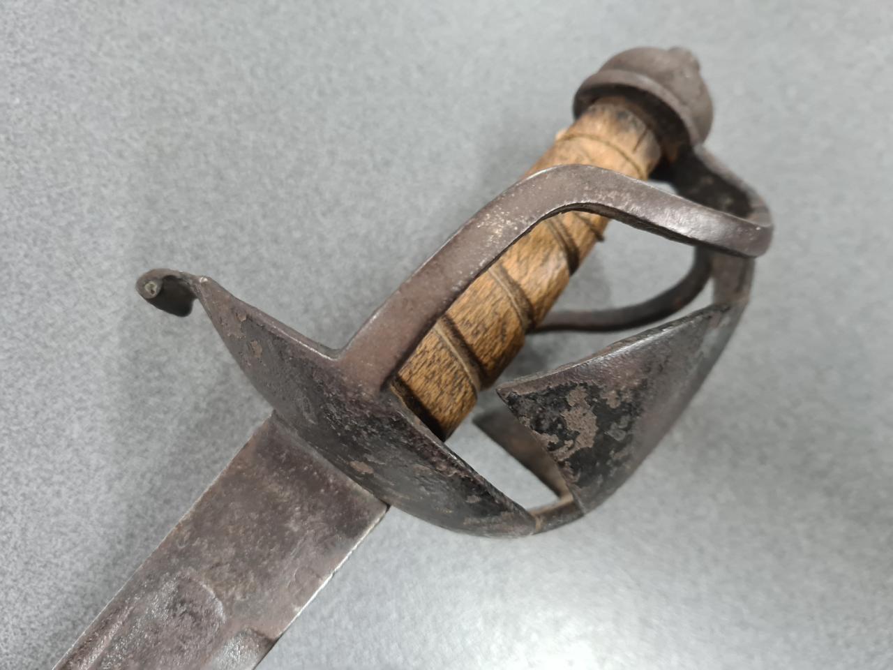

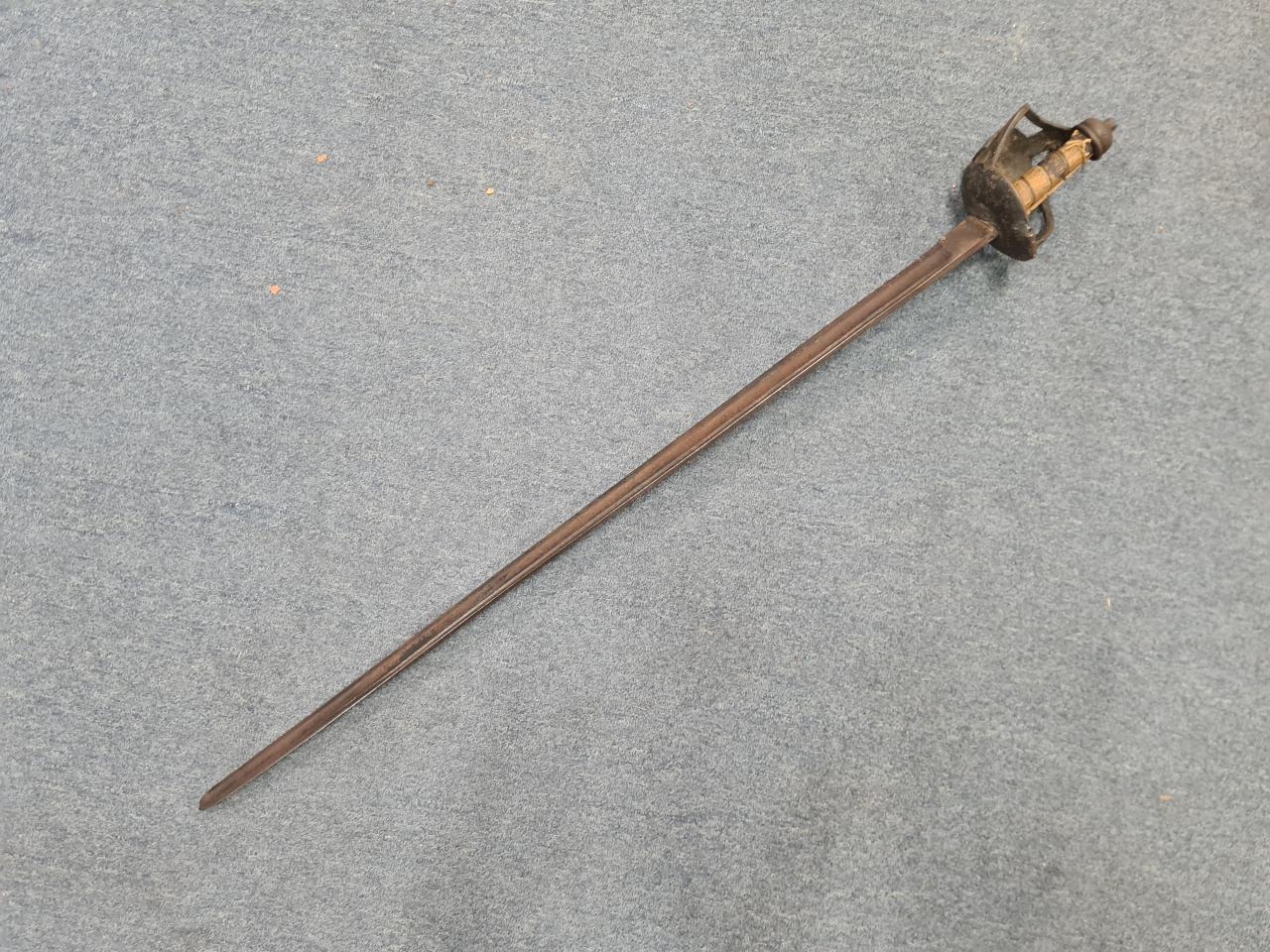

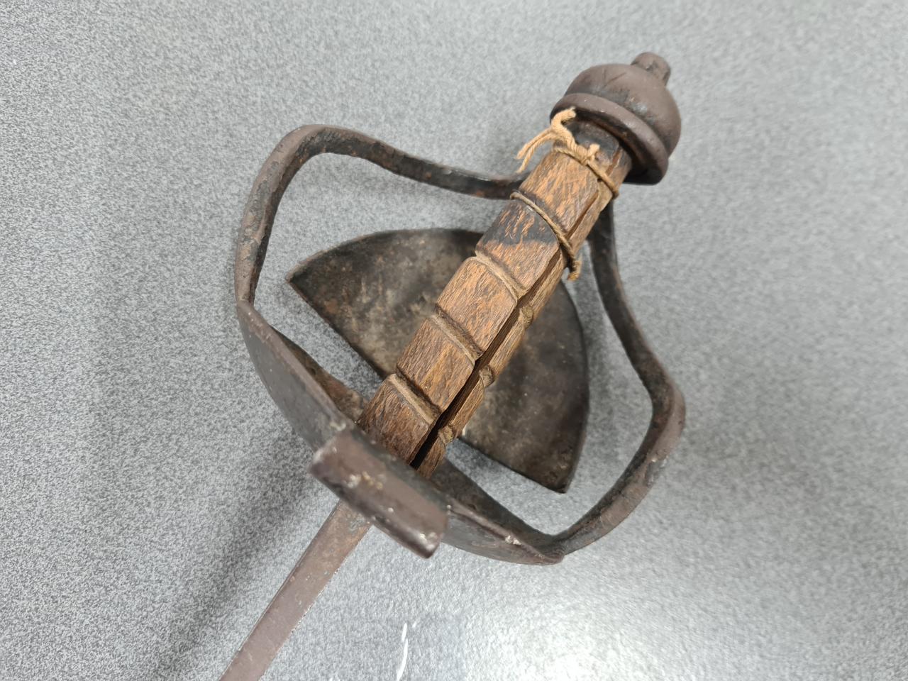

Old 26th March 2024, 07:11 PM   #23

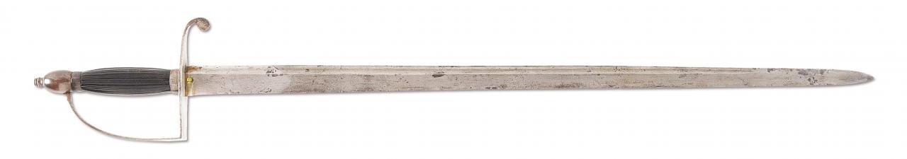

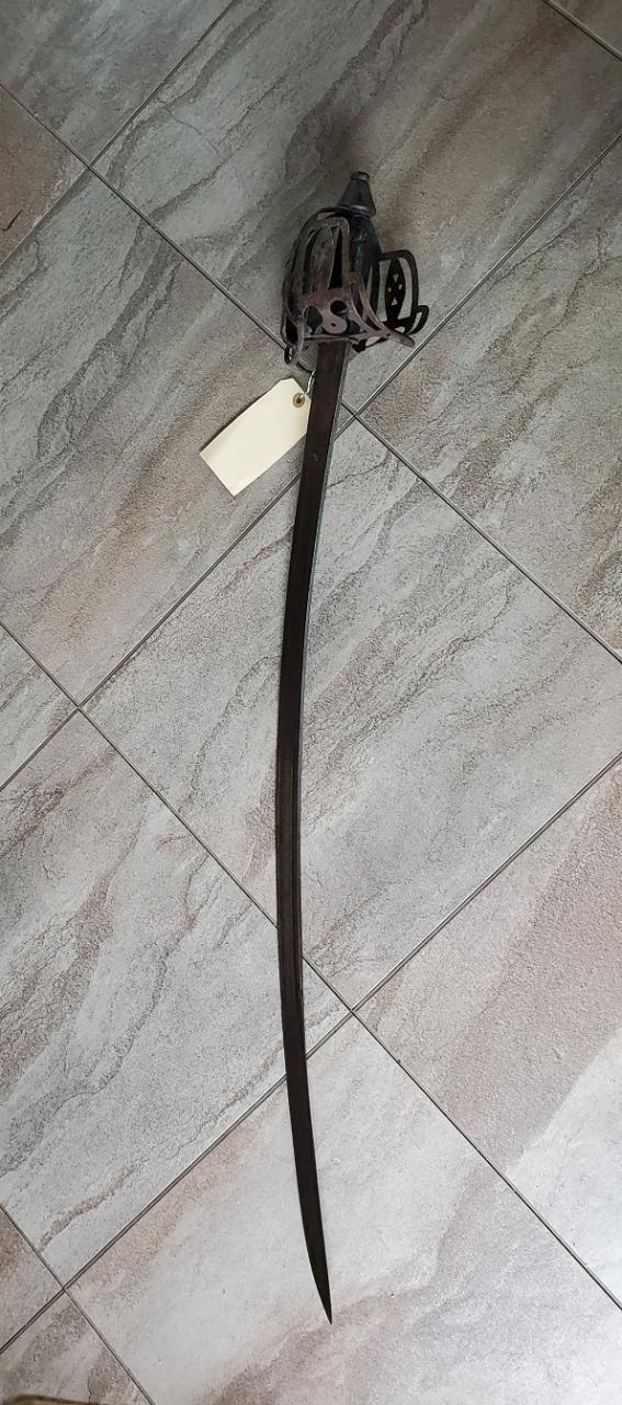

Posts: 10,867
In accord with the case with earlier hilts paired with later blades, this is a c1750 munitions grade British basket hilt of the form produced by Jeffries and Drury in London. These were known to be used by the Black Watch as well as several other infantry units.
At the end of the American Revolution the carrying of swords by infantry units effectively ended, with numbers of these swords of course being put into stores. At some point it appears several of these were paired with M1788 light cavalry saber blade......by whom or for whom is unclear.
I recall many years ago in my quest for the presumed M1788 heavy cavalry sword, which of course had the straight single edged dragoon type blade (despite the light cavalry moving to the hussar type saber).......I found an example of the claimed hilt form...basket type hilt. However, this had a heavy, curved saber blade.
Soon I decided this, with curved blade, did not seem quite proper for the example I needed (as per Robson, it was about 1977) so I let it go.
These are examples of hilts paired incongruently with other blades, and in particular the c. 1750s hilt mounted with 1788 light cavalry saber blade.
It would seem of course that these kinds of pairings might have to do with yeomanry units perhaps, or traditionally held hilts given newer blades.
Whatever the case, it does not seem an altogether unusual instance.
