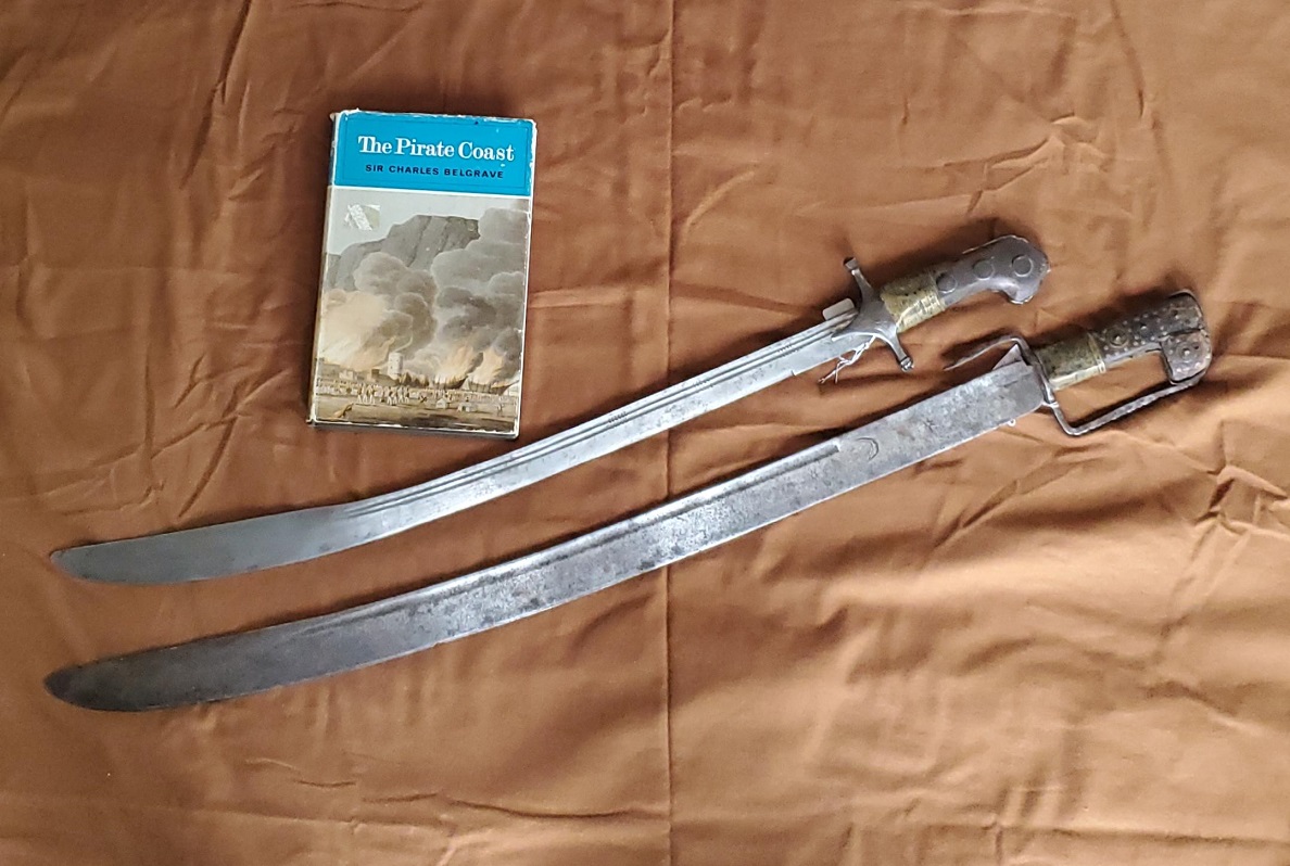

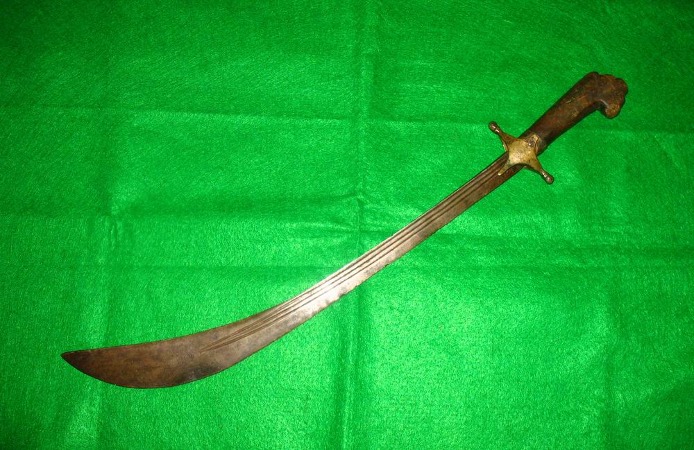

There were pirates in the Persian Gulf in ancient times, but the subject here is those who preyed from the Strait of Hormuz at Ras al Khaima along the coast, southward. These regions were known as the 'Pirate Coast', until 1820 when the British signed treaties with many of the sheikhs in coastal principalities with these regions termed 'The Trucial Coast'.
While the complexities of these ongoing circumstances in these areas, it is interesting to note this obscure area of 'piracy', which typically of course is centered mostly on the familiar pirates of the Caribbean.
In these areas of Arabia, the focus here is on the al Qawasim tribe (termed Joasmi by the British) many of whom formed the groups of pirates who raided and attacked along the coasts of Eastern Arabia, vessels of the East India Co., and even as far as the western (Malabar) coast of India.
It seems that these coastal regions in the Gulf were studded with islands, twisting creeks, treacherous sand banks and ideal for pirate activity.
The book, "The Pirate Coast" by Sir Charles Belgrave (1966) is a wonderful source detailing the history of piracy in these regions.
The top example strongly resembles the 17/18th c. example in "Arms & Armor of Arabia", Robert Elgood, 1994, 2.1,
note the mention of resemblance of blade widening resembling the 'Moplah' weapons of the Malabar coast of India, where it seems these pirate vessels had certain contact. Both of these swords have similar widening of distal third of blade. While the mountings of both of these seem of course far more recent, the blades seem much older.
Would appreciate thoughts, ideas, other examples. I am not specifying these are 'pirate' swords but that they might be of the forms used by either these tribes of Ras al Khalma or perhaps Muscat. It is known of course that there was notable Yemeni influence in Oman, and the lower example, has a hilt shape with the blockish shape seen in the Yemeni sa'if (often termed Zanzibari). in example posted with ring guard.

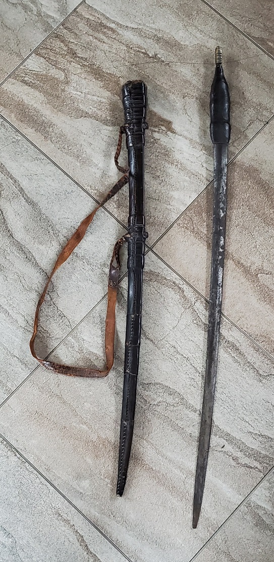

Historic photos shows Qawasim leaders mainly carrying standard Omani swords and other full sized Arab swords that are likely imported from Sharqiya and some examples could very well be imported from Iraq.
I have not found any evidence of those short Yemeni swords being used there while I consistently find them solely coming out of Yemen.
Jim, you'd love this actually, a Yemeni sent me photos of about 30 of them. Some have much larger blades. Will email those images to you as sometimes I have trouble uploading images to the forum.

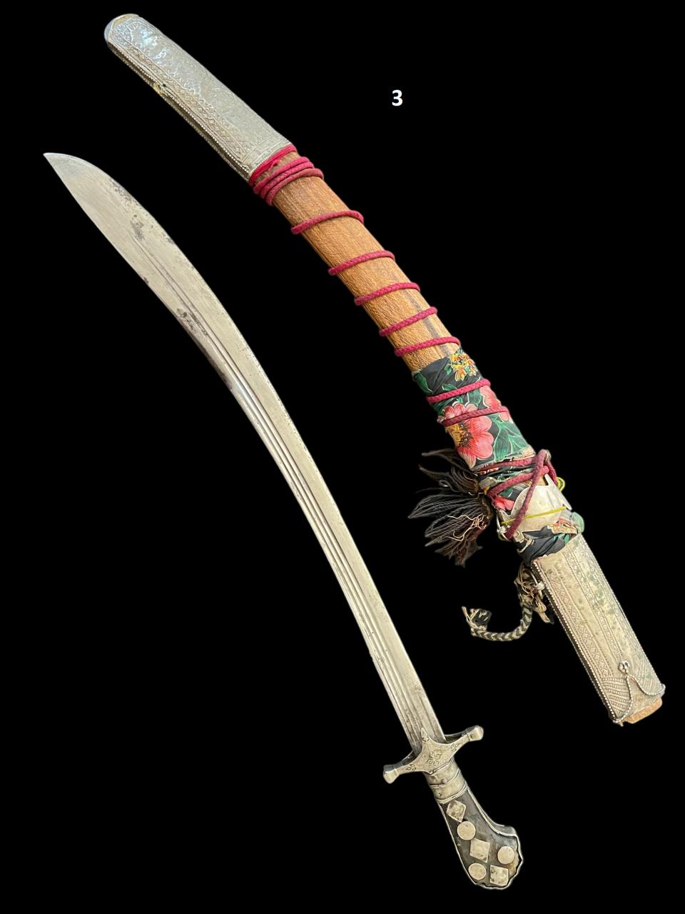

I see what you mean on the Yemeni/ Zanzibar (Oman) form sa'if (like #1 commonly termed nimcha), cruder and simpler. These hilts actually seem cast.
The conical Omani sa'ifs as noted (my example #3 is pretty rough) were it seems often highly embellished, silvered etc. as worn in a status oriented sense. In research a number of years ago, as per burton (1885) and Demmin (1877) these were entirely unlikely as combat weapons.
However the similar conical hilted examples with curved blades (usually German) were. These were the actual 'kitara' swords (illustr. #4).
I agree with your observations on these Omani forms being most likely in the Hormuz, Muscat areas, and if any of the Yemeni forms did find use there it was surely incidental. Thank you again, well explained insights!

It seems one of these (with the Maghrebi style guard system,as pictured below) was captured by Thomas Hopsonn in 1676 from an Algerian corsair. It seems this further supports the Yemeni associations noted by Lofty and Teo on these weapon types, and with these 'Moplah'(?) influenced blades.
In this, there is still a bit of potential for a 'piracy' connection with these two examples, tenuous though it may be. The hilts are clearly far more recent, however the blades resembling the earlier types noted may well have been circulating in these earlier times.
In that case, the regions of North Africa where the Sale' Rovers operated from that city/state in Morocco, as well as the notorious Barbary corsairs from the various Barbary states 17th into 18th c.
It is surprising to know that many of these 'pirates' were actually former European privateers, who moved into these regions in peace time to carry on with their 'trade'. Usually these men converted to Islam and took new names.
As with the often far ranging regions where these groups of 'pirates' operated, along with the complex trade networks which were present through all these areas, the diffusion of weapon forms must have been remarkable.
With that ratiocination, there are of course many possibilities.
Still, by the numbers, the suggestions for probable 'pirate coast' (eastern Arabia) connected to Oman and the 'Barbary Coast' (North Africa) and its connection to Yemen (S. Arabia) seem most plausible.

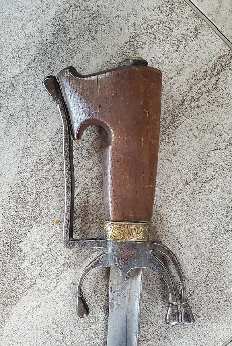

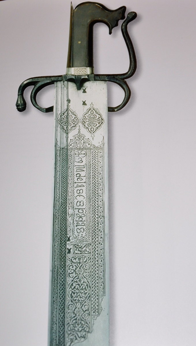

Jim, the nimcha you have posted is the one from the collcetion of the Met in New York. It belongs to a type of which there are multiple examples, including one captured by the great Dutch admiral De Ruuyter in 1655, a couple in the Real Armeria reportedly from the battle of Oran in 1732, as well as other examples without provenance or dating in Malta, St. Petersburg and private collections.
Hopsonn's nimcha currently in the Maritime Museum in Greenwich is slightly different, as you can see on the attached photo of it, but generally from the same time period and just of a slightly different grip style. it is similar to another nimcha in the Rijksmuseum that belonged to Cornelis Tromp.
Personally, I do not quite see the connection to the moplah/adya katti. The Moplah cleavers have the cutting edge on the opposite side. On nimchas the blade seems much more likely to have derived from the Italian storta and the Ottoman and Mameluke blades (the yelman part).

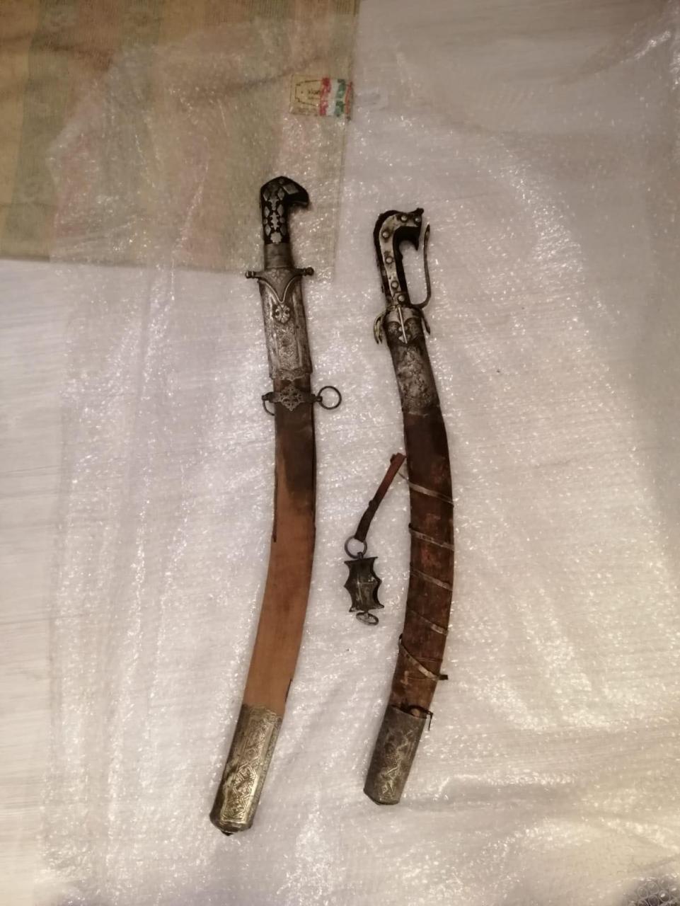

I remember emailing you images of an 'Algerian' nimcha that was found in Yemen with later Yemeni mounts. It was restored but I shall upload the before and after images upon receiving it. Perhaps the mariners had influence on Yemen which explains the high usage of short blades.
Last edited by fernando; 10th February 2024 at 12:00 PM. Reason: Please do not quote entire previous posts, just relevant small sections when necessary.
Old 10th February 2024, 10:44 AM   #14
A.alnakkas
A.alnakkas's Avatar
Join Date: Nov 2010
Location: Kuwait
Posts: 1,340

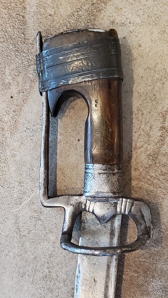

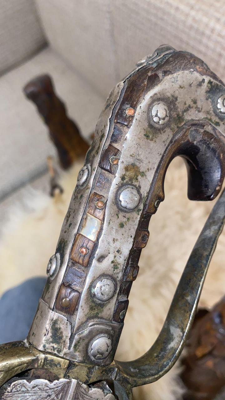

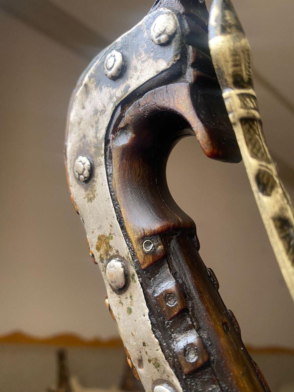

Here are the images. Note that the nimcha will have further restorations to the hilt with MoP and coral. though my restorer will confirm if its a viable option or will negatively effects the handle.
This particular example has two lockets which is odd, the older having Ottoman style niello work over a later, 19th century Yemeni locket (matches the chape and carrying rings) so this likely had quite a journey. The blades on both examples are short cutlass type.
Last edited by A.alnakkas; 10th February 2024 at 10:49 AM. Reason: Additional images of the hilt added
Old 10th February 2024, 10:49 AM   #15
A.alnakkas
A.alnakkas's Avatar
Join Date: Nov 2010
Location: Kuwait
Posts: 1,340
Images of the nimcha hilt

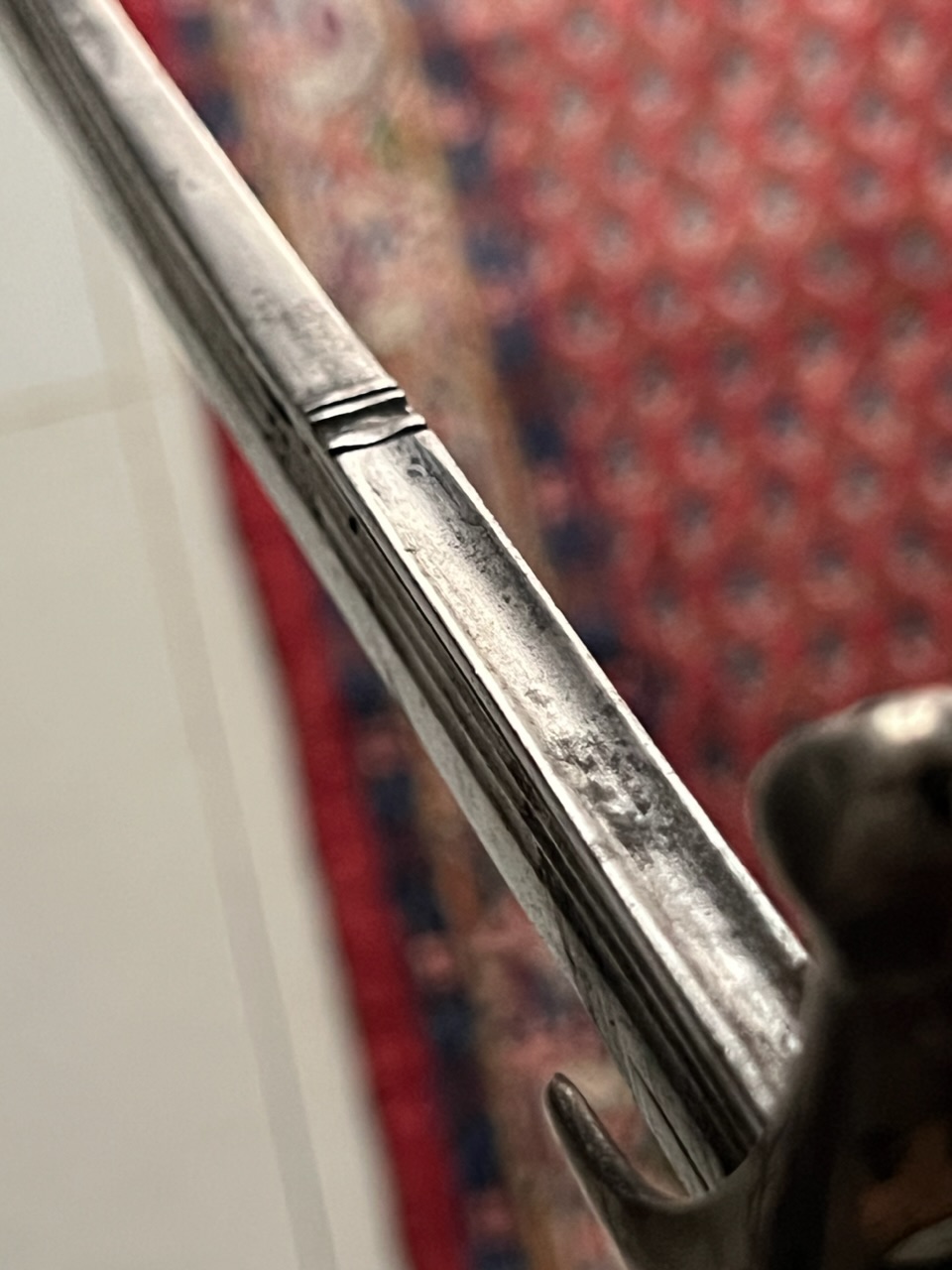

Very interesting Lotfy, thank you for posting these. Do you also have pictures of the blade of the Algerian nimcha?
Yes sir. I am mostly using old photos of when this was being prepared for restoration. The blade is in much better shape now.
There appears to be both import and 'local' production of relatively good quality. I am mainly basing this on the varying finish quality but all seem to maintain the very wide spine and drastic distal taper.

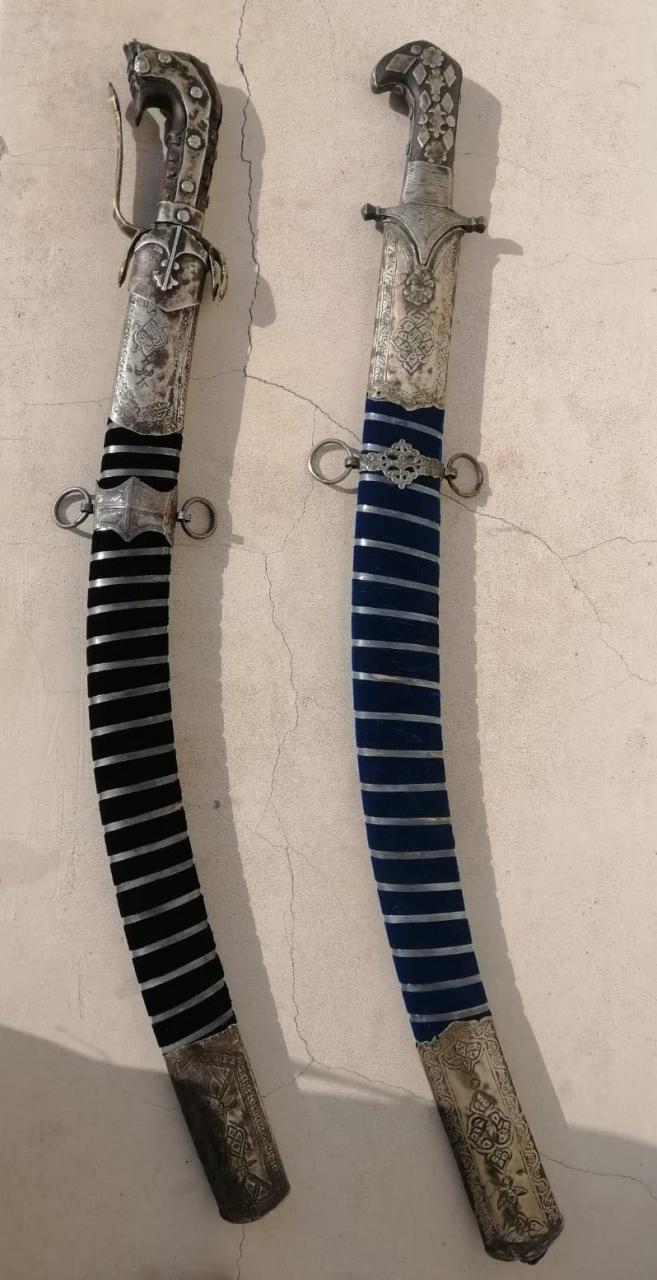

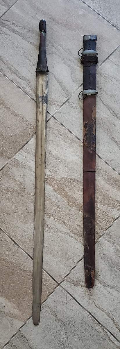

This example I sold a while ago. From what I remember the blade was phenomenal. Those short blades I came to handle all share the features I've mentioned before; very wide spines and drastic distal taper but not all look the same. Some have Arabic stamps too.

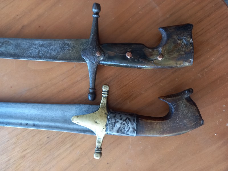

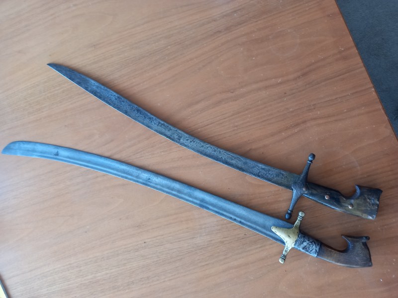

I believe these two are for pirate use also.
Old 12th February 2024, 04:38 PM   #22
TVV
TVV's Avatar
Location: Bay Area
Posts: 1,770
Beautiful and interesting examples Lotfi, thank you for sharing.
Eftihis, the sword and yataghan you show with nimcha grips could have certainly been used in a naval context, and in fact, it is even likely that they were.

I very much agree, and it seems that Arab swords in these forms were likely used in maritime contexts as the Arabs were of course so prevalent in trade which of course was by sea.
I would like to correct my earlier posts where I showed a sword which I had assumed was one of the 'kitara' swords, which was in fact a Manding saber from Mali.
The first image is the one in question; the 2nd a proper Manding saber.

With regards to the Barbary Coast, there is quite a diverse and interesting history as part of it was / concerned the present Moroccan city of Salé , where I have worked for a year in 1980.
It is opposite Rabat , separated by the Bouregreg river and used to be an independent for a while and a cente of the pirates.
Many of whom were Dutch renegades, like Jan Janszoon van Haarlem (AKA Moerad Raďs 1570- 1641).
Enclosed a sword captured by Michiel de Ruyter, most likely in the battle at Salé, approx. 1640-1664, Rijksmuseum NG-NM-10412. I can highly recommand a visit to the city of Salé !

pics :
CUTLASS BARBARY PIRATE SHORT SWORD 1650
and a Barbary Corsar AD 1500-1800 Torquay Museum
and most interesting:

On the topic of Italian influences on Indian Ocean pirates, what do you make of this one? The hilt is a typical example of the "Turk's head" type of mid-eighteenth century Genoan dagger, but the curved blade resembles that of a Moplah knife (Albeit, quite a small and delicate one.). At the same time, the pommel cap design reminds me of Zanzibari nimchas.

The Ottoman Sword most likely to have similar aspects as the Zanzibari Nimcha is as below The Pallash. The Hilt is very similar and has quillons almost the same etc etc... The Ottomans were there in the Indian Ocean from the 16th C and the design flow could easily have followed that situation. The paragraphs above clearly show Ottoman equipment including Cannons being supplied to neighbouring countries by sea routes well established in that period. Copying what was a shipbourne sword style would be a very plausible step. See the picture on my next post please.
