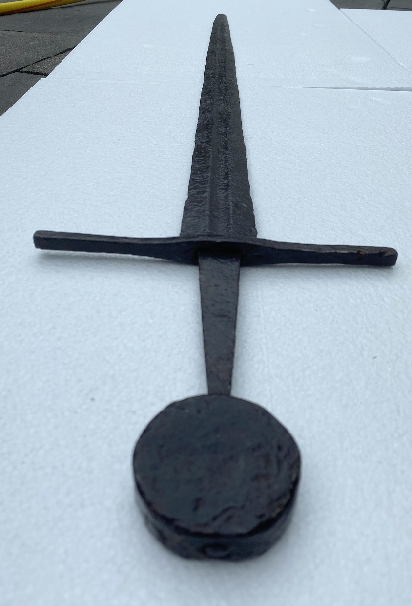

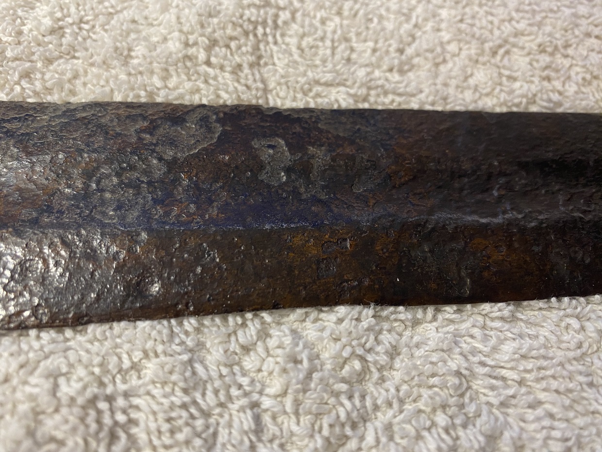

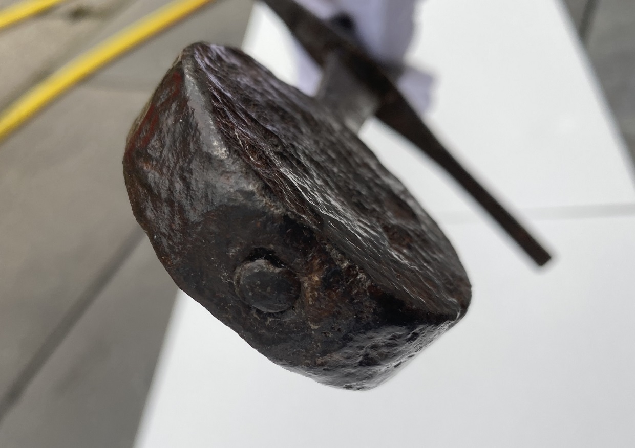

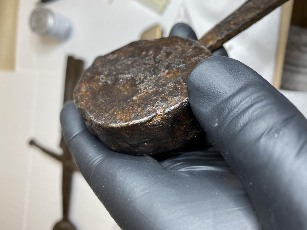

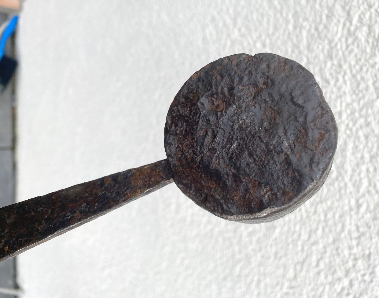

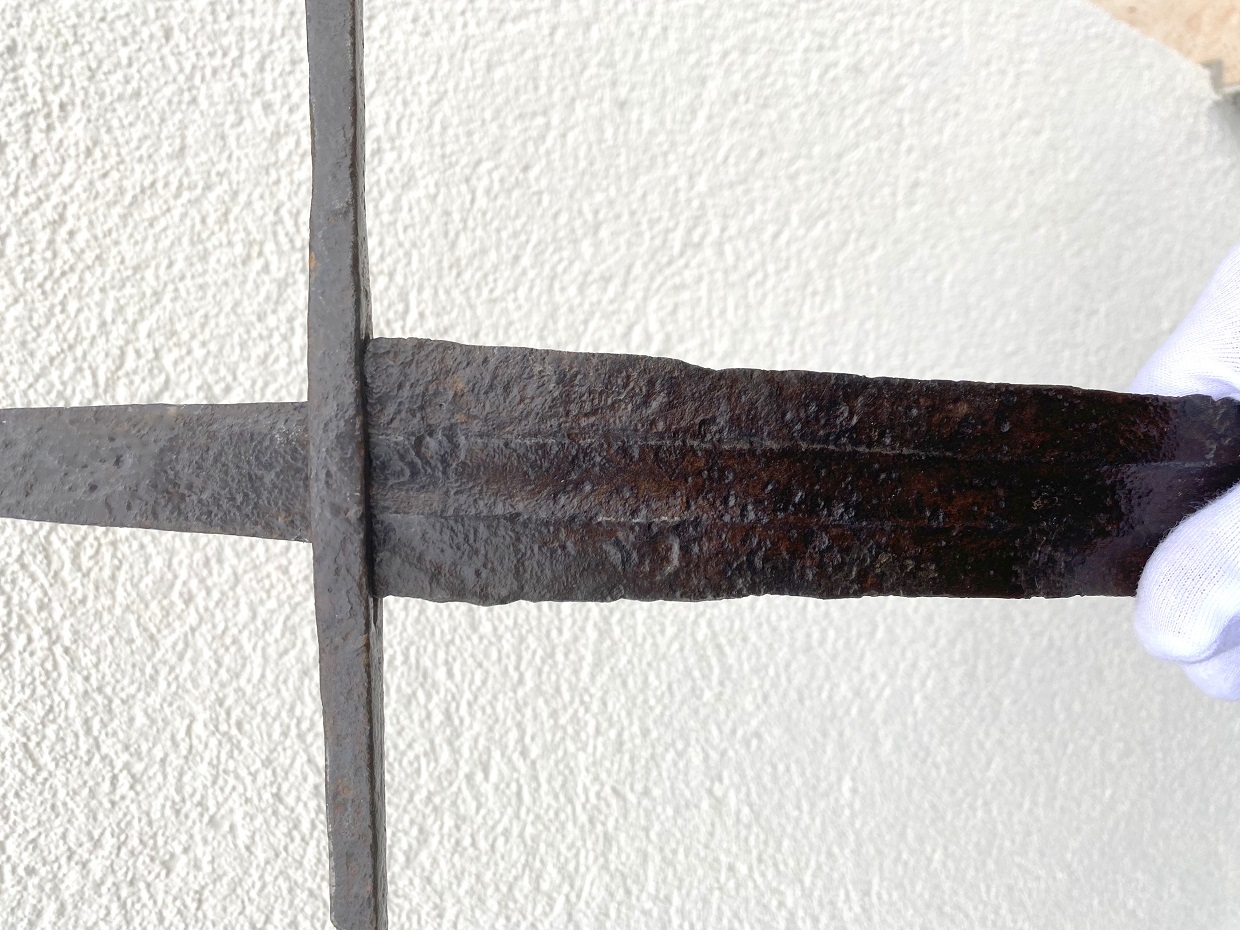

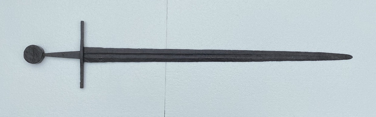

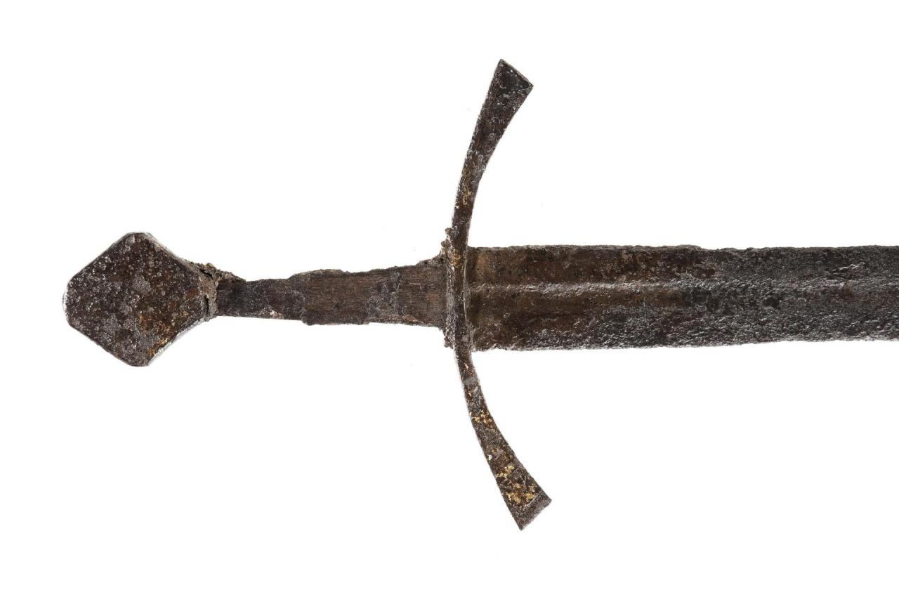

Dear all,
I would love to have your opinion on this sword. It is supposed to be a river find but as there are so many fakes today, I wonder if anyone finds something suspicious.
It is covered with a layer of glossy wax. The blade is pretty felxibel. The rivet is rivettet into a conic hole (at least it seems so for me).
Dimensions:
overall length: 104cm, Blade: 86cm, blade width: 5cm, parrier rod: 21,5cm, weight: 1200g
If some specific images are needed, please let me know.
Looking forward to your thoughts.
Kind regards
Andreas

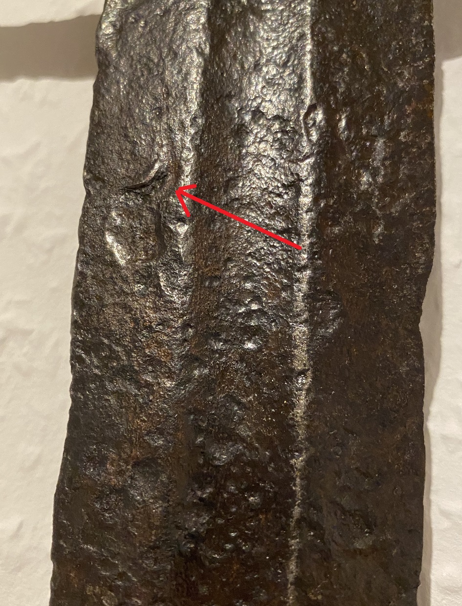

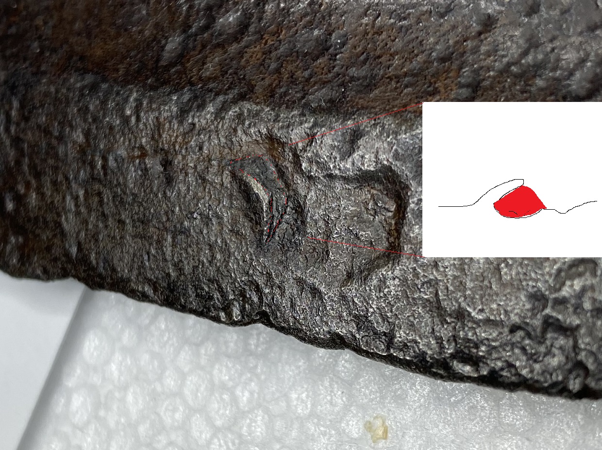

I can't say much, it looks nice. But, am I mistaken or is there a marking on the blade in your last picture? Or is it just deep corrosion?

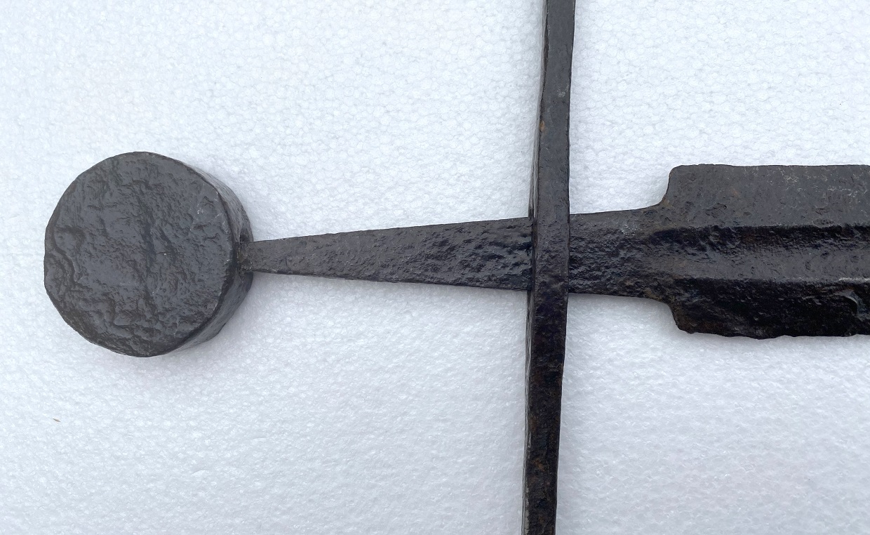

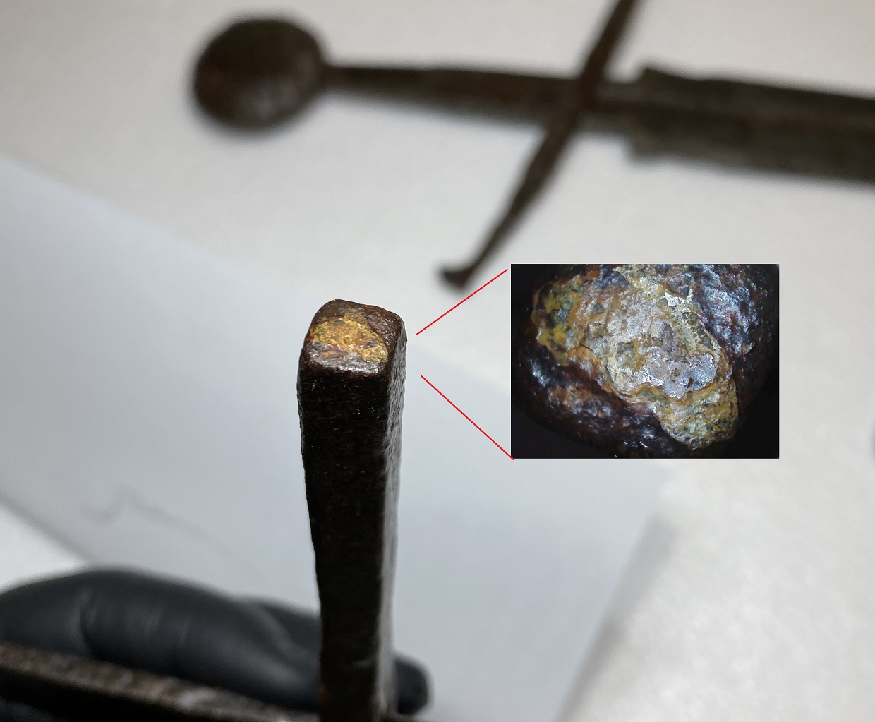

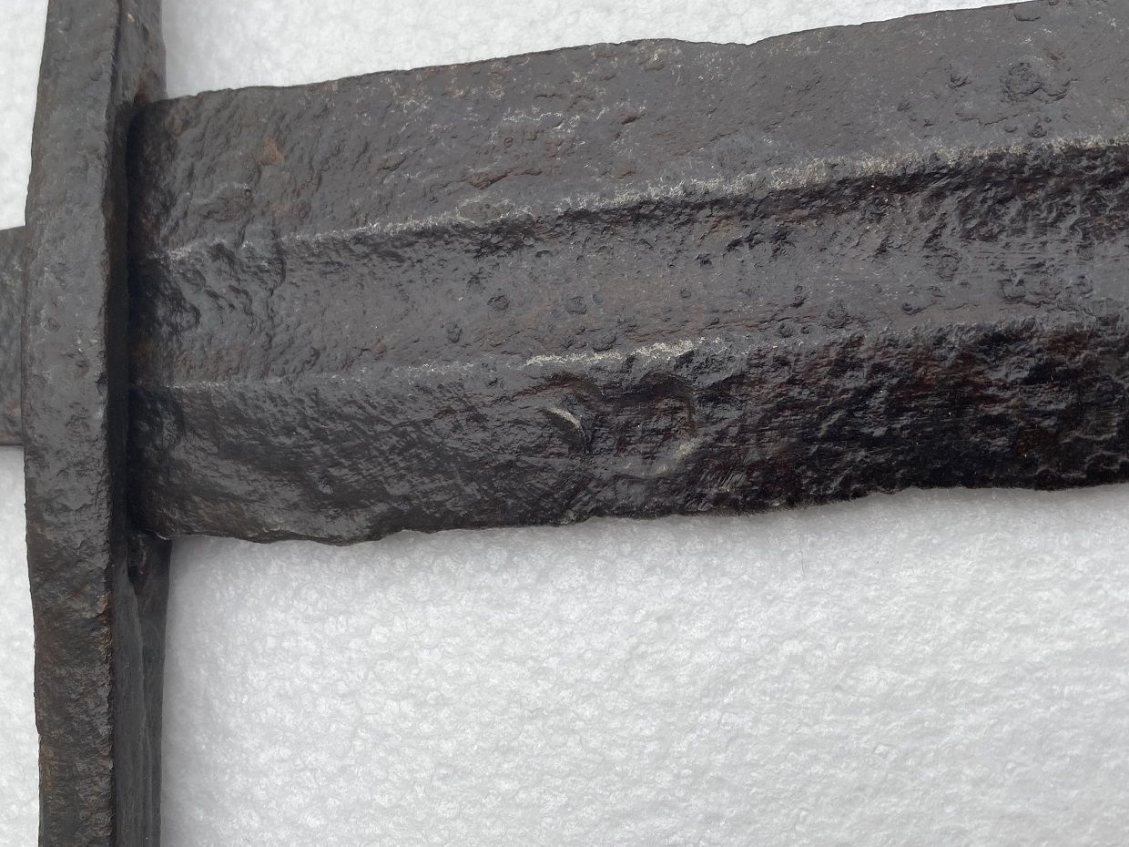

Thanks for your reply. It is not a marking, it is a corrosion pit and a part of metal layer being undermined and liftet by corrosion as far as I can determine

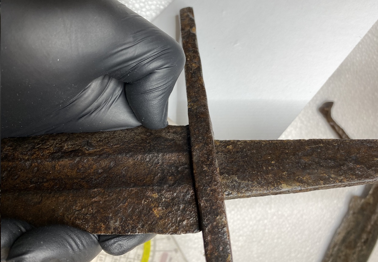

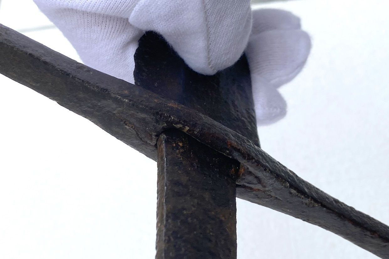

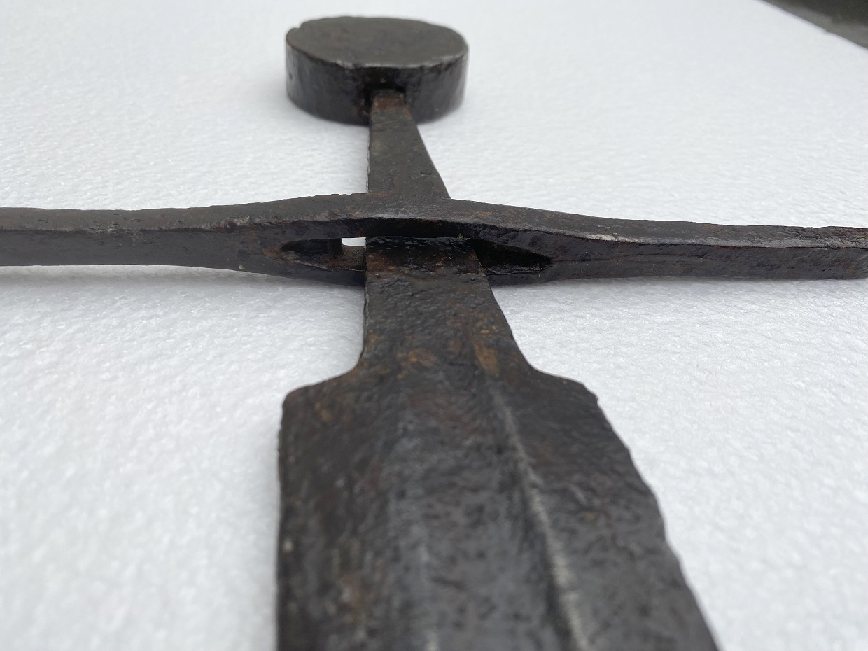

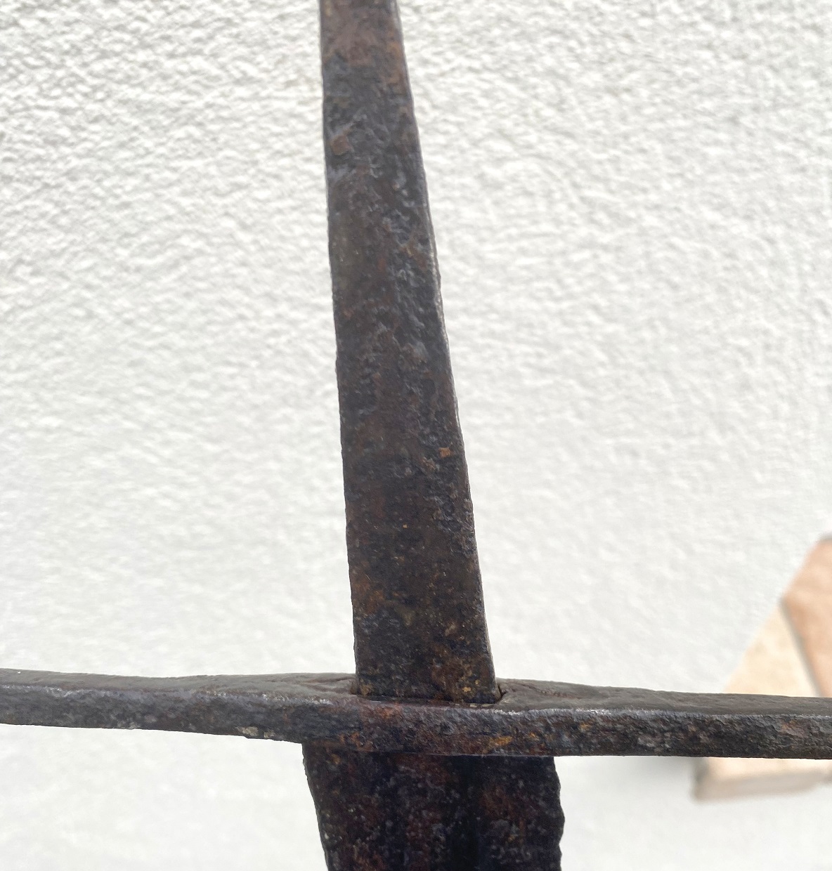

A remark: on the third last image it looks like the crossguard is made from two pieces. What looks like a welding trace is just wax. The crossguard is made from one piece. The whole for the tang is fitted with two triangular pieces of steel inserted on both sides (see second last image)

And thank you for the quick answer. The fact that such a large particle of steel fell of from corrosion makes me think that the steel is not so homogenous, meaning not a modern steel. Maybe other forum members can weigh in on this.
Overall, it's a nice looking piece, I can't find anything thing that would make me think it's a modern piece.
And yes, the wax seam on the cross-guard was a bit confusing, thanks for clarifying.

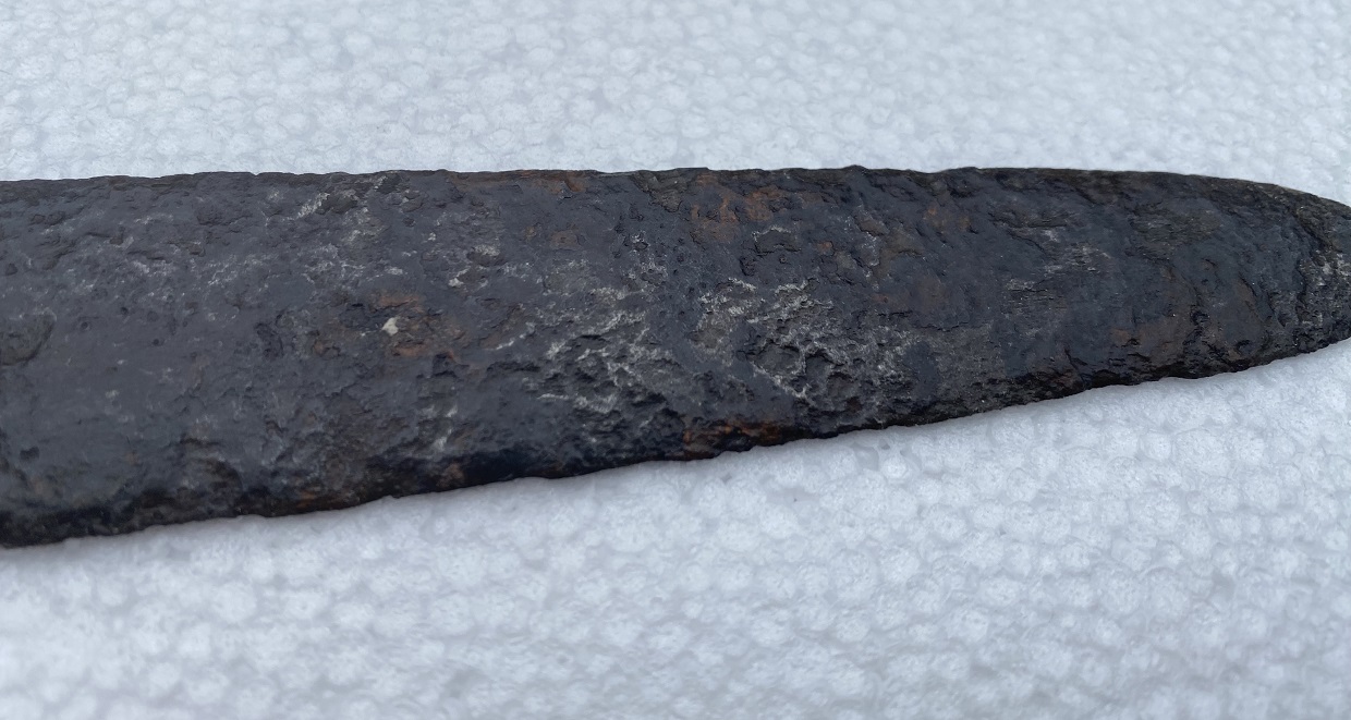

Originally Posted by AHorsa View Post
Do you have better images of the structure of its surface?...
I am afraid these are the two pictures i have; a courtesy of the current owner !

as a type this would be an Okeshott type Xa from around 1050-1100. after 900 years the oxidation of the sword looks very even over the entire surface. It is possible after 900 years but is almost unheard of, or at least so rare that it could be an omen.
After 2000, tens of thousands of most medieval sword forgeries were made, so it helps if the sword can be proven before 2000. So not through a story alone.
In any case I would try to find the previous owner or finder.

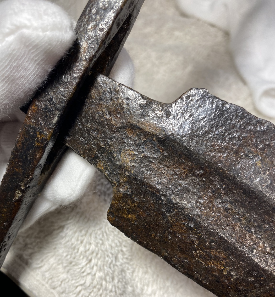

The black patina in water finds is goethite, which is glass hard and difficult to remove, even mechanically.
You could have the patina tested for hardness and chemically with, for example, acetone or other chemical solvent. If it gives off black, it is a recently applied patina.
The style is good but the tang is a bit slim under the pommel for this type with a heavy blade.

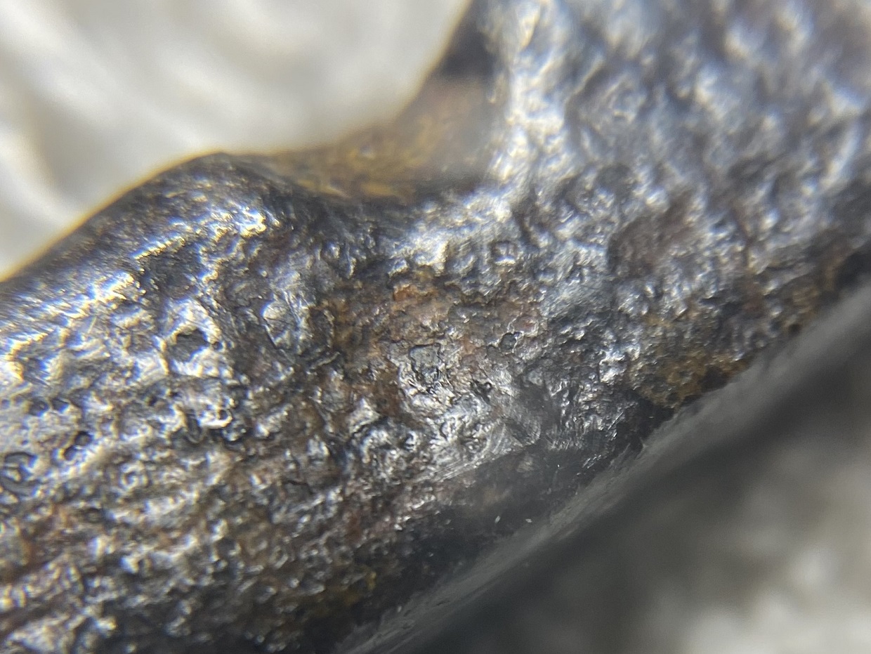

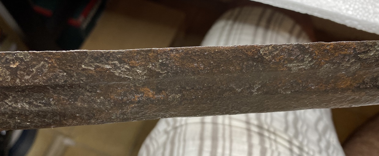

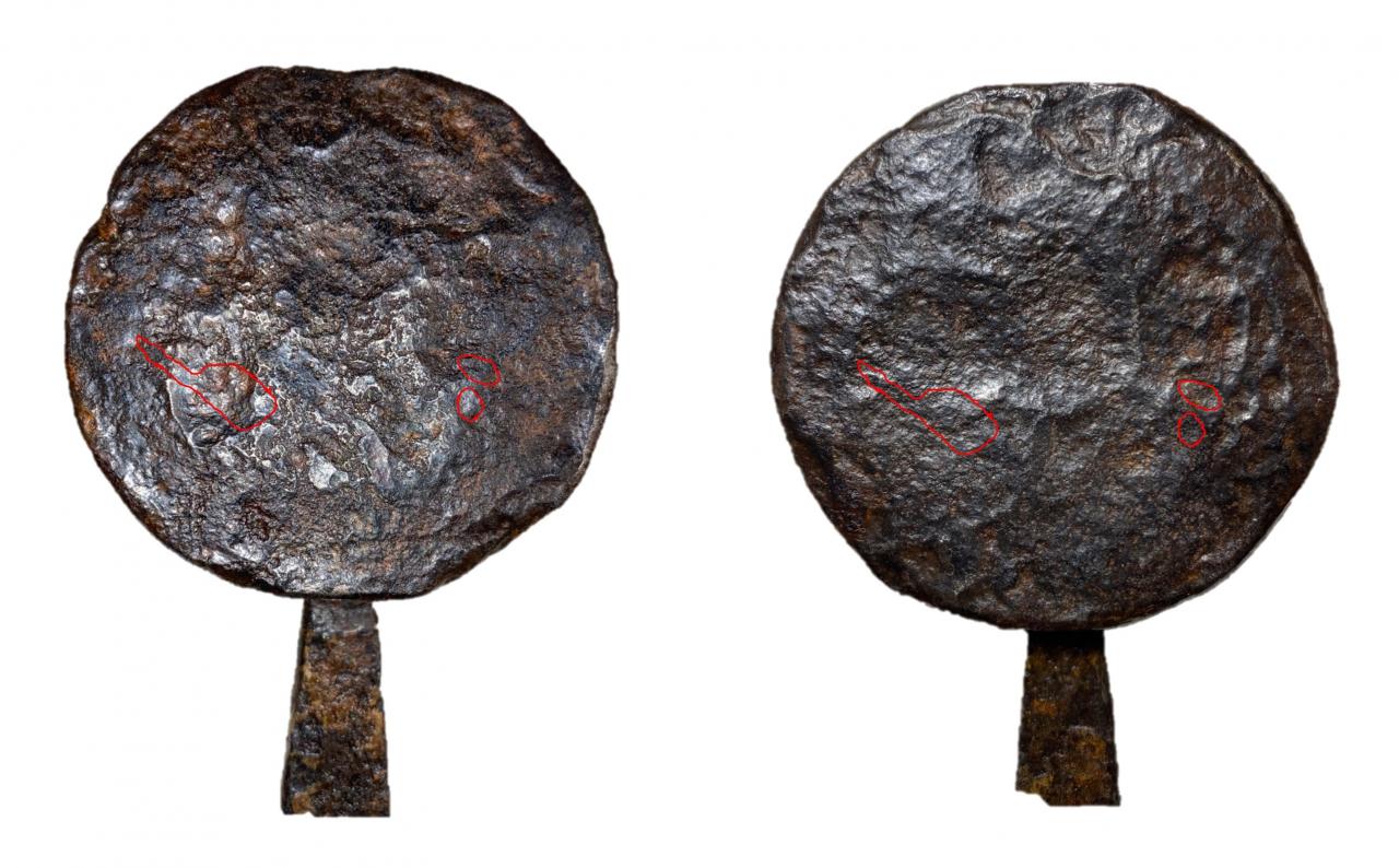

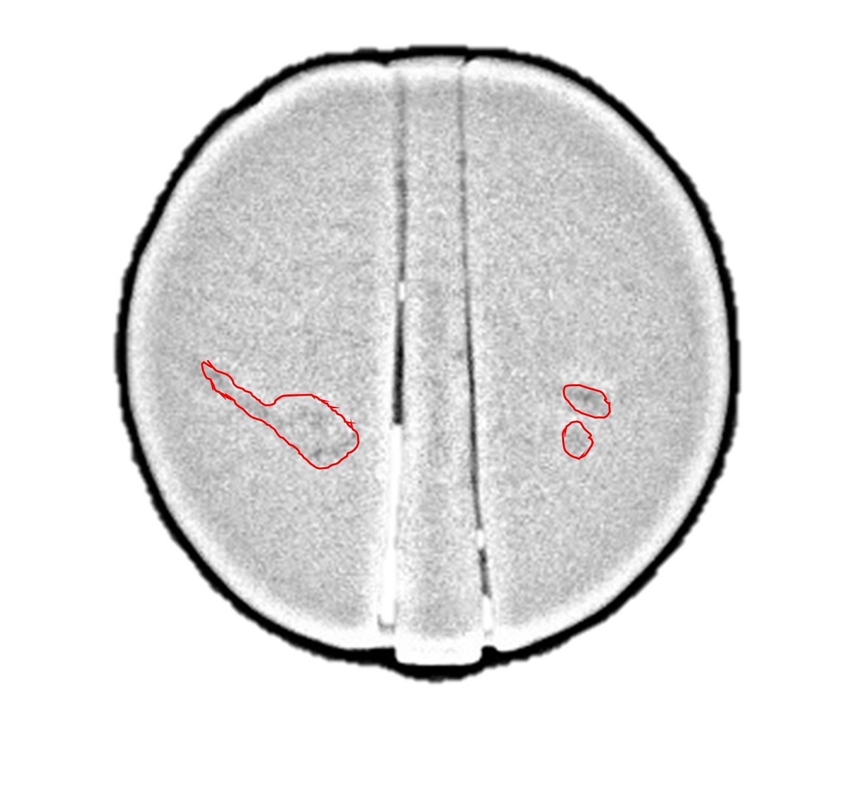

Iīd like to draw your attention to this "chip" mentioned by Teisani in the first reply. as explained this chip is undermined by black oxidation and sticks out. I tried to catch it in a better image and did a small drawing In my eyes this could not only be an indicator for folded steel, but also for some age. But I might be wrong.

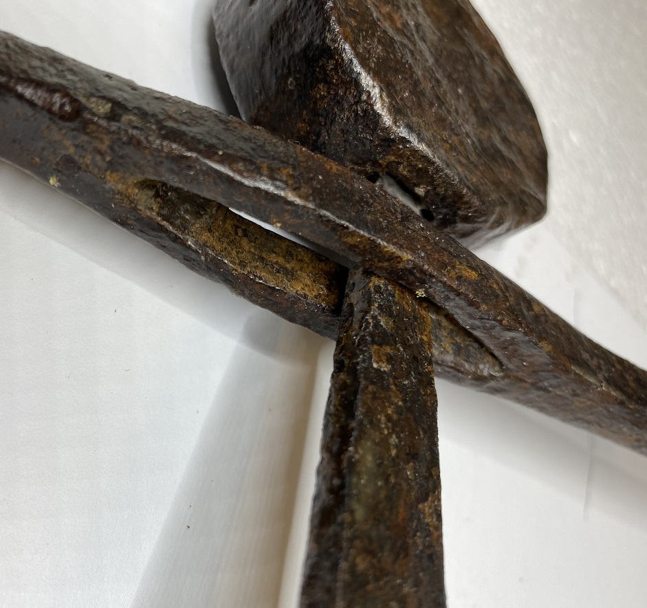

The outer edge of the crossguard wasnīt cleaned propper and remains some brownish-orange adhesion. To me it looks very much like what I know from metal found in a river (I do often search the Rhine for relics when it has low water )
I added some more pictures that hopefully gives a better image of the oxidation / patina.
Regarding the condition: I think it very much depends on the composition of the water (content of oxygen, soil composition etc) as well as when the sword has fallen into it. There is this drawing from Albrecht Durer 1497, showing a person wearing a much older sword (http://www.vikingsword.com/vb/showpo...28&postcount=6). I think swords where used for a very long time.

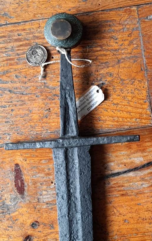

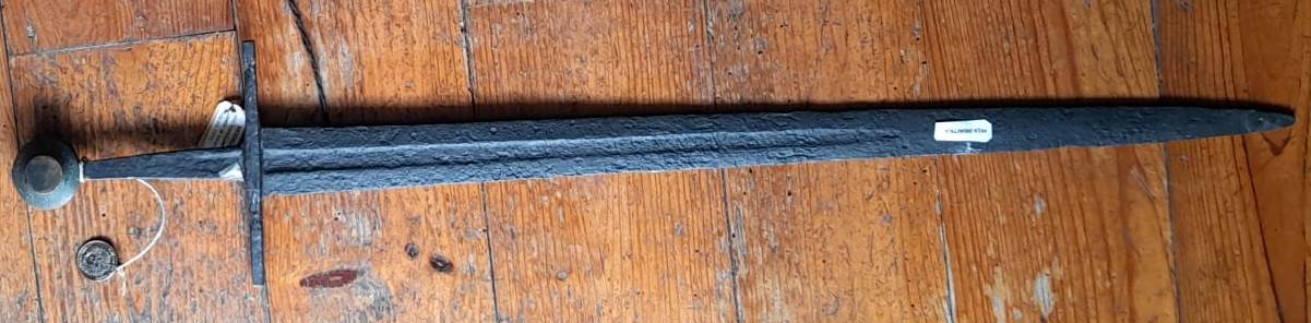

Here is a sword with a similar patination. Sadly there is no background information on it:

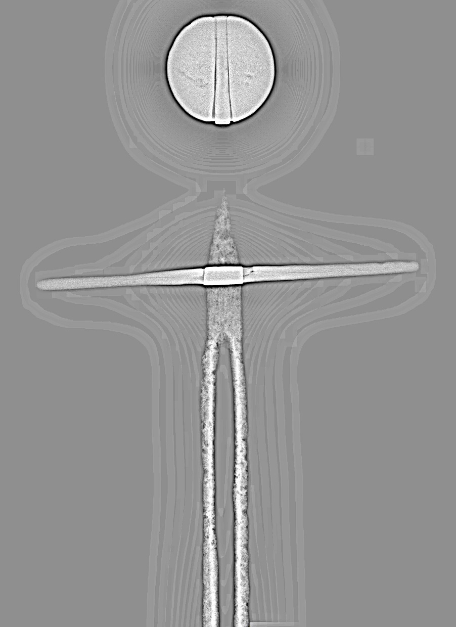

That the patina does not dissolve is a good sign. If you want to be a little more certain, as Lee suggested, you can send a small chip from the shoulder or cutting edge for microscopic examination for inclusions.
However, unfortunately it only says something meaningful if new steel has been used.

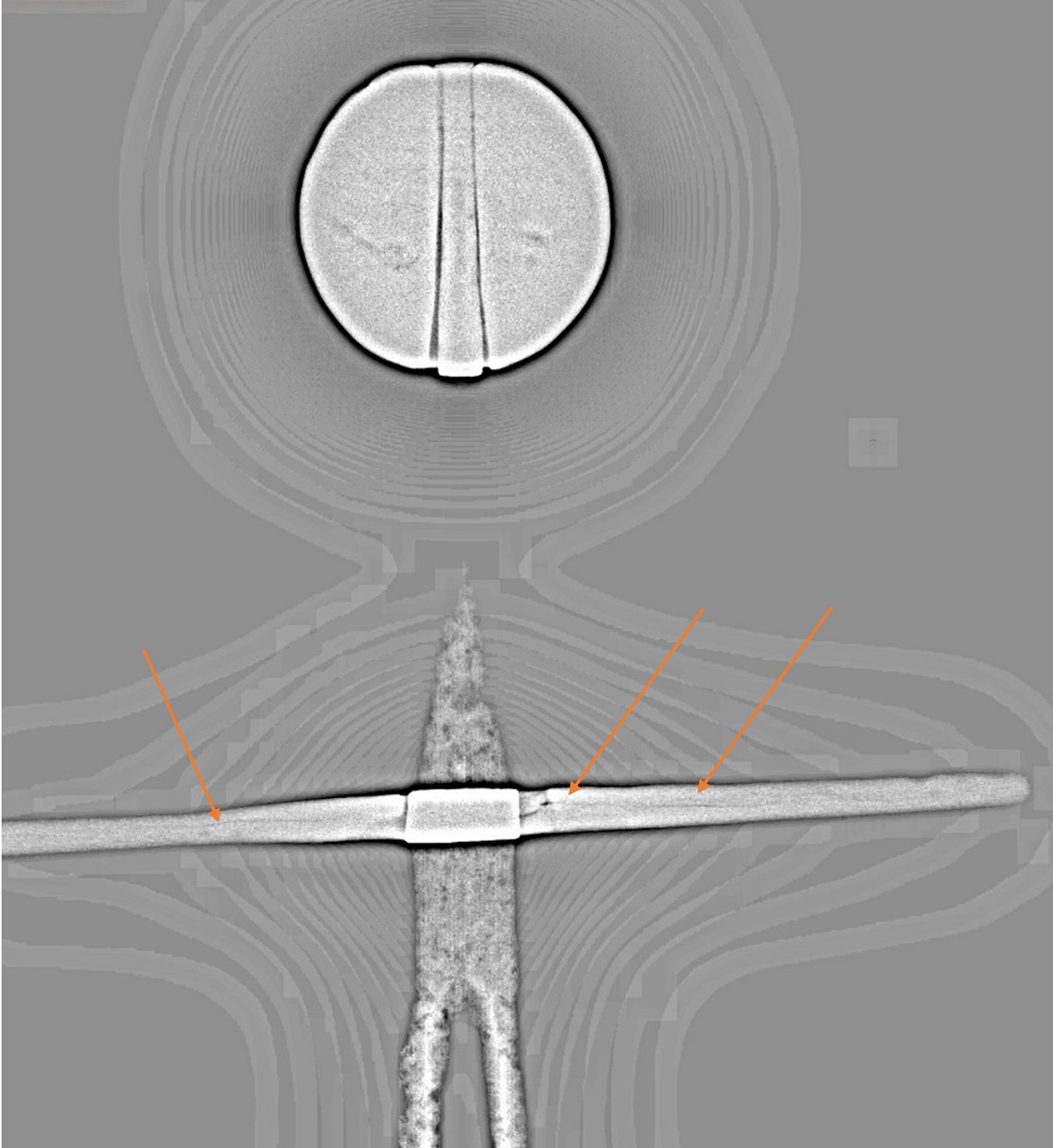

X-ray can also provide more clarity, perhaps inscriptions are visible, including, for example info of the construction of the tang to the blade. Furthermore I would still advise to follow the trail of the story, any additional info will help.

Probably the only way to establish the authenticity of your sword is to understand how these extreme patinas on fake medieval swords are created. Which I assume involves reversing the process of electrolysis used to de rust authentic archaeological finds. This involves dumping the fake sword in a bath of water and washing soda , hook it up to an arc welder and stand well back . The sword is connected to the positive side of the power supply and the negative side to iron plates suspended in the solution. Negative ions (oxygen ) are attracted to the anode, the oxygen combines with the iron and forms the rust. The longer the process or the higher the amperage the more of the iron is etched away. Once pitting has begun some complicated metallurgy takes place which means the pits get deeper creating the irregularly surface associated with genuine decomposition of an iron object. I hope this explanation is in principal correct but if it isnt I’m sure someone more knowledgeably will correct me.
So far so good. The sword will have an orange rust surface which is unlikely to be convincing unless its being offered as a recently excavated find. Options then are to revere the polarity to strip off the recently acquired rust in which case the appearance will be an object that has been electrolytically cleaned. Alternatively remove some , but not all of the rust and use a rust converter (tannic acid) to chemically convert the reddish iron oxides into bluish-black ferric tannate, a more stable material associated with old well established rust.
Rather than comparing the patina on your sword to authenticated examples it might be useful to compare it to the patina on obviously faked examples . A trip round the net will provide plenty of spurious objects that have been aged in this way . Bradfords auctioneers has some good examples of genuine fake medieval swords and helmets. It might be possible to see if there are any minute differences between naturally occurring and electrolytically simulated ageing that might tip the balance one way or other.

Old 15th February 2024, 08:56 PM   #27
AHorsa
AHorsa's Avatar
Join Date: May 2014
Location: Rhineland
Posts: 393
Dear All,
today I had the opportunity to do an x-ray and Iīd love to share the two findings of this analysis:
- the guard is folded
- the black structures (less dense material) on the pommel do not correlate with corrosion pittings. My assumption is, that this could be impuritises or inclusions. Maybe the carbon was not hammered out proper of this "lump" of steel?
But I have no idea if this means something. Maybe one of you can tell more on it.
Kind regards
Andreas
AHorsa is offline   Reply With Quote
Old 15th February 2024, 09:32 PM   #28
Raf
Raf's Avatar
Join Date: Nov 2013
Posts: 252
I would be happy with that. I was impressed by the way the pommel has been fitted so closely to the tang. As if the pommel had been drilled, heated and driven on to the cold tang. I dont know wether a faker would bother with this kind of invisible detail.
Old 16th February 2024, 01:44 AM   #29
Lee
Lee's Avatar
Posts: 998
Just as the crossguard shows darker (more radiolucent) areas of less density suggesting old weld or fold lines from the forging process, the pommel also likely has such areas within its mass that appear as these darker spots in this view, but might look more like imperfect welds if the pommel were rotated 90 degrees.
Also, the blade appears to show more corrosive loss than the hilt elements or tang. This may reflect a different composition of material and perhaps protection for a while longer by a covering guard and is not unusual in my experience.
