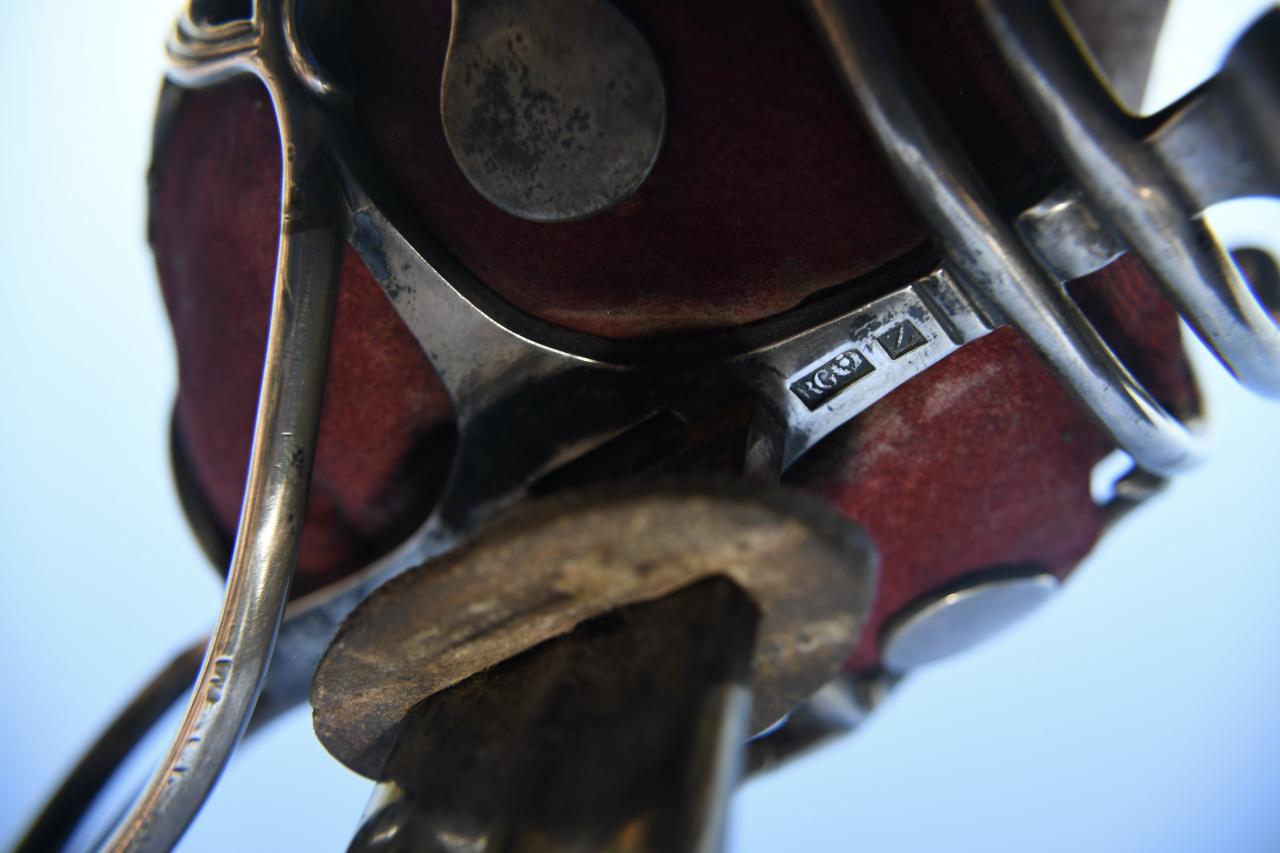

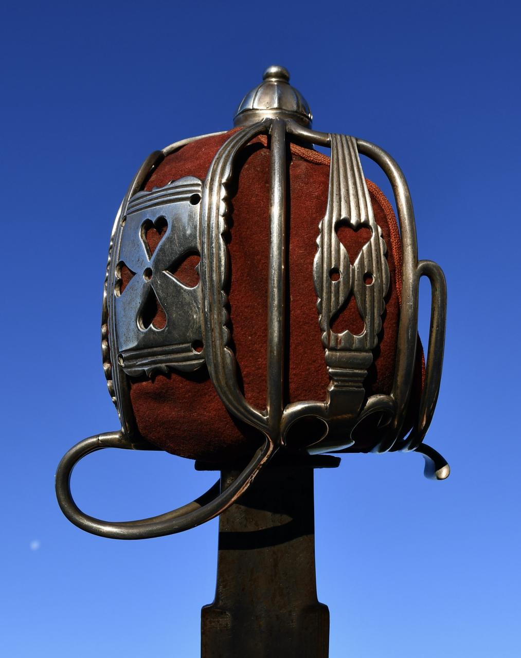

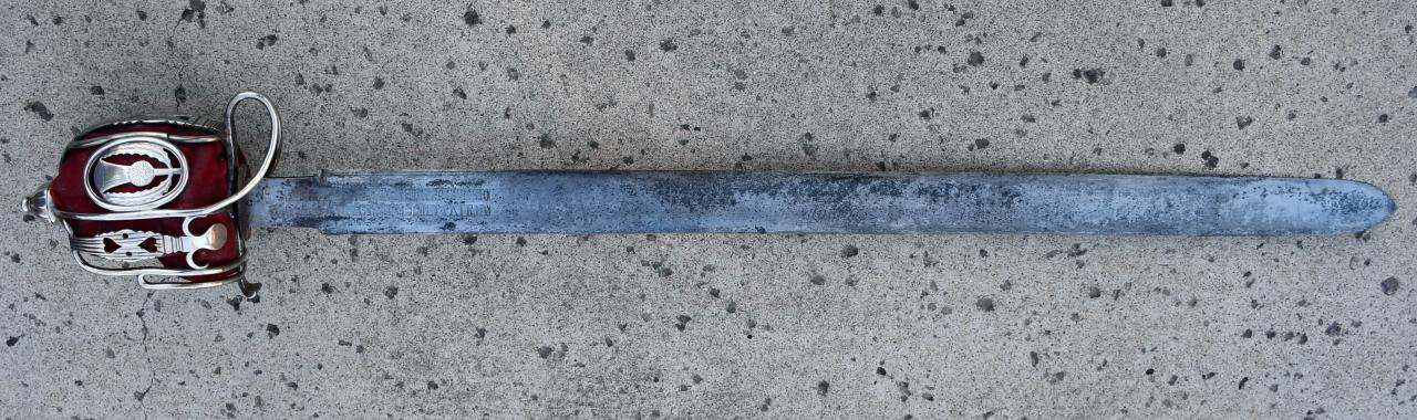

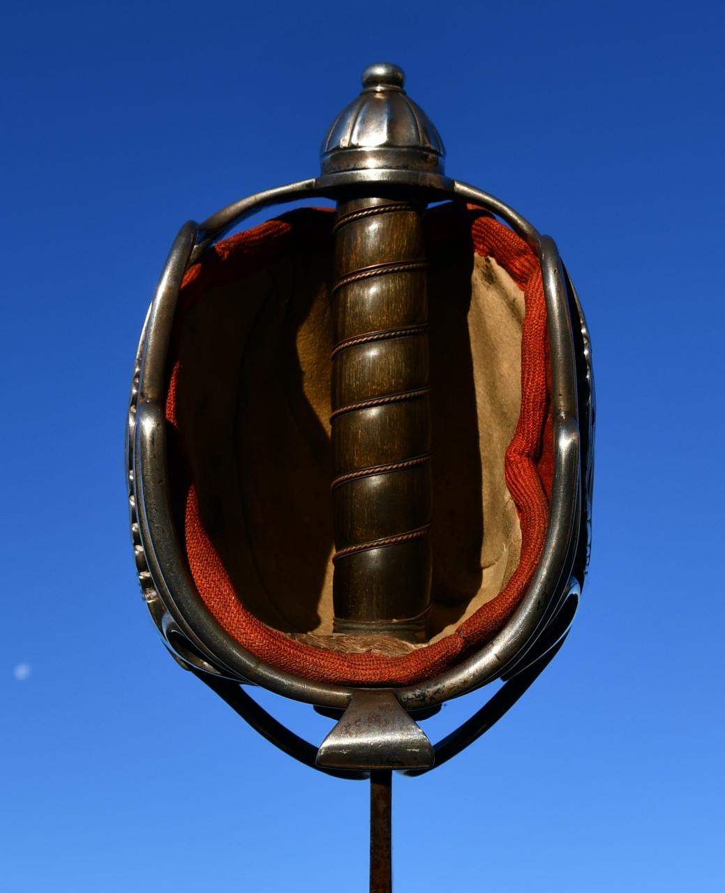

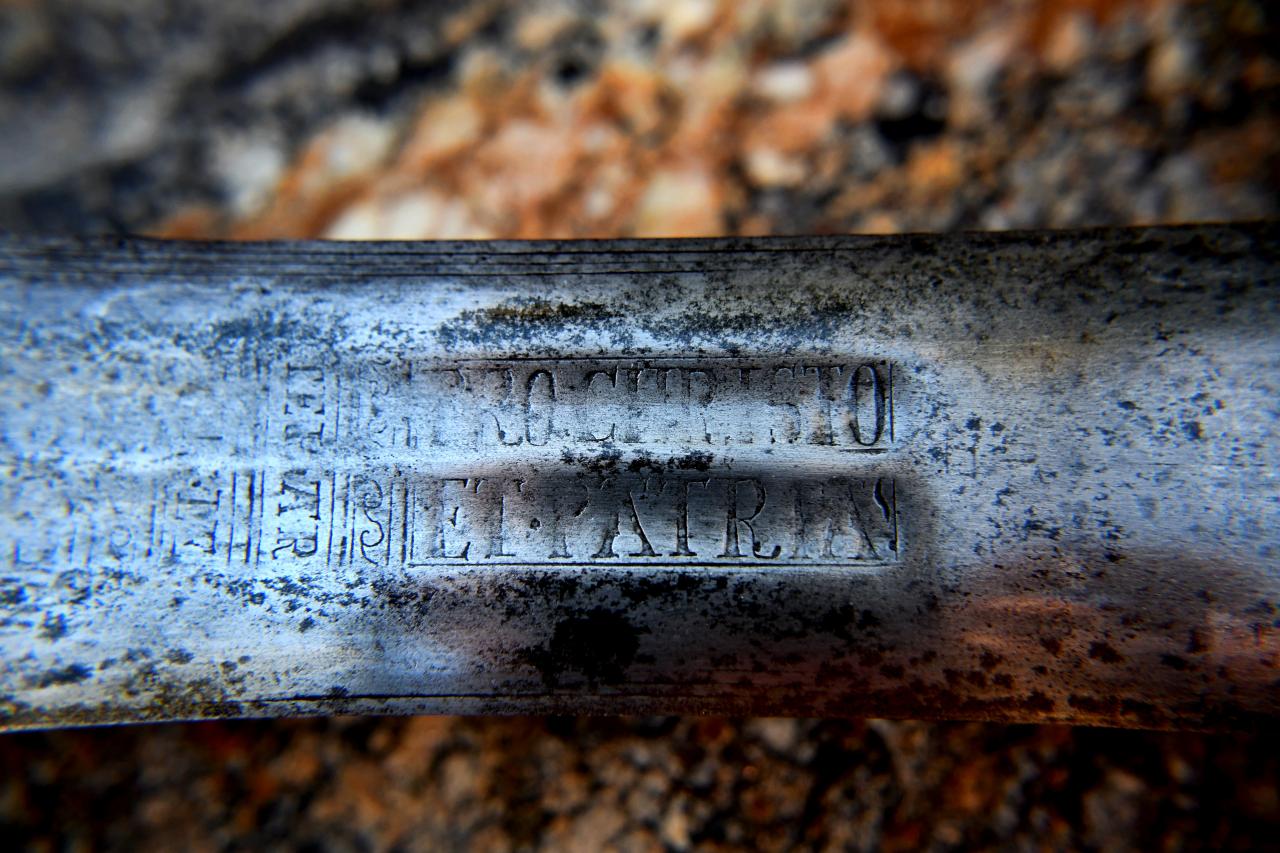

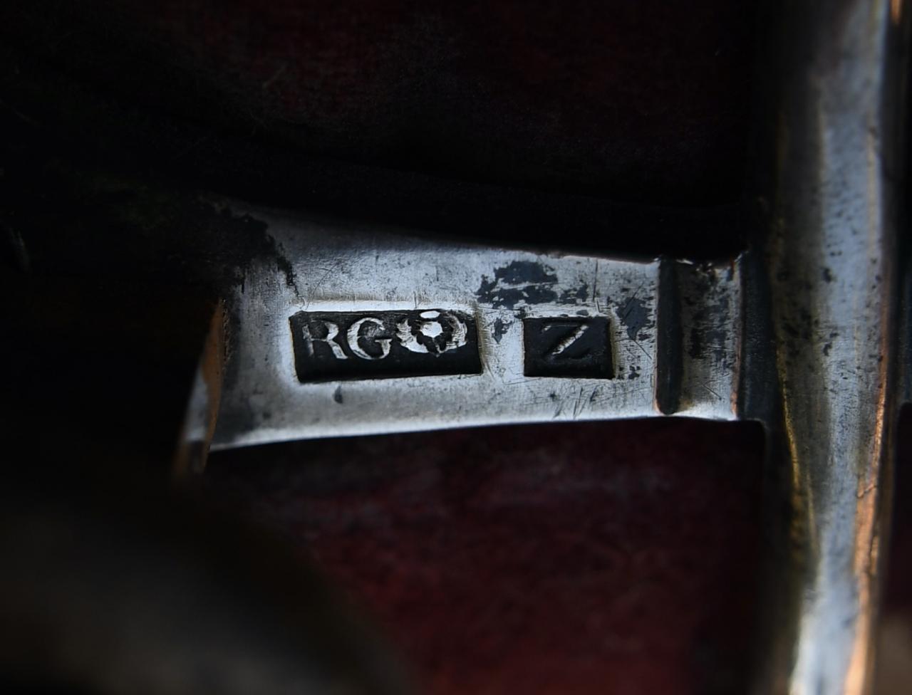

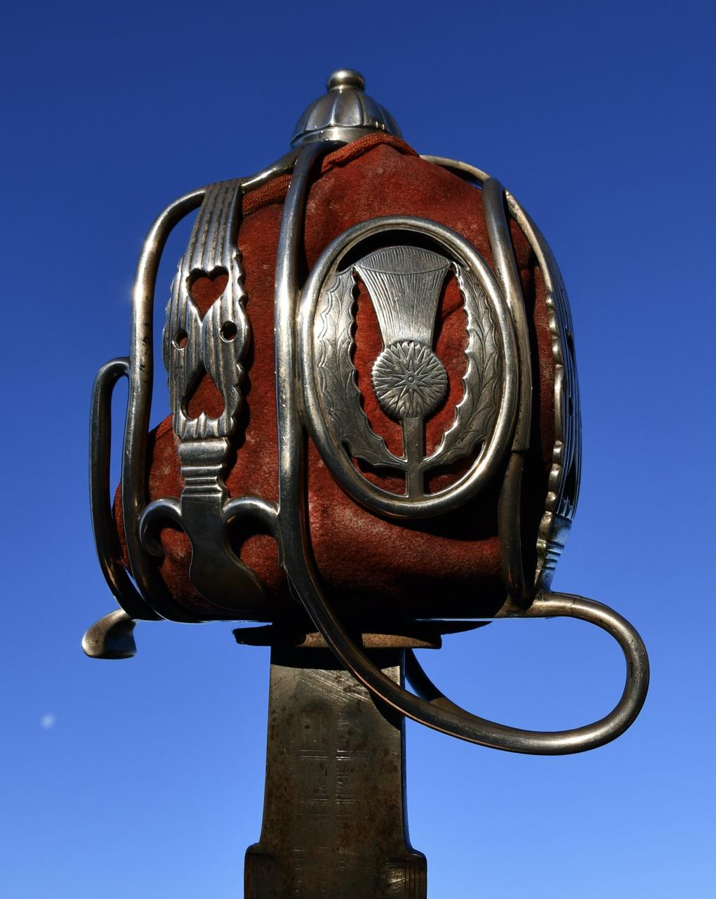

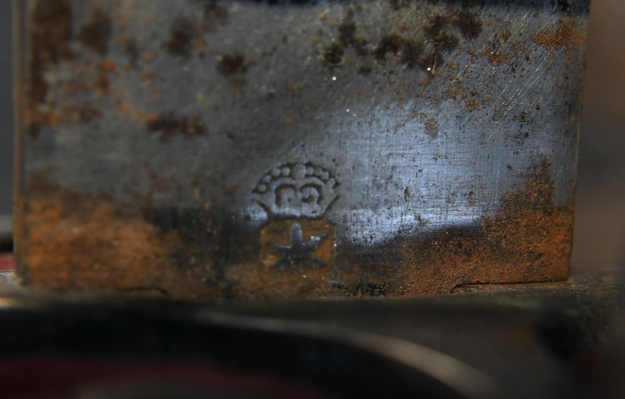

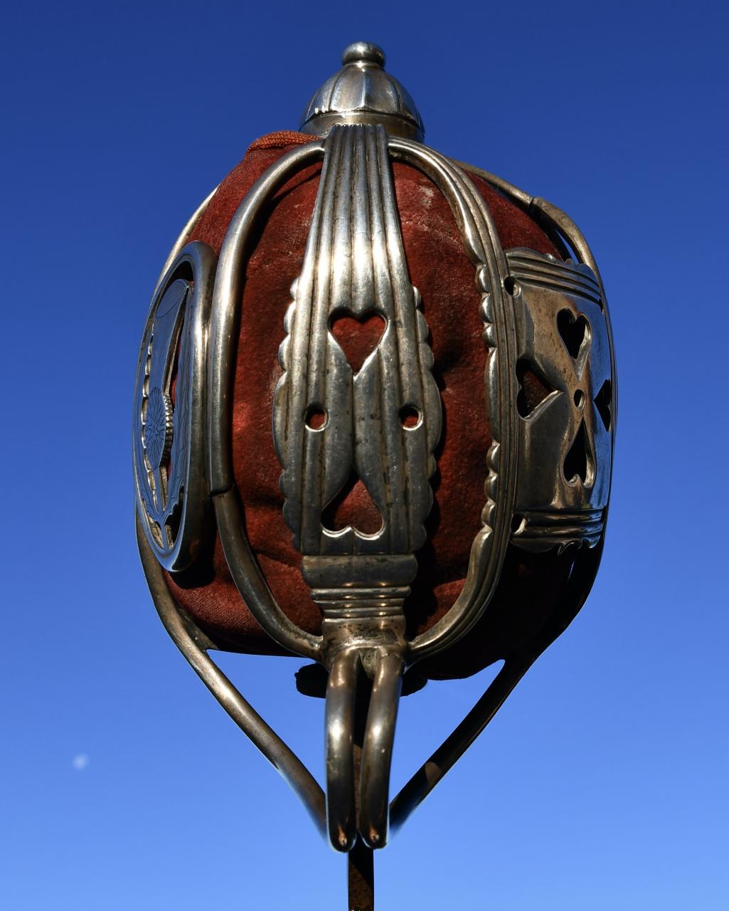

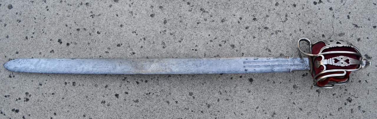

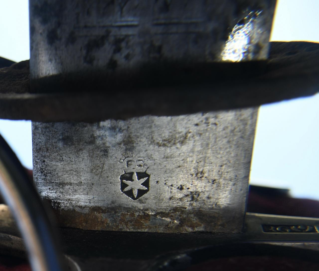

I recently acquired an interesting basket hilt sword from an old American collection. Possibly an older blade married to an more recent hilt. The owner (deceased) purchased it in the 1950's according to his family. Silver hilt marked with a Thistle preceded by the letters "RG" and the letter "Z". The hilt is 7.5" X 6.25" X 4.25". The blade is 36.25 inches long by 2 inches wide with 7 inch double fullers on both sides and pencil engraving adjacent to the fullers. A Crowned 6-point star on both sides of the ricasso. Within the fullers on one side of the blade engraved in large letters "PRO CHRISTO ET PATRIA". Engraved crosswise in smaller letters and much worn "FIDE SED CUI VIDE" and "NEC TEMERE NEC TIMIDE." My guess is that silver hilt are all unique. Any insights or suggestions are welcome!

https://www.silvermakersmarks.co.uk/...tters%20Z.html
https://silvermakersmarks.co.uk/Make...urgh-R.html#RG

What an interesting sword and great to see another silver basket hilt. As you say I also suspect the basket is later than the blade. Fortunately it is hallmarked which should help give us a more precise date.
I'd recommend that you post photos of the basket, sword and hallmarks on this forum, www.925-1000.com - Scottish Hallmarks they are the experts in my experience.

I'm not sure about the blade but I have a match for the maker of the basket at least. This one was a good brain teaser to find. I found a mention in "The Silver Spoon Club" magazine from 2006 that lists a spoon made by a Robert Gordon of Madras circa 1812 with a RG and thistle mark with a Z stamp. They even had a a picture of this stamp.
Your sword is getting more interesting by the minute!

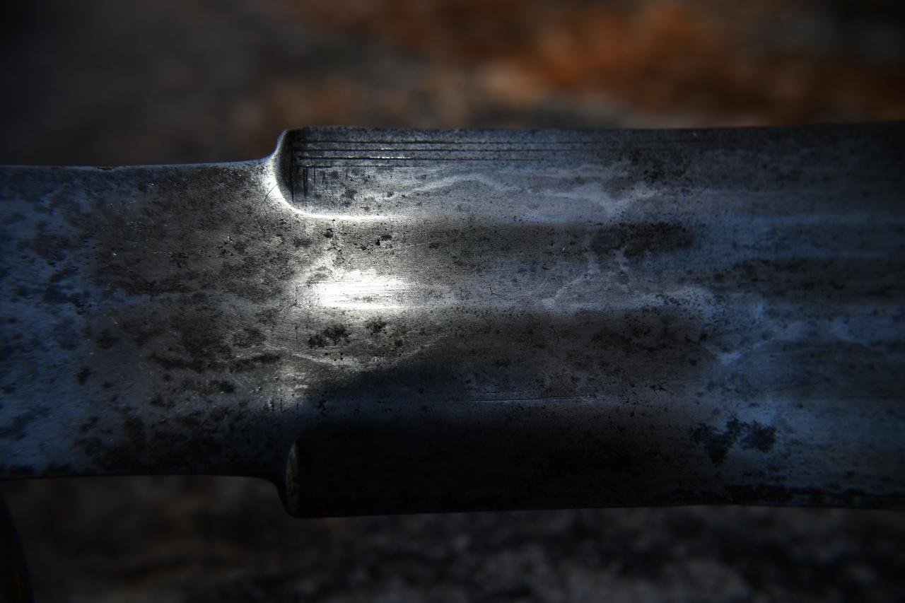

So perhaps a remarkably made Scottish basket hilt in silver produced for an officer or someone of notable standing in Madras in the periods established by the hallmark. It is hard to say what this apparently heirloom blade might be from, but obviously the inset ricasso as seen in rapier blades suggests it is from an entirely different type of sword .

I truly appreciate the insights - what a great forum! Does anybody recognize the crowned star mark on the blade by any change?

Jim those are some mighty kind words. And I think you are right on the money that the recessed ricasso points to something more along the lines of a 18th or 17th century rapier/calvary sword/"insert favorite variation of the word here". Something German maybe? As for the marking I haven't turned anything up but maybe someone has one of the more extensive catalogues on hand.
Are there any other potential markings on the ricasso besides the crowned star? Even if they are faint.

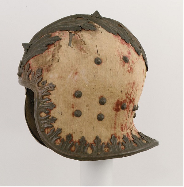

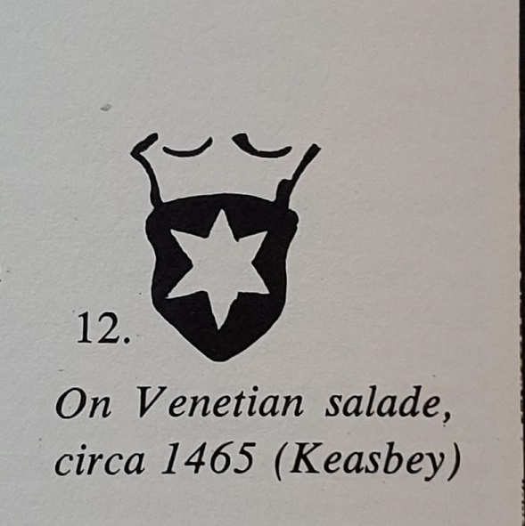

I found the marking in "Small Arms Makers", Robert Gardner, 1963, p.360;
It is to an unidentified armorer in Venice, from one found on a 'salade' helmet c. 1465(pictured). It is important to remember that armorers attended to overall outfitting with armor as well as weapons.
The attached image of the mark cites as a source 'Keasby' which is unknown to me (not in bibliography).
The recessed ricasso does seem unusual on this blade, which may be of course an Italian arming sword, but perhaps with a developed guard system of this period.
This may be a heirloom blade acquired by a Scot in the service of the Stuarts in Italy, and held by an ancestor in distinguished lineage, who likely had the sword itself (or perhaps just the blade?). Perhaps he was serving in India and had the blade mounted in this traditional basket hilt in silver.
Another possibility would be that the sword blade was already in India, as European trade was prevalent of course, and Italian swords, blades etc. (typically Venetian, key in Italian trade) were often notably acquired.
With the inscribed phrases, the primary of course PRO CHRISTO ET PATRIA (for Christ and country);
but FIDE SED CUI VID (loosely, 'have confidence but be careful in whom you trust' ) was a favored phrase notably on the armorial bearings of the NICOLL family).
The NEC TEMERE NE TIMIDE (= neither rashly nor timidly)
Clearly a blade which would have been treasured by a Jacobite owner, as well as by his descendant.
