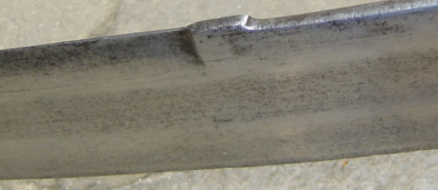

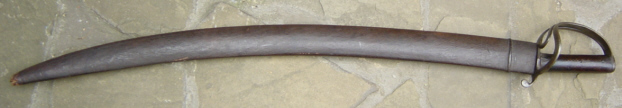

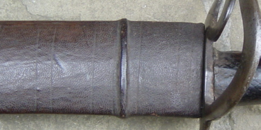

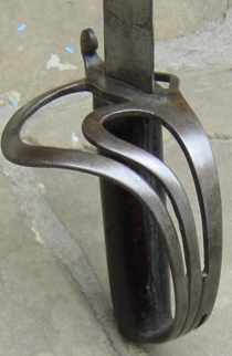

Not really my thing this but when you have OCD these things happen. Heavy blade, wood grips, leather covered wood scabbard. No marks!! Wide fuller on both sides. Very nice balance to a heavy and quite flexible bladed weapon. Just a little damage to the scabbard tip . Some of you seem a little keen and knowledgeable about this sort of creation, I do not really go for service stuff so any info about it would be nice to hear.

I got this sword this morning, it was bit of an impulse buy. Now I have had time to look in some books I think it is the Indian Army version of the British Cavalry troopers 1853 saber. Obviously the blade is made to the local fashion.

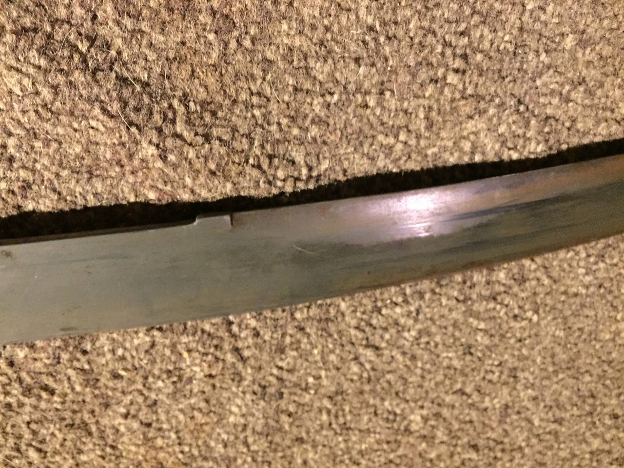

Is there a name for this feature on the spine where the false edge begins ?
Looks like a good no nonsense weapon Tim; fully functional beauty .

The few books I have on military swords only have a slight mention of Indian Army swords except the 1903 or is it 06 pattern adopted by all English speaking countries. I can find no mention of the piece before the false edge. The sword has certainly see some action. Border line ethnographic but tells a story.

A nice blend of east and west The blade seems to be typical tulwar style in design. If you really hate it I would be glad to take it off your hands
It obviously was forged during the manufacturing process.......but is it to re-inforce the spine at the point that the back becomes a false edge....I haven't seen this feature before.

While the progression of British military regulation pattern swords was well documented and has very good resources identifying them ("Swords of the British Army" by Robson, the most recent and comprehensive), the swords of the British native cavalry units are only vaguely described.
It is true that Wilkinson-Latham is one of the famed sword making dynasty in England, and as others, such as John Wilkinson, who has also written on these weapons, have had considerable resources which describe the historical data involving that firms extensive production.
This sword certainly is in the style of the regulation M1853 cavalry sabre, although it is of course not one of the regulation issue examples. There were examples of these produced for native regiments in India, one group having been produced by a Rodwell & Co. I think around the late 19th c. but I do not have details handy at the moment. The typical colonial sabres made in around the 1880's for some of the cavalry units were made in the form known as the 'gothic hilt' and were patterned after the M1821 light cavalry sabre with three bar hilt.
It is also known that the stirrup hilt sabres of the M1796 light cavalry sabre, with the hatchet point, were produced also in the latter 19th c. by makers who consigned to supply forces in the Raj, one such firm was J.Bourne & Sons. These stirrup hilt sabres were still in armouries as late as the 1930's
This sabre is likely end of 19th c. to early yrs 20th and as noted the 'step' preceding the false edge is most interesting, forming a form of 'choil' on the sharpened back edge.

Jim I can see the feature "choil" working on a knife/ survival knife, being very handy, but I cannot see that function on a sword. Is it possible that the chiol on the sword is more of a sighting device to ensure the best delivery of sword cut. By the way google images "British India army cavalry" some interesting pictures, skinners horse ect.

Hi Tim,
Without martial arts expertise it is difficult for me to offer qualified opinion on practical application of such features, but it would seem most likely it was simply to strengthen the sharpened back edge. It is interesting to see the application of the yelman on what would certainly be a latter 19th century sword blade, at least in the mounts of this example. I am still trying to recall where those other '1853' patterns were used, I think it was Baroda province?

On the Indian/Afghan swords I have handled with this feature it has always struck me that the sweat spot of the blade was just an inch or two below the visible spine projection, so I think your theory could be possible Tim.
Another possibility that occors to me is maybe you only want a sword to penetrate to that depth ? any more is a waste of both sword blade & your energy?
Perhaps its also like the cross bar on a boar spear? in a more minimal fashion? you dont want a determined but run through man coming at you up the blade beyond that point?

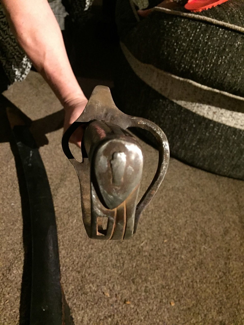

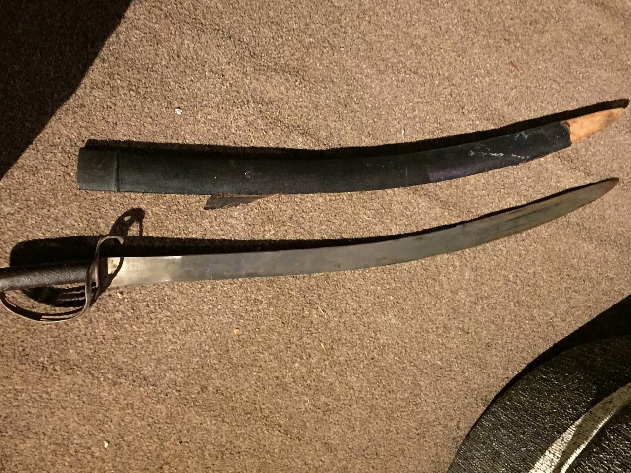

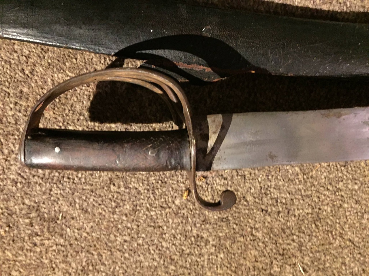

Hello, I realise this quite an old thread, but I have just come into possession of the exact same sword and wondered if anyone knew the history of the one in this thread

More pictures of this sword would be helpful I think.

the M1853 was indeed used as a select pattern for certain units. The Wilkinson Latham book lists these in its survey of chosen types for the units. It is a shame that Mr. Wilkinson Latham has dropped out of the forum scene as SFI has gone defunct.
There is no doubt there are others of this India made pattern out there and he would know of them.

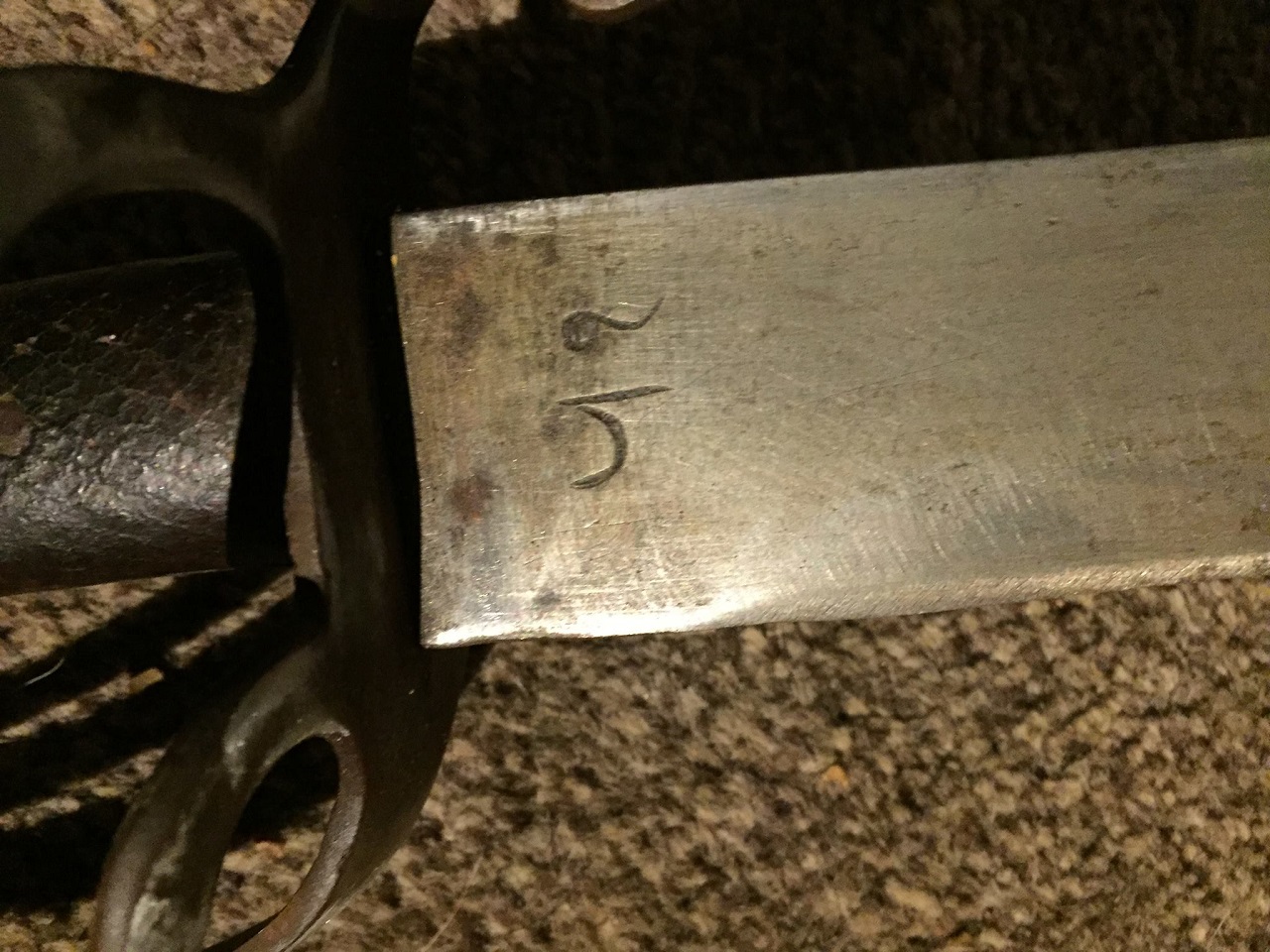

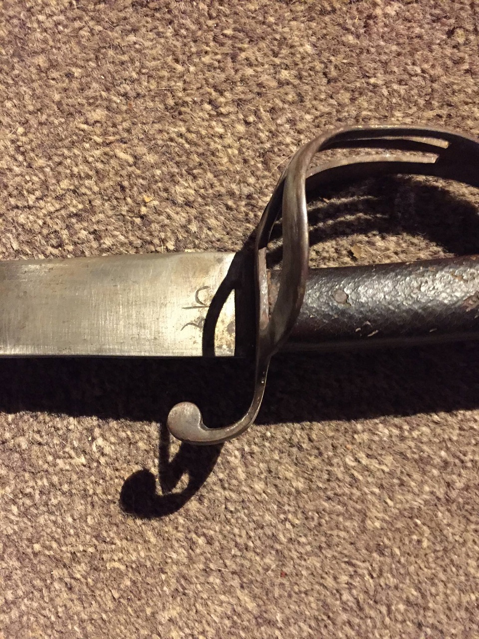

I have just worked out how to add pictures, poor show when a lot of my job involves IT, I hope you like them, I have spoken to Jim who has been brilliant with bringing his encyclopaedic knowledge to bear

I believe the marks on the blade next to the hilt are the Gujarati number 51.
Sincerely,
RobT

I think thats right, it would refer to the rack number

Excellent Rob!!!
That makes perfect sense!! and thank you for spotting this,
I have found that pretty much there were two units using the M1853 pattern hilts per R. Wilkinson-Latham "Pictorial History of Swords and Bayonets" (1973), ...these were one listed as 'Fanes Horse' which is shown as 17th lancers.
This unit was situated in Bengal and actually the unit known as Fanes Horse was the 19th Lancers. These were both Bengal units and I have always thought they used the1821 type hilts.
On the other one, 31st Duke of Connaughts Own Lancers, which was commanded by the Duke of Connaught, who was also governor of the Bombay Presidency.
This huge administrative region of the British Raj, extended from Bombay all the way to Sind which of course included Gujarat mid way in the time period we are considering, c. 1880-1905,
The Gujarati numerals would have likely been rack number.

Happy to help out. The same sort of thing goes on with a lot of the Royal Nepalese khukri (see Guns of the Gurkhas by John Walters). The battalion abbreviation plus the battalion unit and weapon numbers are frequently inscribed on the spine. Save for the 6, 7, and 10, the Devangari numbers used on the khukri are pretty much the same as the Gujarati numbers. As an interesting aside, it would appear that the so called Arabic numbers were actually a Hindu invention and that invention also included the concept (and digit) of zero. The Moslems picked-up the numbers from the Hindus and in turn gave them to the Christians.

I meant to say that the Gujarati and Devangari numbers 6, 7, and 9 are dissimilar. Sorry about that.

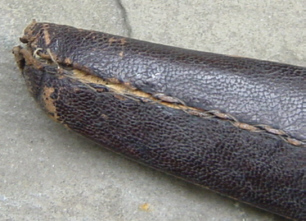

Very good. here we can see the late 19th century Lancers with the same sword. Front row second from the left.
What a shame that the owner or owners after me should damage the scabbard even more rather than try to repair or re-tip with metal.
