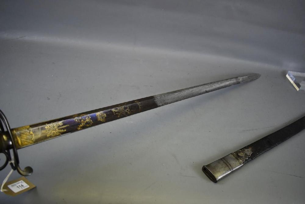

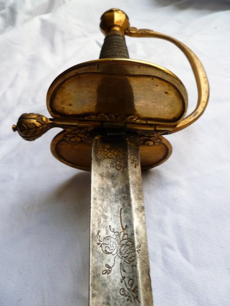

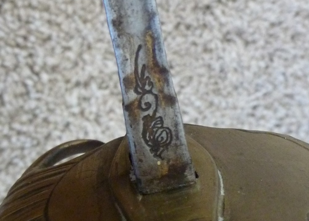

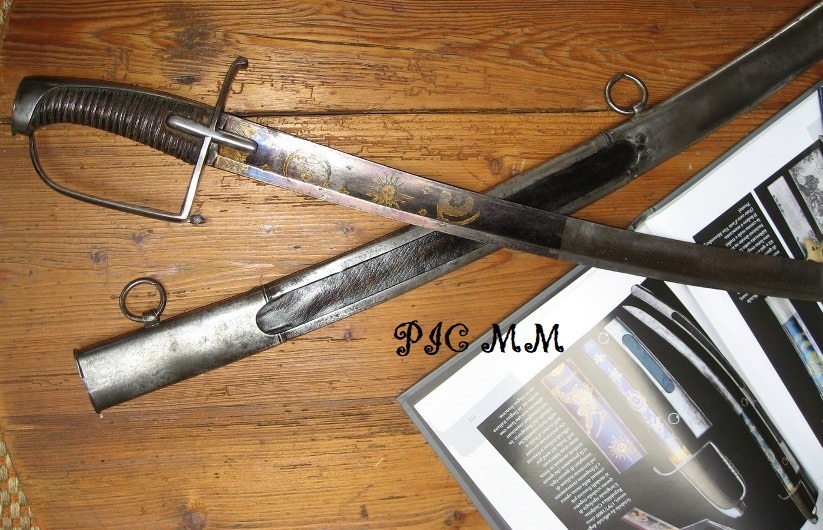

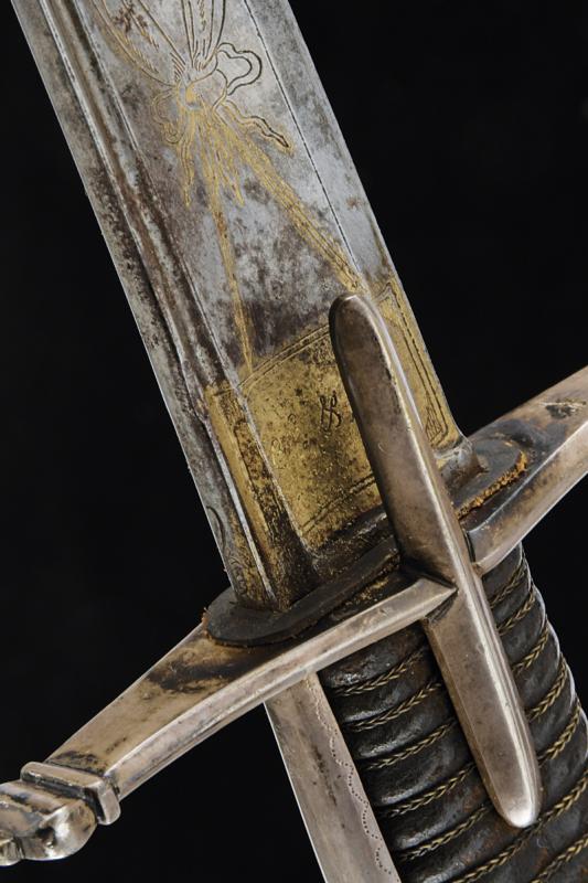

Solingen in Germany has for a very long time been a major manufacturer and exporter of sword and knife blades. These blades were exported far and wide; sold to local cutlers who would mount them on hilts in the local fashions.
While some blades were visibly marked as having come from Solingen, others were not leaving us to make educated guesses of their origins based on decorations and styles.
Two common clues are the 'cartouche' on the ricasso and the presence of a "Rose" on the blade spine at the base. The Rose seams to have appeared in the latter half of the 18th Century and disappeared in the 1820s when the decoration styles changed as well.
Pawel Bartela askes if this change is related to the abolishment of guilds in 1809 by Napoleon:
One of the Solingen marks on the back of the blade. Do you know sabers from the 1820s and later with such a sign? Does the end of the marking have anything to do with the dissolution of craftsmen's guilds in Solingen by Napoleon in 1809?
Decree of March 31, 1809 in Dutchy of Berg (Solingen). [https://wiki.genealogy.net/Patentensteuer_(Westfalen)
International Sword Collectors | Facebook Group
While I don't know the answer, it does appear from known examples that the Rose is missing from blades after the 1820s.
It should also be added that the makers at Solingen were very accommodating and happy to apply marks to their blades in line with their clients' needs. Examples of this are the blades imported by Runkel to the UK between 1780 and 1808. These are marked with his name prior to them being engraved and finished with blue and gilt decoration.
Below are examples of swords from my collection with Solingen made blades that pre-date the change in the 1820s:

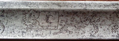

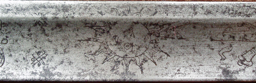

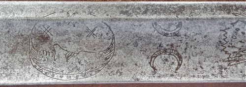

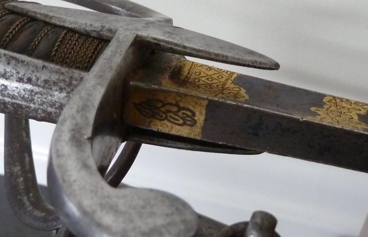

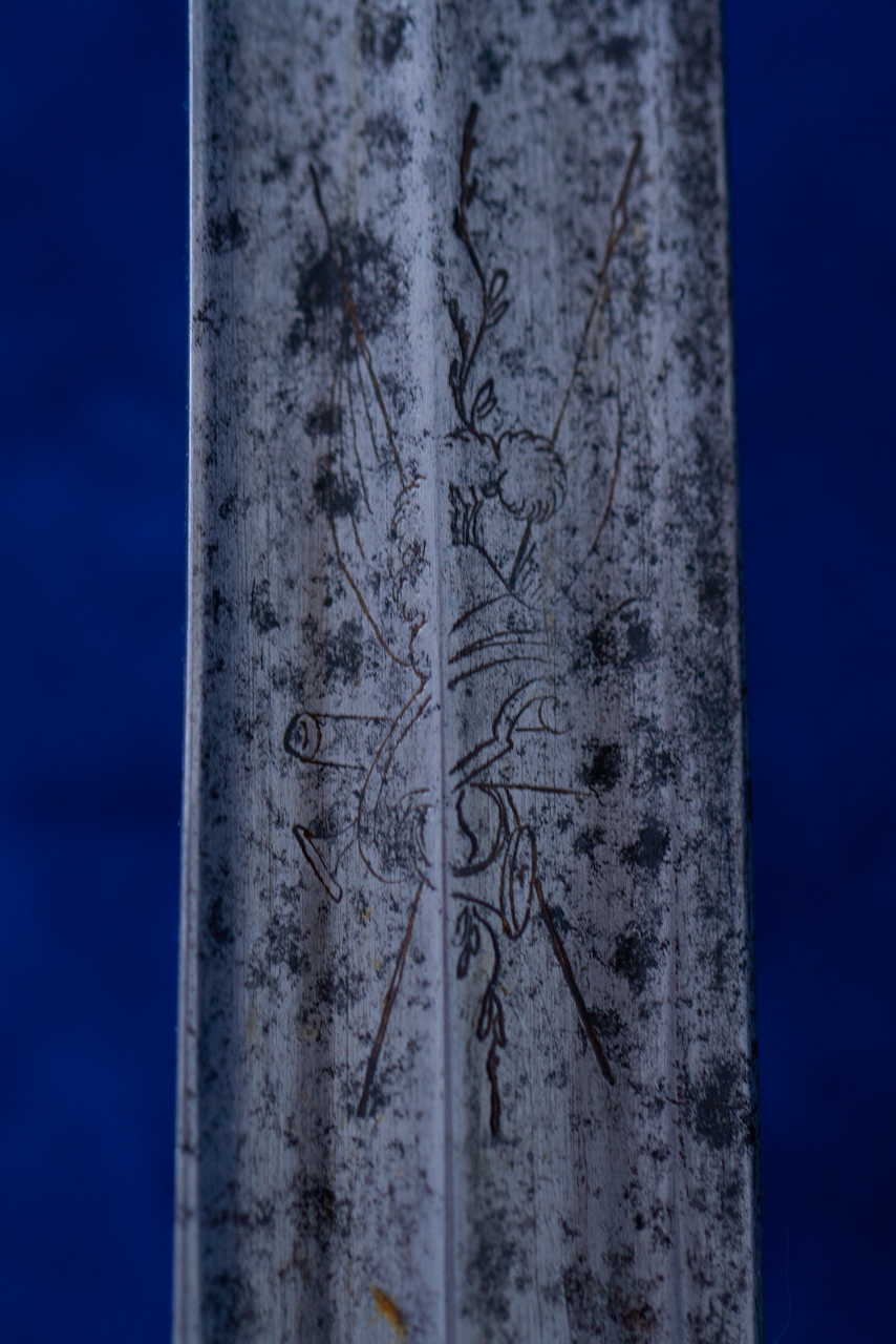

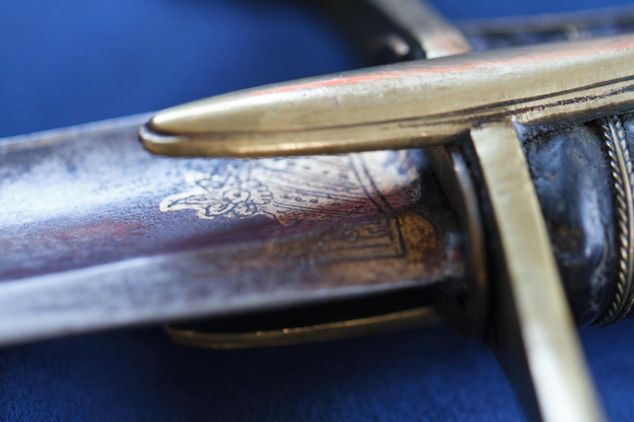

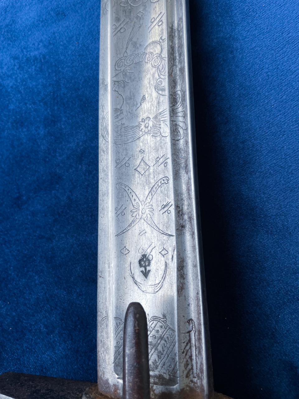

Example of the Solingen Cartouche and 'talismanic' decorations
Name:  Cote de Melon Light Cavalry Officers Sabre 13.jpg

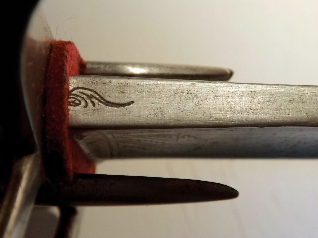

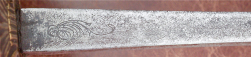

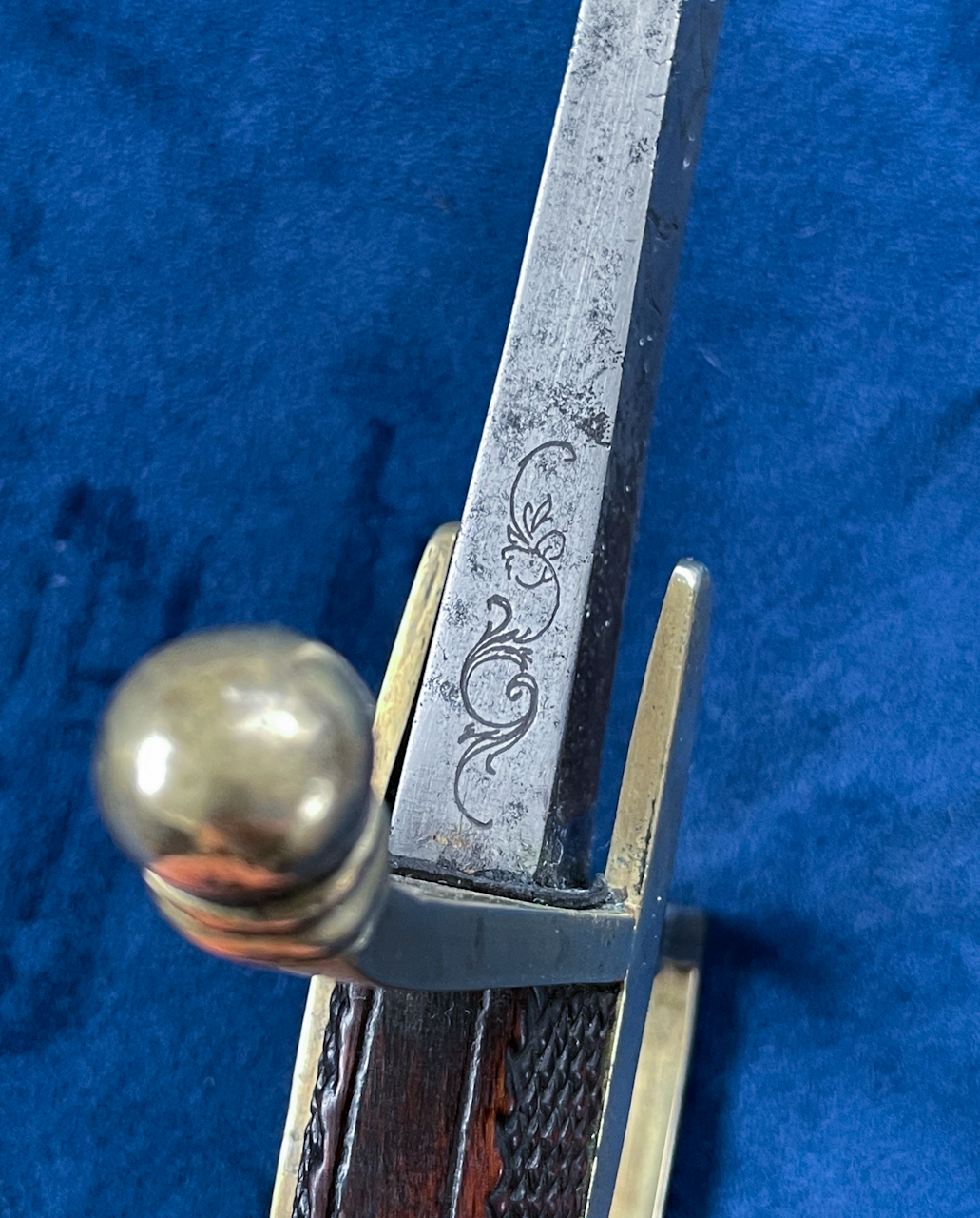

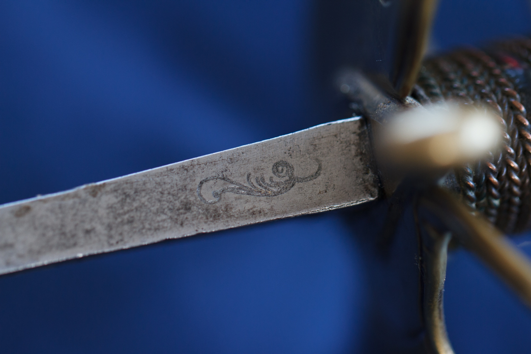

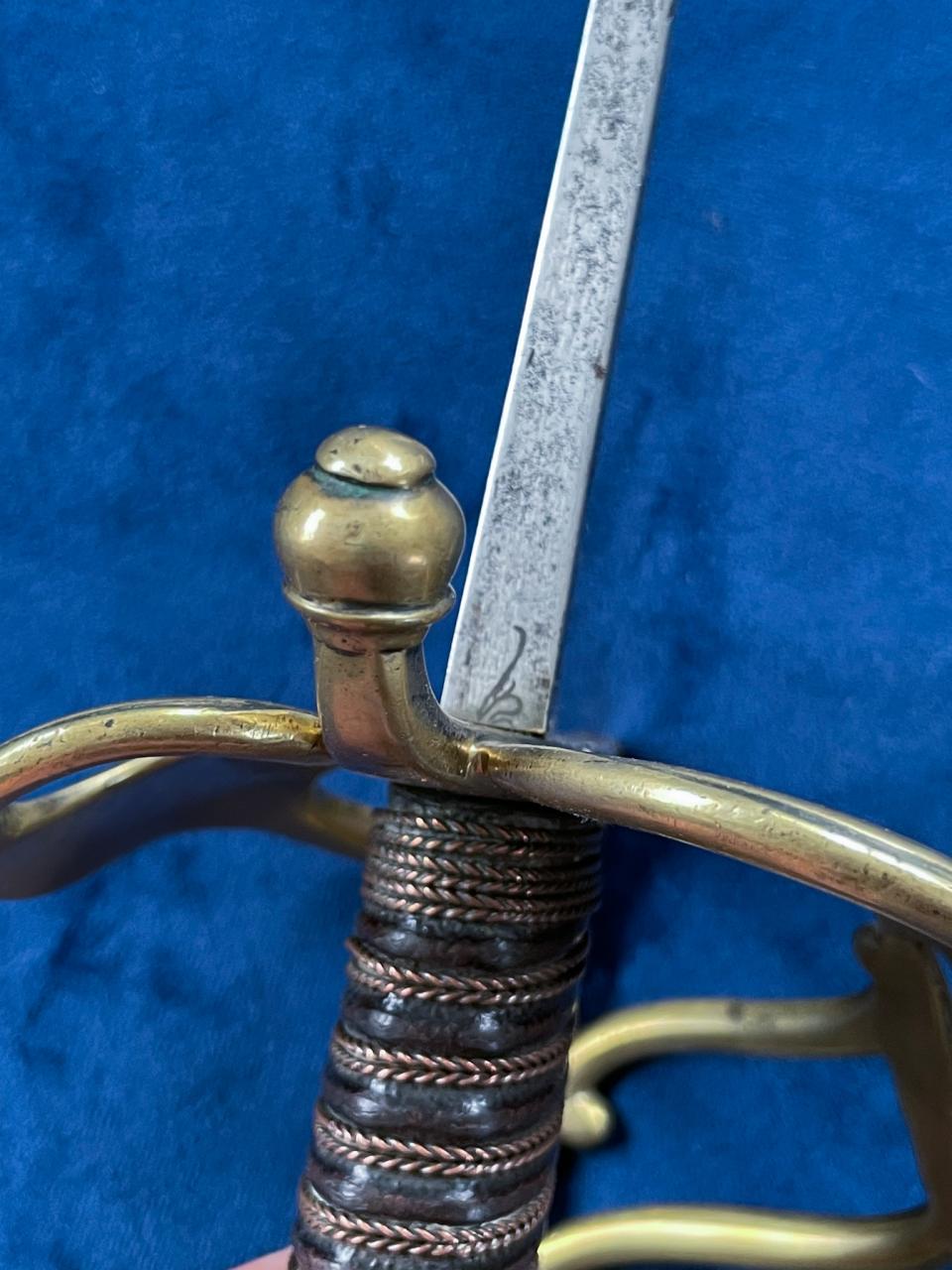

"Rose" Mark
Name:  Cote de Melon Light Cavalry Officers Sabre 16.JPG

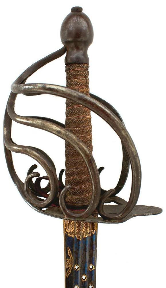

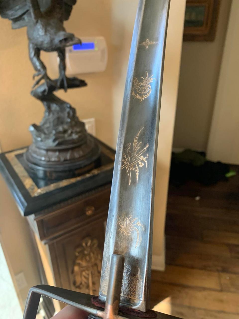

French 'Garde de Bataille' Heavy cavalry sword:
Name:  Carabinier Officers Sabre ā Garde de Bataille 01.jpg

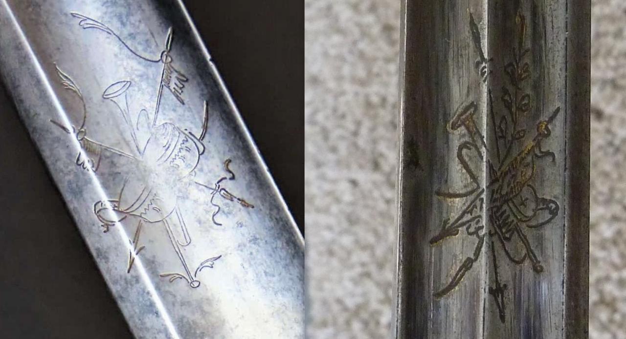

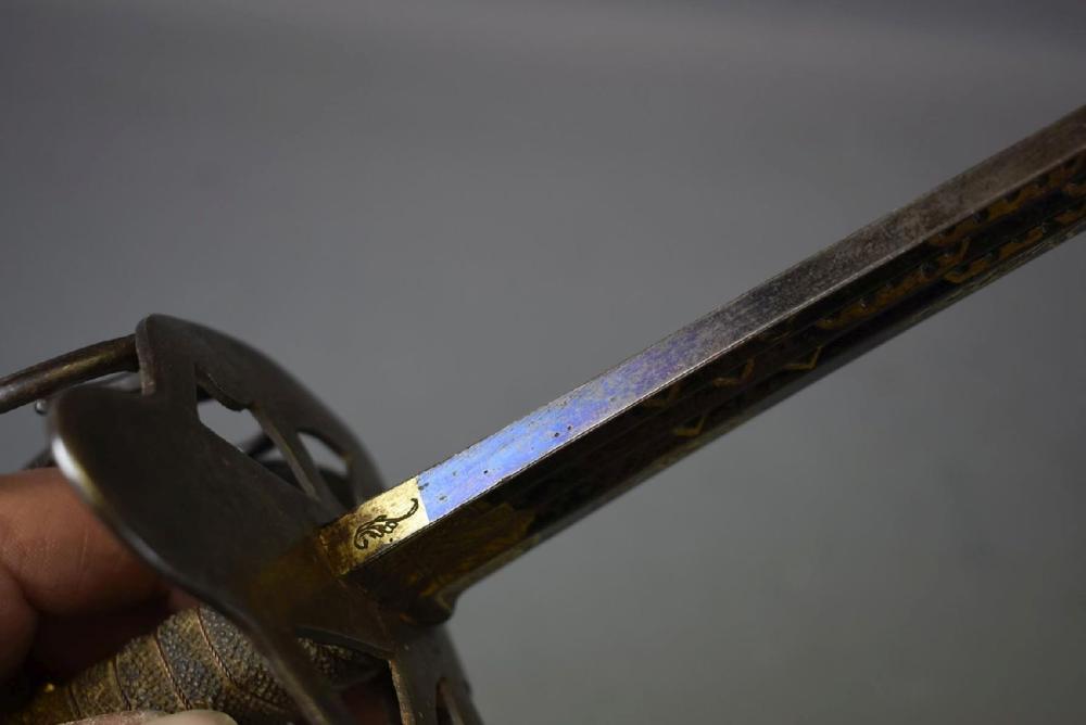

Cartouche and Solingen style Trophy of Arms:
Name:  Carabinier Officers Sabre ā Garde de Bataille 17.jpg
Name:  Carabinier Officers Sabre ā Garde de Bataille 19.jpg
Missing its blue and gilt.

French Dragoon Officers 'Garde de Bataille'

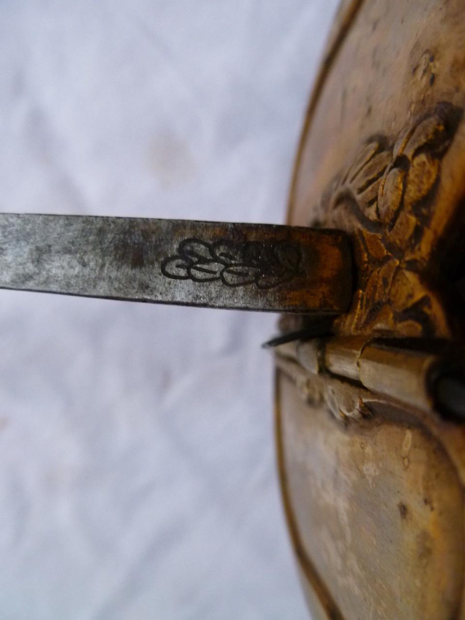

Rose mark

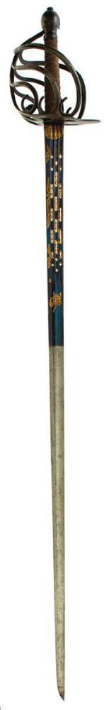

Old 20th November 2023, 12:43 AM   #2
Radboud
Join Date: Sep 2021
Location: New Zealand
Posts: 303
Default More Swords

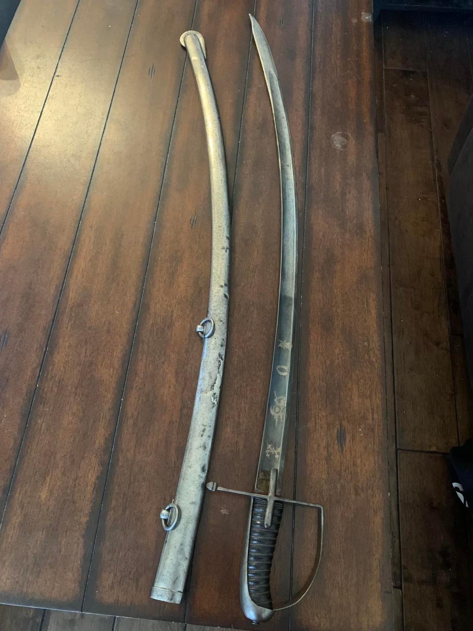

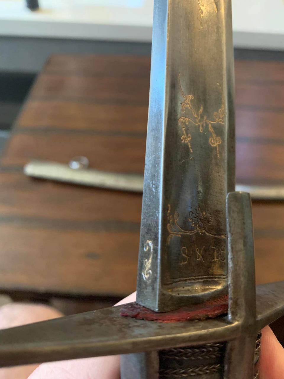

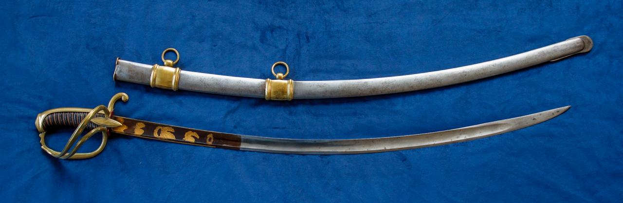

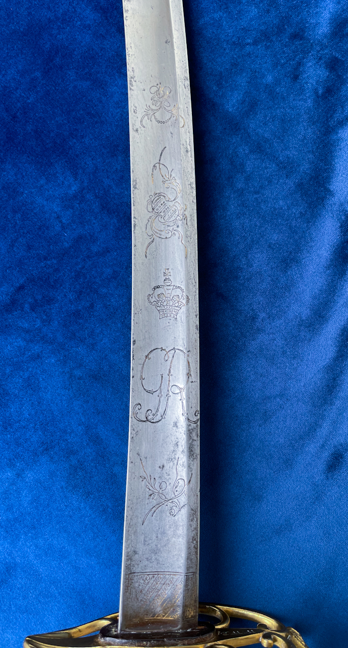

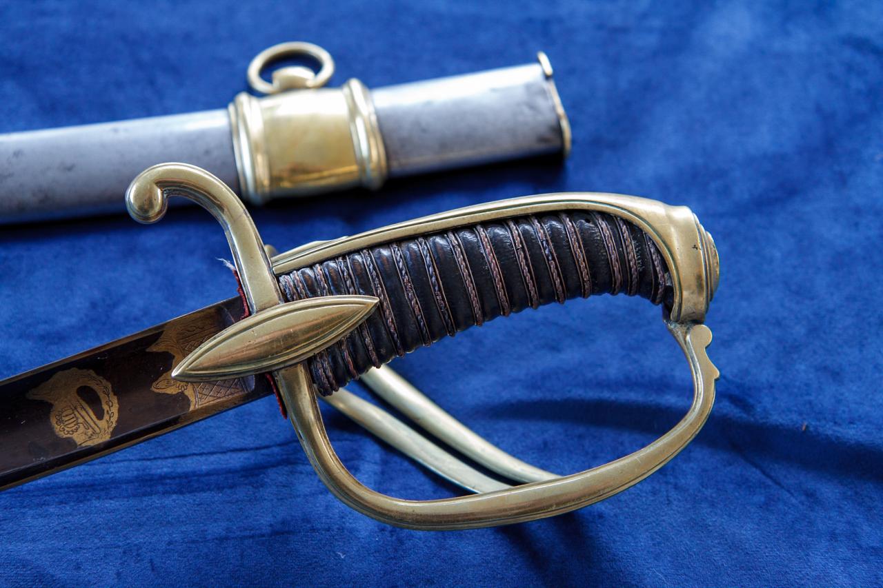

French Year 11 Light cavalry officers' sabre
This sabre is likely to be from the Napoleonic era, but it is possible that dates a little past that. However, the bluing terminates in a straight line, which predates the 1820s change. This blade was retailed by S&K.

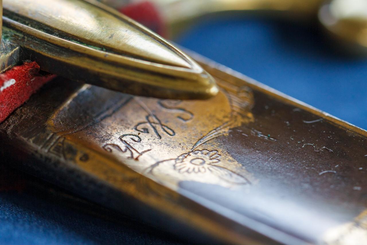

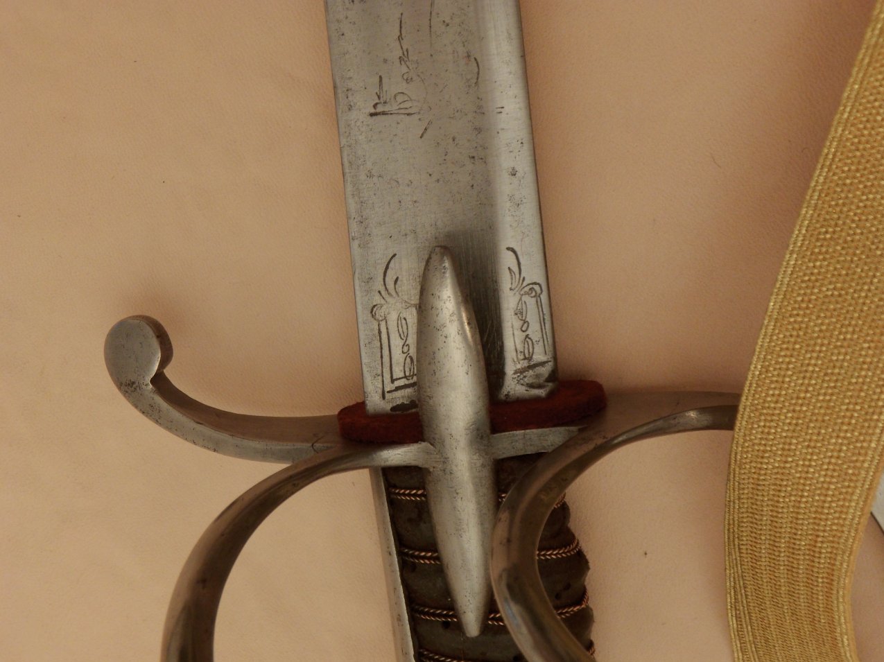

Cartouche with S&K mark
Rose mark

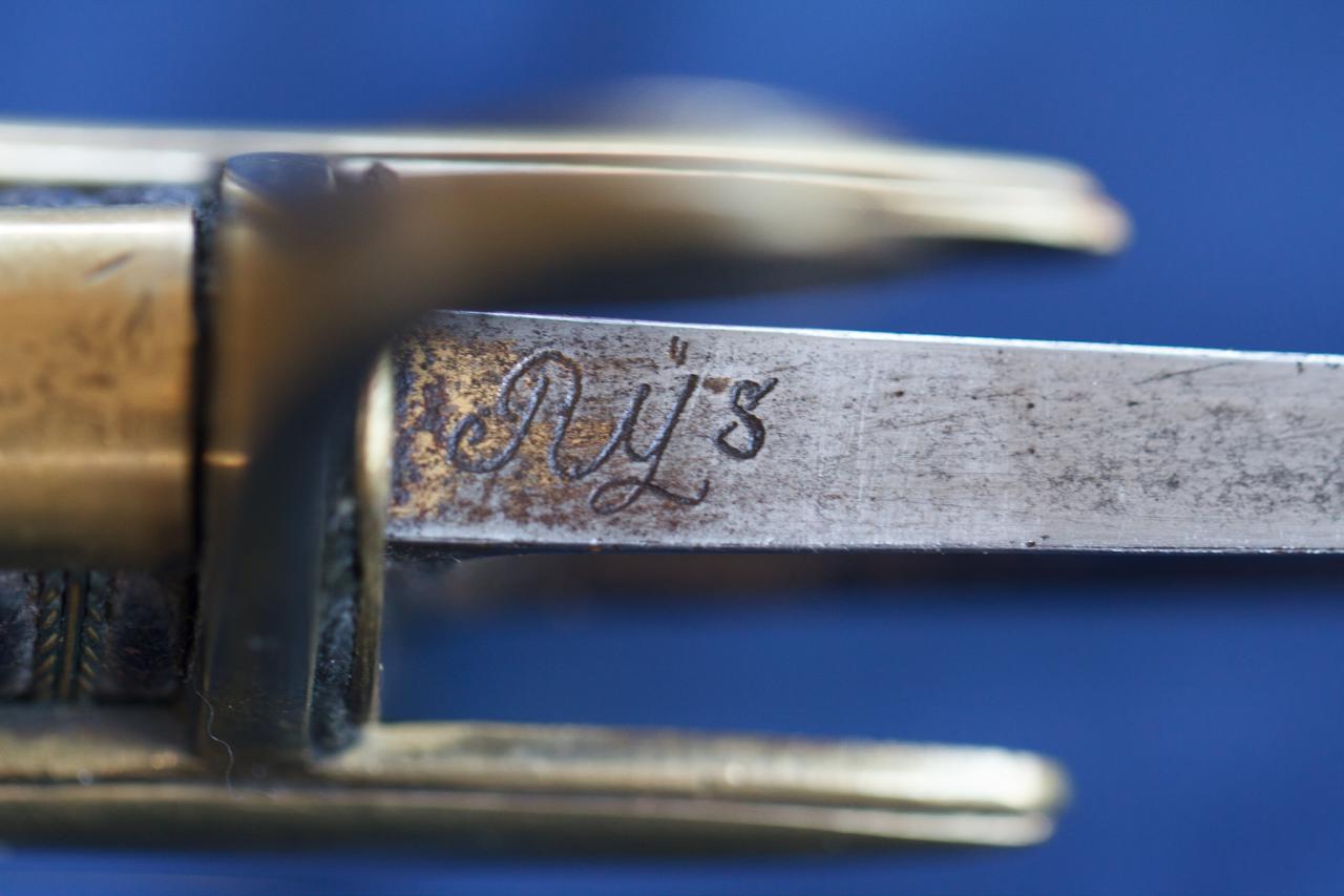

Dutch m1800 Light Cavalry officers' sabre
This sabre has all the typical Solingen decorations but the makers name on the spine is Rys with the Dutch Y. It likely served with Dutch forces during the reign of Napoleon.
Cartouche
Cutler's name instead of the Rose

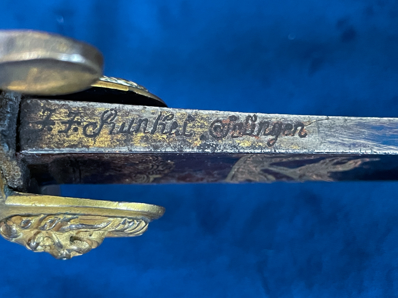

Default J J Runkel supplied blades

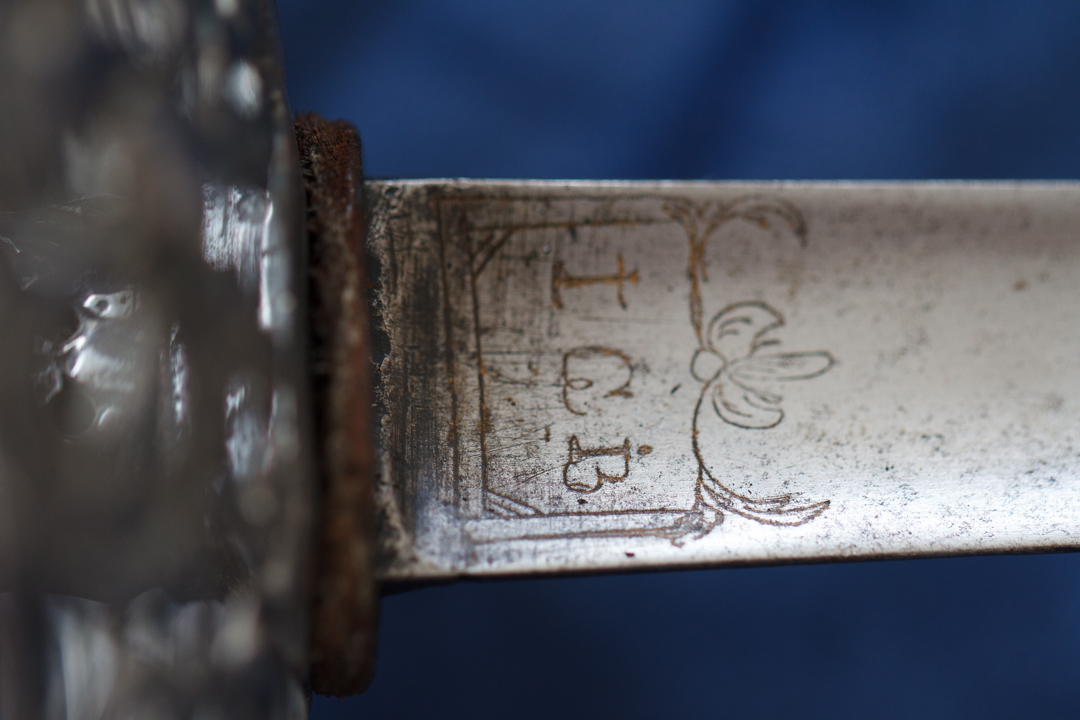

The rest of my Solingen-made blades are from the British side of my collection (I'm excluding the smallswords as they don't have spines and one spadroon with a double-edged blade) and were imported by J J Runkel. They are interesting because they show a uniformity of iconography and variations in the signature.

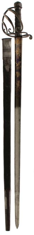

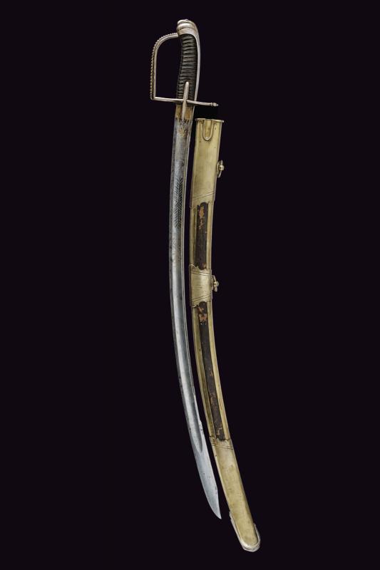

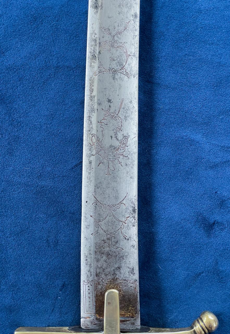

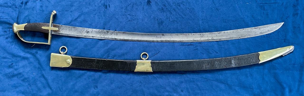

1788 Pattern light cavalry troopers sword
This sword would have been imported as a complete sword by Runkel, it has an ordinance board inspection stamp, and even though the blade is engraved it would have been 'bare' of blue or gilt. These are a good example of how the craftsmen in Solingen were able turn out blades, that a trooper sword would be decorated in this manner.
Name:  1788 Pattern Light Cavalry Troopers Sabre 03.jpg
Cartouch, ordinance board stamp and talismanic decorations
Name:  1788 Pattern Light Cavalry Troopers Sabre 13.jpg

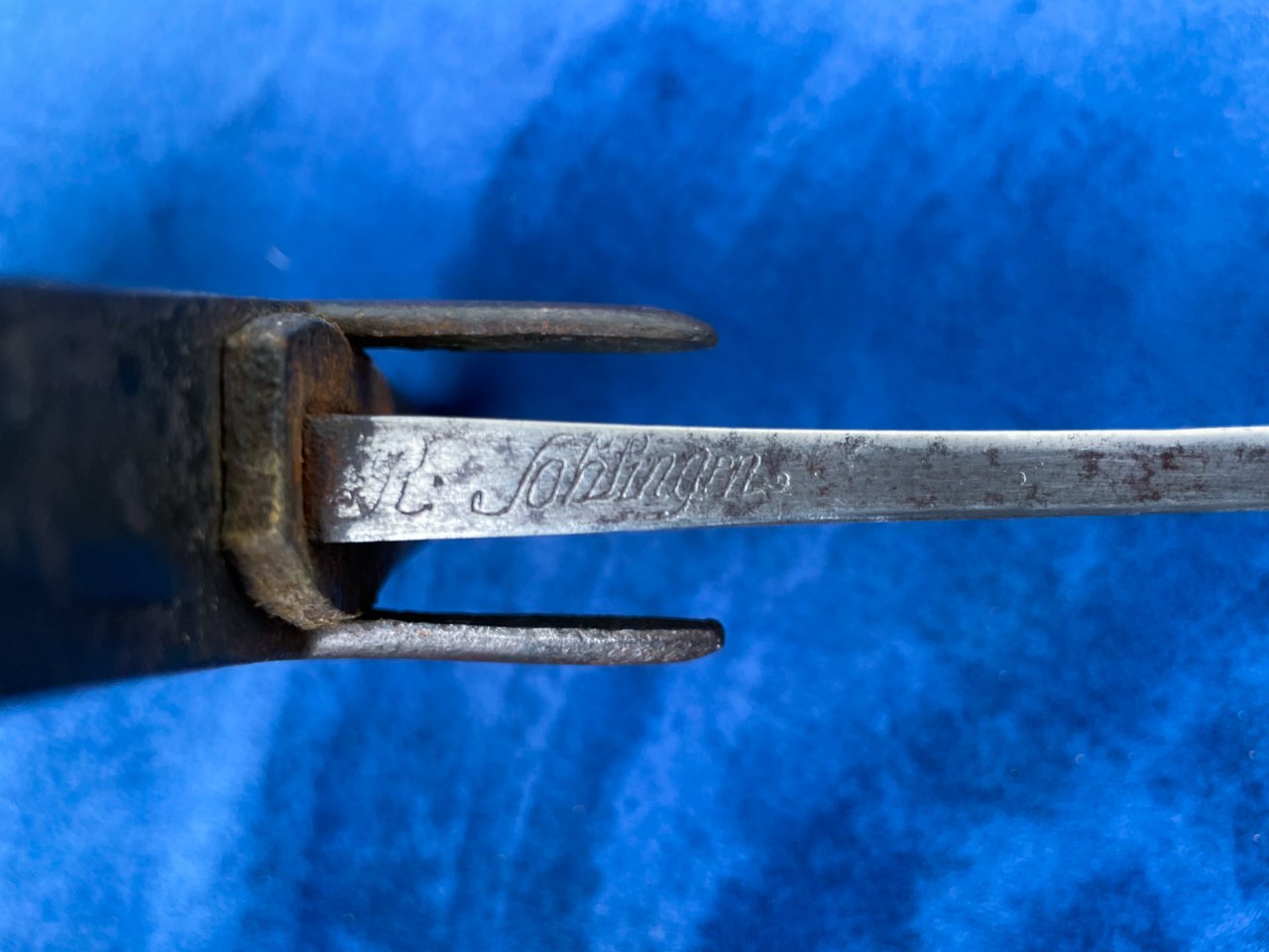

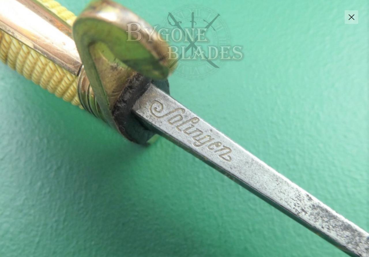

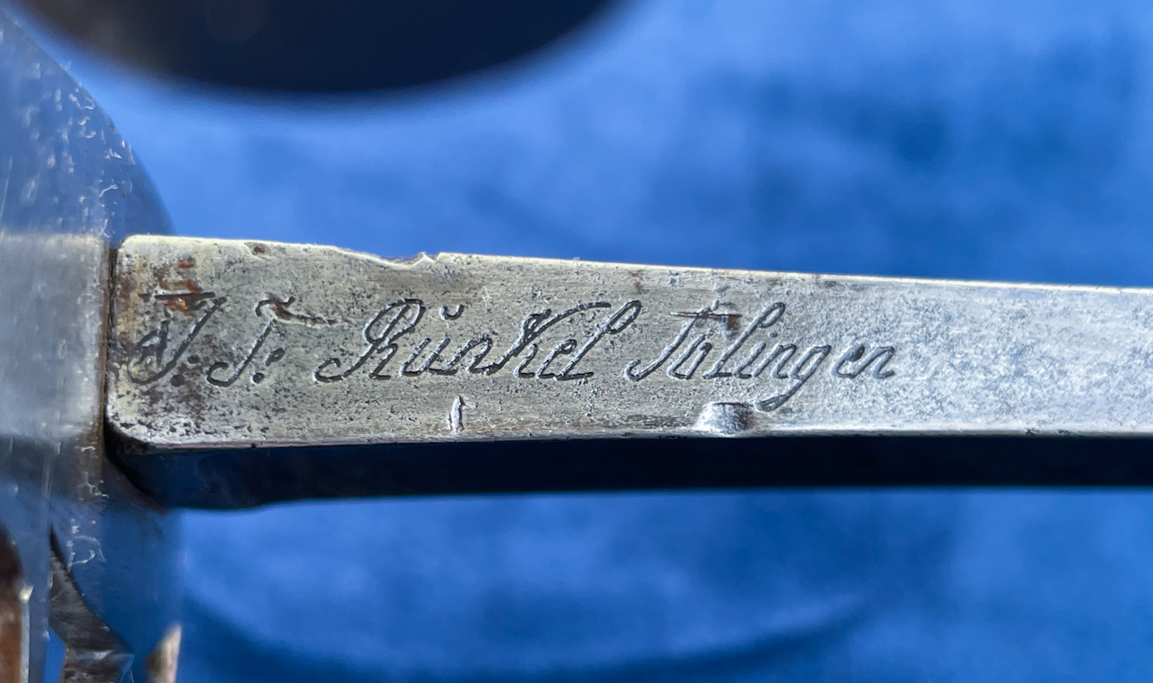

R. Sohlingen
Note the spelling of Solingen with an h, this appears to have changed around the turn of the century.
Name:  1788 Pattern Light Cavalry Troopers Sabre 14.jpg

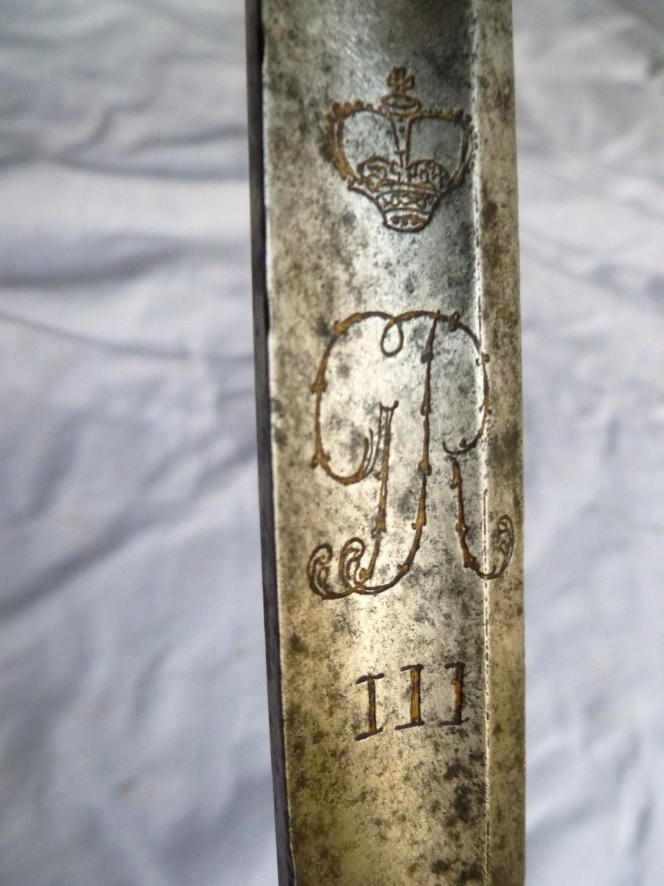

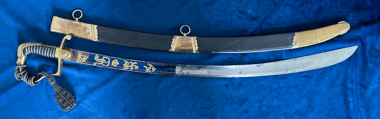

Horse Head officers sabre by Archer of Dublin
Note the straight termination of the blueing. The blade is engraved with GR on one side and the pre-1801 coat of arms. Other decorations are fairly typical of Solingen's work.
Name:  Non-Regulation Horse Head Officers Sabre 03.jpg

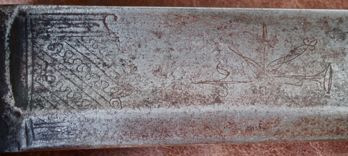

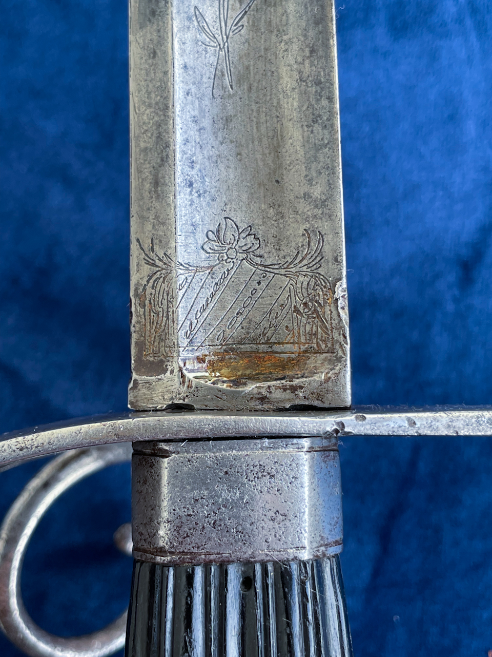

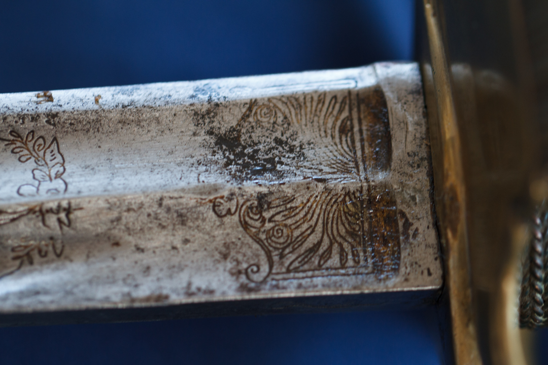

Cartouche
Name:  Non-Regulation Horse Head Officers Sabre 19.jpg
J.J: Runkel. Solingen
Name:  Non-Regulation Horse Head Officers Sabre 18.jpg

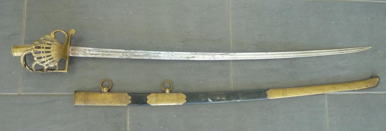

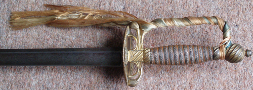

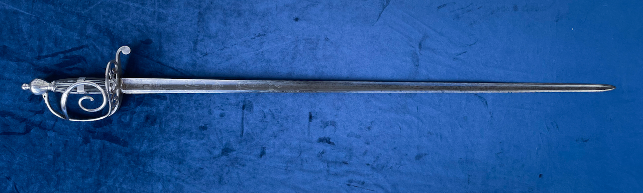

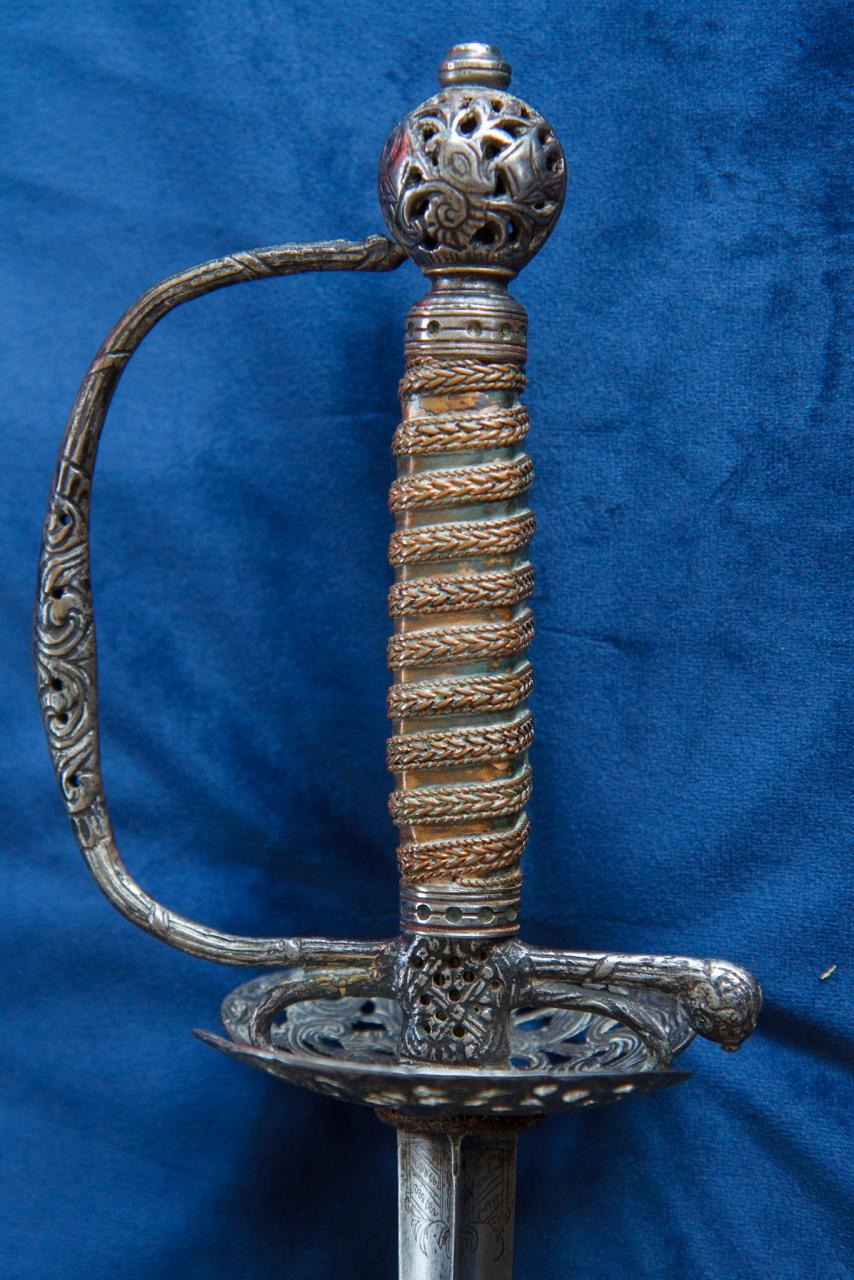

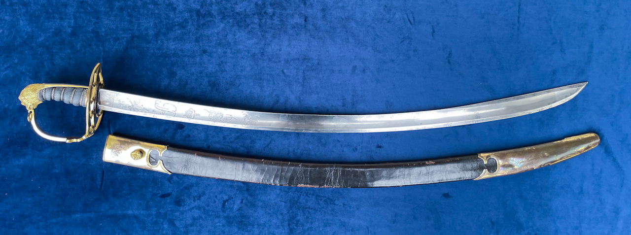

1786 Style Infantry Officers sword
This is a 1780-1790s style infantry officer sword with a Runkel-supplied blade. The blue and gilt are missing, but it has the GR and post-1801 coat of arms.
Name:  Georgian Infantry Officers Sword 01.jpg

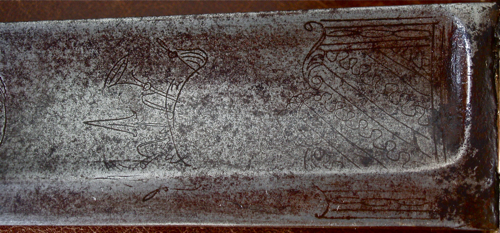

Cartouche
Name:  Georgian Infantry Officers Sword 11.jpg
J: J: Runkel Solingen
Name:  Georgian Infantry Officers Sword 06.jpg

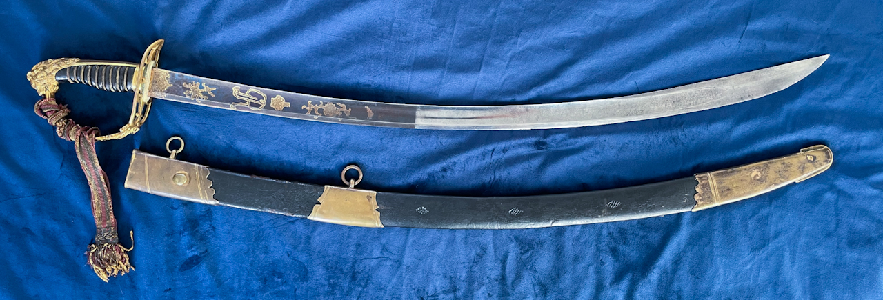

1803 Pattern Light Company Officers sabre.
Assembled by Bennett, the blueing terminates in a straight line with GR and 1801 - 1816 British Coat of Arms.
Name:  1803 Light Company Officers Sabre by Bennett 01.jpg

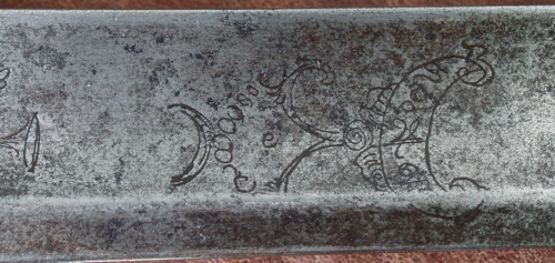

Blade and Cartouche
Name:  1803 Light Company Officers Sabre by Bennett 05.jpg
Name:  1803 Light Company Officers Sabre by Bennett 07.jpg

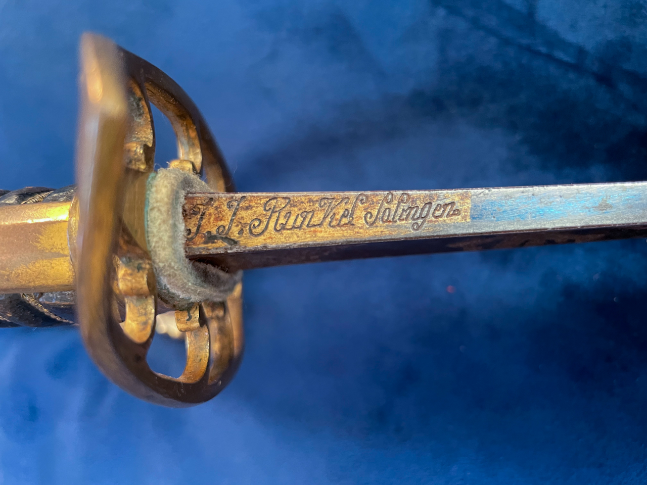

J. J. Runkel Solingen
Note how the gilding terminates at Solingen, indicating that the engraving was done at time of manufacture.

If other members have their own examples of late 18th to early 19th-century Solingen-made blades, I would love to see their markings to expand on the sample size.
Old 20th November 2023, 02:44 AM   #6
Posts: 10,872
This is a magnificent topic and thread! Thank you!
I had asked about the 'ROSE', or what appears to be a floral/vegetal device on the spine of blades near the hilt, and in some arcane fashion as shown in these examples.
Now that I see the context, I am curious on that these seem to appear on blades on French swords, or in European armies' swords during Napoleonic period.
There was mention of these devices being used on Solingen made blades.
I had thought that most blades on French swords of these times were from Klingenthal and of course so marked on the blade spines.
Is it possible that alternatively the blades with these devices on the spines had to do with Caissagnard in Nantes, who embellished blades with certain esoteric and cosmological themed motif?
It seems these blades could have come from Solingen? but would the motif including the 'rose' have been applied in Solingen? then these blades were fitted there.
I am looking forward to other examples of swords with this floral device on the blade spine, and more on these details. Thank you for this thread!

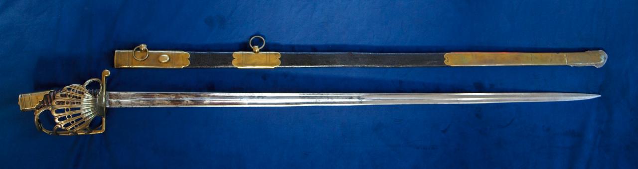

Nice circa 1770 Georgian Horse Grenadiers sword:
Name:  001 - Georgian Horse Grenadier Officers Sword 01.jpg
Cartouche
Name:  001 - Georgian Horse Grenadier Officers Sword 13.jpg
Rose Mark
Name:  001 - Georgian Horse Grenadier Officers Sword 16.jpg

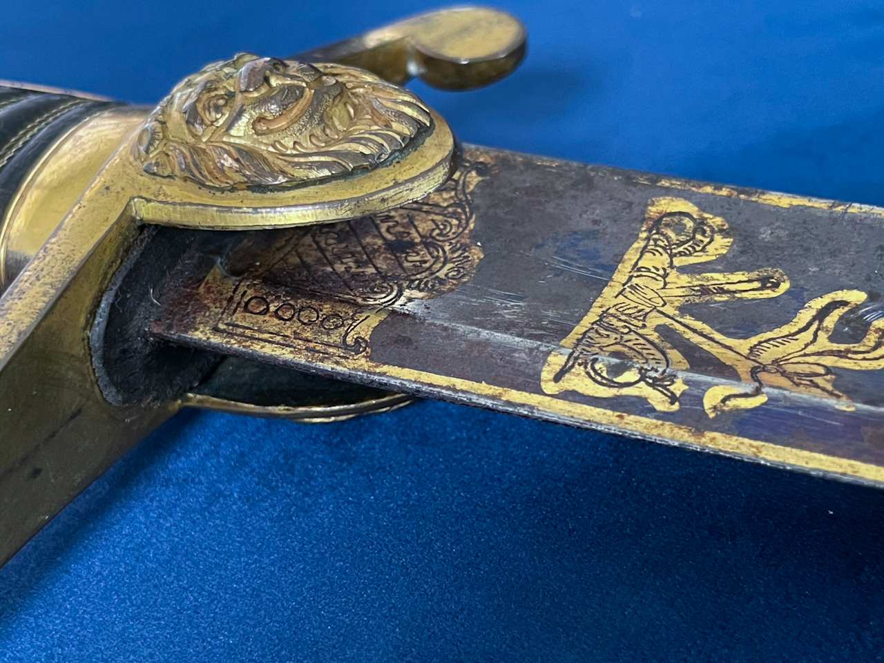

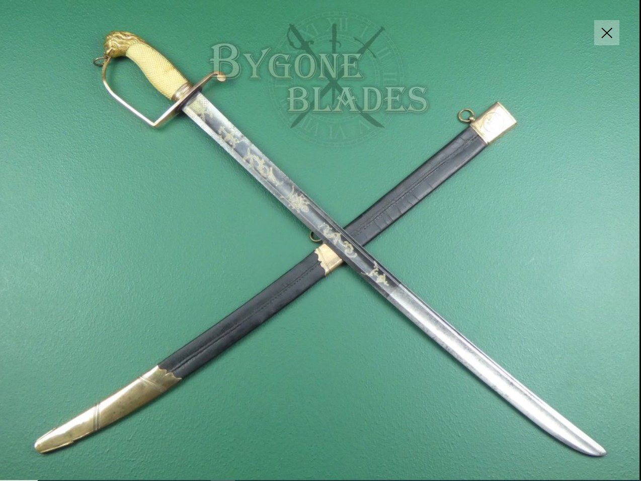

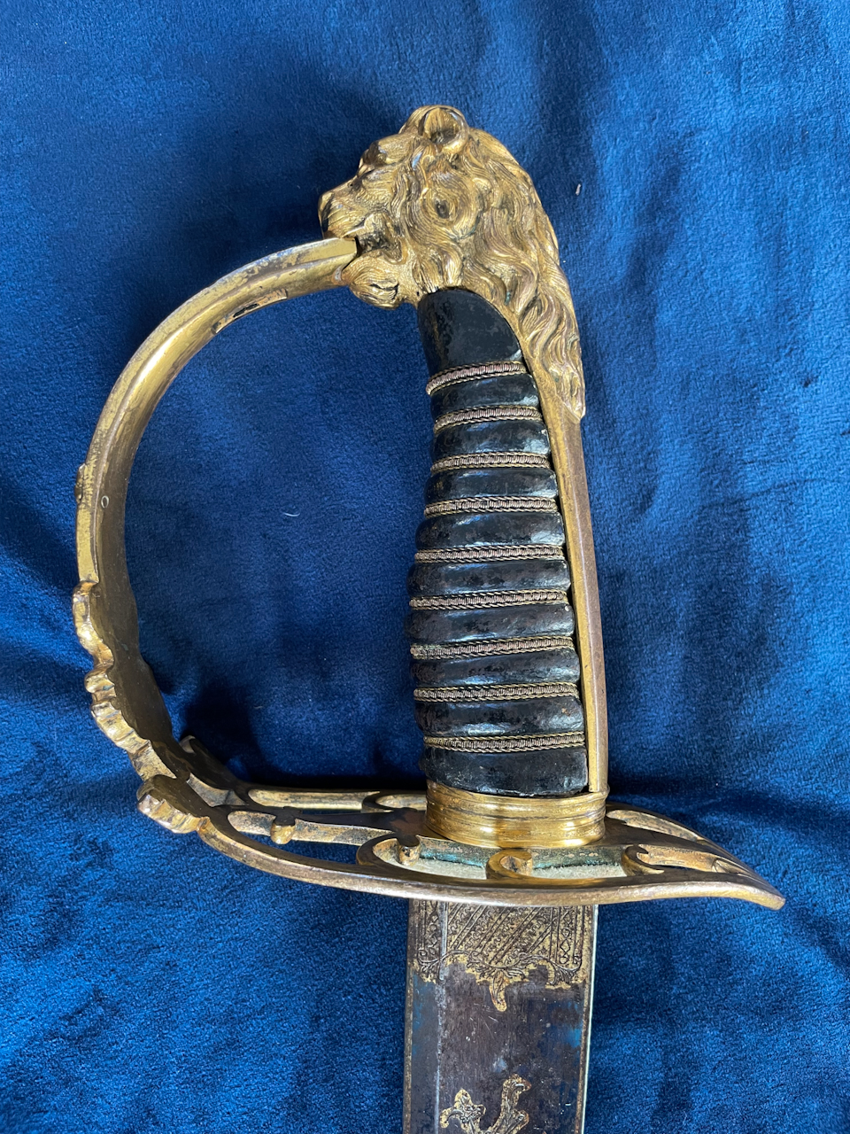

British Lions' head pommel sabre
Name:  037 - Georgian Flank Officers Sword by Drury 01.jpg
Typical Solingen cartouche
Name:  037 - Georgian Flank Officers Sword by Drury 09.jpg
No Rose Mark or retailer, just Solingen
Name:  037 - Georgian Flank Officers Sword by Drury 12.jpg

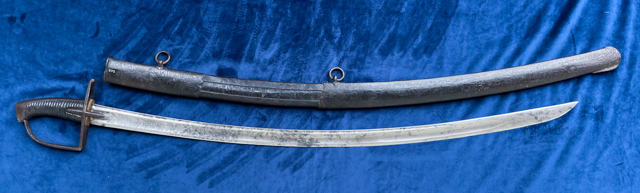

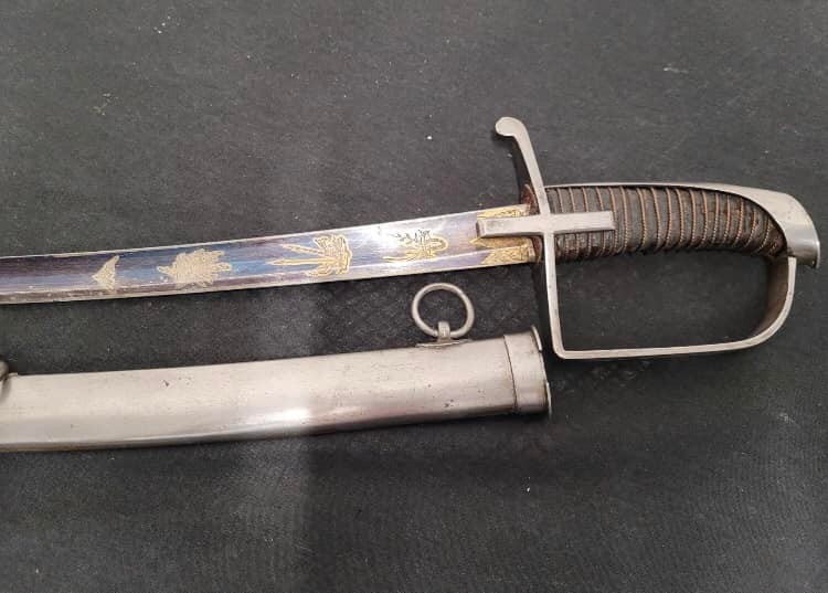

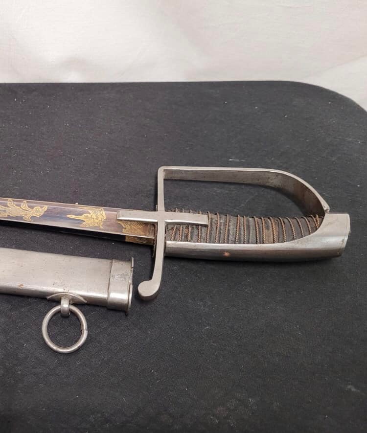

Probably South German light cavalry officers' sabre (Bavaria, Wurttemberg, Hesse)
Name:  005 - m1800 Hussar Sabre 01.jpg
Not the best photos, but you can make out the cartouche and a hint of the rose mark
Name:  005 - m1800 Hussar Sabre 02.jpg
Name:  005 - m1800 Hussar Sabre 03.jpg

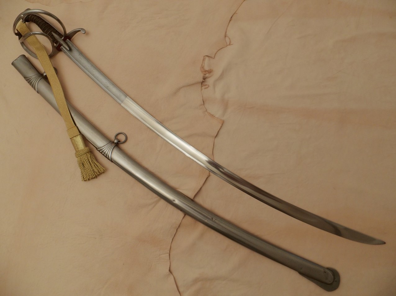

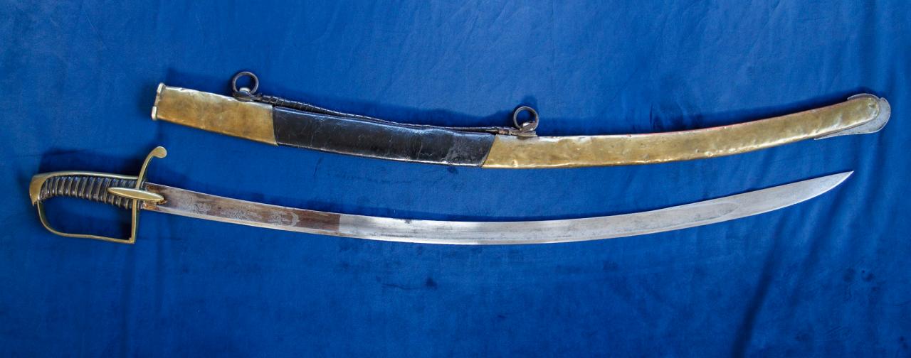

Saxon Light Cavalry officers sabre
Cartouche

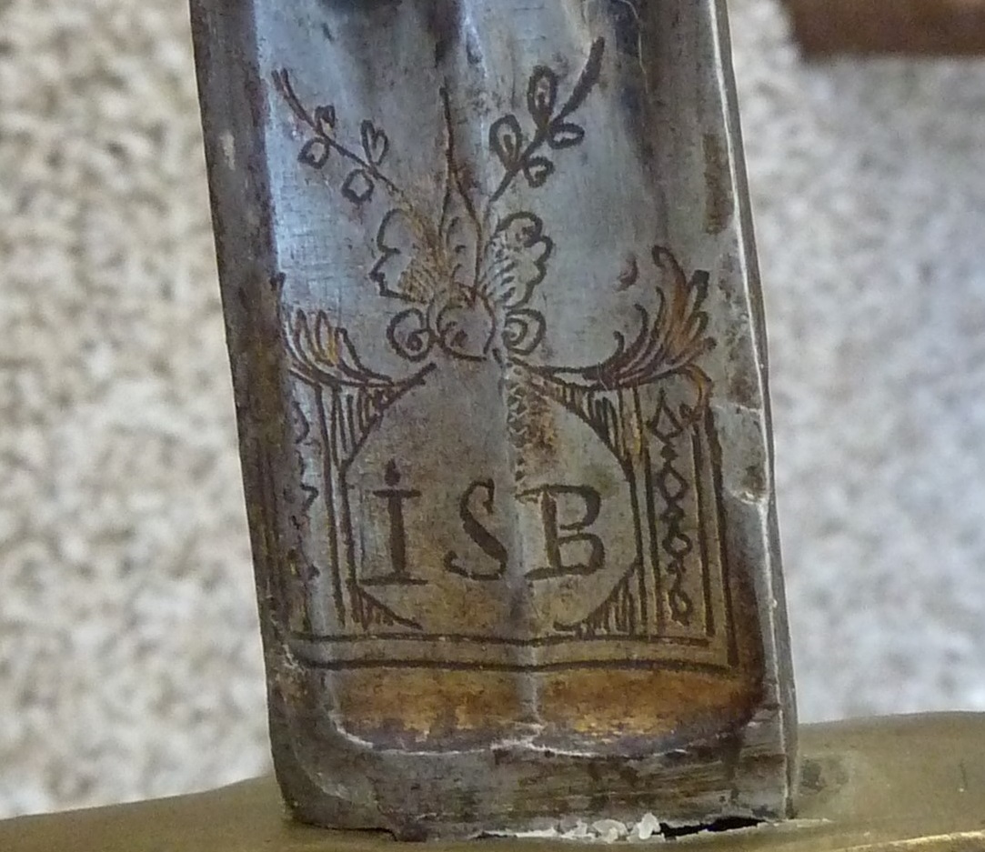

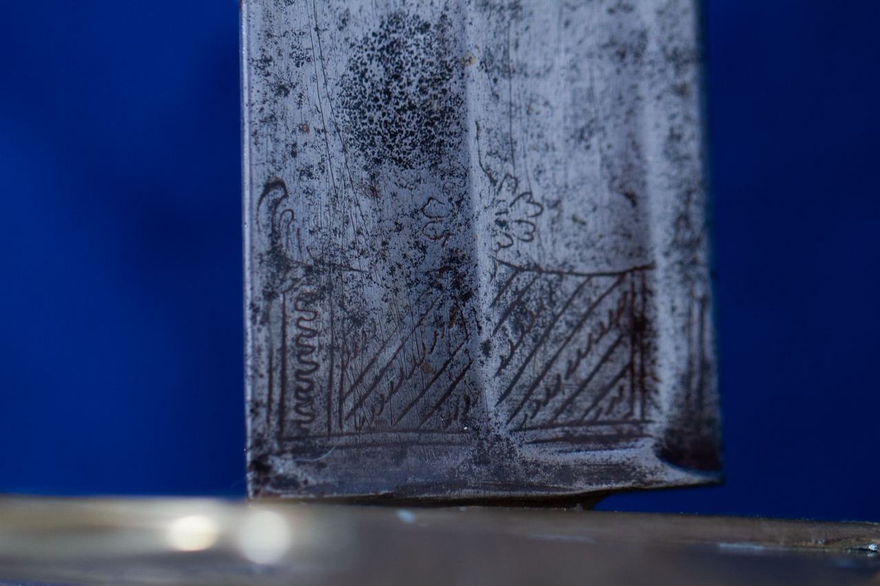

Rose Mark

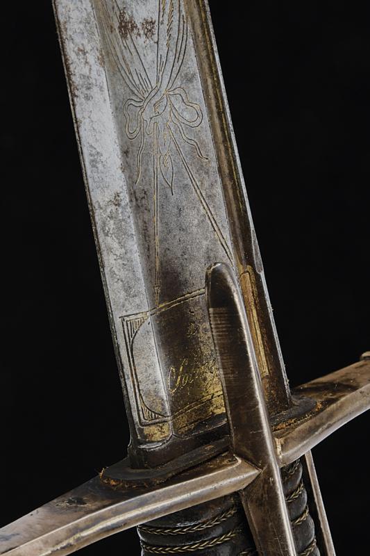

Source: Saxon Napoleonic era Officer's Sabre
And this sabre, I have it as German, but the style could be French as well, especially with that carp's tongue point.

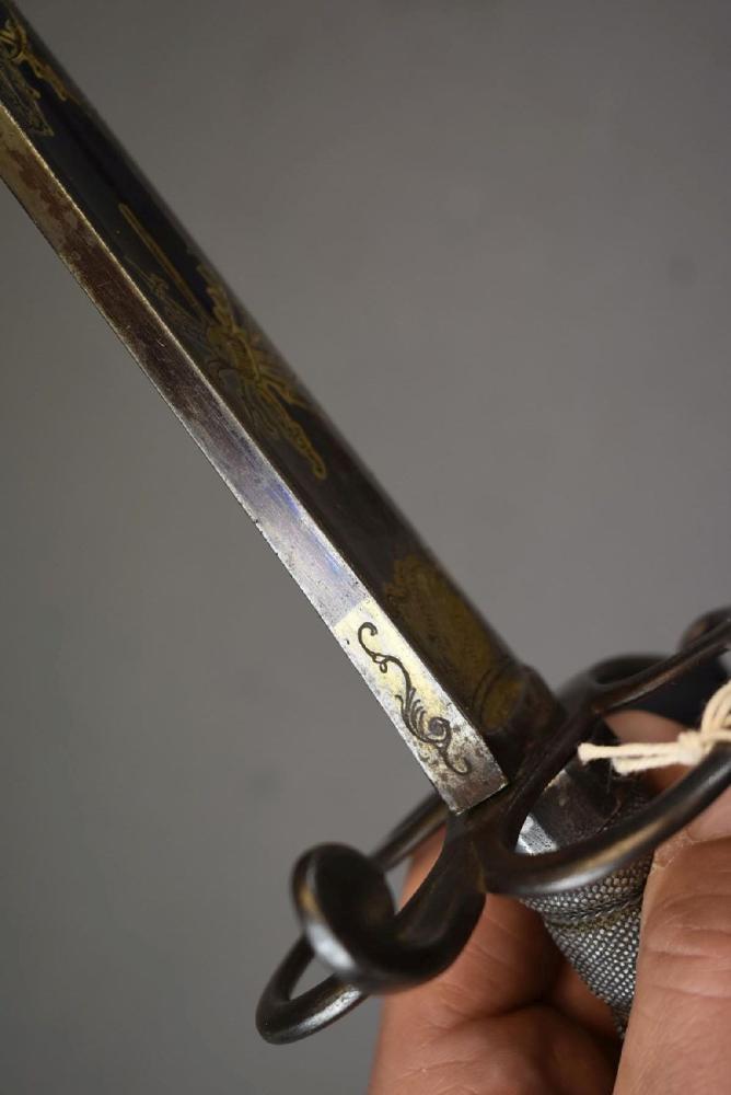

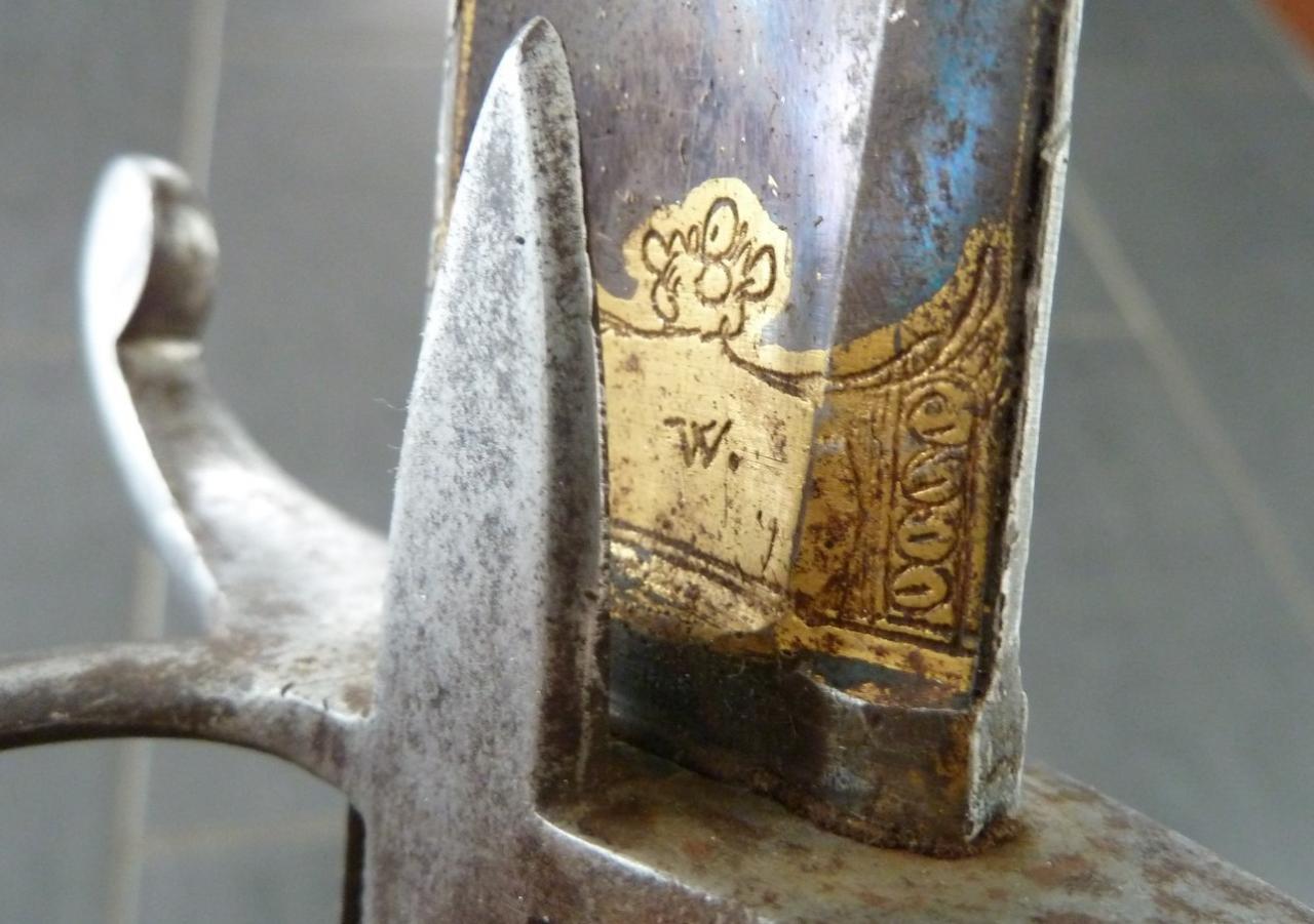

Cartouche
Rose and S&K retailers mark.
This rose appears to be different from my S&K marked sabre. Different bladesmith?
Old 20th November 2023, 08:54 AM   #11
Radboud
Join Date: Sep 2021
Posts: 303
Originally Posted by corrado26 View Post
There is a book published in 1885 showing all blade sins of Solingen since the oldest times, but these "Rose" signs are not to be found. So I think it is very doubtful if these roses are typical or special Solingen signs.
Respectfully I disagree, all the blades I have shown have the cartouche on the ricasso and either Solingen on the spine or a rose. These cartouches are not found on British or French-produced blades.
In the case of the S&K marked swords, we know the Solingen-based retailer that exported the rose-marked blades. Plus there are I.C.B marked smallswords with this cartouche (but no rose because of the trefoil blades):

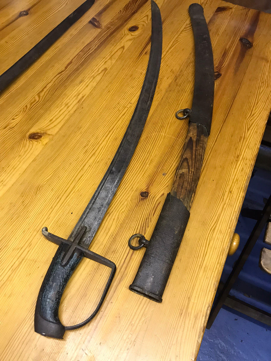

Old 20th November 2023, 11:20 AM   #12
Norman McCormick
Norman McCormick's Avatar
Posts: 1,657
Hi,
I have a small sword hilted spadroon type sword probably for a Dutch officer with this 'rose' detail.
Norman.

The 'Caissagnard' matter for me evolved from several references in French, where my limited understanding of the language prevented more detailed comprehension of what was mostly comments on the talismanic, occult and arcane motifs on French blades of 18th into early 19th c.
I had presumed the name was to a cutler, but more that it had seemed to become a colloquial term describing these motif elements.
It seems to me quite possible that the blade decoration which includes these unusual squiggles and swirls termed 'roses' at the blade spine near hilt may have been added by cutlers to blades which were essentially 'blanks' from shops in Solingen.
These appear to me to be singular renditions of a basic form in a key location on the blade which represent arcane identification or perhaps other 'magical' or occult symbolism as with sigils and such devices. The term magic should not be taken in the negative connotation often perceived, but more in this arcane sense.

- On a sabre belonging to an officer of Marine troops engraved with sun, moons, stars

Old 21st November 2023, 03:45 AM   #17
Radboud
Join Date: Sep 2021

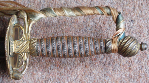

Posts: 303
Italian officers sabre
Circa 1790-1800 with Garde de Perle style hilt and horse hair pommel cap.

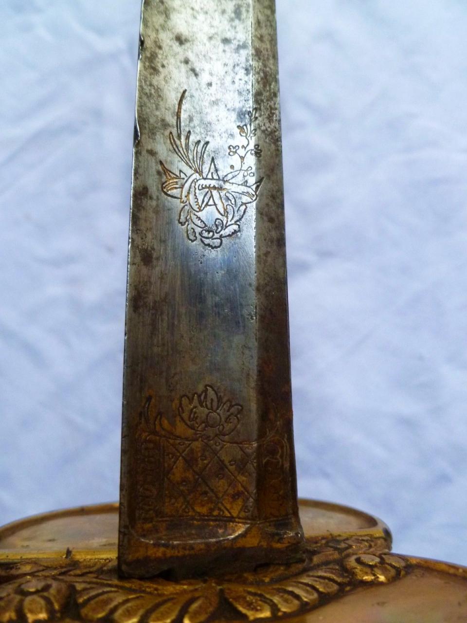

Name:  070 - Garde de Perle Officers Sabre 09.jpg
Cartouche
Square cartouche at the ricasso with Solingen engraved in one side and S & J or S & K on the other.
Name:  070 - Garde de Perle Officers Sabre 07.jpg
Rose Mark
Rose mark on the spine of the blade
Name:  070 - Garde de Perle Officers Sabre 08.jpg
Interestingly with this sabre, the blade decoration is more bespoke than normally seen
Name:  070 - Garde de Perle Officers Sabre 06.jpg
Old 21st November 2023, 05:40 PM   #18

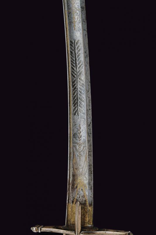

Old 21st November 2023, 10:26 PM   #19
Radboud
Join Date: Sep 2021
Posts: 303
As with most things, variation and exception are a constant, and with the Solingen situation, it was a manufacturing center for blades, which involved many makers, shops and artisans. Naturally there may have been cases of specific completed swords in which entire decorated blades were mounted there. However, this, in my opinion was one of the exceptions.
How do we qualify an exception? From the surviving examples, we know that Solingen made a vast quantity of blades. If ten percent of their business was completed swords, does this qualify as an exception? What evidence do we have to even speculate on such a percentage?
We know from the research and physical examples that J J Runkel imported into the UK completed swords into the UK; the 1788 pattern from my collection is one of those and a perfect example of a generic 1780s "Hussar" sabre, that would otherwise be labelled "European Hussar Sabre" were it not for the British Ordinance board stamp. The capacity to make those swords had to be in place for him to be able to supply them.
I can show you two other examples of near-identical swords made by Solingen that, were it not for markings, would be nearly impossible to identify accurately.
Name:  030 - Revolutionary Officers Sabre 01.jpg
Name:  060 - French Hussars Sabre 01.jpg
To the case in point, I dont believe that the decorative 'rose' images inscribed on the blade spines at the forte were ubiquitous enough in such blades which might have been applied in Solingen to designate them as a 'Solingen' affectation. In most of the cases by the examples shown, they seem to be aligned with French officers swords of 18th c into 19th along with armies associated with the French. As we agree, the blades on these were likely acquired by Caissagnard, and certainly other furbishers, for mounting.
I should point out that in the period they were used, France did control a significant proportion of Europe, inspired the fashion of Europe and filled her armies with men from European allies & vassal states.
Also, there is a huge element of selection bias in the examples I've shown. Since I have primarily focused my personal collecting research on French, British and where possible, Dutch swords. It is only natural that the database of images I have gathered and drawn from will heavily feature swords from these nations. I am sure there are plenty of examples from other nations that I have overlooked since they fall outside of my personal field of interest. With the collectors I have spoken to who share a similar field of interest, it is pretty much a given that the Rose is a Solingen mark, the questions are more around when it started, stopped and what they mean.
If you or anyone else has examples of blades with the Rose that can be positively identified as not having been produced in Solingen, I would be truly grateful.
If in some cases, these cutlers had found artisans in Solingen to apply particular decoration, this would not be surprising, however this would be an incidental case, and not supportive of these decorations being a collectively used decoration or certainly not a certain makers indicator from Solingen in specific.
I disagree, and the physical evidence demonstrates that a good portion of Solingen-made blades were sold pre-decorated. Furthermore, it is doubtful that many foreign cutlers dealt directly with the bladesmiths themselves, and instead went through intermediaries such as Runkel and S&K.
The two S&K blades I have shown earlier are pretty much identical in decorations, including the S&K logo on the ricasso. Since S&K were specifically traders, they would have purchased these blades with the decorations pre-applied for on-sale to the French cutlers. The smallsword in my collection with the blade from Johann & Clemens Boegel would have been sold with their I.C.B logo and decorations applied to the blade.
Of the twenty-two British swords in my collection, six of them have blades imported by Runkel, four of them have near identical decorations even though they were sold to four different cutlers (Prosser, Bennett, Archer of Dublin and one unknown). Of the two that have atypical decorations, the first is the 1788 that was imported as a complete sword and the second is a 1796 Pattern heavy cavalry officers dress sword. Of the 1796, these have a double-edged blade and the majority of the surviving examples have plain blades with Runkels' signature in the fuller.
When I look at a single-edged British sword, I can instantly spot that it carries a Runkel or Solingen blade purely by its decorations. Naturally, it is likely that bare Solingen blades were imported and then locally decorated in British fashion, but without a Solingen stamp on the blade there is no way to identify an example. Existing blades marked to Solingen with British decorations are rare in my experience.

Old 22nd November 2023, 03:08 AM   #20
Bryce
Bryce's Avatar
Join Date: Aug 2017
Posts: 202
G'day Radboud,
I will back you up that Solingen blade decoration is instantly recognizable. As an example the photo below shows similar decoration on a British 1796 heavy cavalry officers undress sword with a Runkel blade (left) and a French Heavy cavalry officer guarde de bataille sword with a blade marked ISB.
Cheers,
Bryce
Old 22nd November 2023, 04:08 AM   #21
Radboud
Join Date: Sep 2021
Posts: 303

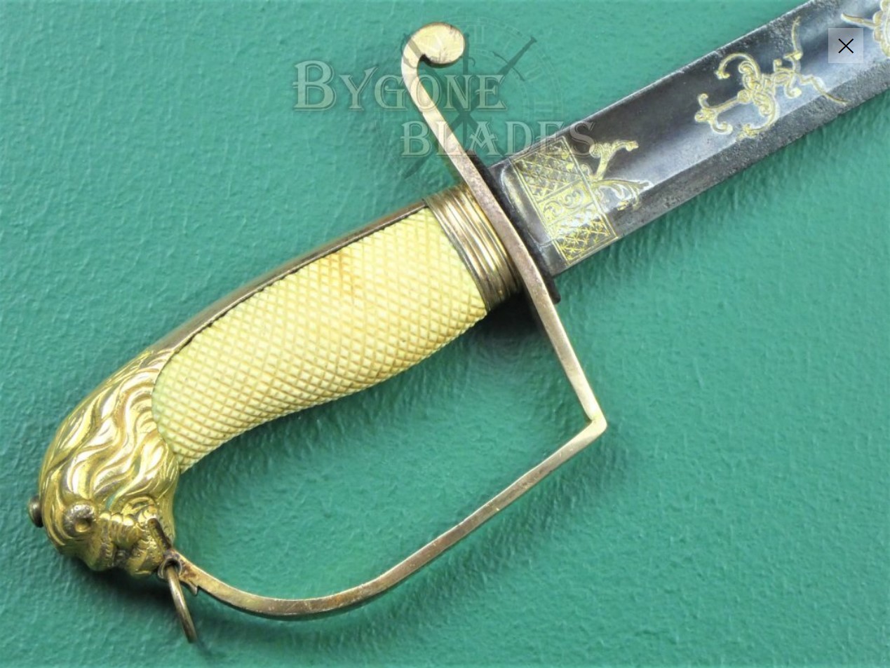

Thank you for the photos Bryce, does the GdB have a Rose or Solingen written on the spine? I'd love to see more photos of that area if you have them.
Old 22nd November 2023, 05:39 AM   #22
Bryce
Bryce's Avatar
Join Date: Aug 2017
Posts: 202
Here you go.
Cheers,
Bryce
Old 22nd November 2023, 05:46 AM   #23
Bryce
Bryce's Avatar
Join Date: Aug 2017
Posts: 202
Here is another sword you may be interested in.
Cheers,
Bryce
Old 22nd November 2023, 05:51 AM   #24
Bryce
Bryce's Avatar
Join Date: Aug 2017
Posts: 202
Here is a British 1796 infantry officer's sword with a Solingen blade, that isn't marked to Runkel. This one isn't from my collection.
Cheers,
Bryce
Old 22nd November 2023, 06:59 AM   #25
Radboud
Join Date: Sep 2021
Posts: 303
Lovely examples Bryce, that GdB sabre is unique!

I would note that the blades by Thomas Gill, who initiated the so called 'sword scandal' in 1790s was a Birmingham maker, as was James Wooley who both produced officers sabers without the blued and gilt decoration typically, and used their own blades, as far as I have known.
At the time, British cutlers were complaining about the tariffs on blades imported from Solingen. They argued that British-produced blades were sub-standard to the German ones. Thomas Gill contested this, claiming that blades produced by him were every bit, if not better than German made blades. He tried on several occasions to have his claim tested by the Ordinance board until finally, the East India Trading company agreed to conduct a test involving swords produced by him, Wooly and supplied by Runkel.
Not surprisingly (possibly because the designer of the testing machine was a close friend of his) Thomas Gill's swords came out on top with a very low failure rate. Next were Runkels' imports. Woollys swords came last, with well over half failing the test.
What followed was a lengthy exchange of letters published in the local papers between Gill and Woolly.
Of interest is the time when Runkel was caught falsifying his import documentation to reduce the duty cost. Some 5,000 blades were confiscated and bladesmiths such as Gill then petitioned to have the blades given to them as compensation.
Interestingly, these tests do not appear to have dented Woolly's reputation, as they remained one of the prominent bladesmiths of the time. Regarding the decoration, they produced blades for the government (remember that regular cavalry soldiers were still supplied their swords by the government), East India Company and private purchase officers. It's pretty common to find officer blades by Woolly that have been decorated in blue and guilt, with their logo on them.
