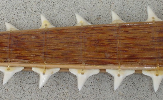

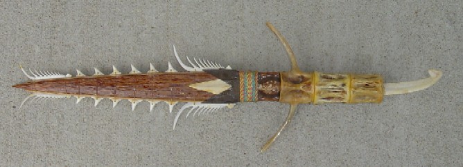

After various threads on the so called 'sword fish' swords and whether they were actually used by natives or were 'made-up' inventions for the tourist trade. I found this on eBay, knowing that sharks teeth are generally quite sharp, usually with serated cutting edges, I would imagine that this weapon could cause serious injury to an opponent, especially with 'slashing' styled strikes. (Once a shark has bitten into its prey, they shake their heads from side to side, this causes the flesh to be cut by the cutting serations on either side of the teeth...)

Thanks Ian.....I have heard of these type of weapons... but never seen a picture.
After quickly scanning the links you provided, I can see the debate about tourist/genuine ethnic ..rearing its head. It makes logical sense to me that this type of weapon must have evolved at some time in some ethnic communities. But, as improved materials and weapons came about...these would become obsolete......such is the process of evolution
Tim, an interesting object.....also facinating is how many diverse communities have scarification and blood letting embroiled in their customs.

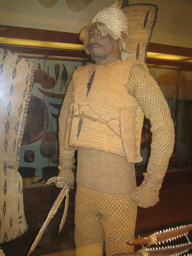

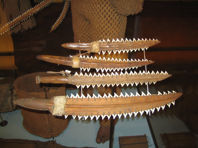

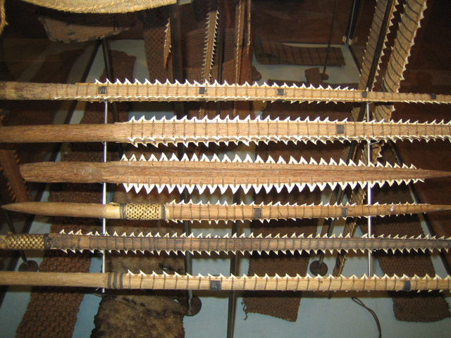

Here we go. A few pictures from the local National Museum's collection. They even have a set of armor made of woven fibers or something like that.

JayJay......thanks for the photos, the 'armour' does seem to suggest that these swords were commonly used weapons.

Interesting side-light about the armor. If you read Arthur Grimble's book on the Gilberts, he mentions not only the armor woven out of coconut fiber (what we see here), but also a ray skin (i.e. rawhide/shagreen) "cuirass" that was tied to the front to protect the belly.
I've always wondered why the Kiribatian armor was tied in front with that vulnerable little cord, but I've never seen the ray skin piece that Grimble says went over it.
Question: has anyone ever seen the alleged ray-skin part of this armor? Did it exist? The fact that they're willing to use a puffer fish skin as a helmet suggests that the ray skin story could be real.
Wow! This is warrior of the Gilberts Islands?
