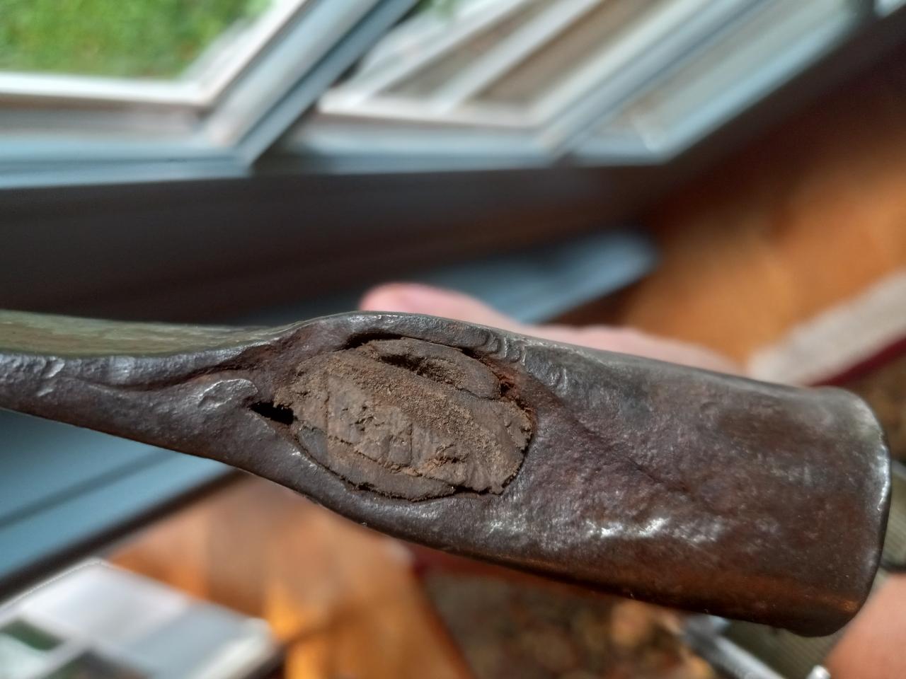

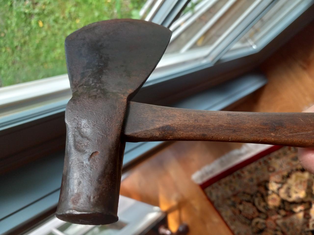

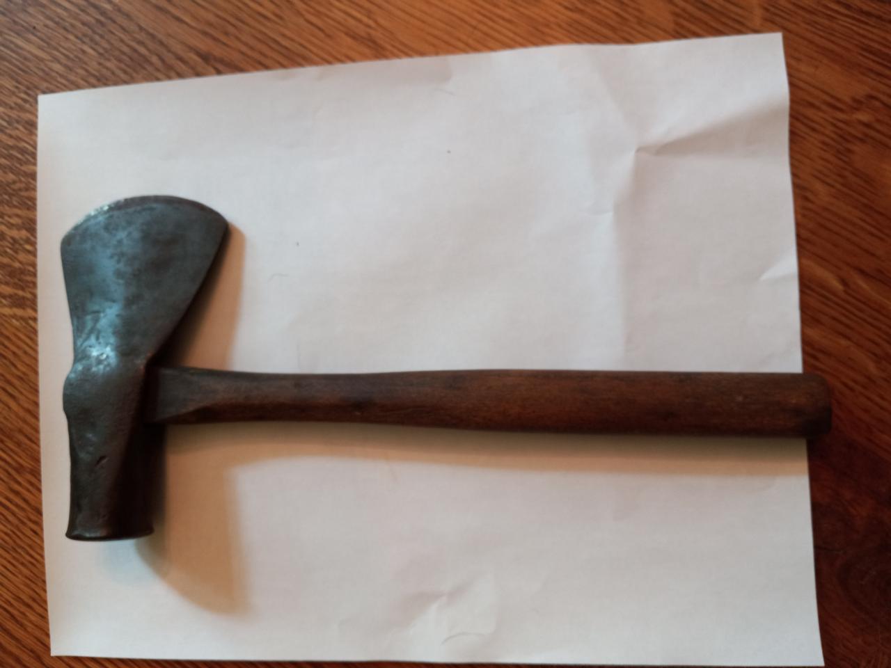

This is the other axe in my collection that I would appreciate any comments/ feedback on. Pretty sure this one is hand forged and handle looks quite old. Based on my research, this one looks more akin to a traditional frontier belt/bag axe.
Dimensions:
5 inches from blade to poll
3inches blade width
10inches overall
15.6 oz

Seems more a tool than a weapon.

Now on this one, I will pause and say in my opinion, this seems like the real deal. Again, there will always be different opinions on these because by their very nature, they are controversial. Hammer pole axes preceded the traditional tool axe, so the only thing that defines one as a weapon and one as as tool are very subtle differences and the time period they were used. Likewise, remember that the pole axe was meant BOTH as a tool and a weapon. The hammer end acted as a counter balance to give a more massive blow, but it could equally be used to chop wood, skin game or hammer in a tent peg. This one appears old, is obviously hand-made and is of an earlier double bearded form. If we accept this as a true hammer pole and not a tool hammer axe, its dimensions indicate that it is indeed a so-called 'bag axe', a more diminutive form compared to a rifleman's belt axe. This is just my opinion, so you can take it for what its worth-

What are your thoughts as to approximate age? My thought was late 18th century to early 19th century. Say 1770s to 1830s...

I think your dating is pretty spot-on, long before the days of 'hardware store' pieces. These tools hung around and were essential for survival. I think it's a great little axe!

I find the slightly offset eye interesting and tool like. Useful to a right-handed person for smoothing and shaping poles and small beams.

Tool. And rather crudely made. The 'side axe' offset is good for woodwork, but makes it a terrible weapon.

A nice piece with some serious age to it, hand forged with wrap around construction. I would call it a camp axe or bag axe.

It could be a butcher's\slaughterman's axe. These often had a poll that was designed to be struck by a mallet thus enabling the blade to be placed accurately. Rather like a woodsplitting axe.

I would say it's a blacksmith made carpenter's / roofers hatchet with what might be a newer "adze eye" (square) style handle made to fit. Not easy to tell from the photos.
