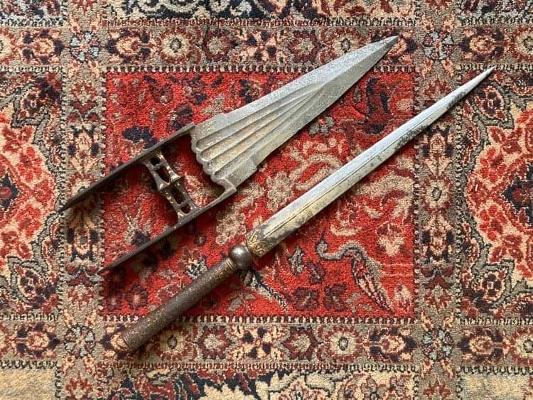

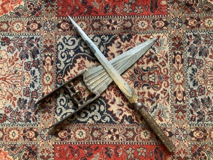

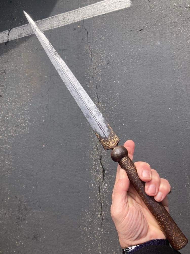

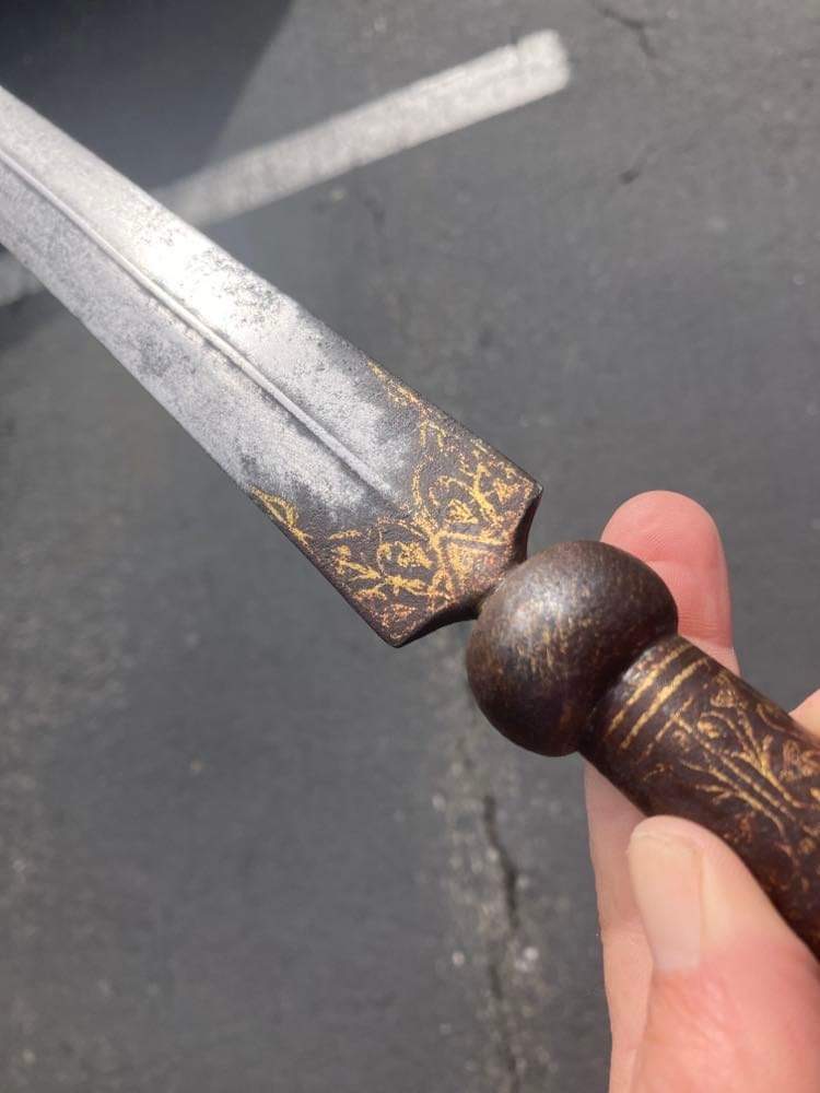

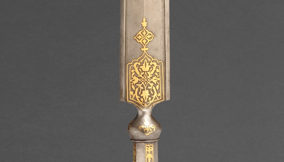

Greetings fellow collectors,
I was wondering if anyone may be able to shed some light on this 20 inch gold damascened lancehead.
Based on its form, does it seem more prone to have been Persian, Syrian, Ottoman, or even Mughal?
The closest example I could find was an old pre Qajar Persian one.
It is very solid, not flexible or delicate, like some of the thinner Wootz Qajar lances. This is pointy and made for serious battle play.
Any thoughts would be most truly appreciated.
Thanks.

Old 28th February 2023, 09:58 PM   #2
It is Indian, more likely Mughal, 18-19 century. A nice one.
Did it come together with the katar?

Thanks Ariel,
No, the Katar I purchased several years ago from Italy. A little worn out, but a large strong specimen.
May I ask what characteristics point to Mughal for the lance head? I’ve never seen a lance of quite this form before.

Old 1st March 2023, 06:41 PM   #5

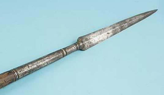

Cheers,

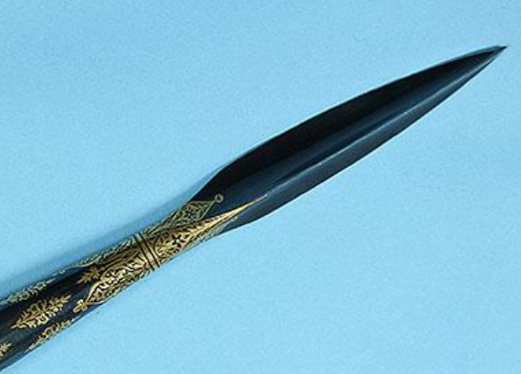

If you google “ indian spear images ” or mughal spear images” ( or something in that mode) you will find a lot of similar ones. Old site of Oriental_Arms had many. Unfortunately, the new one shortened their archives significantly.
As customary for all handmade weapons, there were some differences between items, but generally, the narrow spearhead and koftgari decoration tell the story.Metropolitan museum has several. Here is just one example.

Old 2nd March 2023, 04:53 AM   #6
DavidFriedman
Join Date: Feb 2021
Posts: 113
Default Qajar

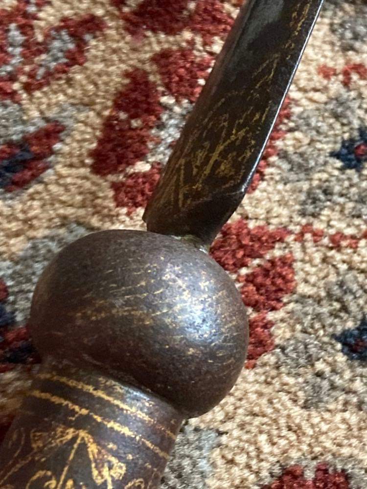

Hi, thanks Ariel.

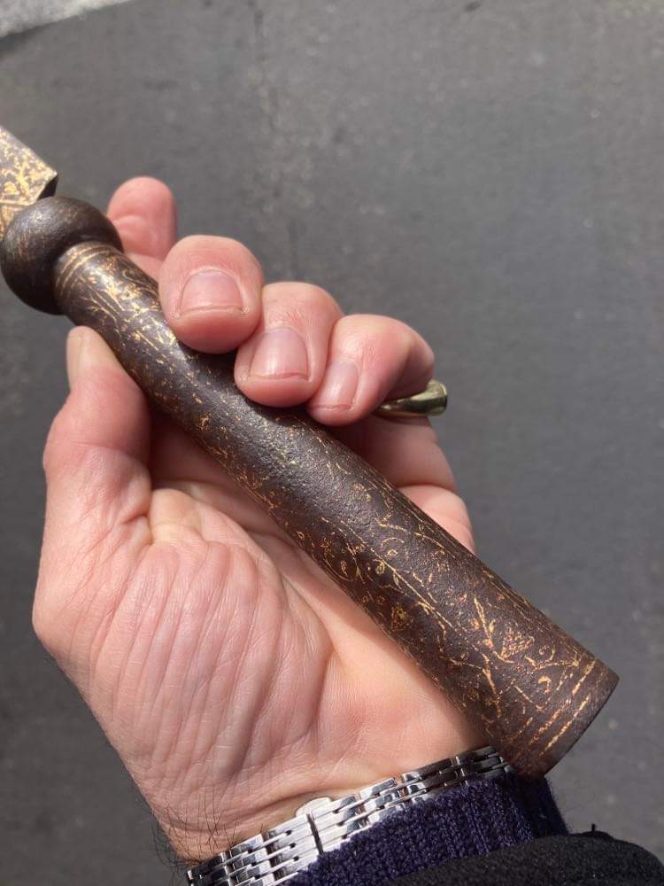

The lance in the picture looks very similar in form to a Persian Qajar lance I used to own. Thinner blade and less diamondesque in cross section profile than this current one I have. The Qajar ones I find have the thin blades, reinforced edge, and smaller ball section between collar and blade.
My one has a solid ball that could act as a small mace it’s so hefty, even though small.
It could well be Mughal, but the one in the picture you show, I am convinced is a Qajar lance, possibly used by Sufi’s, or at least I saw an old photo of a Sufi carrying a similar styled one in your picture.
If I’m wrong, I’m definitely open to correction. Thanks.

Old 2nd March 2023, 06:19 AM   #7

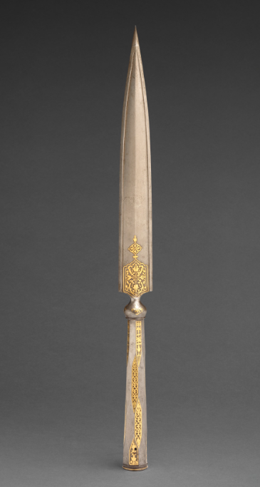

Well, “The Met” attributed it to North India, and it came from the famous collection of Giovanni Morosini who obviously knew where it came from.
As I mentioned before, virtually all Indo-Persian lances have rather similar constructions due to their very well-defined function: cavalry use , lancing the opponent. We have to rely on their decorative techniques and first and foremost on their provenance and attribution by superspecialists. Not having the documents of the former and not being the latter, I have to rely on their collective conclusion. This is in part why I said “ more likely”.
Hi, thanks Ariel.
Hello David.
I fully agree with your opinion. I think this is a Persian spear both in form and decor. The website of the Metropolitan Museum of Art often comes across errors ...
Dmitry

Old 2nd March 2023, 05:18 PM   #12
Hi, thanks Ariel.
Cheers,

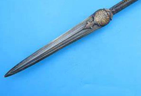

David,
By the 17-18 centuries Mughal armourers produced items identical in quality to the Persian ones. Moreover, there was a strong Sufi minority among the Mughal court and intellectuals. Thus the quality of the execution and religious bents cannot help very much.
I found the old Artzi's site and here are several examples of N. Indian lances from his archives + the Met example. As you see, there are major differences between all of them due to different workshops/masters.
You now have 3 opinions: Mahratt's ( Persia" and Artzi's/Met's ( N. India).
You can choose either. That's the frequent name of the game in our hobby:-)

Sorry... Am I the only one who sees the obvious differences between David's spear head and the spear heads from the Artzi website and the Metropolitan Museum of Art? Is it fair to compare them?

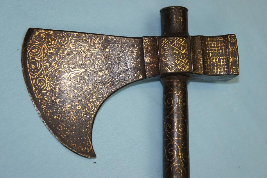

I'll be honest David, I don't know, but in the spirit of looking at it objectively, I would say India when purely considering the manufacture aspects rather than its shape and decoration.
Then a think to myself are the design elements Turkic, similar to this axe I once thought was Turkic, loosely drawn from Henry Landsell materials... but the years have shown me more than one clearly Indian example of this Tabar's head shape, that then points me to the Sindh and Gujarat based on the decorative embellishments found those examples... so that bought me back to India...but as a offshoot, there are Turkish War hammers with these decorative motifs on them too, not an Indian weapon... they were decorated like the image presented and of the same assembly features... perhaps Indian produced and sold those as a regional export to be decorated elsewhere... pondering the ponderous there... so back to the spearhead...
Given the comparative examples, albeit some in a league of their own, and aspects I see, I'd be confident in suggesting India as a point of origin with all aspects considered.
Gavin, thanks for a very interesting analysis! I, too, like you, remembered similar decor Turkish War hammers. But the overall design of the spear head is really more like the Indo-Persian region

I agree with the Indo-Persian origins.

Thanks, I’d never seen one like that before from Indian provenance. I’ve seen many from Qajar Persia. It would be very interesting to me if the design crossed over to India. That particular blade type was flexible and sharp, very similar in overall shape to a kindjal I used to own, but even thinner in profile.

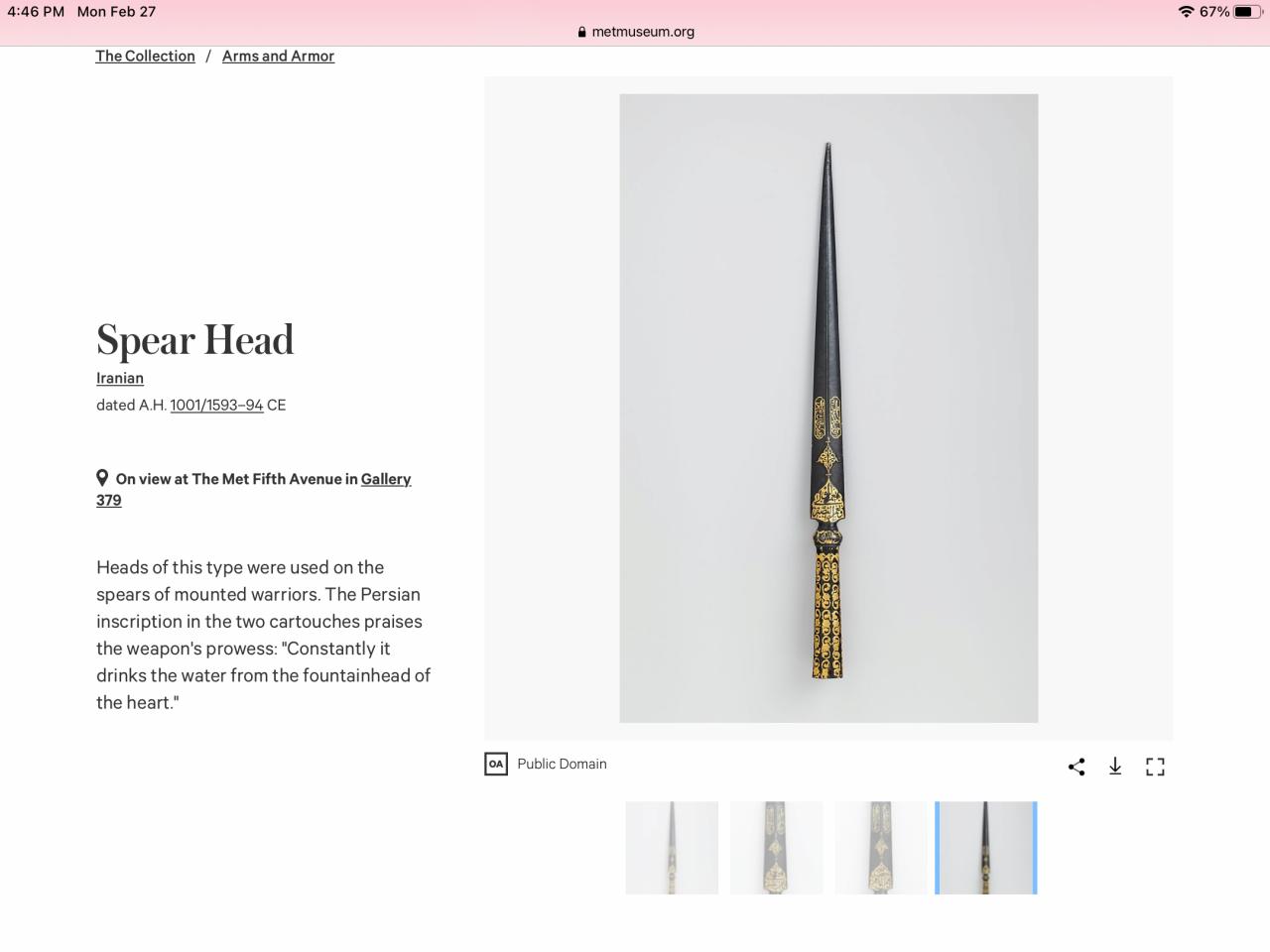

Thanks everyone for all of your input, thoughts and advice. This piece really has me stumped.
I saw this one in the attached pic listed in the MET collection. Attributed to Persia. Albeit the MET example has far superior gold damascene work. I felt that the lines were similar along the center, rib, as well as the profiles.
