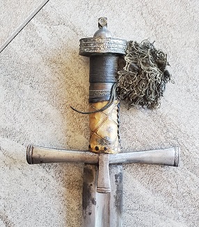

I'd like to know the significance of this sword as at least two people did in this auction. Sold for £100,000

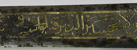

Old 10th December 2022, 11:03 AM   #4
colin henshaw
Join Date: Jan 2008
Posts: 1,432

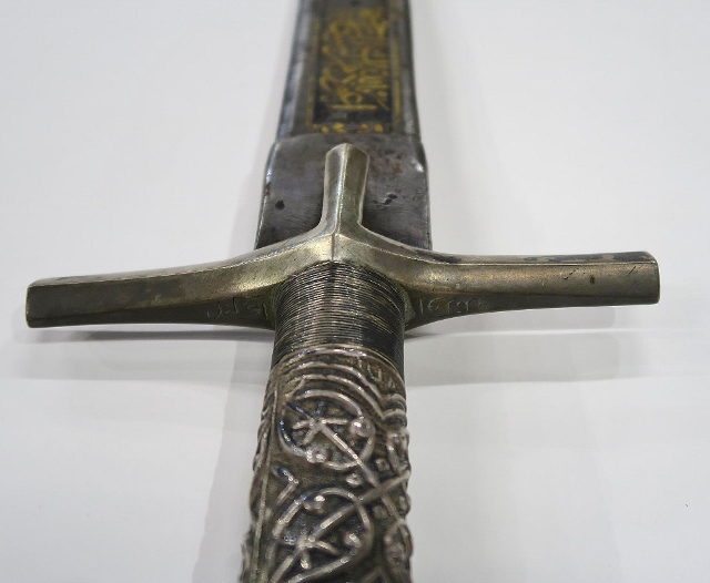

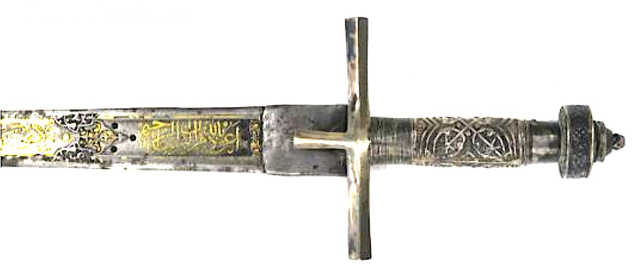

Better photos...

A very wild guess. Someone put a fancy 14th century mamluk sword blade on their kaskara. But hard to tell since the pictures are not super detailed.

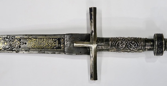

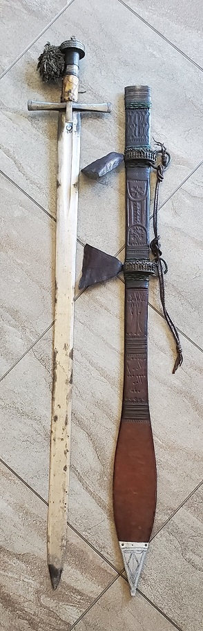

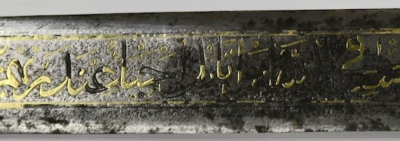

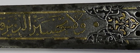

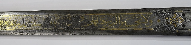

More images. The calligraphic inlay looks like brass ?

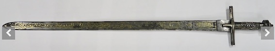

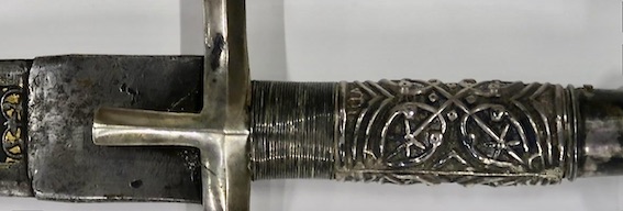

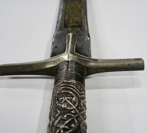

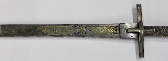

Don't know if these through anymore light on the issue. With commission and tax more like 130K final price.

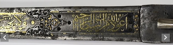

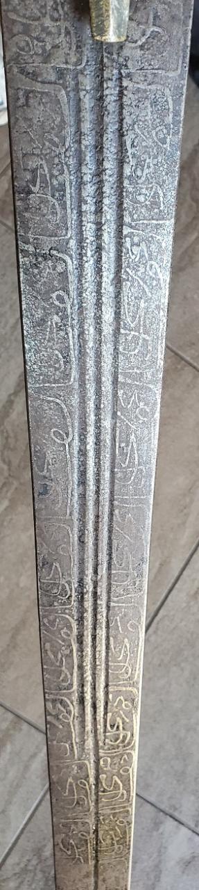

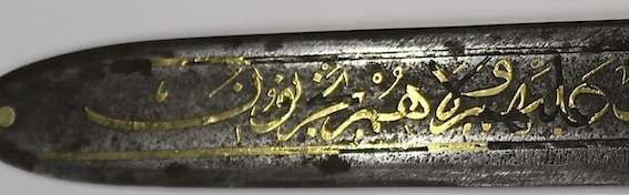

One more.

There is an incised Arabic inscription on the steel crossguard, it would be of interest to learn what it says, as well as the calligraphy on the blade.
Old 10th December 2022, 04:56 PM   #11
Edster
Join Date: Oct 2010
Posts: 452

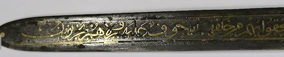

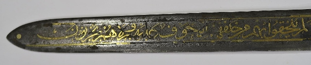

Exceptional Kaskara. The only qualifying personages during the Mahdiya would be the Khalifa or the Mahdi himself. I'm not aware of swords of either that have surfaced. The price is consistent with the best work of Ali Dinar's workshops.
The blade is ancient and imported. The cross guard has interesting lines where it may have been assembled and welded together, but the lines aren't where they should be, i.e. langets should cover the long pieces. It's good quality, but not nearly as good (flared ends) as those on Ali Dinar's swords. The silver cover on the grip is of a design unique to me.
Yes, Colin we certainly could use translations of the engravings and the cross guard as you noted. Note the "gold" dot at the end of the blade. Also, it wouldn't hurt to contact the auction house to see if more details, including provenance, could be discovered.

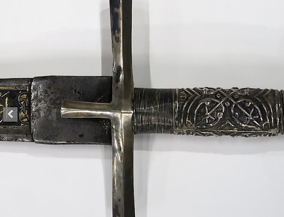

I cannot say that it is that impressive when you look at the file marks on the blade? Also the inlay is probably brass?

It is all about this blade, and with the sword's of the Sudan known as kaskara, we know that in many cases they, and their western cousins, the takouba, often carried very old and significant blades. Blades actually from the Crusades have turned up in takouba.
As Ed has noted, the swords of the Mahdi himself, and the Khalif, are not known, though obviously we know they existed, and a blade of this stature would of course be a good candidate for either. The profuse inscription in latten (inlaid gold metal) appears to be in 'Naskh' (though I have no particular knowledge of the 'pens' of Islamic calligraphy)....which resembles that seen on several swords which belonged to Ali Dinar, the last Sultan of Darfur. Images of these are seen in the late Tony North's "Introduction to Islamic Arms".
When I talked with Mr. North asking the disposition of one of these swords, with inscription laden blades similar to this, he told me the owner was in Malaysia and was unclear on exactly how to reach them.
This type of script is quite contrary to the heavily acid etched inscriptions typically seen on Mahdiyya period sword blades and other weapons, with this form known as 'thuluth' a more rudimentary 'pen' of the Islamic script.
This is a quite early blade as has been noted, the block ricasso indicates, and the gold color metal dot at the tip of the blade is a talismanic/magic (?) type convention often seen on these early Islamic blades (Yucel).
While it is stunning to see a weapon like this, clearly in a relatively common Sudanese hilt, and so vapidly described sell for such a staggering amount, it is clear this offering was well attended by well initiated figures who needed no detailed description, they knew exactly what it was.

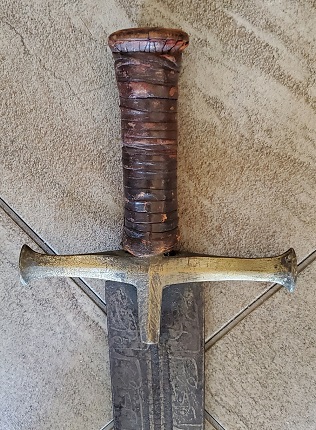

I added some pics, the first two are basically the type of kaskara hilt typically seen (in some variation) during the Mahdiyya (1883-1898) and the profusely acid etched 'thuluth' inscription. These are repeated passages from the Quran used in decorative style, often with other messages added in.
The next two are the kaskara style (often associated with Ali Dinar) which seem to have evolved at some just after the Mahdiyya and during the Anglo Egyptian condominium, particularly in Darfur. Note the heavy discoid pommel and capstan. While these are most often with silver lozenge design on grip, some like this are with crocodile hide, as seen here.
Clearly this example is worlds away from that Norman has shown.
Just wanted to illustrate these variances for those reading here.

Very impressive and interesting kaskara. The blade was definitely a heirloom one, as it has been inserted into mount at the forte, similar to some takoubas. The chiseled, gold inlaid floral decoration at the base of the blade is reminiscent of Ottoman 18th century work, so this is probably one of the oldest blades on a kaskara. It would be interesting if kwiatek or someone else can read and translate the inscription.

The mechanical jammed wooden attachment of the kaskara's blade to the cross guard seems to me to be an innovation to the Mamluk method.
The Sennar (chisel) ends on some cross guards is a kaskara innovation over the rhomboid, as is the welded four part method of fabricating the overall cross guard. Unlike the cast cross guard preferred by the Mamluks.

It would indeed be most important to have these inscriptions translated as this would establish more toward the dating of the blade by the context of the wording and other information. Clearly this is an important blade, which has heirloom connection as Teodor has noted.
While not necessarily the oldest blade from a kaskara, and may well be earlier than 18th century, it is certainly among the often extremely old blades which made their way into Egypt and Sudan.

If it can be linked to the Mamluk arsenal at Alexandria, maybe through the inscription, then £100K seems about right.

Until someone is kind enough to let us know what the blade inscription says, we can only speculate.

I would say the yellow inlay is gold. You can see some loss of the inlay, brass would be heated and stick better while gold is hammered in. Brass dulls and this is all bright. Gold has different shades:
https://en.wikipedia.org/wiki/Gold_(color)
You can also have gold mixed with other metals. To me one bit looks as if it's peeling up suggesting it is quite soft.
Just an opinion, having it in hand makes discerning it's material more easily.
