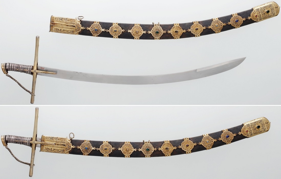

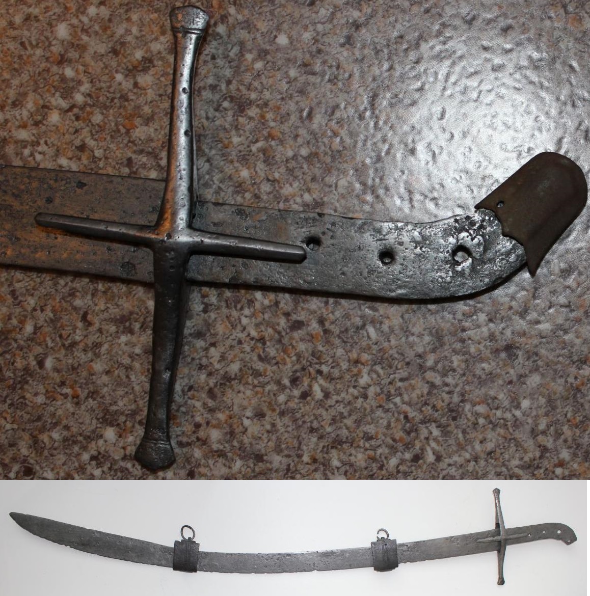

Hi all,
I´d like to make a little listing available here as a PDF file. It is about sabers used in the area of the Polish-Lithuanian Commonwealth and Hungary. It is not about the production origins, solely their existence in a time period based on comprehensive paintings. I noticed there seem to be some misconceptions on forums and auction houses when it comes to dating these swords and talk is cheap so I decided to collect some contemporary depictions of sabers and match them as best as possible with photographs of specimen.
Also reading books about this topic I wonder sometimes why some authors date certain swords in a specific way: Turns out sometimes that authors rely on books written a hundred years ago and take what was then nothing more than a working hypothesis as pure fact. This is annoying. Since these paintings are all veryfied when it comes to their production date, it´s an elegant way of "proof" for a dating.
Please note that the age of the sabers depicted on the photos do eventually not correspond 1:1 with the depiction on those paintings because those have been used throughout many decades.
Some time gaps still remaining because of the lack of contemporary visual sources.
Patrick

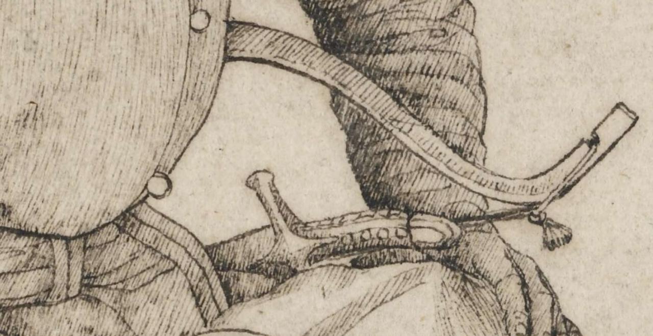

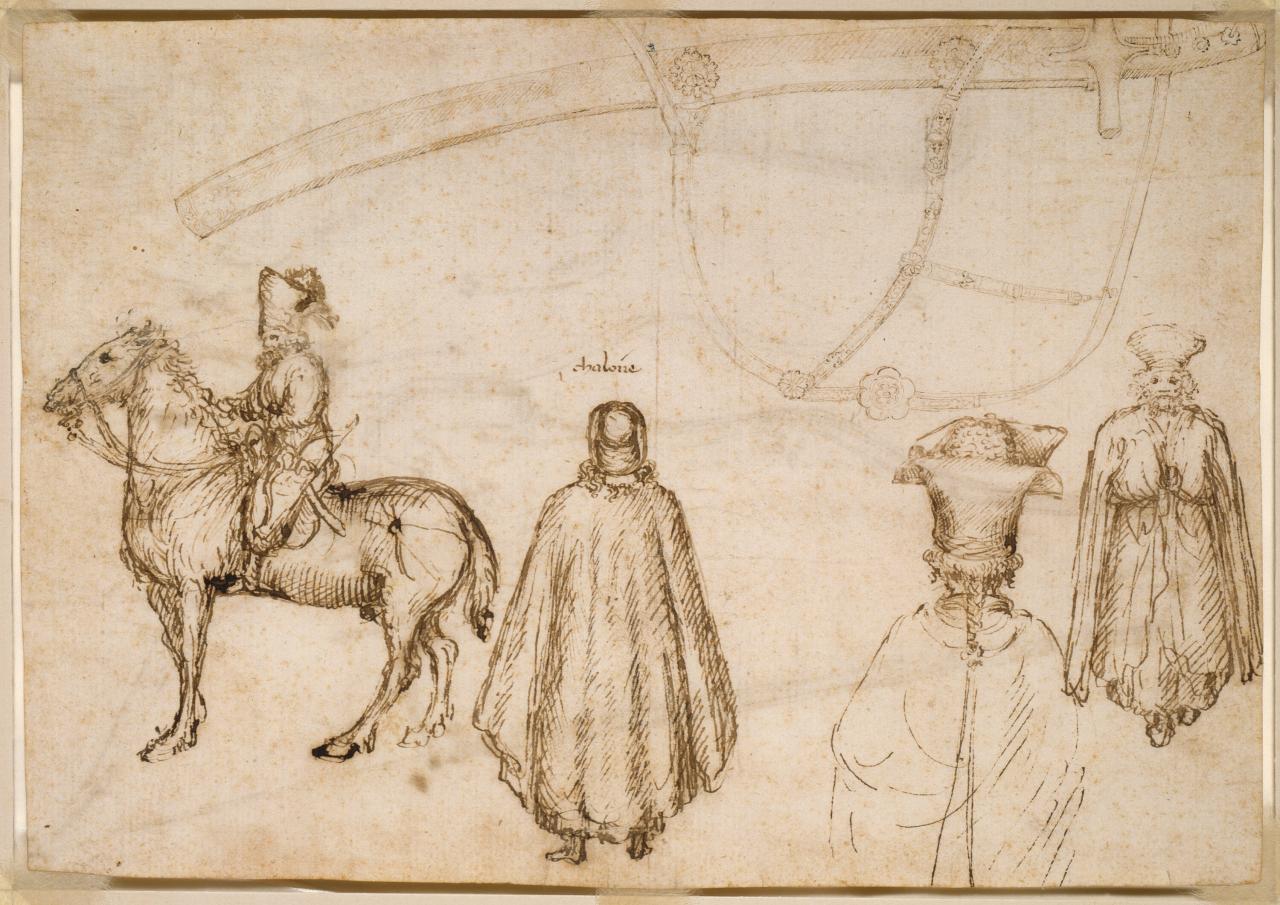

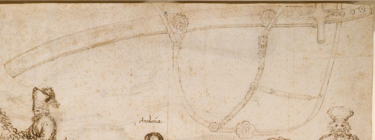

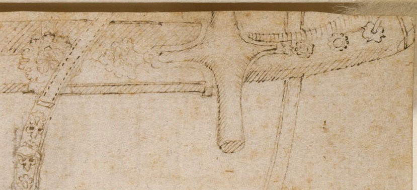

A few beautiful drawings by Italian artists from the 15th century of Ottoman/Byzantine people (and their sabres). Luckily in high resolution . This kind of artwork really tickles my fancy .
1 - Sketches of the Emperor John VIII Palaeologus, a monk, and a sabre - by Pisanello in 1438:
Source: https://www.artic.edu/artworks/11356...rd?q=Pisanello
I highly recommend studying the high-resolution version in the link.
PS: There is also a depiction of a bow and quiver here (https://www.artic.edu/artworks/11356...iver-of-arrows) and another depiction of John VIII Palaiologos (https://commons.wikimedia.org/wiki/F..._Pisanello.jpg). Although not really relevant to this discussion, still nice.
Teisani is offline   Reply With Quote

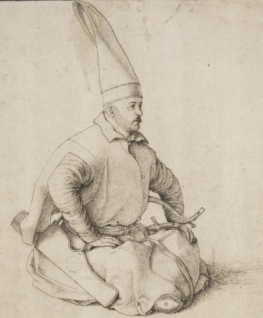

Posts: 314
2 - Ottoman janissary by Gentile Bellini 1479 - 1481 (probably at Constantinople).
Source: https://www.britishmuseum.org/collec...ject/P_Pp-1-19

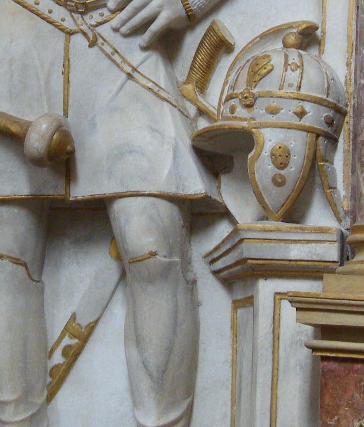

3 - Ippolito de' Medici in Hungarian costume by Tiziano Vecellio in 1533.
Source: https://it.wikipedia.org/wiki/Ritrat...o_de%27_Medici & https://gallerix.org/album/Titian/pic/glrx-323132363
I know I posted this one before, but it's worth posting a close-up of that sabre.

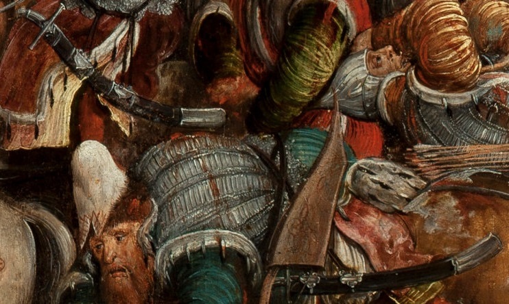

4 - Battle of Orsha/Bitwa pod Orszą - probably by a painter from the circle of Lukas Cranach the Elder, most likely Hans Krell in 1525 - 1535.
Of course I posted this one, I'm only human..couldn't resist! The famous painting depicting the battle of Orsha from 1514. It's a real treasure for anyone interested in that period/region's weapons.
Nice summary about it can be found here: https://www.youtube.com/watch?v=ILwHcl8y2fk
Source: https://en.wikipedia.org/wiki/Battle...Orsz%C4%85.jpg
The painting is much too big and detailed to post in low resolution here, so instead here are some close-ups.
Muscovites

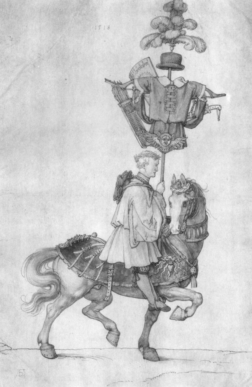

5 - The great triumphal chariot, detail: The Hungarian trophy by Albrecht Dürer, 1518 original.
Detailed design for the woodcut sequence of imperial triumphal procession Maximilian I, printed in its entirety for the first time in 1526, Dürer was responsible for the design of the carriage with the marriage of Emperor Maximilian to Mary of Burgundy and published it in 1522 in eight sheets.
Source: http://www.zeno.org/Kunstwerke/B/D%C...?hl=ungarische
Not very detailed, but every source helps.

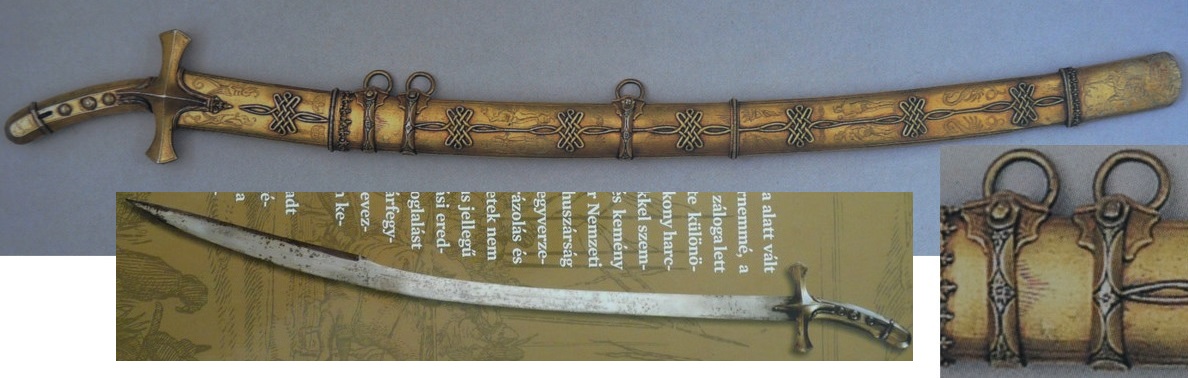

6 - Nikola IV Zrinski (Hungarian: Szigeti Zrínyi Miklós; 1508–1566), Ban of Croatia from 1542 until 1556.
Source: Leónidasz a végvidéken. Zrínyi Miklós (1508-1566) by Varga Szabolcs
Note: I've posted this one before, but this one's in higher quality.
Source: https://docplayer.hu/222752167-Tanul...-szablyak.html
The sabre resides at the Museum of Fine Arts in Vienna (Kunsthistorisches Museum Wien), Austria. According to Prof. dr. Major General József Padányi, the likely year - with the dragon coat of arms of the Zrínyis on the grip caps - is 1563. At that time, Miklós Zrínyi was at the height of his power, and at the coronation of Maximilian II (King of Hungary September 8, 1563 - 12 October 1576), the saber could have been a gift from Zrínyi, who carried the state apple, as a souvenir. A painting was also made of this event, proving the above.
The previous posted source dates the painting to 1541-42. So, it's a bit confusing.

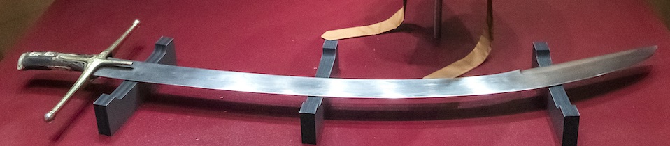

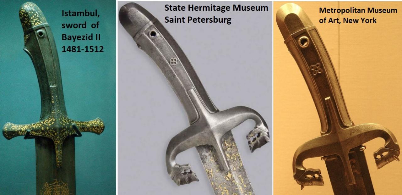

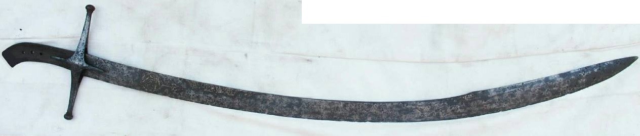

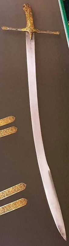

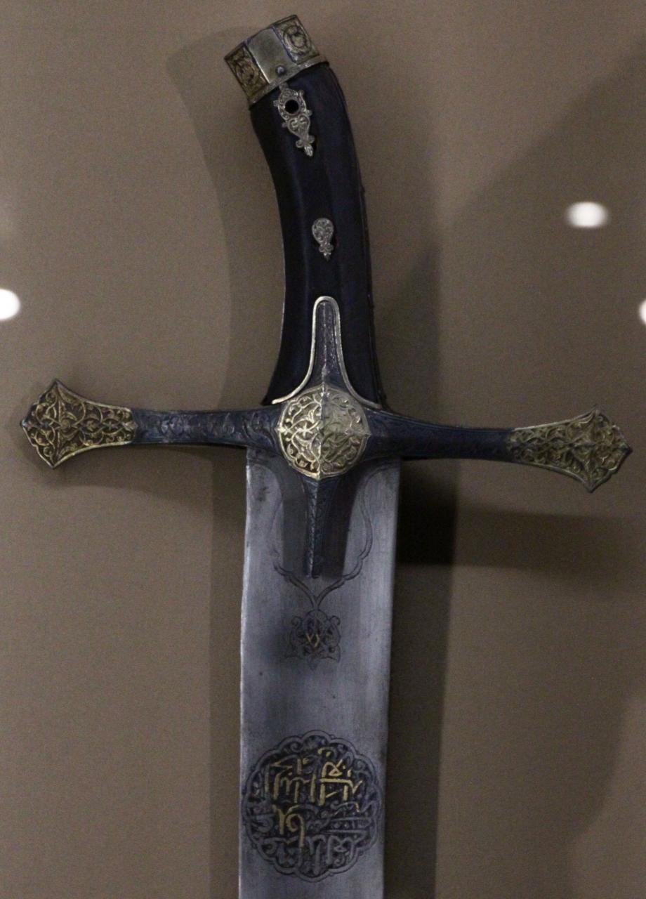

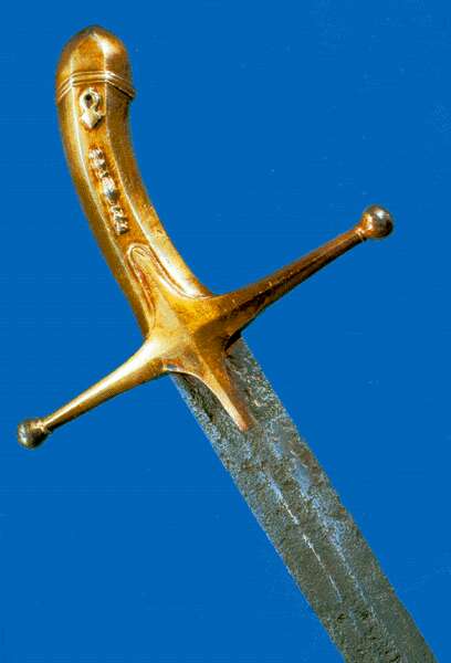

7 - "Gothic" sabre (1470?-1520?) at the Magyar Nemzeti Múzeum Budapest
This is probably the oldest Hungarian sabre known. It also has the earliest depiction of a hussar, on the scabbard. Most likely originaly Ottoman sabre (from 1470-1500?), later (probably during the 1510s) its scabbard was modified to incorporate the hussar depiction. Another reason to classify this as Hungarian rather than Ottoman is the representation of Adam & Eve on the scabbard. So not much is known about this one. The best source of info on this one, I've found is "SZABLYÁK A KÉSŐ KÖZÉPKORI MAGYARORSZÁGON by KOVÁCS S. Tibor" https://library.hungaricana.hu/en/vi...g=270&layout=s
There are a few other ottoman swords with similar hilts around the world (Turkey, Russia, and USA).

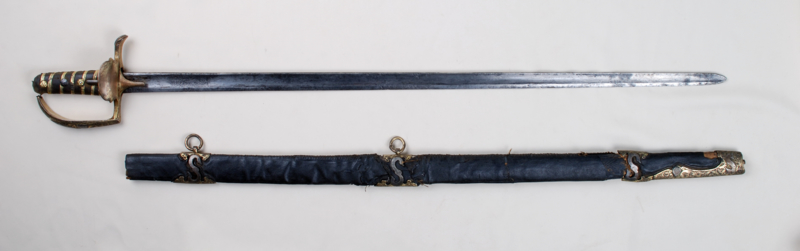

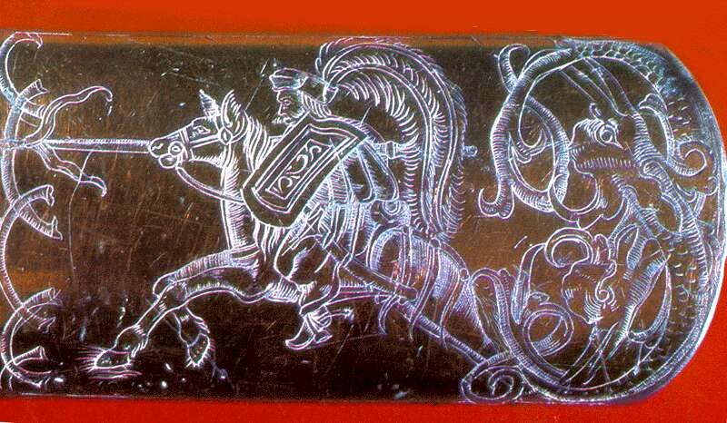

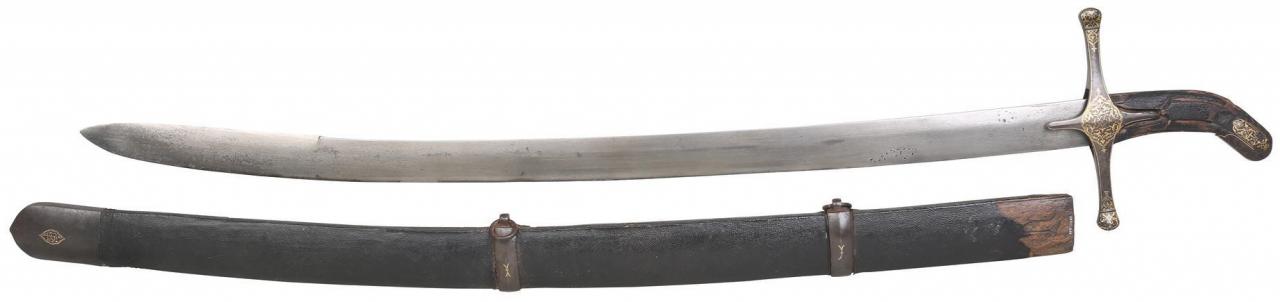

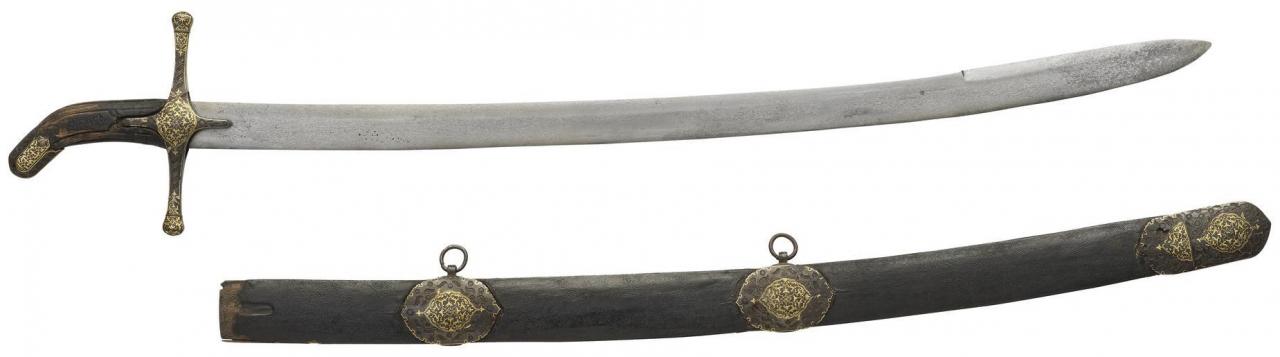

8 - Szikszó sabre
Discovered in Szikszó, Borsod-Abaúj-Zemplén county, Hungary. Currently resides at the Magyar Nemzeti Múzeum, Budapest. Can find no other info on it.
https://sites.google.com/site/hagyom...zablya-szikszo

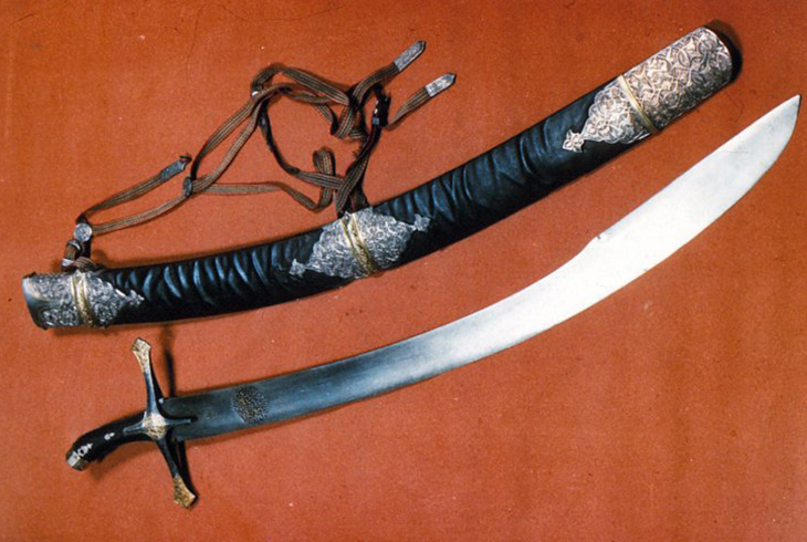

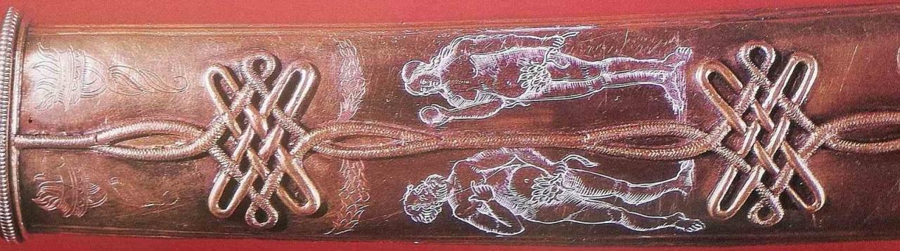

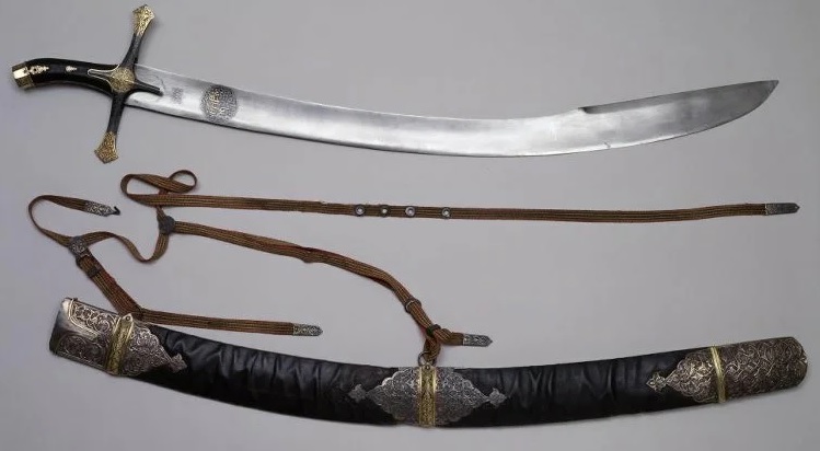

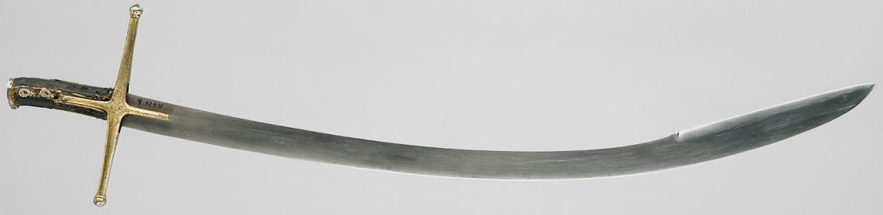

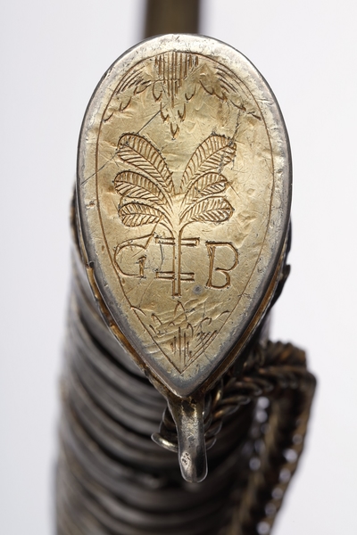

9 - Bebek György sabre
Bebek György (lived 1529-1567), became a prisoner of the Ottomans in 1562 but was released in 1565 from captivity and given this sabre by sultan Suleiman I the Magnificent.
For his own salvation, György Bebek secretly offered Hally Pasha, who had contact with the Luminous Padisah, 50 Turkish prisoners, 10 thousand gold ducats, and many silver and gold adornments, which his worried wife, Mistress Zsófia Patócsy, sent to the Porta in Stambul. As a result of this "carrot", George Bebek was led from his place of detention to the Divan, the highest political center of the Ottoman Empire, on March 6, 1565. He was dressed in an expensive kaftan so that he could pay homage to the Sultan in a dignified manner. Bebek kissed the hand of Suleiman I, who sternly urged him to be a supporter of his Hungarian vassal, John Sigismund, and served him afterwards. At Suleiman's behest, the court officials brought forth a splendid Arabian thoroughbred, which was surrounded by a shiny, expensive horse tool. Other pashas gave him another four horses. In order not to go home as a beggar, bags of money were placed in the pockets of his robes, totalling 10 thousand ospora (aka acpe, Turkish silver coins). Among the gifts was handed over a superb saber, the main character of this article.
The blade has an inscription: Amel-i Mohammed Misri (the work of Mohammed of Egypt)
Total Length: 94cm
Blade width: 3.3cm
Weight with scabbard: 2kg
Source: https://www.szadvar.hu/2021/07/bebek-gyorgy-szablyaja/

Posts: 314
9 - Bebek György sabre (continued)
Personal opinion...Bebek's sabre seems to be a typical (my estimates 1540s to 1590s) boot hilt, with wire wrap, long quillons (about same length as the handle). Yet it was a gift from the Sultan. The question is whether:
- the Sultan had craftsmen that could make Hungarian style hilts.
- it was a looted by the Ottomans, later gifted to Bebek.
- the sabre's original hilt and scabbard was changed later between the 1565 (release date) and 1567 (year of death). My opinion no likely but who knows.
Really interesting... Bebek's sabre looks very, very similar to this sabre in Sultan Mehmed IV (1642 – 1693) portrait in 1682. I really wonder if this painting is authentic (no idea if yes or no), or why would the Sultan be wearing a Hungarian sabre, 100 years out of date. Really strange! Anybody else have any idea/opinions about this painting?
Source: https://en.wikipedia.org/wiki/Mehmed...med_IV_(2).jpg

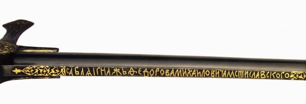

10 - Knyaz (prince) Fyodor Mikhailovich Mstislavsky (? - 1540)
This one is a Muskovite sabre, reminescent a bit of some sabres depicted in the "Battle of Orsha" painting. On the blade's spine there is the incription "Сабля Князь Федора Михайловича Мстиславскаго/Saber of Prince Fyodor Mikhailovich Mstislavsky". The blade is made by "Abdul-Ali Qasim from Egypt". Looks like a typical Ottoman sabre of the era, except for the flat end-cap.
Total length: 102cm --- Blade length: 86.36cm --- Blade width: 5.65cm (8cm at the yelman) --- Thickness: 0.8-1cm --- Quillon: 22cm --- Languettes: 10cm --- Weight with scabbard: 2.6kg
https://ru.wikipedia.org/wiki/Мстисл...ич
https://pikabu.ru/story/istinno_boga...vskogo_4919872
https://mayak-parnasa.livejournal.com/1227109.html

11 - Two more Muscovy sabres? They look a bit like some of the sabres in the "Battle of Orsha painting".

12 - Ottoman/Mamluk sabre (probably from early or mid 16th century??).. It's hilt is reminiscent of some sabres depicted in some portraits, like Jan Zamoyski's (https://en.wikipedia.org/wiki/Jan_Za...n_Zamoyski.PNG) & Jan Daniłowicz's(https://en.wikipedia.org/wiki/Jan_Da..._Ruthenia).PNG). Portraits also posted above.
The blade is very similar in nature to a group of 15th-century blades which have been housed in the imperial armoury in Istanbul for centuries, which are all identified as being Mamluk in origin. These swords would have been brought back to the capital city by Ottoman forces after they had battled the Mamluk armies in Syria and Egypt during the late 15th and early 16th centuries, ultimately defeating them at Ridanieh in 1517. (See U. Yucel, Islamic Swords and Swordsmiths (Istanbul, U.I.C. Research Centre for Islamic History, Art and Culture, 2001), pp.93-113 for various published examples from this group of slightly curved swords with blades of Mamluk provenance and hilts attached later by Ottoman craftsmen, all part of the collection held in Topkapi Palace.) The blades were later remounted with a variety of different hilt forms by Ottoman craftsmen. It is likely that this sword received the same treatment and was refitted with furniture made to appeal to Turkish taste. The foliate ornamentation on the metal fittings is typical of the style present on many of the weapons and objects of decorative art emerging from the workshops of the Ottoman court during the 16th century. The empty indentations visible on the mounts would probably have housed precious or semi-precious stones. The hilt, scabbard clasps and chape closely resemble another set attached to one of the sacred swords in the Topkapi Palace in Istanbul which is said to have been associated with 'Abu'l Hasene (Abu Hasan), scribe of the Prophet of God’, and is thought to have been remounted by court craftsmen around 1560. The hilt form with its long spatulate quillons is similar to others produced and illustrated during the reign of Suleiman I (Suleiman the Magnificent), Sultan of the Ottoman Empire 1520-1566. (See Ricketts and Missillier, 'Splendeur Des Armes Orientales' (Paris: Acte-Expo, 1988), p.157.)
Blade Length 817 mm
Scabbard Length 830 mm
Scabbard Weight 0.457 kg
Sword Length 960 mm
Sword Weight 1.154 kg
Source:https://collections.royalarmouries.o...c-object-31132

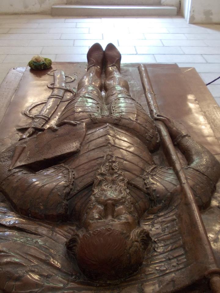

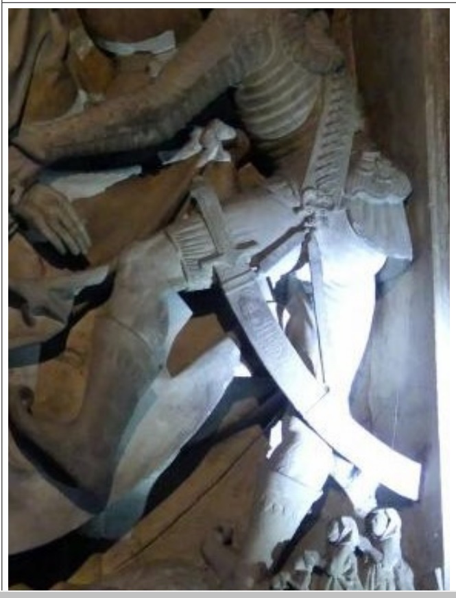

13 - Tomb effigy of Balassa Menyhért/Melchior Balassa (1511-1568) - in the church of Sološnica, Slovakia.
Inscription on the tomb says:
To the famous and important hero Melchior Balassi of Gyarmat, enlightened to advice, magnanimous in faithfulness to his promise, he had this monument built by his father, highly esteemed, son Štefan Balassi. He died in Vienna in the year of Christ the Lord 1568, in the month 9. At the age of 57 years.
Nice triple fullered blade...no Ottoman blade for Melchior . Since it was his son that had the effigy made, we don't really know how much later after his death it was. About his son Štefan Balassi/Balassa István we know:
His second son, Stephen, freed from Báthori's captivity in 1570, became a supporter of King Maximilian, from whom he received several estates. He set up a printing house in Detrekő, where in 1584 the ecclesiastical sermons of Peter Bornemisza began to be printed. John B. became famous at a young age for his duel with the Spanish valiant Francesco de Lasso, in which he defeated his powerful and boastful opponent. In 1550 he became captain of Szolnok Castle, and in 1555 leader of the rising nobility and captain of the mining towns: in 1562 he was already the high sheriff of Hont and Zólyom counties, and as such he laid siege to the castle of Szécsény, but after receiving a wound on his hand, he abandoned the siege. In 1569, together with his relative István Dobó, he was tried for calling on János Sigismund Szapolyai to attack Maximilian. He was thrown into prison, from which he was freed. In 1572, he was pardoned by the intercession of the National Assembly, and in 1574 he became a royal chief doorman and an examiner of appellate cases. In 1575, the castle of Kékkő was occupied by the Turks. A year later, he died.
So, between 1570 (Istvan's release) and 1576 (István's death).
https://hu.wikipedia.org/wiki/Balassa_Menyh%C3%A9rt
https://malackepohlady.sk/?p=1718
https://ujkor.hu/content/emberveres-...fosztas-forras
https://malackepohlady.sk/?p=22263

Wonder what kind of sabre he had https://hu.wikipedia.org/wiki/F%C3%A1jl:Gregor_Baci.jpg
