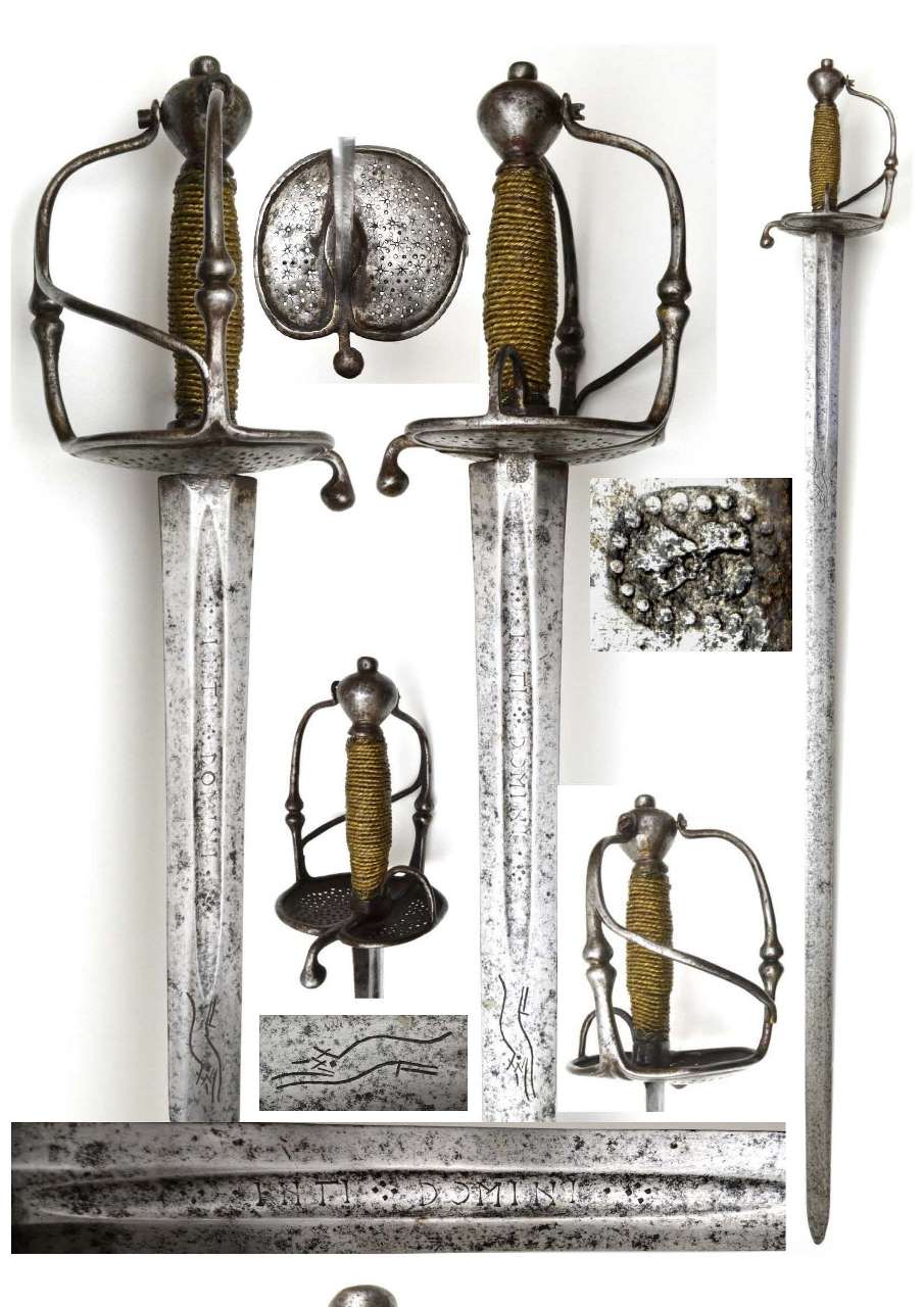

Walloon-c1670-Broadsword-Inti Domini
Good. 35" straight double-edged blade with light staining & clear markings, short single fullers inscribed INTI DOMINI (Innermost with the Lord) & struck with the running wolf mark; grey finish to steel hilt with thumb ring on the inner side; urn shaped pommel & pierced kidney shaped guard; grip re-bound with woven brass wire; n/s. A good early sword C.1670.

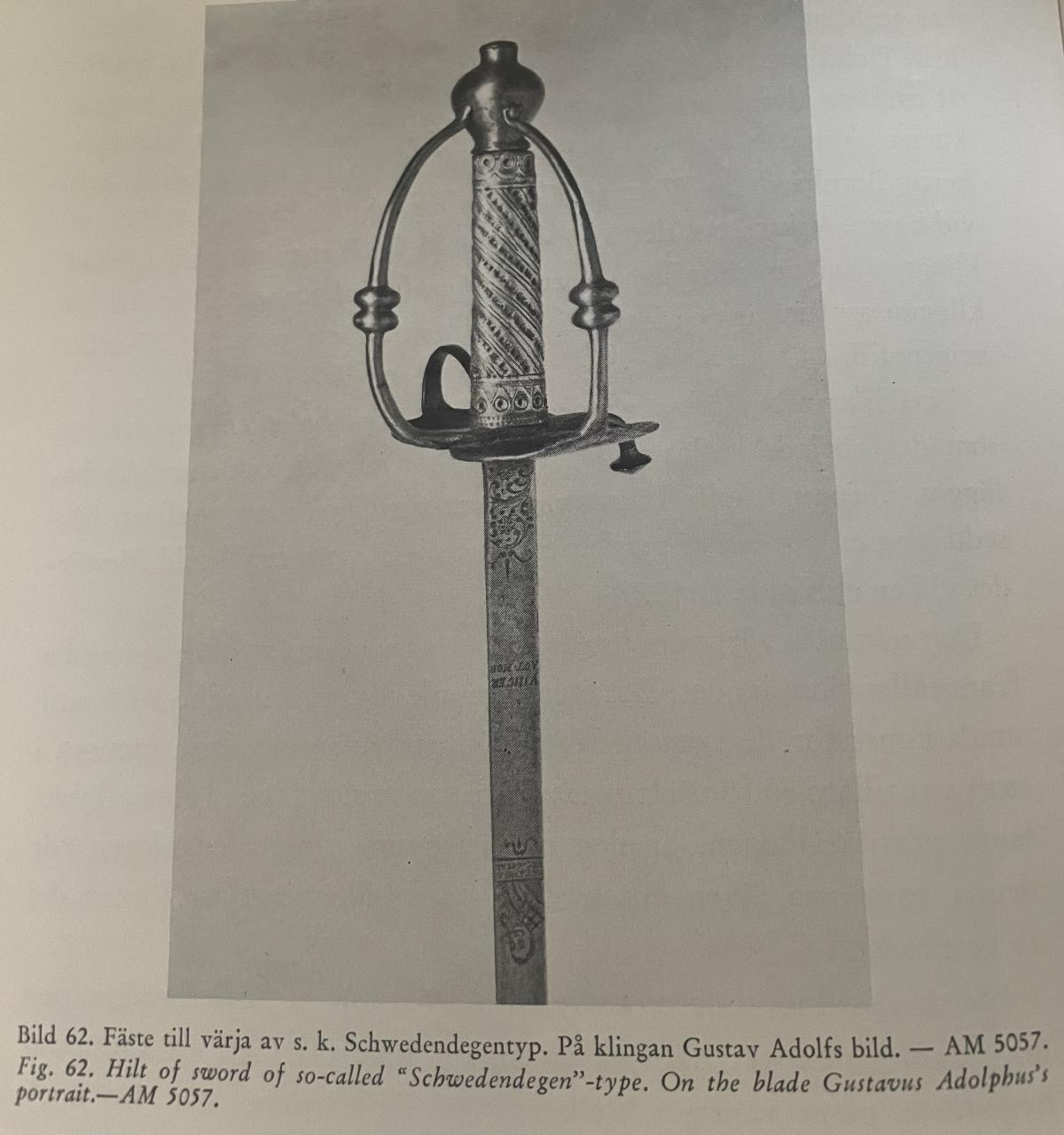

I strongly discourage you from identifying these type of swords as Schwedendegen or Schwedensäbel since this means Swedish sword and sabre (not Swiss!). People from non-European continents often mix up Sweden and Switzerland which have some similarities in character but are very different countries in Europe.
As I mentioned in post #2 already: “Nobody in Sweden knows why the Germans sometimes call it Schwedendegen/Schwedensäbel (Swedish sword/sabre). It seems to be a German term dating back to the 30-year war. These swords were never common in Sweden.”

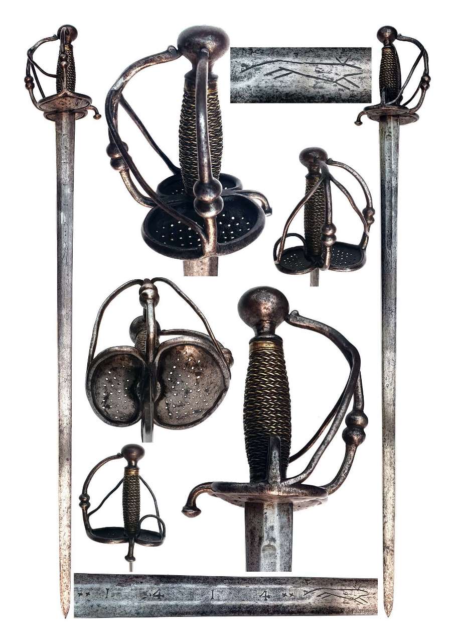

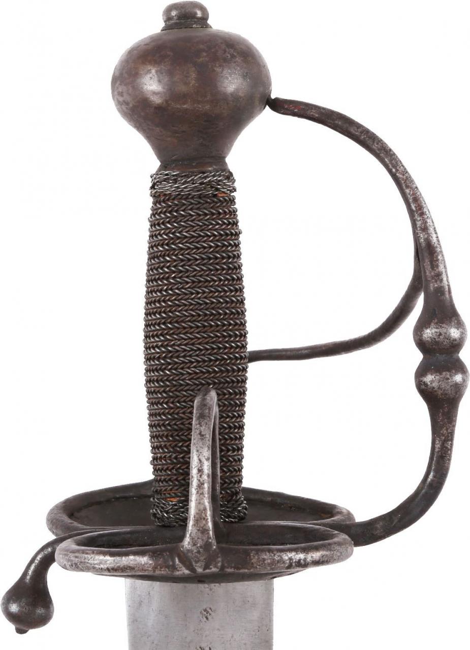

I have found the thread to be very informative and have restrained my own thoughts due to real ignorance of the scope in time we are looking at.
The more I read of the descriptive terms, it seems like a timeline needs to be included to categorize the specific forms. Walloons best regarding the late century infantry swords.

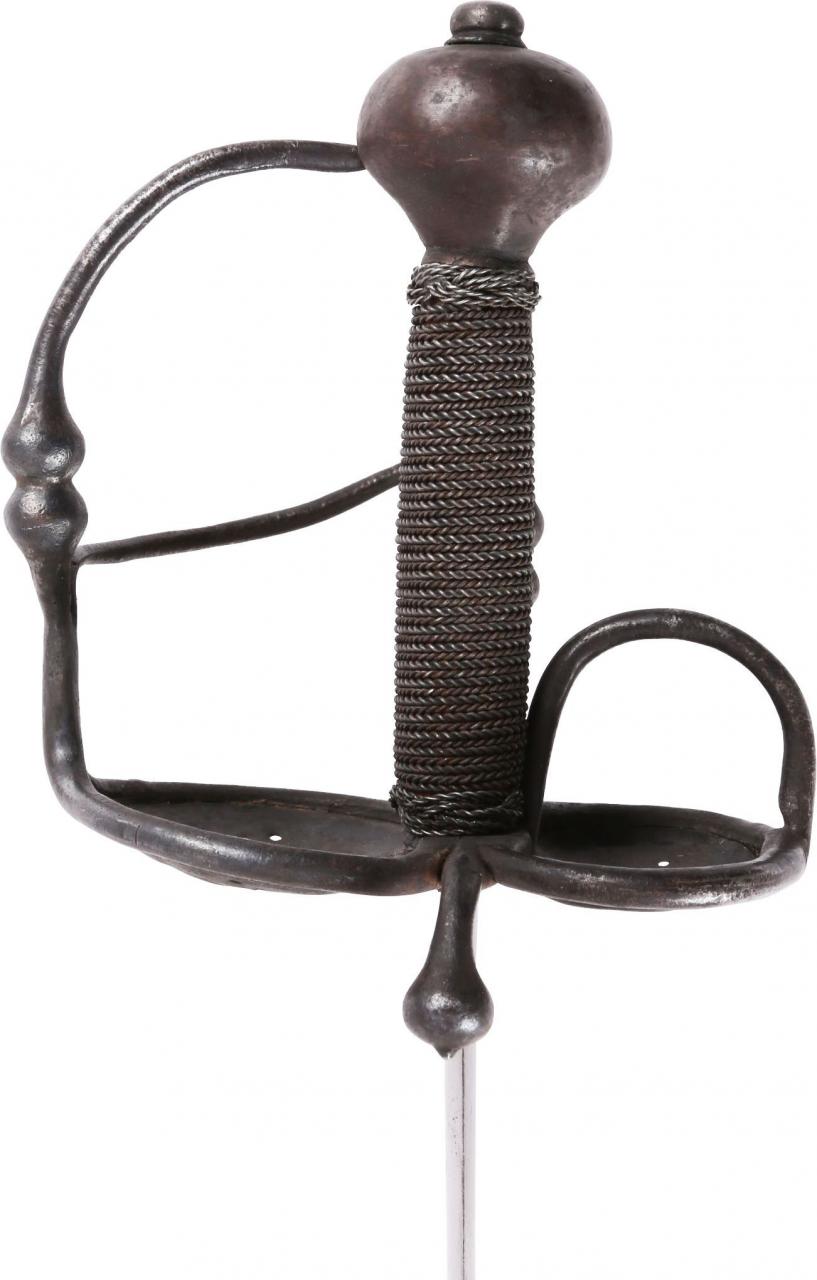

My one example may be later 17th century, with the fully developed inboard plate. Also a plain broad hewing blade of cavalry length.
Some descriptions get parsed to death as to literal meanings, so that just adds more to simply calling everything a walloon (when they are not).
Thanks for this thread!

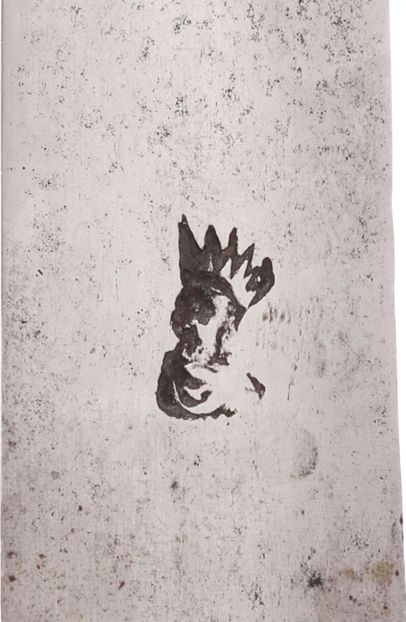

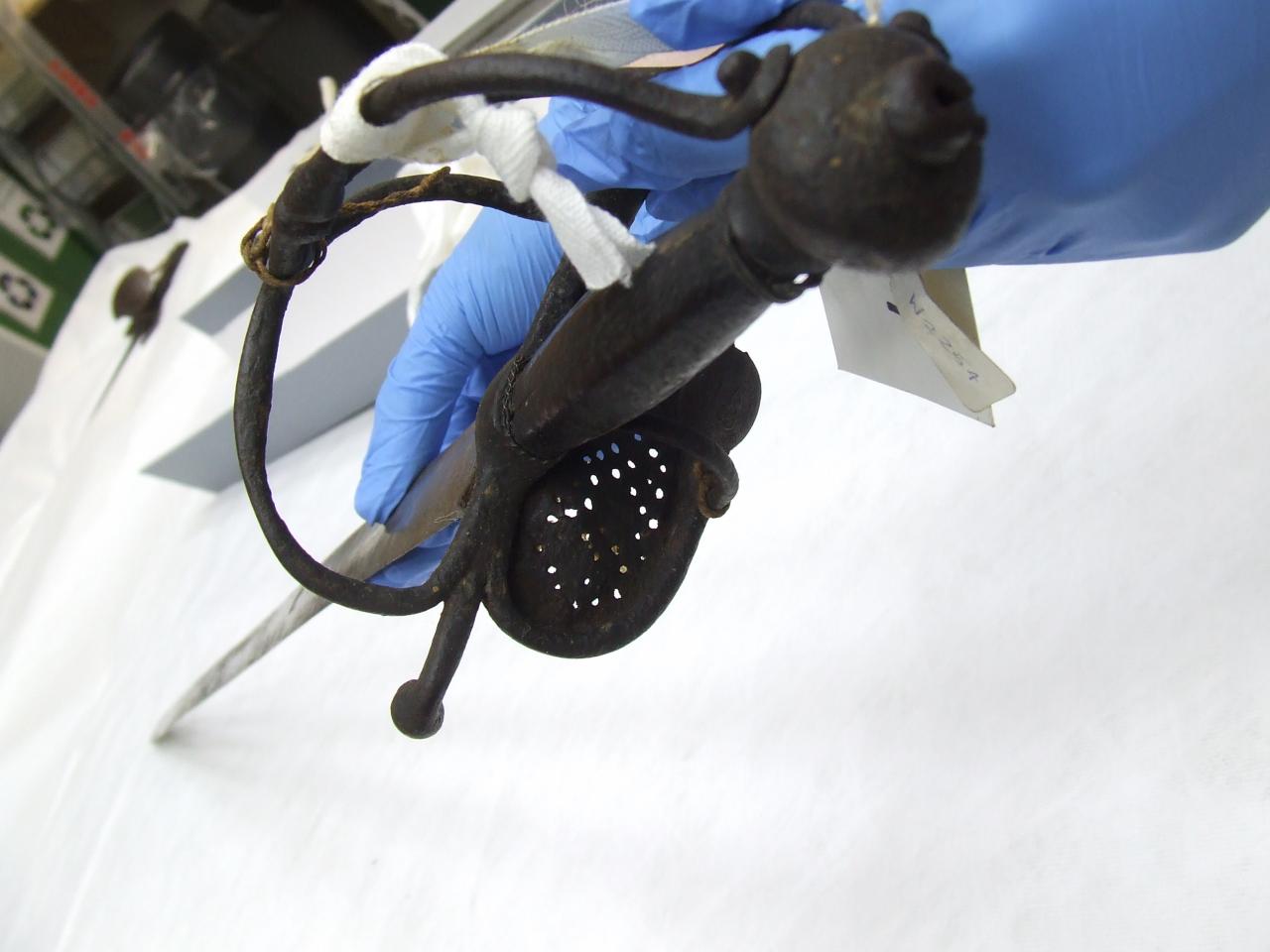

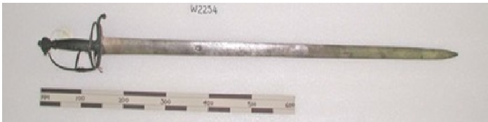

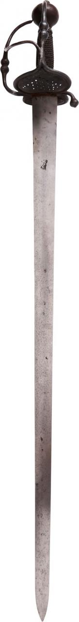

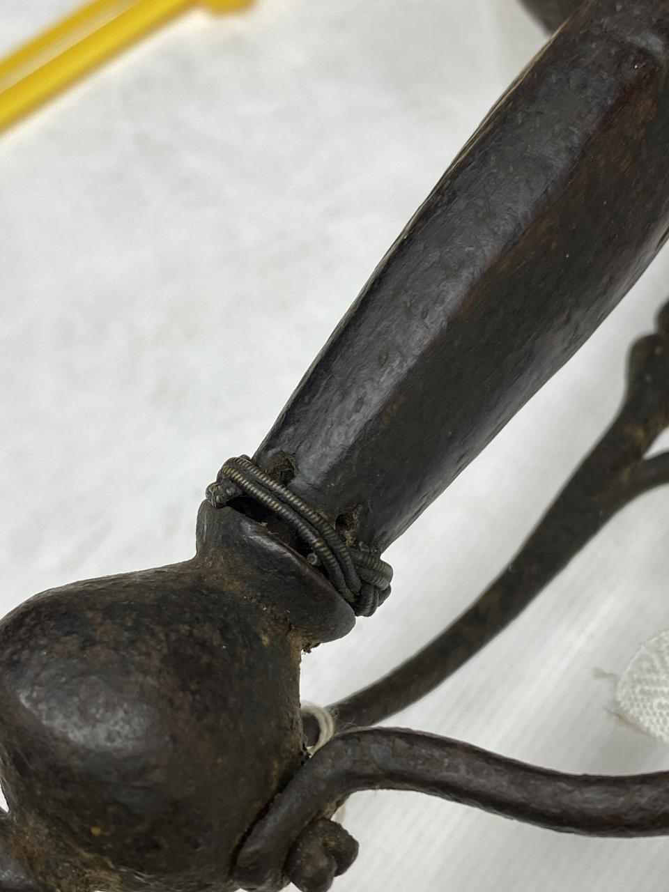

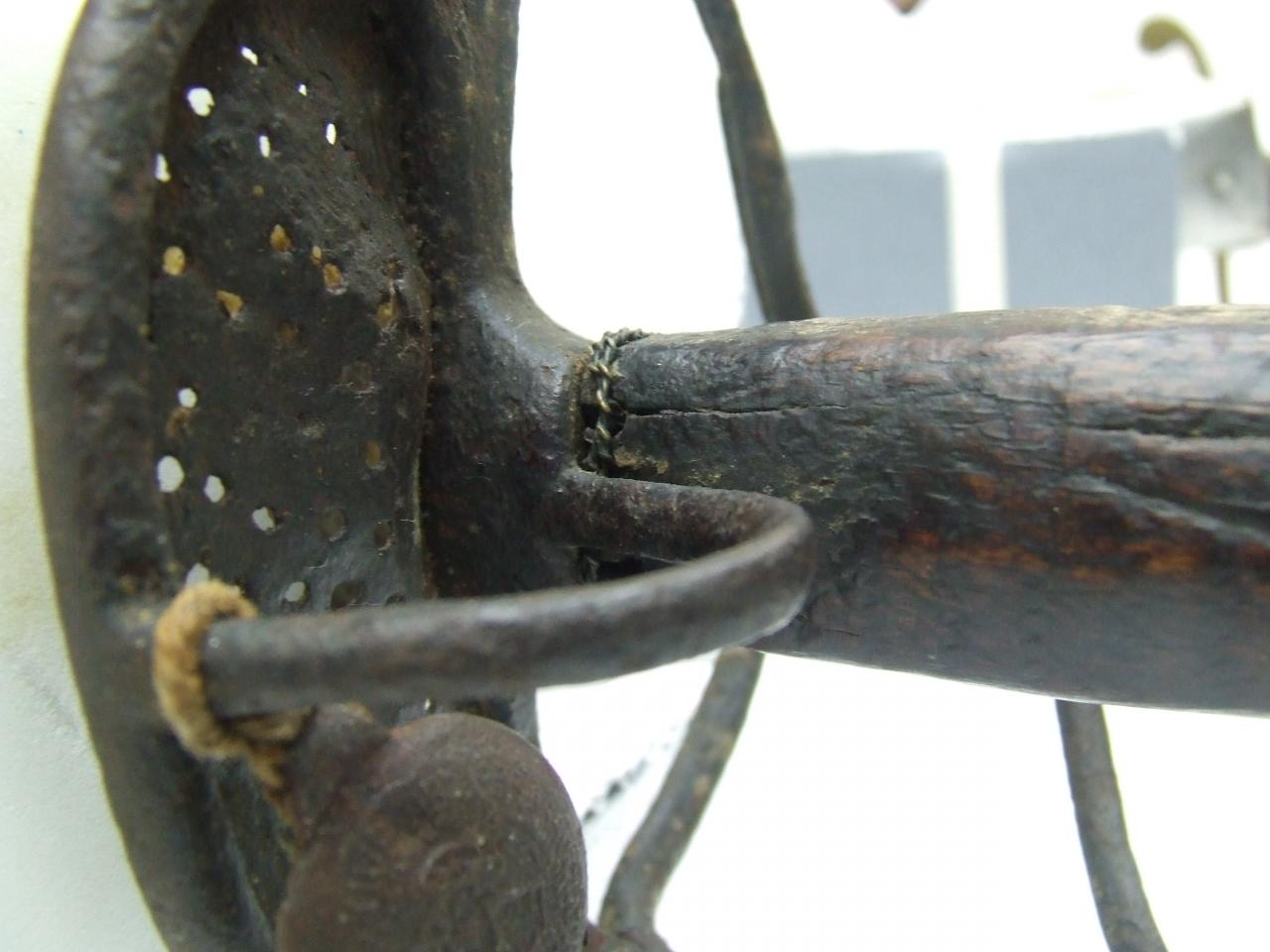

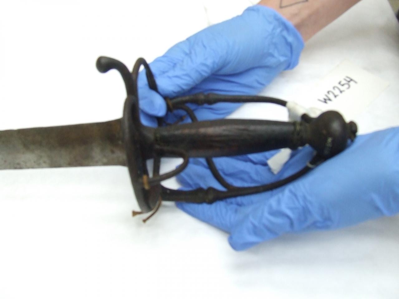

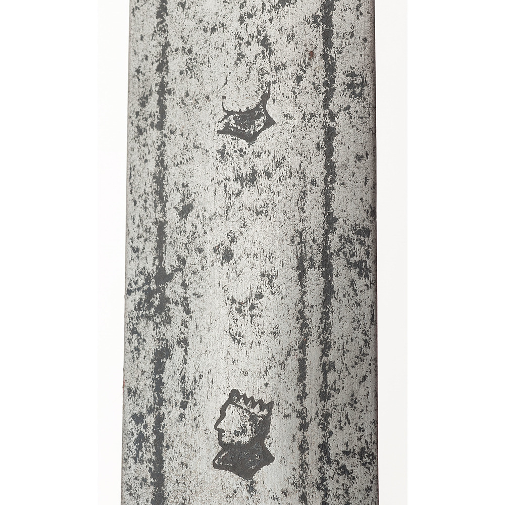

So here is the walloon type sword with a kings head mark I found in the Auckland War Memorial Museum, which they had mislabeled as a rapier!
My initial research into the Kings Head turned up the Wundes family but upon further digging I figured it had to be Martino Antonio because it faced left. Now you show me pictures that say the Wundes family mark could face either way. If anyone has any firm idea of this exact mark it would be appreciated, no other marks are to be seen on the blade.
toaster5sqn is offline   Reply With Quote

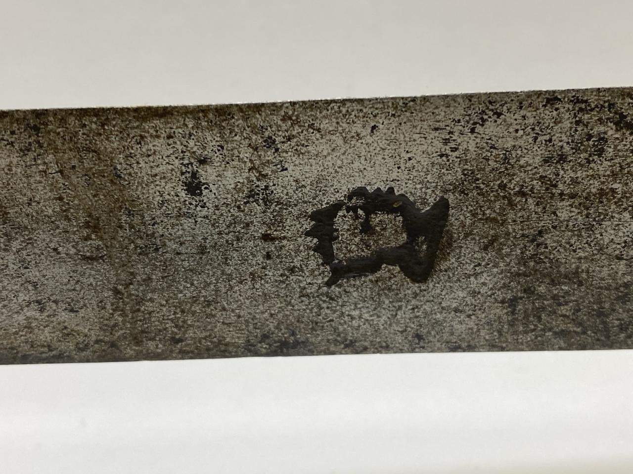

While the focus on makers marks, specifically the 'konigskopf' (=kings head), is in some sense a digression, it is salient in some manner as pertains to these sword forms.
The 'kings head' is well known initially to the Wundes' family of Solingen from late 16th c. into 18th, however in mid to latter 18th it was adopted by the dominant Solingen Weyersberg dynasty, in which there seems to have been abundant variations. In the pages from "The Plug Bayonet" by the late Roger Evans, the mysteries of these often almost wildly variant images of kings head marks seem to have been used by different family members in different periods. Often these dies would become worn or broken, or in cases simply revised in degree to signify individual note.
There is the suggestion of possible use by the German makers who had gone to England in early 18th century to Hounslow using these Solingen marks, just as with the 'running wolf' , however this seems unlikely.
Naturally there have always been cases where well established marks were purloined on other blades, which was a matter of notable disagreement and dispute, but ironically, many markings used in Solingen were spuriously used from other countries, esp. Spain. and the guild registered markings were notably monitored.
It is interesting that in the Wundes group of kings head marks there is one with reduced points of the 'crown' referring to it as a 'conventionalized' version. In the 17th c.. Kohl was using a very similar 'emperors head', so this I'm sure might be factored in.
The 'green man' image with crown was among the figures popular in English themes in hilt decoration early 17th c. (see "British Military Swords 1600-1660" Stuart Mowbray , 2013 for further reading.
Here I would note regarding the use of these 'walloon' type swords in Sweden is further supported by the fact that Casper Kohl of Solingen went to Wira in Sweden in 1630s and there brought in other Solingen smiths as well. As these types of swords were seemingly predominant in German manufacture it seems likely they were made there, as with note to issuance of these by Gustavus Adolphus. Perhaps this might account for the term attributing these in cases being 'Swedish swords'.

Here's my Wundes head marking from my Scottish basket hilt. Very similar to yours, Toaster-

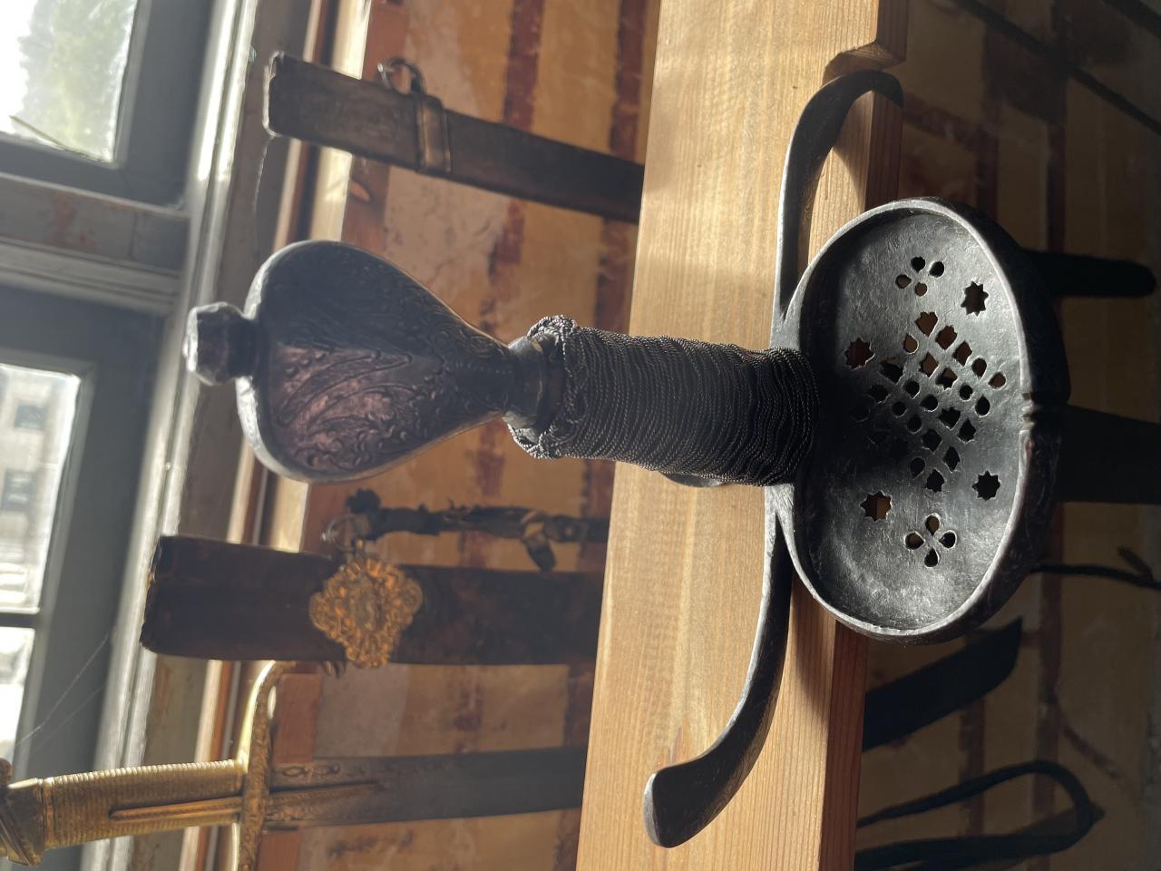

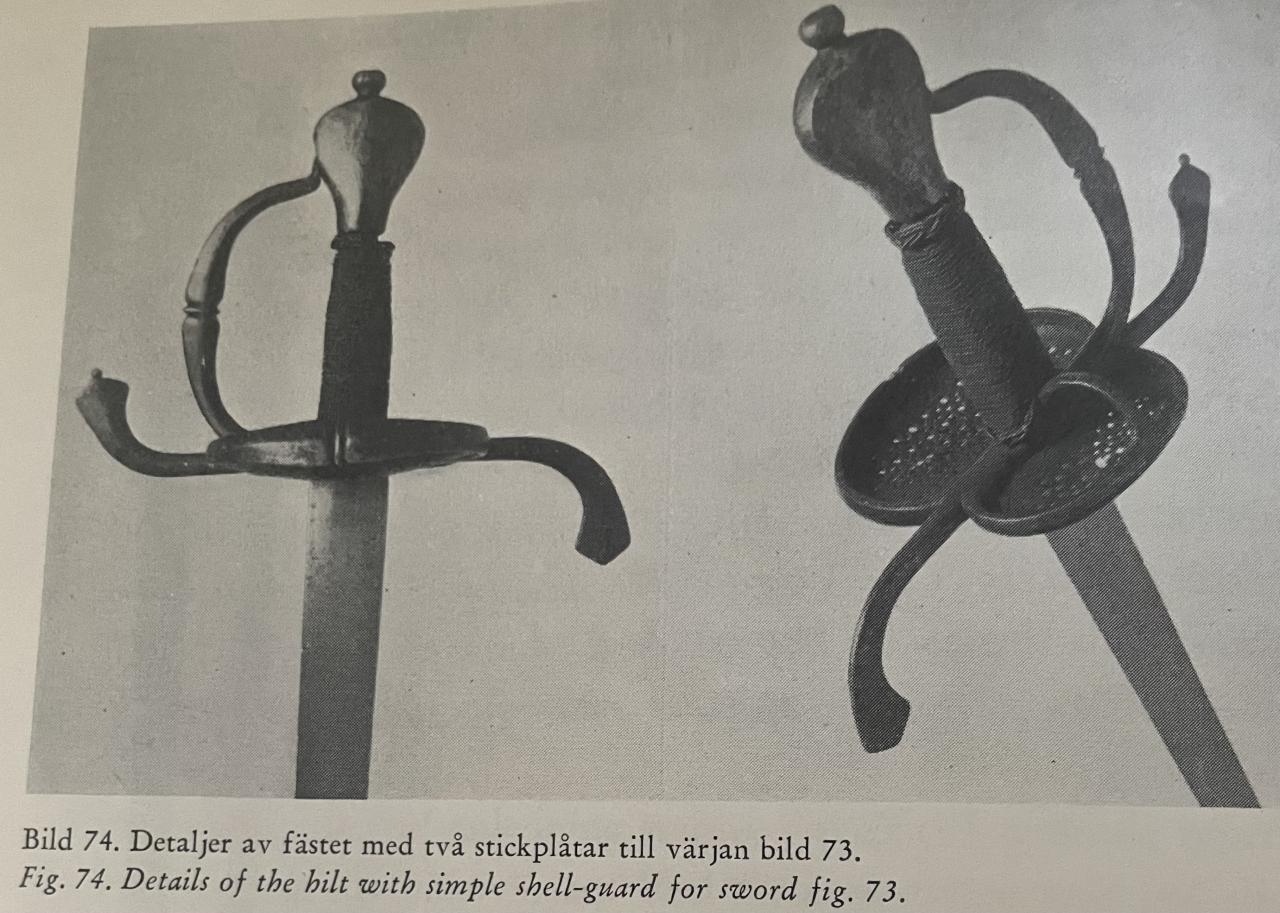

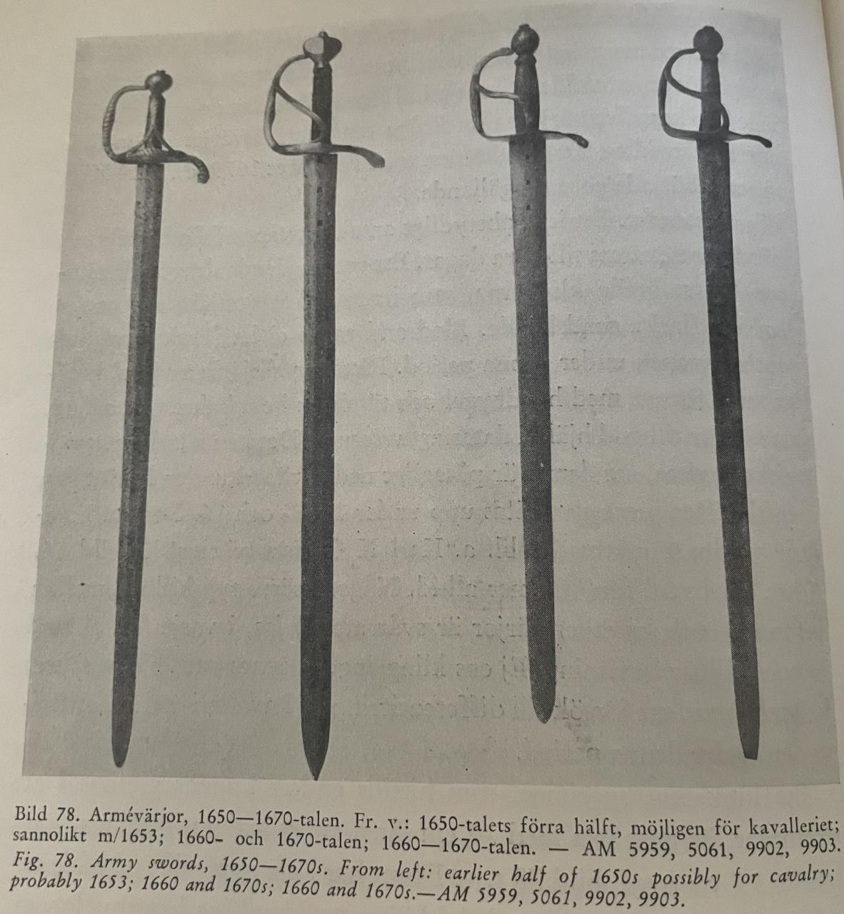

Whilst it’s true that Gustavus Adolphus started domestic production of military swords in Wira in 1630s and brought Casper Kohl of Solingen for this purpose, there is no evidence that Walloon type swords were produced there. The following information is from Heribert Seitz’s Svärdet och Värjan som Armévapen (1955).
The first picture shows a Walloon type sword common in Central Europe of German origins from the later phase of the 30-year war which in German-speaking areas sometimes are called “Swedendegen” or if the blade is curved “Schwedensäbel.” The reason could be that the blade is engraved with Gustav Adolphus’s portrait.
At the beginning of the 30-year war in 1620-30s Sweden imported most of its swords from the Netherlands (protestants). These are the Netherland-Swedish type some of which have a knuckle guard (pics 2, 3 and 4). These have cross guards and characteristic flat pear/heart shaped pommels.
Domestic production of swords in Sweden started in mid 1630s and and developed from the previously imported Netherland-Swedish type to a simple design cavalry sword at the end of the 30-year war (pics 5-6). This later developed into the soldier swords of the 1650-70s where the pommel became more spherical or onion shaped (pic 7).
From the above my impression is that the so called Walloon type sword was more prevalent on the continent than in Sweden where the Netherland-Swedish type dominated. I have seen no evidence that Walloon type swords were produced in Sweden. Only the first sword above is described as “Schwedendegen” in the book and is of German origins.

Jim it seems it’s mainly in Germany they were called “Swedish swords” (Schwedendegen) and they were mostly produced on the European continent (i.e. not locally in Sweden). Most of Gustavus Adolphus’s army consisted of foreign mercenaries (many famous Scotsmen included) and Germans who were his allieds. It’s possible that these German troops and mercenaries were issued with or were using Walloon type swords produced locally in Germany or nearby Netherlands.
Seitz’s book is excellent. It’s mostly in Swedish but has some captions in English. Its English sub-title is The History of the Swedish Army Sword 1500-1860. It’s occasionally available in local second hand bookshops.

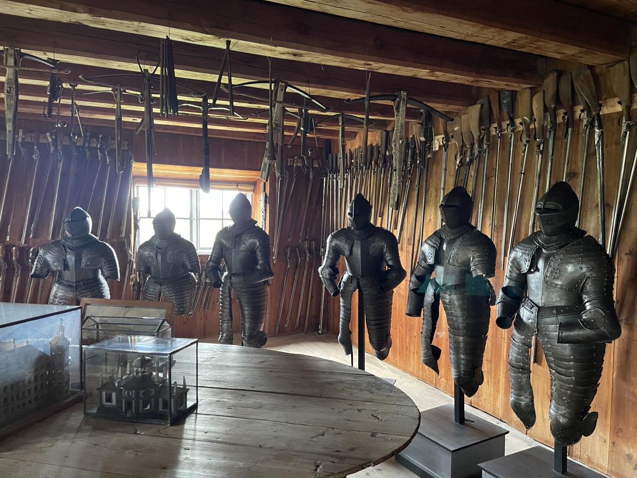

Only a couple of weeks ago I was fortunate enough to attend a viewing of the armoury at Skokloster castle which is one of the largest arms collections in Europe dating from around the 30-year war. I was then able to see some of the swords in the book first hand. The collection belonged to Carl Gustaf Wrangel, one of the Swedish commanders in that war who amassed war booty and became fabulously wealthy.

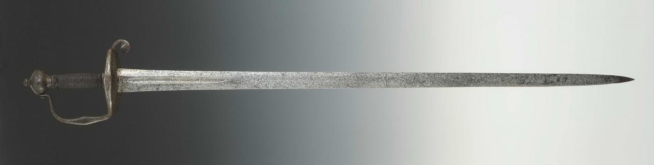

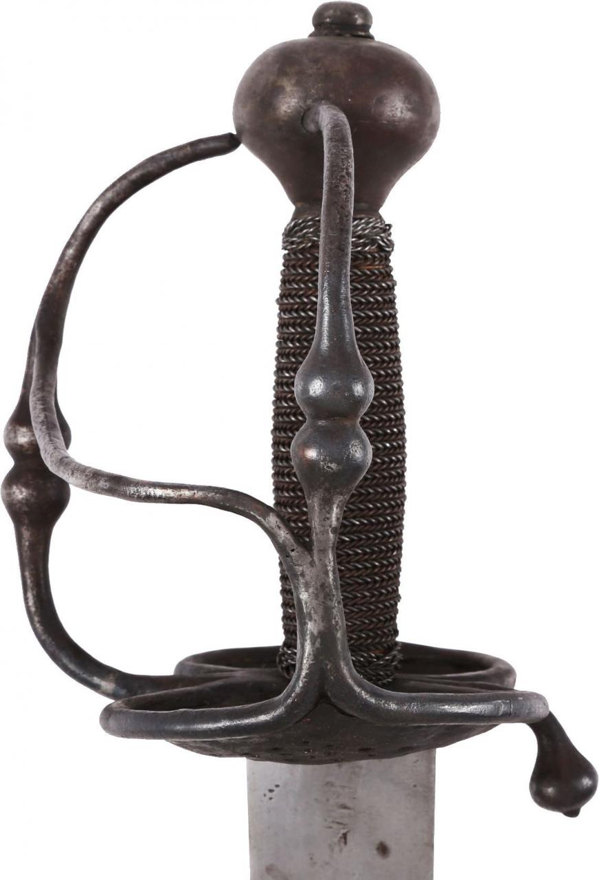

It's been my understanding that the term Schwedendegen was slang originating towards the end of the Danish phase of the 30-year war and used during the continuations in the Swedish wars up until the end of the great Northern war as slang term for a sword to be used against the Sweds. As a "degen" for use against the Swedes". There are some literature references for this, but I will have to return with specific references when I am with my library. Until then, it is only my five cent's inputs
https://bruun-rasmussen.dk/m/lots/D6...iod%3Dall_time
The link is to the latest one I bought, of this type.
In old inventory lists they are often referred to as commissioned degen, as they were commissioned and approved for production and issuing holding the commissions specification. Feltedegen is a very broad and general term, that includes various types of swords, if my understanding, based on contemporary literature and inventory lists are correct. I been wrong before and could be wrong again....

this type is called in Dutch Houwdegen = broadsword for the foot soldier/infantry and must be dated much later between 1675-1725.
I support Jasper's dating for most of the examples shown in this tread, Ca 1670 - 1725 was the period were this type of hilts saw their prime use in Europe. I am adding on some additional observations below.
I do believe that the first types are seen from the 1640's. From where's we see the beginning of a transition period from the munition grade rapier style hilts on foot soldier's side arms. This transition period based on actual types that can be dated seems to be from Ca 1640 - 1660, in central and northern Europe.
I agree the examples discussed here can be referred to using different thermology's. As long as we all understand what we are talking about as suggested by others in this tread.
I believe this type of sword started to be seen from the 1640's. earlier examples has larger knuckles and often flat non pierced guards are also a sign of how to date the earliest types, if my understanding is correct. Other inputs / challenges on dating these types would be interesting and welcome.
