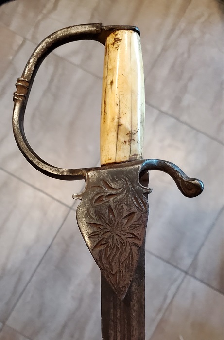

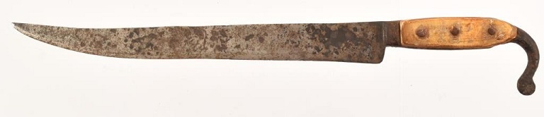

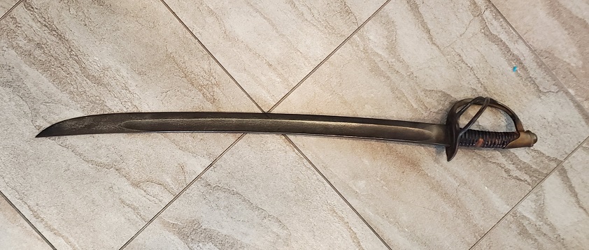

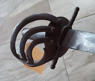

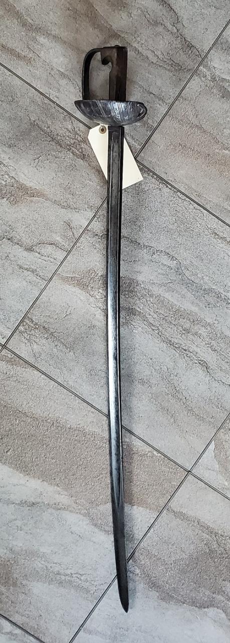

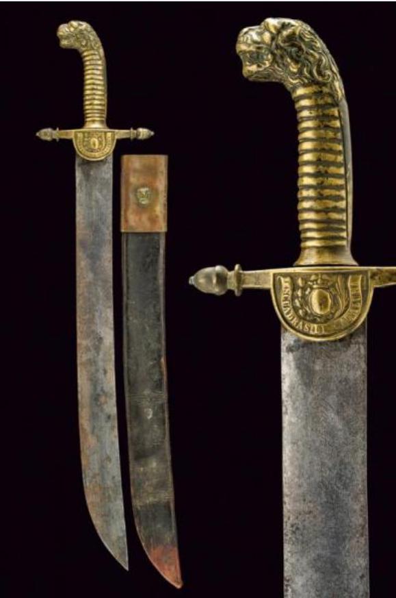

In the attachments:

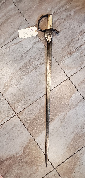

First is a bone gripped example, probably 1790s and at this point presumed of a form known in Sinaloa but later Alta Calif. and Santa Fe. Here the hilt is of the familiar hanger style but mounted with 18th c. Spanish dragoon blade (broadsword).

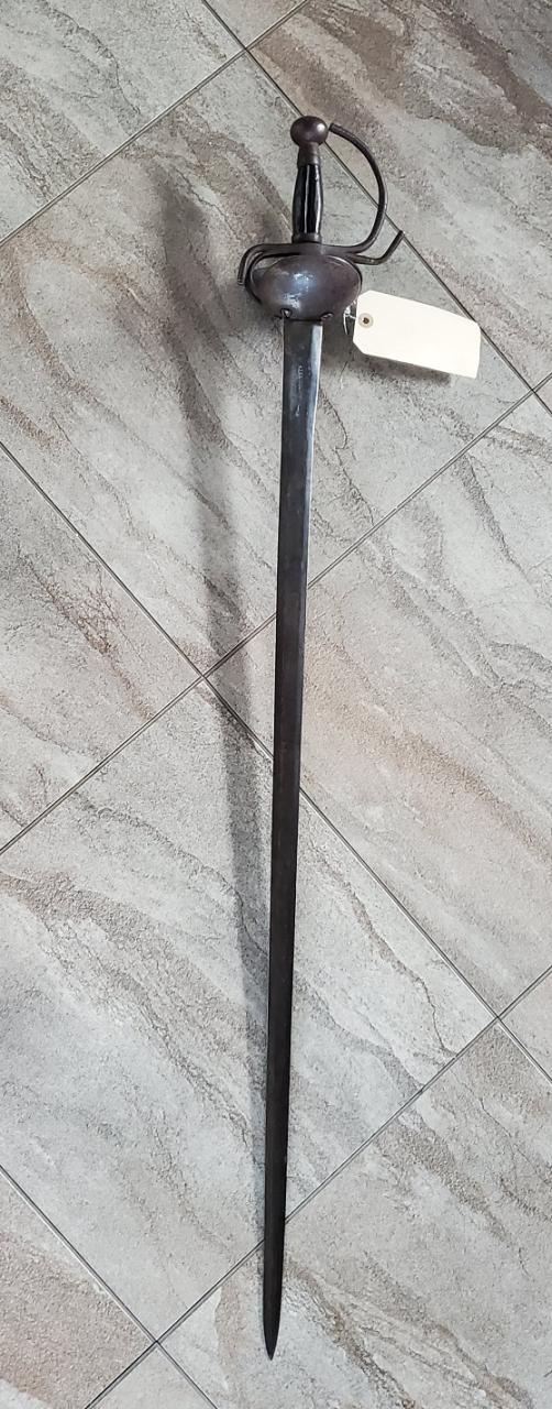

Next is the 'regulation' military form used by Spanish through the 18th century into 19th known colloquially as the 'bilbo' in European and American parlance. As the blades were DE, broadsword, the Spaniards regarded them as ESPADA ANCHA.

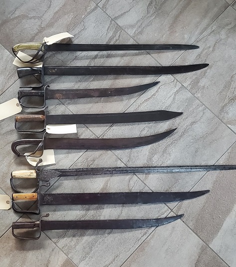

Next is a grouping of these colonial 'machete' (espada ancha) showing wide variation of forms, most of these from c. 1790-1850.

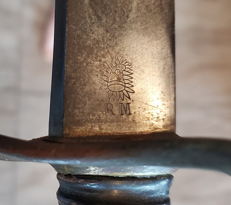

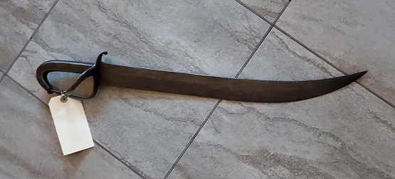

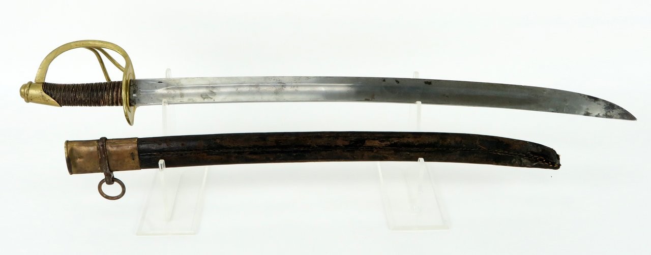

Jim, that is a known Mexican army cutlass model 1870ish
'Blade is marked “A.C. Mexico” for A. Colubuzier, a supplier of military items to the army. The reverse is marked “R.M.” with liberty cap, which stands for “Republica Mexico” '
There is an earlier rendition with a rather distinctive scabbard.
Photo (and text) from Collectors Firearms.
I don't recall any of them referenced as Espada Ancha or bowies.
Cheers
GC

Thanks very much ! the 1870s sounds right as well as these '1840' style hilts were around for some time. I know they were referred to as cutlass, but am not aware if they had a naval connection despite the term.
I was suggesting that the character of these heavy bladed swords in degree recalled that of the espada ancha form in discussion, not that the term was ever applied. ..just my own observation. Clearly these sabers had nothing to do with Bowie's.
Thank you for the notes on Colubuzier....I couldnt recall the name but thought it was something like that.

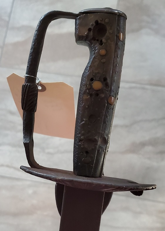

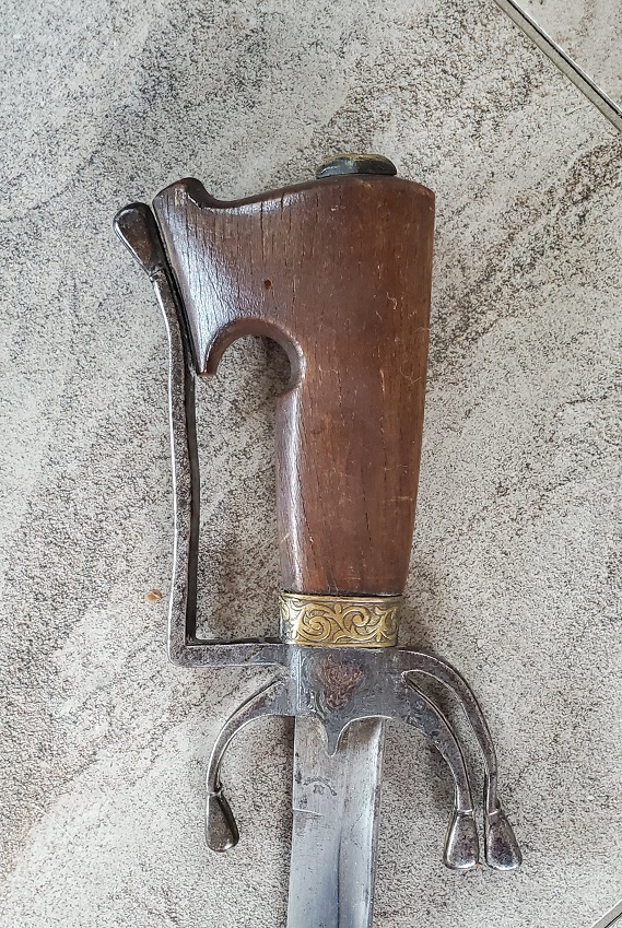

The espada ancha 'type' of hilts with full length blades were found in the southern sectors of New Spain as well as Caribbean and into South America. These regions were part of the "Spanish Main" still quite active in 19th c.
With that being the case, note the Arab influence with the 'hand nock' in the hilt near pommel, as seen on Moroccan sa'if (nimcha).
This may derive from trade activity from Spanish colonial areas in Morocco of course. The striated shell guards much favored in Spanish colonial hilts also are part of the hilt character.

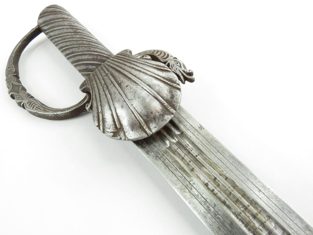

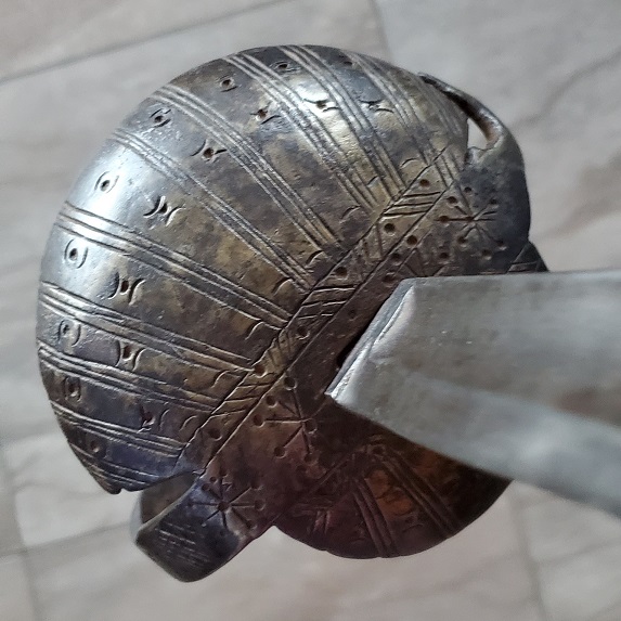

The second one with larger bowl type striated shell guard is of a form seen in Brazilian regions in first half 19th c. Many Spanish colonial swords in these groups have English blades from c. 1800-10.
Other Spanish colonial swords such as the Caribbean cup hilt and bilbo prevailed in these regions as well in these periods.
The first pics are the version with smaller shell guard.
second the larger bowl type guard
Note the similar character of star type motif, striations. I have seen examples of the bowl guard type with inside langet similar to the first example shown here.
The Moroccan 'nimcha' is shown to illustrate the 'hand nock'.

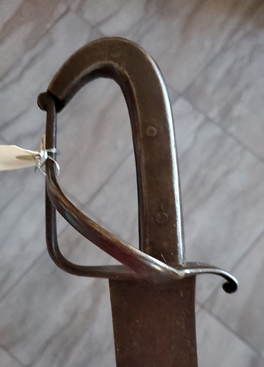

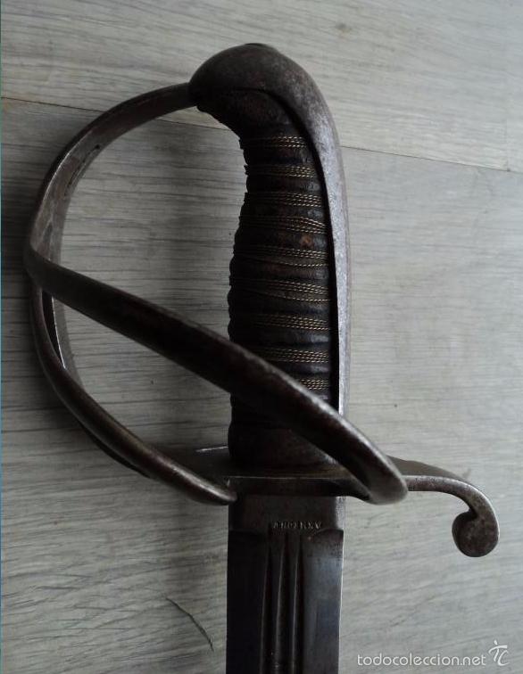

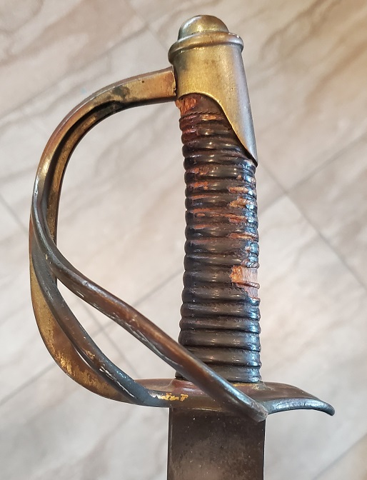

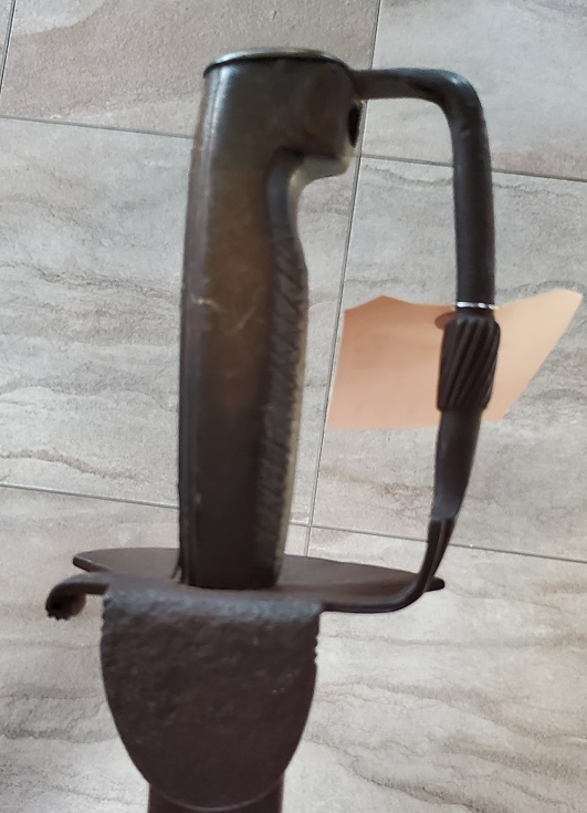

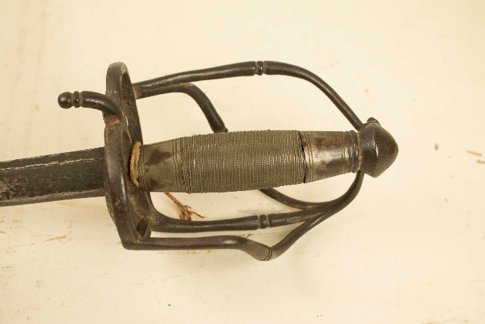

In around 1810-20s the European style hilts with branched guards became popular in New Spain northern frontier regions it seems. According to Adams (1985), he called these multi quillon branched guards the 'round tang' espada ancha, to carry even further from the distortion on the form.
It is curious that these have the branched guard, often with cup type base and under that a cross guard, all a bit redundant.
Also, and unclear how related (if at all) is this 'espada ancha' termed in one reference a 'cutlass' and with hooked type pommel, as well as notably a branched guard. Unsubstantiated suggestions are the Potosi region, but no sound evidence as yet known.

In post #5, the bowl type shell guard, note the serpent creeping near one edge. As we know from examples with provenance from South America on these, and we can presume they were among 'Spanish Main' examples, this example of 'espada ancha' with the serpent on the quillon perhaps is from southern regions as well?
Clearly this is presumption, but at this point it is what is at hand as far as clues.

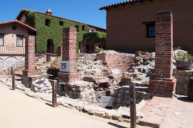

Jim, maybe you remember my reference to Catalan swords and Catalan forges in Alta Calif. The attached images included an auctioneer's (Czerny) description indicating it was made in Toledo but named it Catalan.
Catalan design forges were established in the colonies and presumably local blacksmiths were supplying troops with these machete blade like swords.

Catalan is also a dialect and described territories such as Valencia and Catalunya. The Toledo sword is a Catalunya police hanger.

Absolutely! and that observation of yours was one of the key breakthroughs in my understanding of these locally produced machetes (=espada anchas).
In Brinckerhoff & Chamberlain (1972) it was noted that the presidio commandantes preferred 'catalonian' blades to the Toledo, as the Toledo were prone to breaking.
While this brought attention to the possibility of blades being made in other than Toledo, that realization was that the term 'catalonian' referred to the type of forges used locally by the smiths, not the place of production.
Over the years it had been held that the 'Spanish motto' blades had been produced in Solingen for the Spanish colonial markets. We then learned that with the reopening of Toledo manufactory in 1760s, there were blades made there and it seems of this type of dragoon blades so well known.
As these blades were sent to Bilbao, from there shipped to the colonies, and there the familiar shell guard hilts of the 18th century military swords were mounted on them....these swords became colloquially known as 'bilbo's.

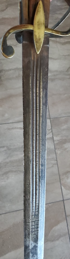

Attached:
Grouping of long bladed Spanish colonial types and two (on right) espada ancha types
Left to right:

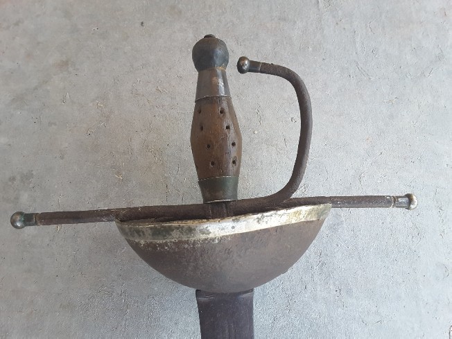

A 'Caribbean cuphilt', these versions of the famed Spanish cuphilt are of course crudely fashioned and prevailed in the 'Spanish Main' areas.
The 'bilbo' regulation Spanish arming sword is the true 'espada ancha' (broadsword). These dragoon blades are double edged, hence the term.
These prevailed throughout Spains colonies including those of the northern frontiers, and in Alta California.
The curious 'guanabacoa' which is an offshoot of these machetes, but seems to have prevailed in Cuba, and east coast Mexico, Vera Cruz. The blade on this is almost a bar of steel, but note the hilt with shell guard (most of these are without). I first learned identification of this from Pierce Chamberlain many years back.
The long blade espada ancha which seems to be of Gulf and Spanish Main prevalence, this example from Spanish colonies in America, probably Florida and latter 19th c.

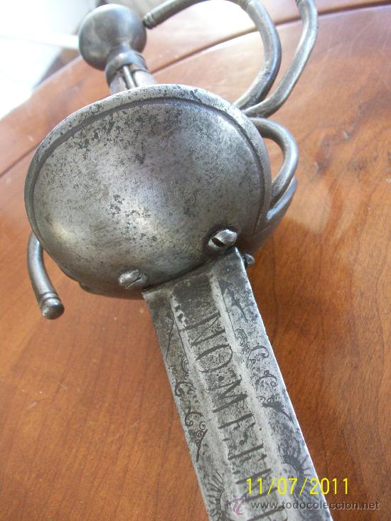

The so called 'round tang' espada ancha (Adams '85) of form which came into use post 1810 in revolutionary forces.
The shell guard form being discussed with serpent, these known have provenance to Brazil mid 19th c. but seem to have prevailed in Spanish Main regions much earlier, my example has British blade c.1805.

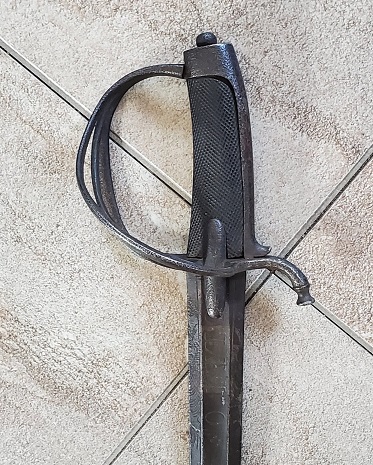

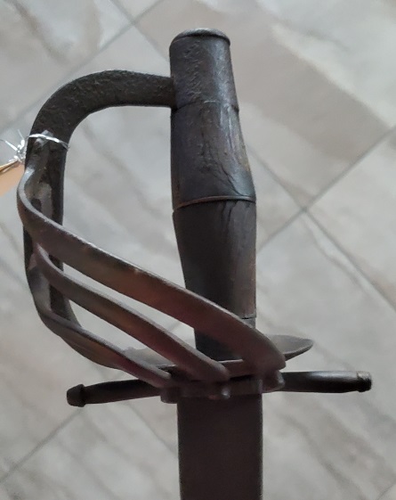

A pair of branched guard sabers which came into use with colonial military prior to 1821. The brass hilt example has the 'Spanish motto' and the familiar 'dragoon' broadsword blade.
The other has blade marked TOLEDO.
These have no royal markings. There was strong affinity for French form which had prevailed even before the Napoleonic overtaking of Spain in 1808.

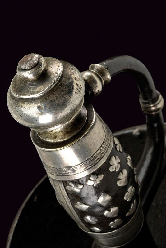

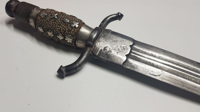

Here is an example of the turn back pommel that seems associated with Potosi, but still seeking more evidence. This resembles the hilt on the similarly pommeled espada ancha I posted, and was found in Arizona.
The association is admittedly tenuous, but of course simply a step toward possible regional affinities.

On the blade on the branched hilt saber I just posted, after TOLEDO is the word Sagaun (I believe) which seems to possibly be a corruption of the famed Sahagum, an often spuriously applied name from that Toledo smith.

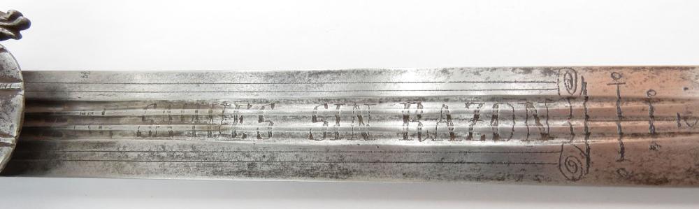

Shorter weapons could be had from the navy as well.
As in Spain, we find also Solingen blades, with the motto "no me saques sin razon" or others "Por el rey Carlos III". This were private purchases, by officers and by civilians. There is a very interesting article. GODOY, J. A. (1988): «Modelos de espadas y sables para el ejército y armada de Carlos III». Reales Sitios, nº 98. Here the author has described real size, blades cardboard samples, sent to the court by a Solingen cutler c1775, and nowadays at the Simancas archives. I have seen most of those models in real swords from the period. In Brinckerhoff, plates 168 to 172 are of this type. There are curved and straight, infantry and cavalry.
We have also a lot of blade exports of the Carynthia type (plates 127, 131, 134, 135, etc). Straight, three channeled, these blades are found from Scotland to the Caspian sea and India. They were also later made in Solingen for a century and a half (kaskaras).
A variety of these are blades made after the Mexican Independance in Solingen, combining the three channels with Spanish mottoes and false claims to Toledo with fake dating, but quite often with the real Solingen mark as well (P.KNECHT is a common one). Made in 1830 to 1860 but with a much antique look, and used in the non-government side of the sucesive Mexican revolutions. Example below. The writing can be found in script as in cursive, and are easily mistaken with XVIIIth century blades. If weathered and no Solingen mark is present, the main difference is in the existence of a squarish ricasso, and the regularity of the channels, thinner and closer.
Then we have the blades made locally, usually shorter types, and the types above disfigured beyond recognition, of what little systematics can be done.
About the hilts, they could be done locally, but specially after 1808 when no more supplies from Spain could be had. The more fantastic ones (those with the quillions under the shell) I believe are from later times, about 1850, as the revolutionary commanders mixed their wishes of connection with their people with a (fake or real) Toledo blade.
It is possible to find typical Solingen hilts (three barred, iron) but I believe most blades were sent without mountings and they were provided in Mexico.
So, under Espadas anchas we have many different things, product of a 100 yers of tumultuous warfare in Greater Mexico.

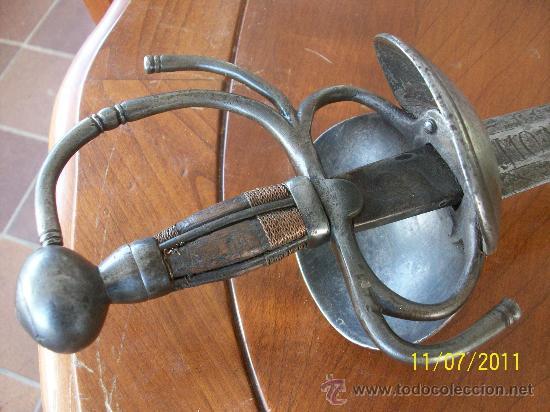

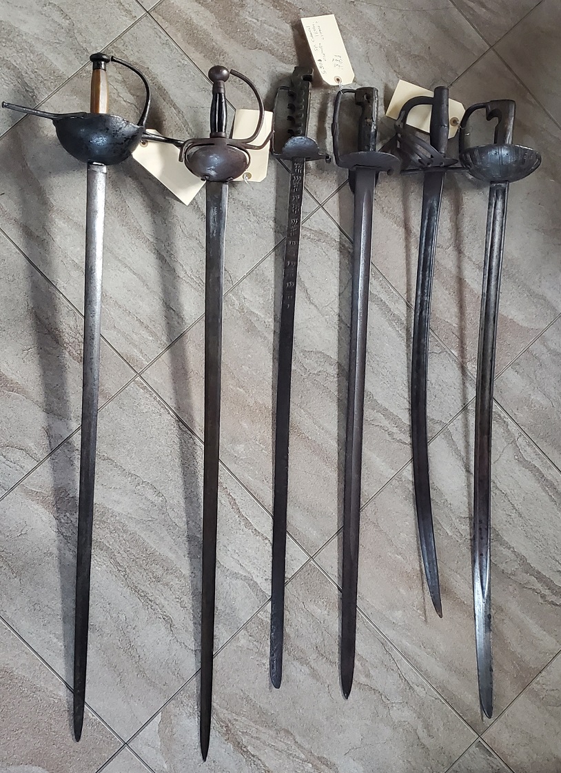

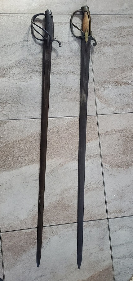

The description I make of the picture above is:
1st one is a cheaper copy of a Brescian hilt, made probably in Europe, 2nd is a 1728 cavalry model from a still unknown factory (I suspect now Trubia, in Northern Spain c1790).
A Cuban machete after 1880 (3rd from the left, Guanabacoa type). 4th, much older hilt than the blade, I can no say sure if is or is not a Espada Ancha. Closely related to number 6th, that I believe is a Brazilian c1840-1860 sword, for long thought to be "moorish" by many antiquarians. There could be an interesting evolutionary relation there. The 5th is very interesting because those grip cylinder types with caps were often used in 1760-1800 by Spanish private officers in infantry and navy, often in silver, but what we have here I believe is a Mexican revolutionary sword from c1850-1860, so a grip making tradition was kept for a century.

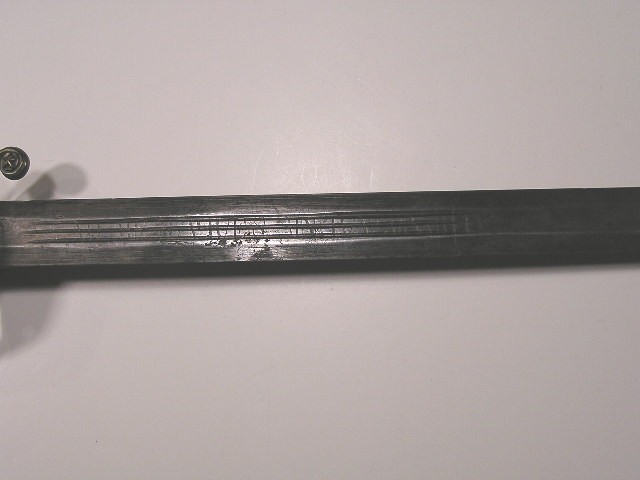

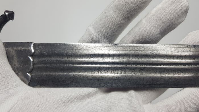

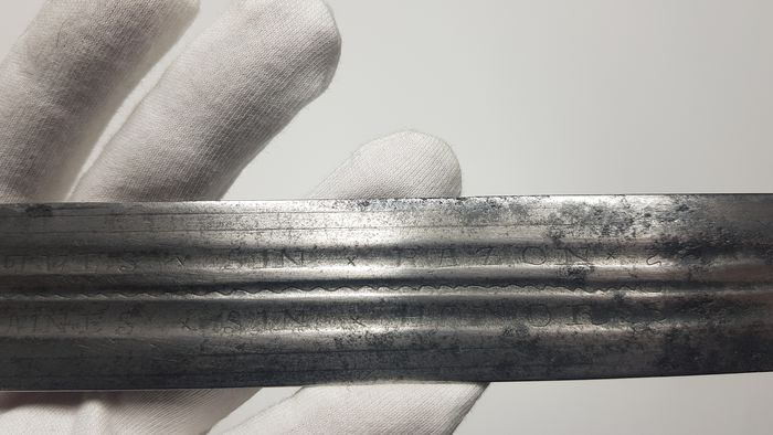

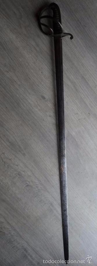

Lets give a look to the subject of three fullered blades.
I believe this 3 are from Solingen around 1840, made for Mexican market. All marked with the "No me saques" motto, but only the first one marked P.KNECHT (Lunechloss is another common one).
Old 1st July 2022, 03:04 PM   #21
midelburgo
Join Date: Jun 2005
Posts: 299

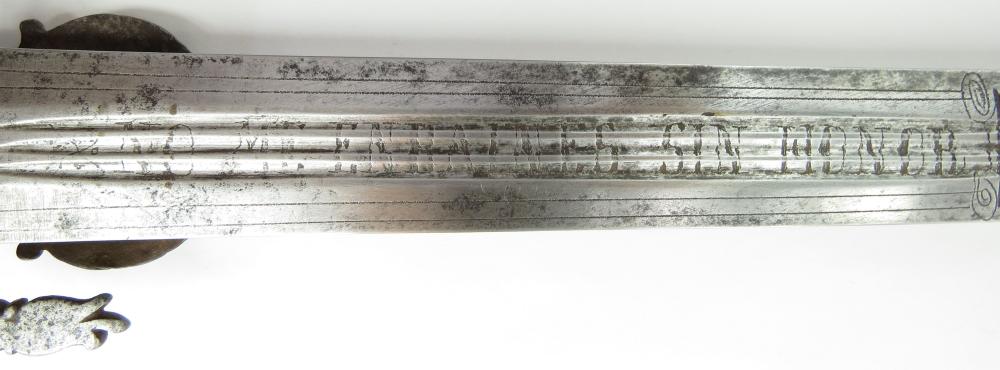

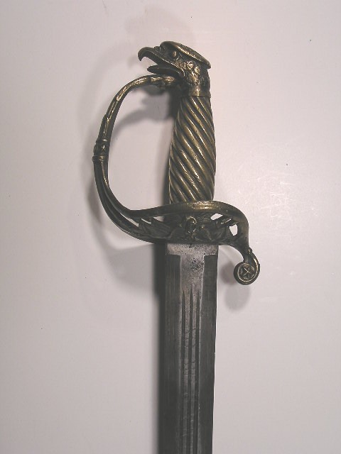

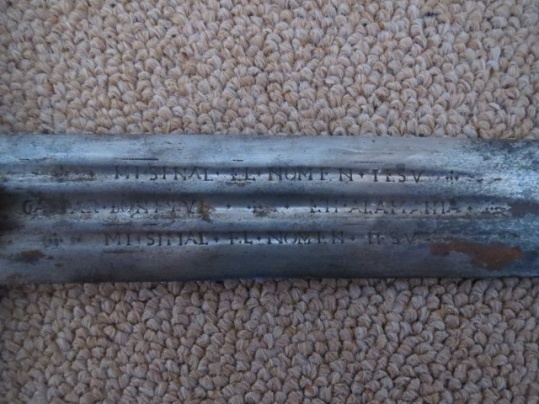

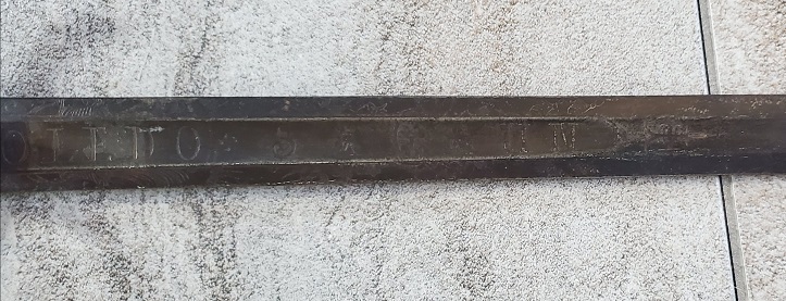

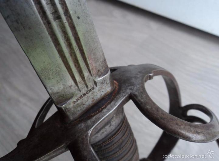

These 2 are real XVIIIth century three fullered blades from Spanish 1728 models. Three fullered blades although they exist, are a minority of 1728 blades. Most are non fullered or single fullered.
Old 1st July 2022, 03:22 PM   #22
midelburgo
Join Date: Jun 2005
Posts: 299
So.
What is this?
A)Colonial period using remounted Spanish cavalry blade.
B)Republican period using Solingen exported 1830-1850 blades imitating the above.
C) Older hilt with a Solingen newer blade.

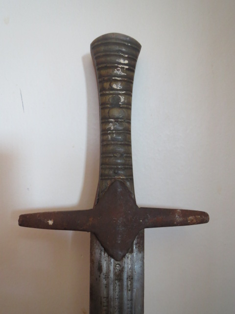

Now lets give a look to the two caps grips.
These are common both in swords as in knifes. They are not limited to colonial, they were everywhere in the Spanish world up to XXth century.

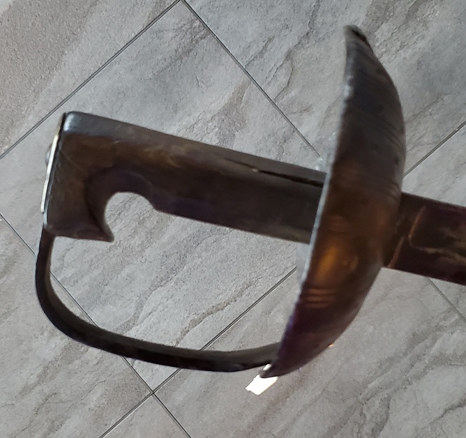

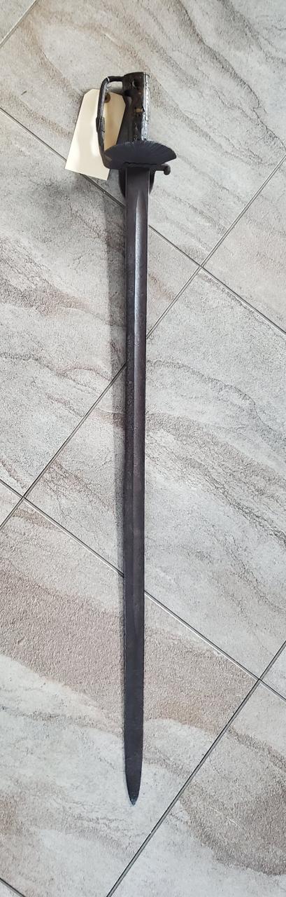

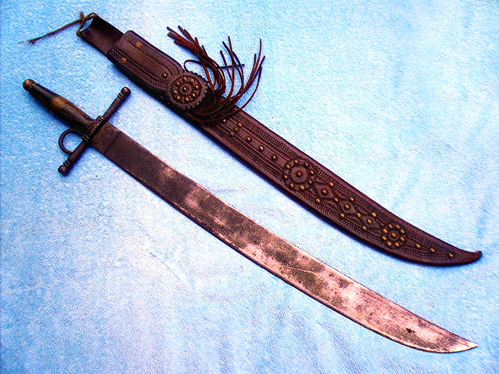

I've always thought of this one as my espada ancha:
Old 8th July 2024, 06:52 PM   #27
Posts: 10,870
Hey Wayne, thank you for responding!
Thats a nice example, and in that configuration it could well be considered one, after all these utility oriented swords (machete) were found in countless variations. In Levine (1985) these kinds of ring over the cross quillon and similar type grip are noted as 'Central American dirks'. Here that type hilt is mounted with a machete type blade, and these were well known throughout the Spanish Main through the 19th c.
Great scabbard, and of the excellent leather work typically found in Mexico through the 19th c. as well.
Old 9th July 2024, 07:56 AM   #28
Very nice example, Wayne .
Old 9th July 2024, 08:41 AM   #29
Thanks, it's high on my list of favourites.
Old 10th July 2024, 01:16 AM   #30
M ELEY
Location: NC, U.S.A.
Posts: 2,236
Indeed a nice Spanish colonial sword! You can see that this blade certainly was both a weapon and a tool. It would be perfect for hacking through brush, splitting a cactus or...well, I'll leave the weapon part to your imagination! A great piece for one's collection!
