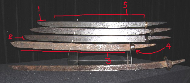

The first pic shows the highlight of the meeting. They are example of swords found in Ayuthaya city core, especially in Wat KaiTia (a temple in Ayuthaya) and surrounding area. Tons of these blade recovered from river bed and sold as salvage steel during past 30+ years. We hypothesized that the blade 's a style of mid-Ayuthaya period. Some of them might be dated to earlier period since they come together with gold decorative which are associated with early Ayuthaya. We concluded that this is one of a major style (from many) blade, used in that period (C15?-C18). They share some common characteristics which are...
1. Clip point+False edge (60-90 degree edge angle), from the tip upto 1-3 inches. Looks very similar to Bowie knife.
2. Tips are not very pointy (wide tip angle), in the most case, tip's curvature are only cover the first few inches.
3. Blade chest/waist (aka, ratio of blade width at 1/4 and 3/4 from the tip) 's close to 1. In some case, the ratio is <1. Unlike the later Rattanakosin blades which has >1 ratio.
4. An important point, they almost always carry a little inner ferrule (1/8"-2/8" thick), called PaGan. This is an important device which are keeping their tang securely in place and also reducing hand shock (we concluded from reconstructed blades, with and without this ring).
5. Style of the spine 's what I call single taper, almost no taper. The spine 's almost in parallel upto the beginning of false edge. And in most case, the spine carry 2-3 little "V" upsetting, looks very similar to lotus petal decorative.
Some of them come up with a little guard and longer blade but still carrying the typical features.

Yes, thank you both, and your fellow collectors at the meeting. This is like cool water to a man in the desert to me!
If I understand #4 correctly, Ayutthaya daab have a more uniform width (meaning edge-to-spine) than Ratanakosin daab? Looking the other way, Ratanakosin daab bulge out more toward the tip?
The PaGan is an interesting feature. Is it something that you can only see when the handle is removed? There is not one visible on my Ayutthaya daab (http://dharesearch.bowditch.us/0056.htm).

Mark, from the meeting, I learned that Ayuthaya 's a kind of culture soup. There are more than 20 ethnic groups in that little area. We estimated more than 100 Krabi-KraBong schools were co-exist. This kind of Dahb (according to its archaeological site, we named Wat KaiTia style blade) could be just one of many other major styles. Beside this one, especially in the late Ayuthaya, glass leaf, rice leaf, sheep foot, cut-off head and Japanese influenced styles were also popular. I cannot say that Ayuthaya blades have uniformly width. But I can say that this style has been popularly used, and, so far, the oldest one we have found for that local and period.
The PaGan is inner ferrule. So you cannot see it from outside, without removal of the handle. Even without little plate guard, most of the hilts are covered with resinous stuff. And in my recent case, the inner ferrule is made of wood !!! (which I hypothesized as a transition between metal PaGan and no PaGan) If excessive force were applied during outer ferrule removal, or the handle has too much weather damage, you might not be able to find the inner one.

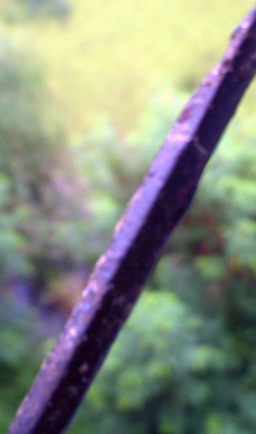

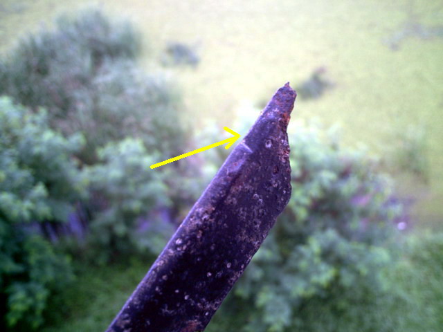

Here 's the little "V" on the spine. IMO: this design is an integral lotus petal decorative.
These are pictures of a broken sword found in the area. Some blades have 2-3 "V" marks on their spine.
