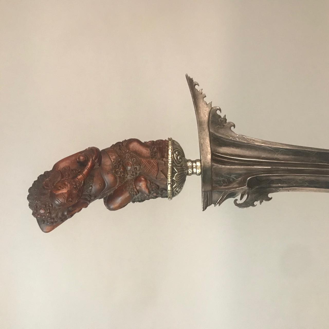

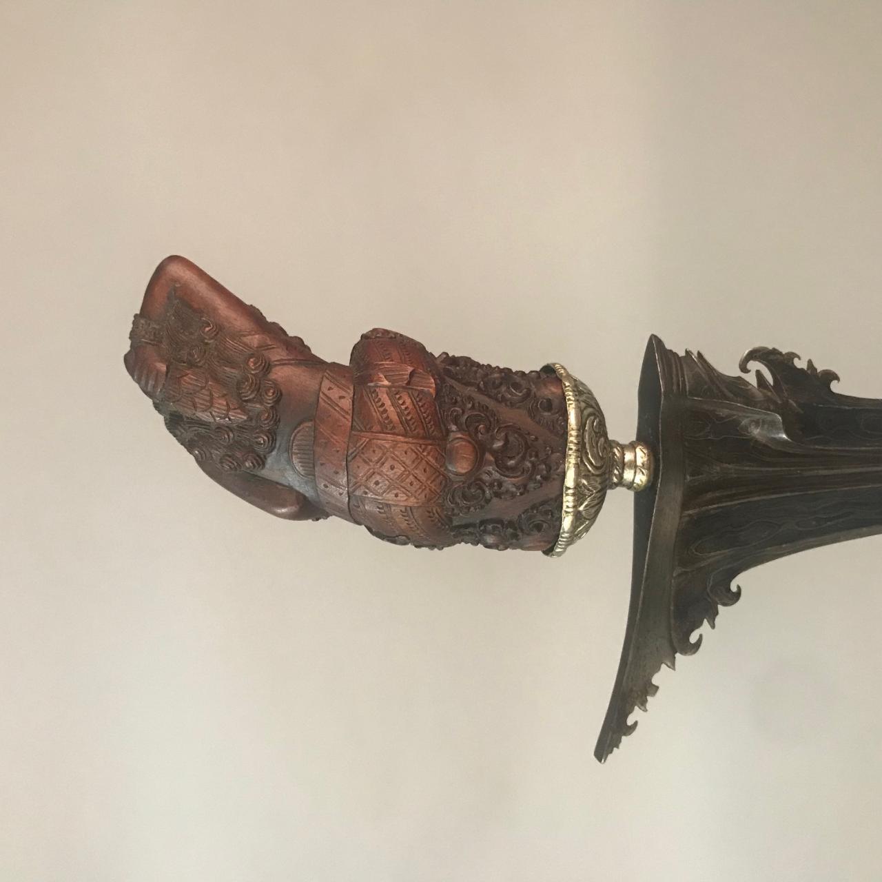

Default Bali keris of unknown origin
Bought from an old collector around 80 whose grandfather collected from Indonesia for almost 80 years

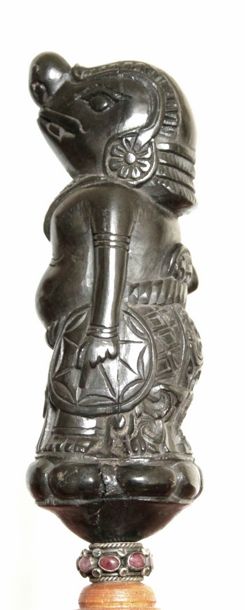

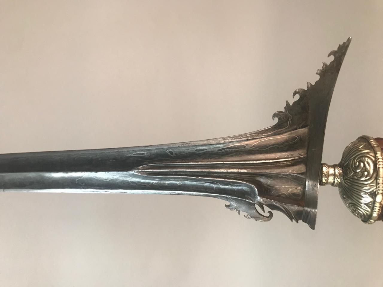

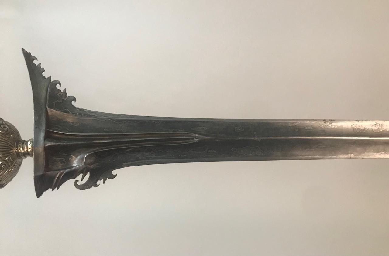

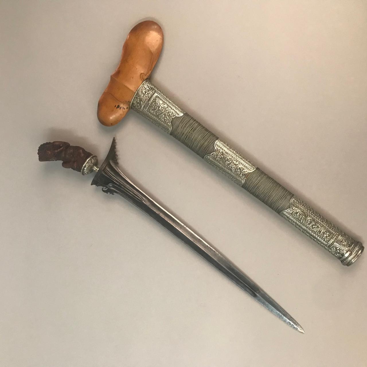

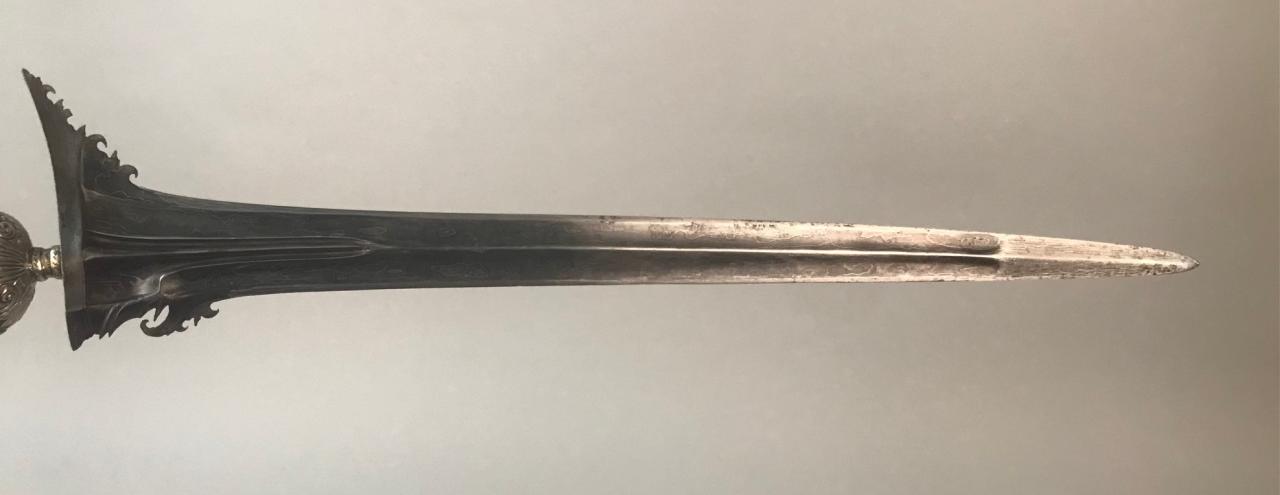

The keris itself looks to be very nice, old, good condition, 19th century, classic.
The gambar of the wrongko (the top cross part) looks as if it could be original to the blade.
The pendok & the cup upon which the hilt sits are not Balinese, the hilt is a modern era carving that mixes elements of the Balinese Nawa Sari form and elements of an elephant form probably intended as Ganesha, which of course it is not, not particularly recent, maybe 1960's-1970's, and probably done in Sumenep.
My guess is that this keris was redressed in Surabaya, it looks like the sort of thing that Pak Hardiono of Jln. Ngagel Tomo used to sell.

I was surprised to see the face of Lord Ganesha on this style of ukiran.

Nothing much to add to what Alan said. I do really like the blade. The hilt is a strange mix for me. Also i can't recall seeing a wrapped gandar like that on Bali keris. If i knew what the wood looked like underneath i would almost be inclined to remove it. It does look a bit loose in the wrapping, especially the upper part so you could possible push it aside a little and have a peek.

Yes David, its a nice keris, but a dealer who knew very little about keris got hold of it along the way and dressed it incorrectly, as it is, it is regrettably a very bad joke, almost an insult.
The hilt should be removed and put in a bottom drawer somewhere, then replaced with one that is free of insult. Clearly the carver had no idea at all of what he was supposed to be carving.
The pendok should be removed and if the gandar is even halfway passable it could live without the pendok. The gandar could be lacquered if it is a bit ordinary, lacquer would be better than what is on it now.

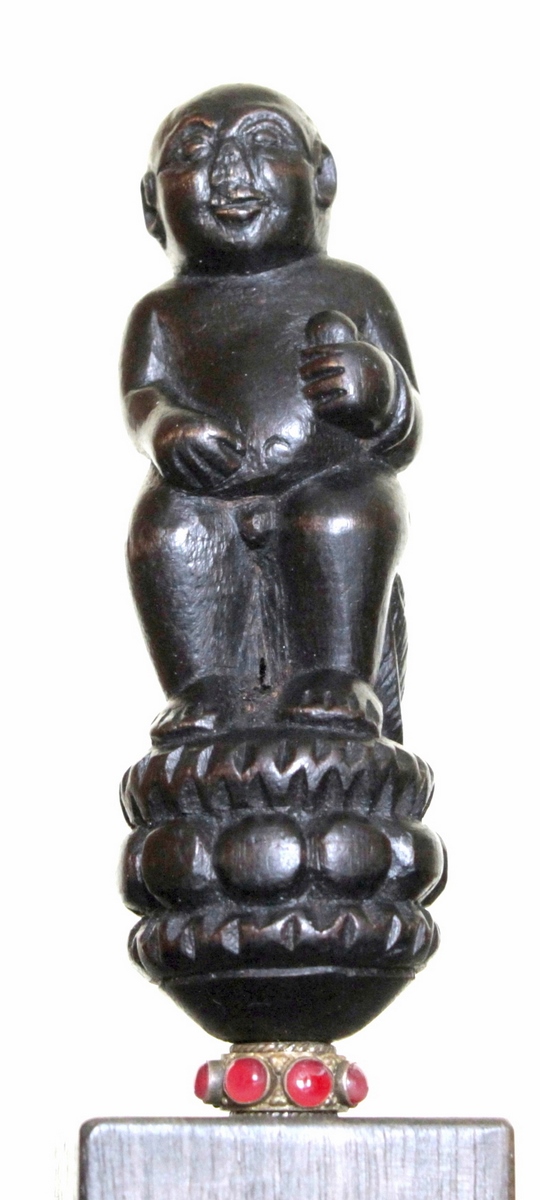

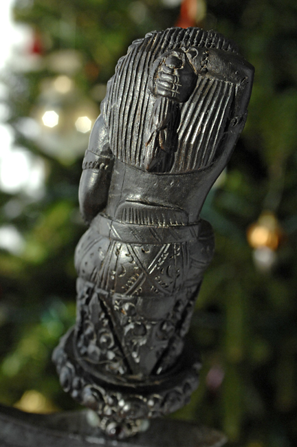

I have a similar hilt that shows a Ganesha like face with the right hand position of Nawa Sari. While my blade is indeed an older one i suspect the hilt is likely kamardikan, so may be like this one a mixing of characters.

Do yourself a favour David, and replace it.
Wrapped up and into the back of the bottom drawer.

It could happen one day. This keris needs a bit before it would be ready for court wear anyway. I found it rusting away in a curio shop window with no sheath. So that is more likely a necessity before i think about replacing the hilt. But no worries. I have no illusions that this is an good hilt. Just wanted to show that such combinations have been done more than once.

Yeah, we've had the Bali Hilt discussion more times than once in the past.
There are a number of factors involved, I personally think that the major one is that most hilts in the modern era have not been carved by religiously conscious people, and only done for decorative effect, but there is the other thing too:- a lot of so-called "Balinese Carving" is actually done in other places where wage rates are lower.
I used to know a young bloke in Solo whose father carved perfectly beautiful small sculptures that were sold through a couple of Ubud galleries as Balinese. The Sumenep craftsmen have been carving for the Balinese market for years.
I might have seen this particular "Nawanesha" combination before, but I don't remember it, I tend to quickly pass over things for sale in Bali that are outside the bounds of tradition.

The complete dress seems to be made for a Sumatran kris (with this buntut). It is a disrespectful sarong.

Just the pendok Paul, the atasan or gambar is older Bali, the hilt is a bit of a mix of two different genuinely Balinese themes, the cup upon which the hilt sits is a sort invention, as is the treatment of the covering for the gandar.
It is what we might call a montage, a keris composed of various unrelated pieces.
The disrespect I consider to be associated with the hilt.
This sort of thing is more common than we might wish, it usually occurs when an uneducated dealer gets hold of something genuine that he wants to extract the max dollar for, and it then gets sold to a keen collector who is still learning the ropes.

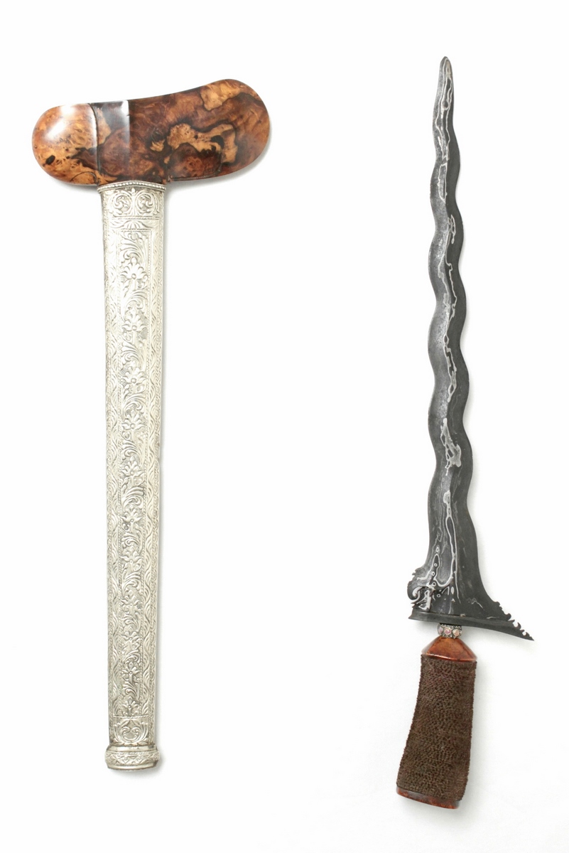

See a similar style of silver pendok with a flat buntut for a Bali/ Lombok kris and which has some age.

Jean, the keris is Balinese or Balinese style, the atasan is Balinese style, the pendok is not Balinese, and the hilt is more likely to be Lombok than Bali.
There is perhaps a possibility that this keris was put together in Lombok, but my personal opinion is that it is much more likely to have been put together in Surabaya.
I find it very difficult to accept the embossing work on that pendok as being from a Balinese hand.
I did not nominate a particular person in my earlier post without a basis for so doing.
Bear this in mind Jean:- a buntut is added to a pendok or a gandar for a functional reason, it is not placed there for ornamentation. The reason for its existence is prevent dislodging the scabbard when the keris is drawn, and Balinese keris have no need for that buntut because they are not worn in a way where a buntut would serve any functional purpose.
However, many collectors do find the existence of a buntut to be very cool indeed, so dealers who understand the collector market have in the past sometimes added a buntut to a scabbard in order to make a keris more attractive to a buyer.

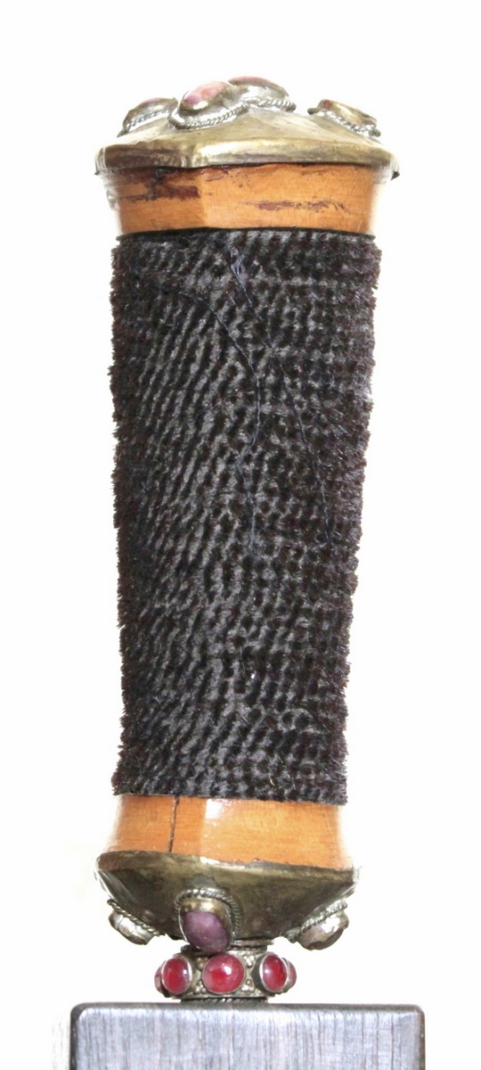

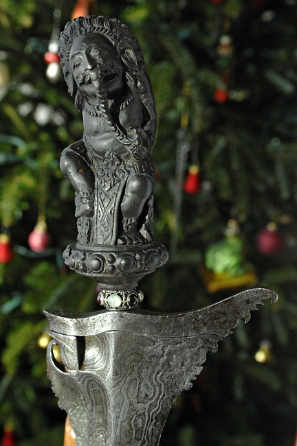

The sampir of this kris was replaced by the Dutch seller, it was in sampiran/ bancihan/ jamprahan style originally.
I have no clue about the origin of the pendok as well but it is nicely made.
The blade & hilt are probably from Lombok indeed. The stones on the uwer seem to be low quality rubies, these are quite commonly found with good quality silver uwers.

Thank you Jean for this beautiful illustration of the point I was trying to make. It is sometimes difficult to understand why something --- in this case a keris --- varies from what we expect to see, but with this keris that you have presented you have the answers to some of the questions one might ask if this particular keris were to be encountered.
I would like to talk about the component parts of this keris just a little more.
Starting with the atasan of the wrongko.
I use the word "atasan" for two reasons, firstly it was invariably the word that the tukang wrongkos whom I knew used to refer to this part of the wrongko, secondly it is from the word "atas" which is a very common word in BI that everybody can immediately grasp, "atasan" applied to the top cross part of the wrongko is readily understood as the "part above", or the "top part".
Although many keris books will tell us that in Jawa the correct name for this part is "gambar", my experience is that this word, meaning "picture" is rarely used in reference to a wrongko, but is more often used in reference to the carvings of nagas, singo barongs & puthuts in the actual keris itself.
The word "sampir" has the sense of something that is hanging, it occurs in Javanese, Balinese & BI and in each language it has related but slightly different principal understandings. I have never heard "sampir" used in relation to keris scabbards in either Jawa or Bali. However, it does appear to be the correct word to use when we refer to a Malay style of wrongko top.
You have mentioned that this atasan was "--- replaced by the Dutch seller ---". I am unclear if you mean that the Dutch seller carved this atasan himself, or if he gave to somebody else to carve or to have carved.
If he carved it himself it is a remarkable achievement, if it was carved in Indonesia I would need to carefully consider where the carving was done. My first impression when I looked at this atasan was that it was just a whisker too short across and a whisker too fat, a bit like the Bali style wrongkos that come from Madura & East Jawa, and also similar to the Bali style wrongkos that come from the carvers who supply the Jogja market. The material from which it is carved can be understood as tri kancu, really nice tri kancu. This wood is scarce everywhere but it is more likely to be used in Bali or Lombok than in Jawa.
So from my perspective, I see this atasan as a bit of a contradiction:- I am uncertain where this atasan might have been carved. On the other hand, I might just by seeing something that is a distortion artefact caused by the camera or the angle at which the photo was taken.
The above is the reason I used the word "style".
In respect of the pendok, there is probably not much more to say. It is in my opinion not Balinese work. The lis ("collar") is not used on Balinese pendoks, but it is common in Madura, similarly, many Madura pendok use a kepet, which although totally different in form to the buntut on this pendok, do serve the same purpose.I do not want to guess where this pendok was made, but it does not look like either Balinese work or Central Jawa work. If a gun was held to my head I think I'd opt for East Jawa. I am assuming that the material is silver, not mamas.
The keris itself is certainly Balinese style, it might be Lombok origin, but I find it difficult to accept Balinese settlement on Lombok as not being a part of Bali itself. You & I, and I think probably all Western World people, think of the sea separating land as division, the peoples of the Archepelago do not. They think of the sea, & bodies of water in general, as highways. To the Balinese of the Balinese colonial period, the settlements on Lombok were right next door and there was continuous contact between Klungkung and Lombok. Just looking at a keris blade bare of dress, I find it extraordinarily difficult to support a valid opinion on whether that blade originated in either Bali or Lombok.
The uwer is worth close attention.
The colour of those cabochon(?) "stones" on my screens is pink, a light, pretty pink. These stones might be natural stones, or they might be pastes. They might be light pink in colour, or they might be red, and the colour in the hand differs from the colour I can see on my screens.
There are a number of gem stones that are pink, but not all were historically used in Balinese & Javanese ornamentation. The most common pink stones found in older Balinese work are tourmaline, topaz, spinel & ruby, when ruby is found it is usually a star ruby. In Javanese work it is common to refer to all pink and red stones as "mirah" which is a pretty rubbery term and can mean either "ruby" or "cheap" or "red". In Balinese the word "mirah" is 99% of the time understood to mean "ruby".
Now, if indeed these "stones" are red, then that makes this a legitimate colour for use in Balinese society. Red is the colour of Brahma, and as such is appropriate for such use. The other colours that are deemed to be appropriate are black & white.
If indeed these stones are pink, that colour is associated with Mahesora, God of the South East, & Laksmi, the Goddess of wealth. Neither of these two deities seem to have a place in the Balinese Mandala as applied to the Keris Culture of Bali.

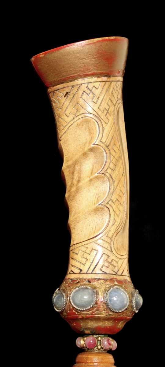

Regarding the top part of the scabbard, Neka calls it sampir/ warangka (page 52) and Djelenga calls it angkup (page 288).
I have several uwers from Bali/ Lombok with pink stones (see pics) but I am not sure about the materials.
The "atasan" of my ex-kris was not made by the Dutch seller, it has some age and I shipped the whole kris to Solo for adjusting and treating the blade, polishing the atasan, and fitting the pendok.

Yes GP, its a nice keris, these older, classic Bali keris have a presence that i feel is very powerful, however, unfortunately your particular keris has been thoughtlessly dressed. That is no big deal, but in my opinion it is something I personally would correct as soon as possible.

Well, it is indeed a nice example of the classic late 19th century Bali keris form.
I can only assume you are kidding about the "amazing handle and sheath" part.
If this were mine i believe the easiest thing to do right off is to replace the hilt. You can certainly find a fairly reasonable bondalan style hilt which would be perfectly acceptable. A nicely carved togogan (figural) hilt can cost quite a bit more, though they are not hard to come by if you want to invest the money.
As a collector living in the Western world replacing sheaths is a much more difficult task. I think we all agree that the atasan of your sheath has some age and is sincerely Balinese. So really the trouble with your dress lies mainly in the gandar treatment. It does seem to me that i can see some wood pattern beneath the string wrap. The string seems a bit loose. Can you gently push it aside to create a window and show us a photo of what lies beneath the string. If there is good wood there, as i stated before, i would simply remove the string. This does still leave the culturally incorrect silver fittings (are these real silver of some other alloy?). You could pull off that bottom piece that ends in a buntet like form and see if the wooden gandar still terminates properly. That shouldn't really cause damage if done properly and could easily be put back in place. If you have a good and complete gandar under these fittings a little refinishing could make this a proper sheath again. If not and you are handy with wood craft, the gandar would be the easiest part of a sheath to craft on your own and make the sheath look legit.
