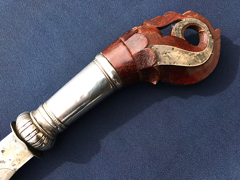

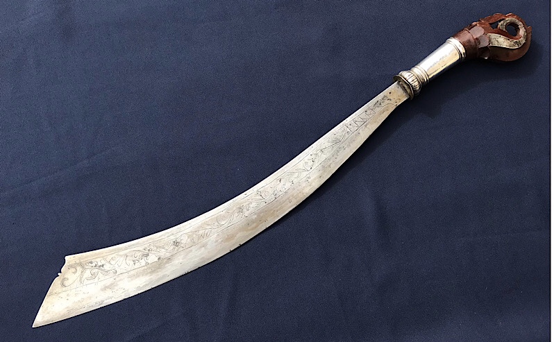

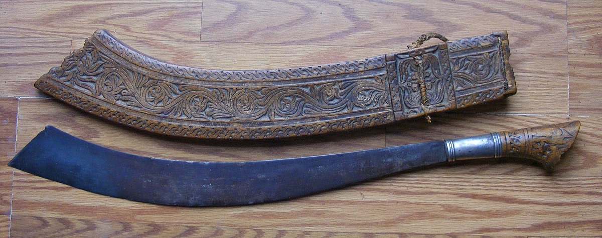

Blade profile resembles a Panabas in a way but a Panabas is supposed to be a 2 hand implement. Could be a Pira / Panabas hybrid.
Overall length 24.5”, blade 18”.
Thoughts?

First, I know NOTHING about Asian weapons other than Nihonto.

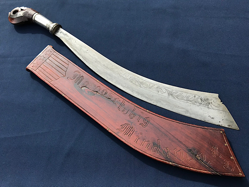

Given the writing on the scabbard, I would suggest a possible tourist item????

I don't know about that Rich. Firstly it is obviously a laminated blade, something they usually don't bother with for tourist items. Also, looks like silver fittings on the hilt, though difficult to be sure just from a photo.
I will also point out that given the way "Margosatubig" is oddly positioned to follow along the damaged crack in the sheath i strongly suspect the writing was added at later date, after the damage was done to the sheath.
Also the stars & stripes shield might be a clue. My suspicion would be this was a WWII bring back from an American G.I. who had this inscription carved in the sheath before he brought it home.

It’s definitely not a tourist item.I think the
scabbard is newer although it was made in the Philippines.

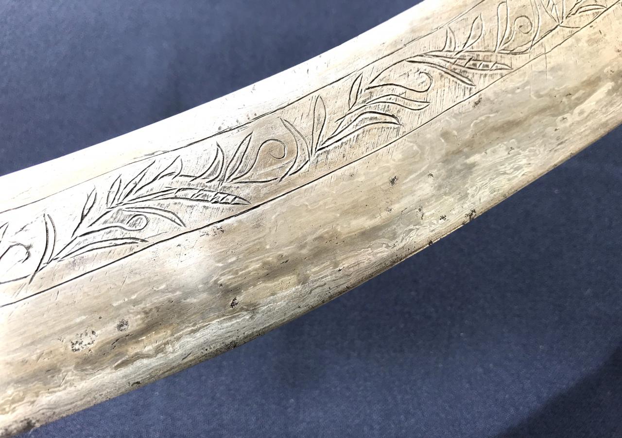

Here’s a closeup of the blade.

How thick is the blade, Albert?
A very good, bent kampilan...
IMHO it doesn't help trying to relate these unusual pieces to some of the more well-known styles. We know there have been quite a few more different types around even if they are nowadays tough/impossible to pin down (including exact origin and names).
I'm not yet fully convinced this really is a Moro sword. The hilt might also have some Melayu and/or coastal Borneo vibes and I also have a tough time attributing the engraving of the bladebto any specific Moro group...

It's a not a Moro blade, but rather a Lumad one, under the Subanen tribe.
They have a number of names for this, but it's commonly known nowadays as "glot." To my knowledge, modern ones are still being made, with the same scabbard, but simple wooden hilts.
The hilt may have been a product of trade with other Mindanao or Sulu locations or tribes, as even the old glot samples have simple wooden hilts. Kino, your old piece must have been a status blade in the tribe.
"Margosatubig" is a municipality in Zamboanga del Sur which is populated by Subanen.
All credit for the information goes to the museum curator of Cagayan de Oro, who is also a Lumad researcher and cultural bearer.

Kai, the spine nearest the hilt is 5/16” thick.
Xas, makes sense since Kai noted the blades engraving doesn’t resemble Moro. I looked up Margosatubig location earlier. Any idea what “Margo”, means.

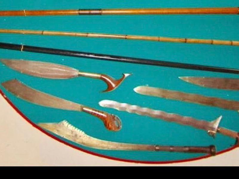

Here’s another one in this photo, from a panoply of mostly Moro weapons in a Spanish collection. Xas, you’ll probably find the Panabas interesting.
Yup, that's another nice one! Note that the ferrule is somewhat different but otherwise it's a close match - great find!

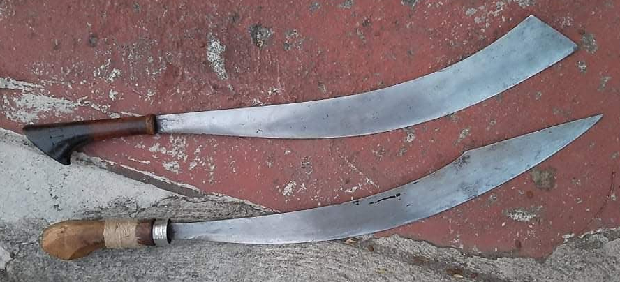

I'll ask my friend to post his antique sample on this thread.

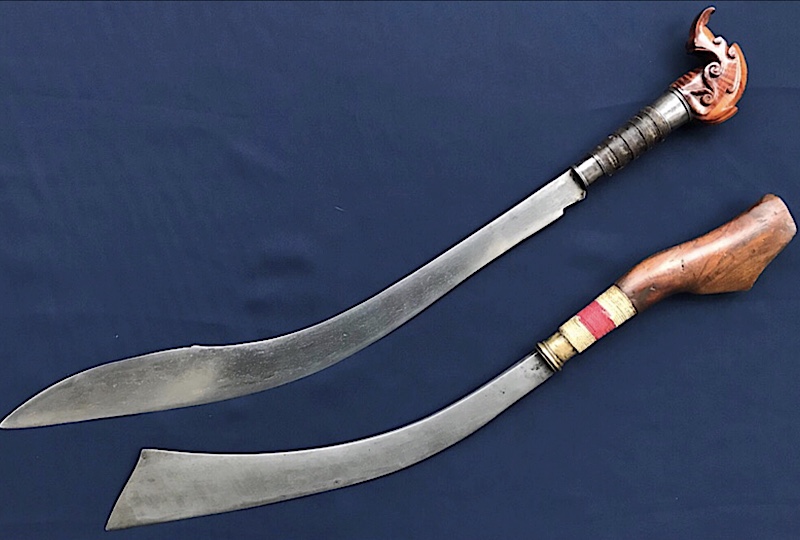

My friend's glot vs my pira.

Xas, Thanks for posting the link to the Peabody Glot with a status hilt and the photo of your friends Glot. I’m looking forward to the research papers of the Subanen Tribe weapons and others.

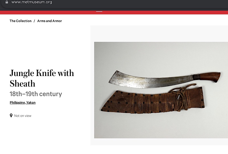

Here’s another Glot. Courtesy of the Met
