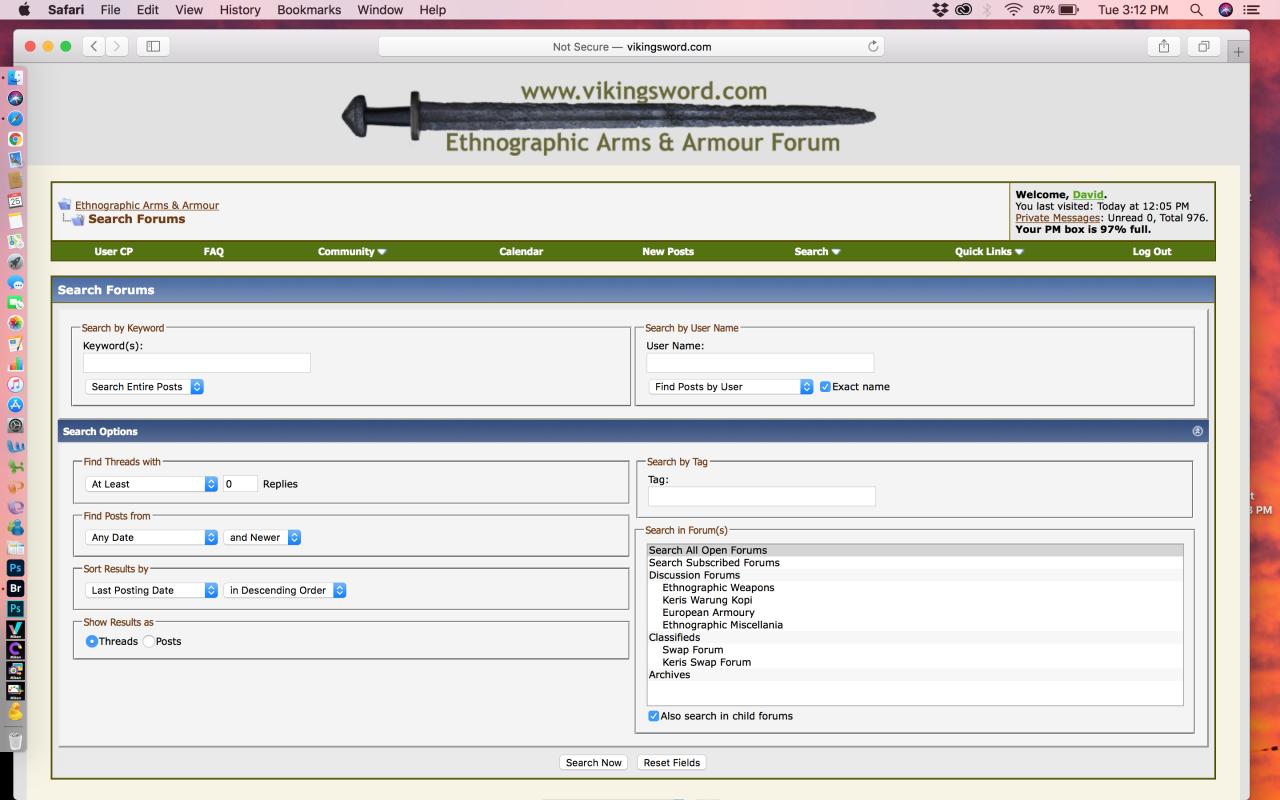

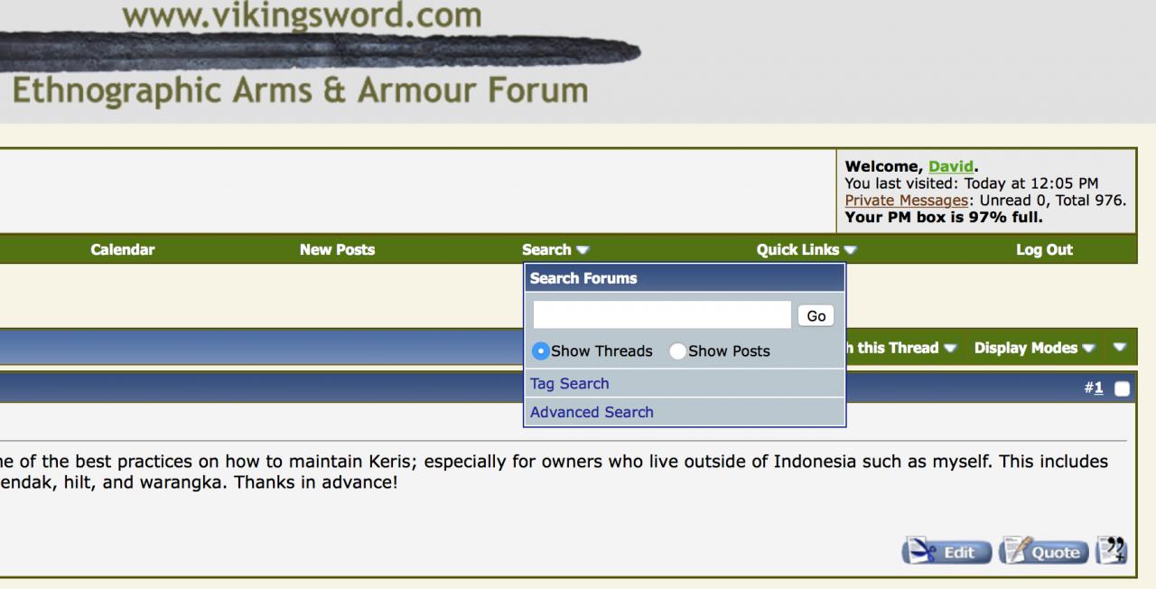

Use the "search" function. Green tab, sixth option from the left. There is an advanced search option also if you want to try to follow a particular members evolution of thought on a subject. Very interesting to watch ideas and knowledge bases develop.
Old 25th January 2022, 07:15 PM   #9
Posts: 7,296
Here is how you search the archives Shadejoy. As IP stated, you can use either a quick search or you can click on 'Advanced Search" in the dropdown menu for a more detailed and specific search.

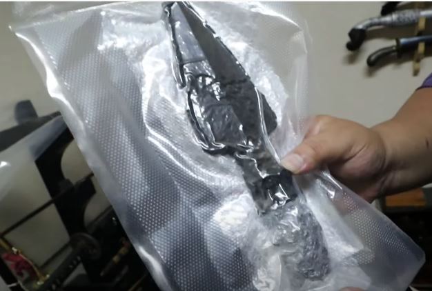

Default Cringe warning for traditionalists out there
I most likely will do this after a good cleaning and oiling, airtight vacuum-sealed.
