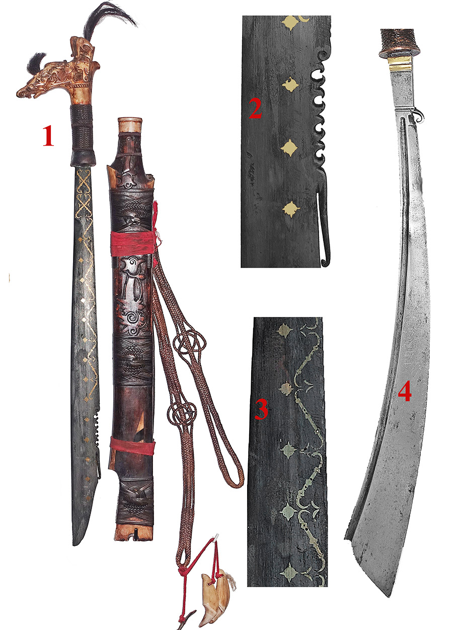

Underneath a mandau of which the blade is black. It doesn't seem like a pamor to me because the drawing of pamor is created by forging different types of steel together. I don't see any of that. nr-1 is the mandau, nr-2 and-3 are details so that the iron can be seen better and nr-3 is the "white" sample of a Jimpul to see the color differences well. Meteorite steel is found by dayaks in riverbanks and beds and is black. Does anyone have another explanation or is this indeed meteorite steel? At the time I bought this mandau with the mention "pamor".

Actually I do see different colors of steel which might indicate that there are different carbon steels laminated together.

Most certainly this blade is laminated - as pretty much all (traditionally forged) Dayak blades are. In this case, it's a bit difficult to discern since different surface treatment as well as cleaning prior to etching and uneven staining may all contribute to the shades visible in the pics. How about the other side, Godfried? Close-ups along the blade would be great and very likely help to get a better understanding.
The typical bladesmithing approach in Borneo seems to be to only fold the obtained mild steel upon itself, multiple times. Pretty much identical to what is done in Japan. Thus, there usually is no contrast between the layers and the layers tend to be quite thin resulting in an almost homogeneous appearance
Despite many people expecting pamor to be bold and contrasting, neither layers of contrast, nor complex pattern welding, nor actual etching/staining define a pamor blade. Any laminated blade can be argued to have pamor.
In this case, the blade seems to have been treated with arsenic (warangan) as would be typical for some keris. It will probably prove impossible to determine when and where this was done; the style of etching looks almost Balinese (with lesser prior surface finish though). One might be inclined to believe that this result is pretty unlikely to be achieved by the warangan commonly done in Java/Madura. Tougher to rule out someone in the Netherlands trying to improve the appearance - however, there don't seem to many examples like this. A tough riddle!

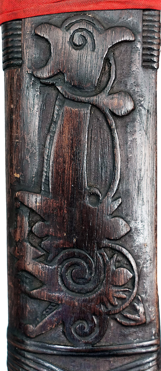

Your explanation got me thinking and I scratched a tiny bit off the back of the sword. Indeed, "bare steel" emerged. Then wonder why Dayaks want to blacken the steel. At least it didn't happen in the Netherlands because I bought this sword at a foreign auction. For the time being I think that it was then glazed and blackened in Borneo itself because the pamor looks much worse than, for example, the blackening of the pamor on Javanese and Balinese krisses. the steel and color on the back looks the same as the front i.e. some areas of the blade are quite rough while most of the blade is polished smooth. I still have a question about the sheath. Is this the "Aso" or maybe "Mata Kalong" or some other stylized creature? Thanks for your explanation.
Hello Godfried,
Another stunning mandau. Thanks for sharing.
The figure on the scabbard is different from what I have seen before.
Although the variation in carvings seems endless.
I think that is an aso figure. His head on the bottom side, and the mouth towards the left side.
But it also looks a bit like a prawn motif.
Willem

Would there be any reason to think that the "blackening" of the blade was intended to function as a rust preventive, similar to the bluing or browning of Western firearms?
Willem
Goeie dag Willem,
I understand you are thinking of the crab motif because both the sheath and your drawing have "teeth" on one side. However, I also go for the Aso motif because (as far as I know) the crab motif is used more on Ikats than on mandaus. The tattoo motifs of the Aso below also look a lot like the carving on the sheath. Thank you, you have hopefully set me on the right track.

Could be but usually put with it then in the fat or oil. I personally think it was done in Borneo itself. If you are a european collector why would you blacken that mandau when e.g. the handle is very finely carved and, as you can see in the photo, complicated rattan buttons, etc., you have "raped" as a collector, in my opinion, a beautiful sword.

I'm still wondering if the former owner etched this in this way to bring out the brass inlays on the blade surface. When Balinese do this and there is nickel present in the blade, the nickel stands out prominently. Perhaps the former owner who got this to the auction market thought this was common throughout the entire Indonesian peninsula and would enhance the value by bringing out the inlays making it more attractive (if not incorrect).
I've seen this a lot on other pieces, for example, Moro kris being etched in a Javanese fashion. Looks great to some, but destructive and incorrect, and a mess that I have had to repair in the past.

The previous owner brought 34 Mandau's to Czerny's auction in Sarzana Italy. This was the only mandau that had the description PAMOR. That is all I know.
