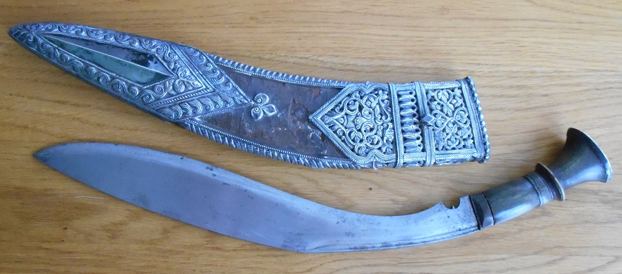

A cool kukri with an engraved blade...

Cool Kothimora scabbard. The Khukuri is a quality one too! Excellent back story to go with it!
Old 16th September 2021, 01:59 AM   #3
Posts: 7,416
I LOVE the silver work on this kothimora! And how wonderful to have provenance!

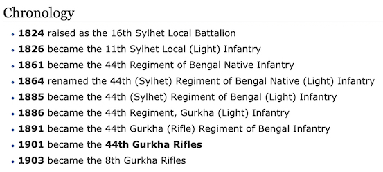

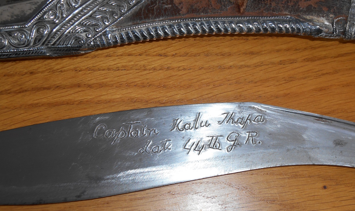

Speaking of provenance, that's a crude inscription for such an important guy. The "late 44th GR" reference means, I presume, that he was a member of the 44th Gurkha Rifles at the time of his retirement. However, when I looked up the naming of that regiment, it was not until 1901 that it became the 44th Gurkha Rifles. Since he retired in 1897, four years before the change in name, we have an anachronism with the inscription. It's a nice kukhri, and worthy of a distinguished soldier, but is the inscription genuine or added by someone else to inflate its value?
The chronology of the regiment's name is shown in the attached picture from the Wikipedia site devoted to this unit.

Hi, Finaly a suspicious and negative comment.
Well just read well my post... The kukri should be in between 1886-1897.
"was not until 1886 that the regiment was officially titled the 44th Gurkha Light Infantry.
He retired on 5 Feb 1897"
I won't try to convince you or any other suspicious member about the quality of the engraving, but yes, it's not a British 19th c. engraving with Gothic letters.
I'm not a paleographist and neither are you...
Old 16th September 2021, 12:39 PM   #7
Posts: 4,747
Kubur,
I am not a paleographist, but I have an undergraduate minor in English with particular reference to the Victorian period. Since you call into question my credentials for commenting on the inscription, I shall elaborate further.
The expression "late 44th G.R." is interesting for a couple of reasons. The use of the word "late" means previous or former. It can be used to describe the last place a person lived (e.g., Mr ..., late of The Strand, London). In another sense, it can refer to someone who has died (e.g., the late Mr ...) but that is not its use here. It is a word that was often found in obituaries of the 19th C and first half of the 20th C when describing a person's last place of employment, but less so today except in a somewhat formal and pedantic sense. In its use, the word "late" is used as a descriptor of someone else, and is not used to describe oneself.
From the use of the word "late" in "late 44th G.R.," we can deduce that the inscription was not composed by the owner, but by someone else to describe the owner. Furthermore, the inscription was written after the gentleman had retired.
Now look at "44th G.R.," which is recognized as the 44th Ghurka Rifles. I have already noted that this name for the regiment post-dated the gentleman's tenure. The presumed owner, a distinguished officer, would never have made such an error, which again points to someone else being responsible for this inscription, and also that the inscription post-dated a change in name to the 44th Ghurka Rifles.
Who was responsible for this inscription and why put it on the blade? I don't know, but the person seems to have had an education that included English as taught in the 19th and early 20th C. There are many reasons why someone may have done this, but one always has to be wary of an attempt to mislead and enhance the value of an item.

While kukri's are far from my fields of study, I had occasion to try to learn more on them many years back, and had several great communications for the late Byron Farwell ("The Gurkhas", 1984). Despite some great coaching from John Powell, I never got a foothold in them, but still recognize the fascination and regard for them as a weapon, as well as utmost respect for the Gurkhas.
I can see the consternation over this inscription, and it does seem if this was added in presentation, or commemoration, it would have had more wording and have been professionally done.
However, in the case of ownership, many weapons are inscribed with the owners name in less than professional manner, and tend to be simply the name without hyperbole. With regimental names of units, especially in the British army, often they were known colloquially by terms other than shown in official regimental records.
Naturally there is no way to prove such an inscription with the name of such a distinguished officer was not added spuriously.
However, I would suggest that is may have been added in a personal manner of ownership after he retired and perhaps wore this as a personal weapon.
It would be understandable that he would be extremely proud of his time with this distinguished regiment, and as this was post retirement, he would add his association as 'late' (ex). This is much in the manner that veterans in this country proudly wear regalia signifying their units and pride.
A very nice weapon, with intriguing historical possibilities. More research and forensics would surely reveal more, i.e. how long did he survive after he retired; was he involved in activities where he would have worn a weapon (many Gurkhas became involved in security work and associations).

I see Kubur’s point, but the kukri is clearly marked as 44 GR ( Gurkha Rifles) and it acquired its name only in 1901. Prior to that it carried other names.
Also, for a kothimora kukri the inscription is rather crude, isn’t it?
I do not think there is an unequivocal evidence in favor of this inscription being 100% genuine. I might be wrong.

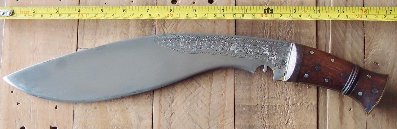

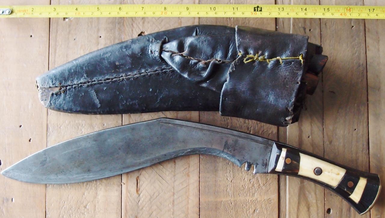

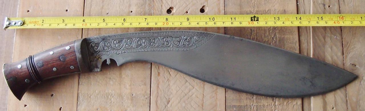

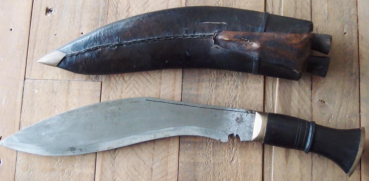

I have attached photos of each Kukri (apologies if they are out of order) and starting with:

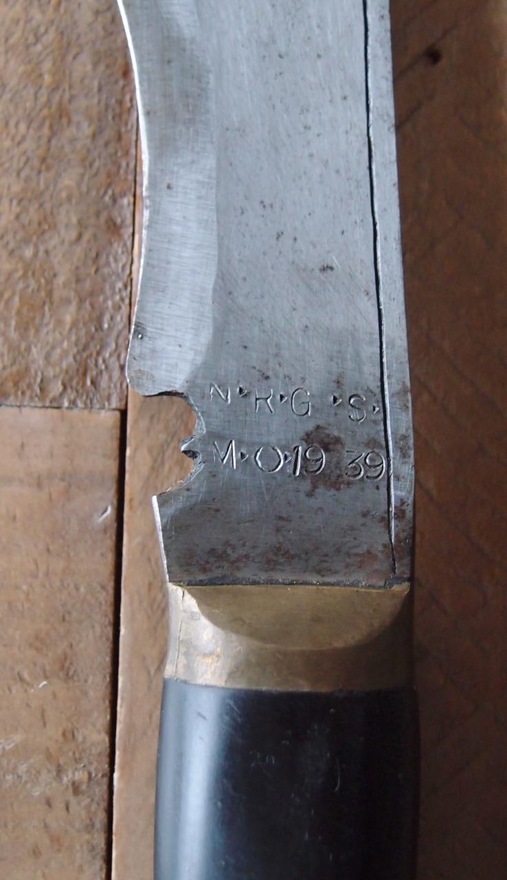

Number 1 - this appears to be a stock standard Kukri with the only distinguishing feature being the lettering on the blade - namely N.R.G.S. followed by the letters/numbers M.O. 1939. I searched various websites to try and see what the letters refer to but without success. I assume 1939 refers to the year 1939 but the best I can find with the lettering is through 'AI' which says the N.R.G.S. could stand for "Nepal Regimental Gurka Service" and the M.O. for "Military Ordnance" - any thoughts or info re the lettering would be appreciated.
Number 2 - the main point of interest with this Kukri is the engraving on the blade which appears to be (a) unusual, in terms of very few Kukri blades being engraved and (b) of quite good quality compared to the few other engraved blades that I have seen. The handle appears to be of good quality in terms of carving as well. The sheath it came with was disintegrating but appears to be of standard make. I'm assuming this Kukri is a cut (excuse the pun) above the norm but any comment would be appreciated.

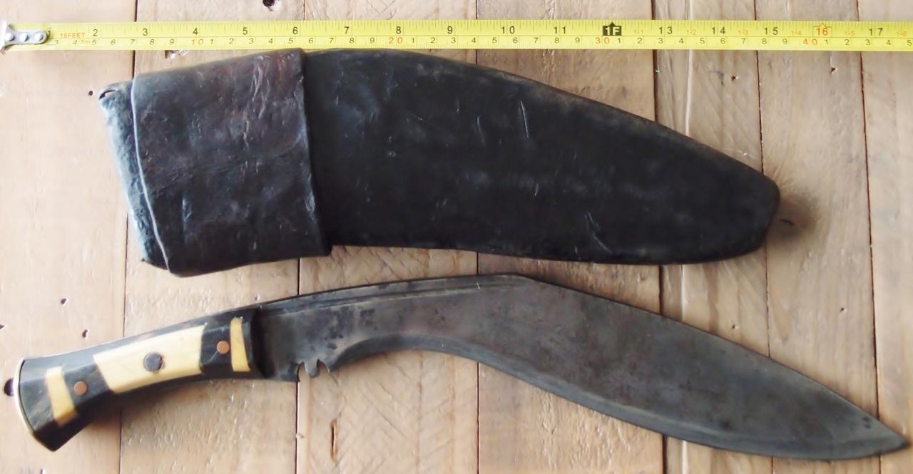

Number 3 - the point of interest with this Kukri is the handle which appears to have been made from horn with inlaid ivory - it does not follow the usual pattern, lacking the raised ridge part way down the handle. I have confirmed the ivory aspect with a local bone carver who fitted a replacement piece which was missing from the handle. This kukri appears to have been a 'working example' with the handle showing good patina. The sheath was very dirty with a thin layer of caked dirt in place between the inner sheath and the chakmak/karda holders. The knife has a full tang and I was wondering if it was originally a military model which has had a new handle fitted?

Hi nicknz,
Some time ago I owned a kukri with similar horn and bone segments on the hilt. I'll try to find pics.
Regards, Ian.
