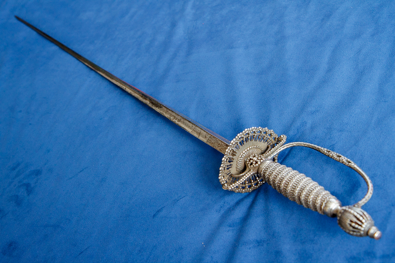

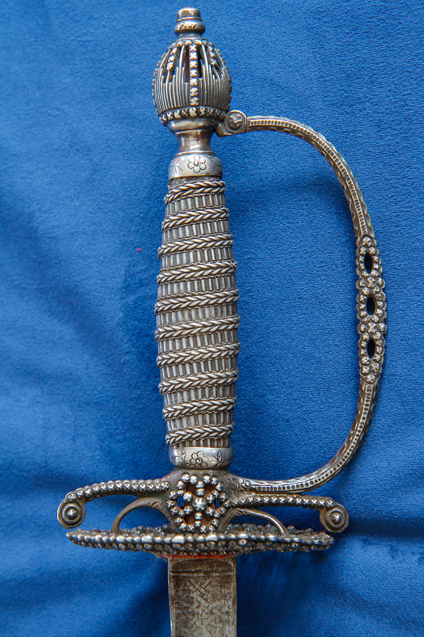

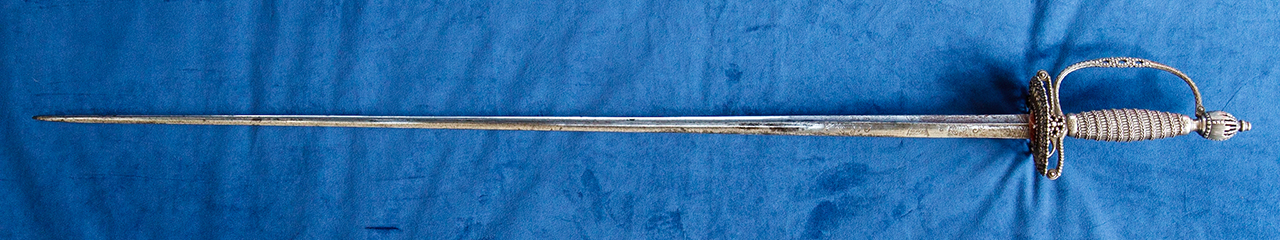

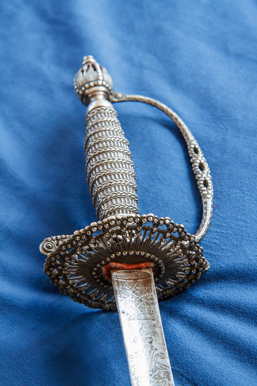

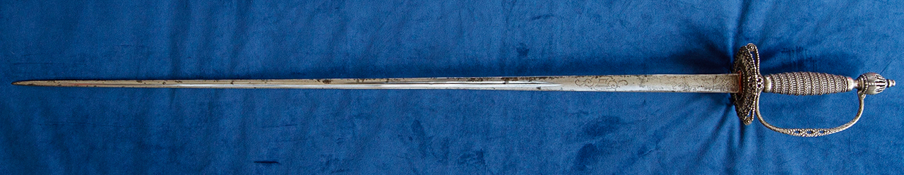

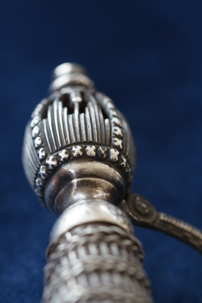

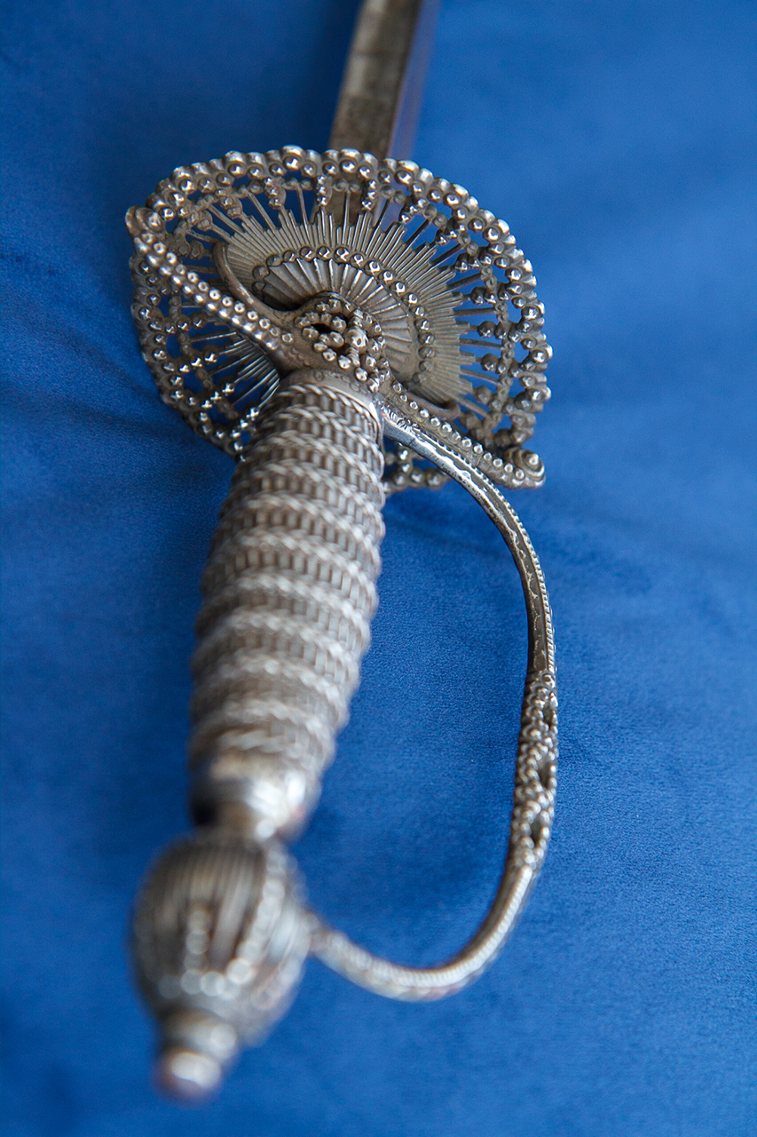

This is my second smallsword. Described as an English silver hilt smallsword c.1770 it, unfortunately, has no discernable silver hallmarks. I haven't had it tested for silver, but it isn't magnetic.
The blade is hollow ground triangular cross-section without a makers mark. It is decorated with a mix of etching and engraving on the forte of the blade. Regrettably, the blade has a slight warp to it.
LOA: 922mm
Blade: 763mm
Weight: 330grams
POB: 80mm
Would welcome any feedback on the style possible maker.

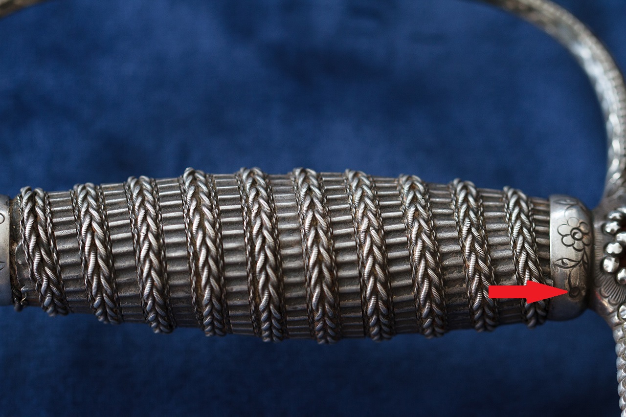

Yep, English, from the end of 18th centrury would be my guess (maybe contemporary to mine so the estimate of 1770 seems reasonably correct).
I would still look for the silver marks as English silversmiths were pretty thorough with their markings (see for example the arrow in the photo).
Very nice piece.

Mariusgmioc, unfortunately, that is part of the decoration.
Richard, was there an obligation to display the hallmark? Could it be covered by another part of the guard?

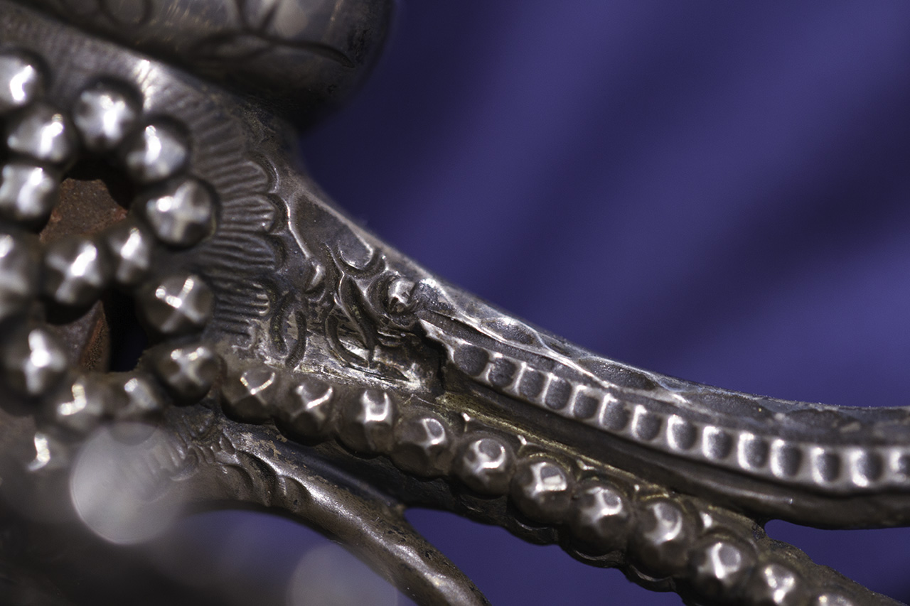

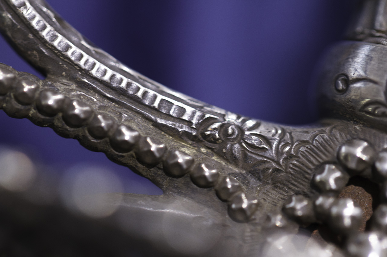

Posts: 303
This is the closest I could find to what might be a hallmark.
Located at the top of the knuckle bow where it joins the annelet. The other photo is for comparison for the detail that is on the obverse side.

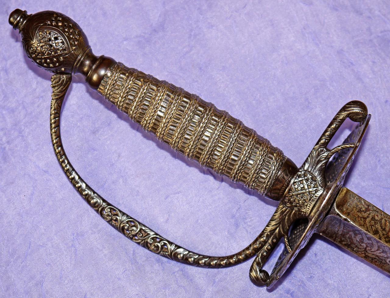

Pinning down the nationality of an unmarked smallsword is always something of an enigma The component parts were available to furbishers from various sources and international trade was well established in the 18th C. Most of the makers / retailers engraved their details on the top scabbard mount, most of which are long since lost.
With regard to the sword being discussed, I have one which is engraved on the blade with a Dutch address, that has an almost identical crenulated silver grip.

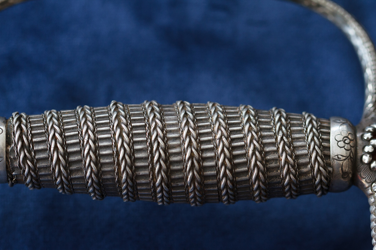

This style of grip binding I've seen on a few other swords, including one by William Kinman posted by Marius in my other thread.

Yes, I've seen the Kinman one, very nice, I do have a couple of others with similar crenulated foil grips, I think one of them is French.

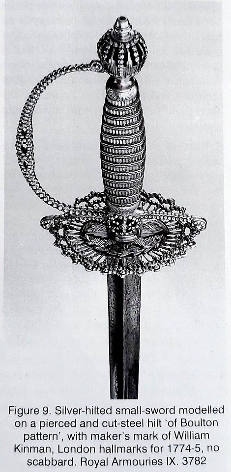

While I claim no special knowledge on small swords, I have been familiar with Aylward and notes on these passim, and whenever I see 'cut steel' I think of Matthew Boulton.
I found the photo of this silver hilt small sword by William Kinman (hallmark 1774-75) which is based on a cut steel pattern of Boulton's , in fact it is termed 'Boulton pattern'.
Boulton of Soho had huge production factory for many items , buttons, buckles and metalwork items.
In the article I found the photo in, "Matthew Boulton's Small Sword Hilt Designs, His Links with the London sword Trade and New Light on Cut Steel Swords", Leslie Southwick, JAAS, Vol.XIX, #6, Sept. 2009.
I had hoped to find more on the metals used, but the focus was on designs, however this 'pattern' is distinctly Boulton's. While there seems to be a hestitation to associate cut steel designs with precious metal work, it is noted that James Morisset(1738-1815) of London was sometimes employed and consulted with Boulton's 'particular work', whatever that was.
It is also noted that many of these cut steel swords were made at Boulton's Soho works for retailers, who would then place their own names on them.
I am unsure of why this sword would not be magnetic if indeed cut steel.
I wonder if a percentage of non ferrous alloy present in the metal being worked would render the item non magnetic?
