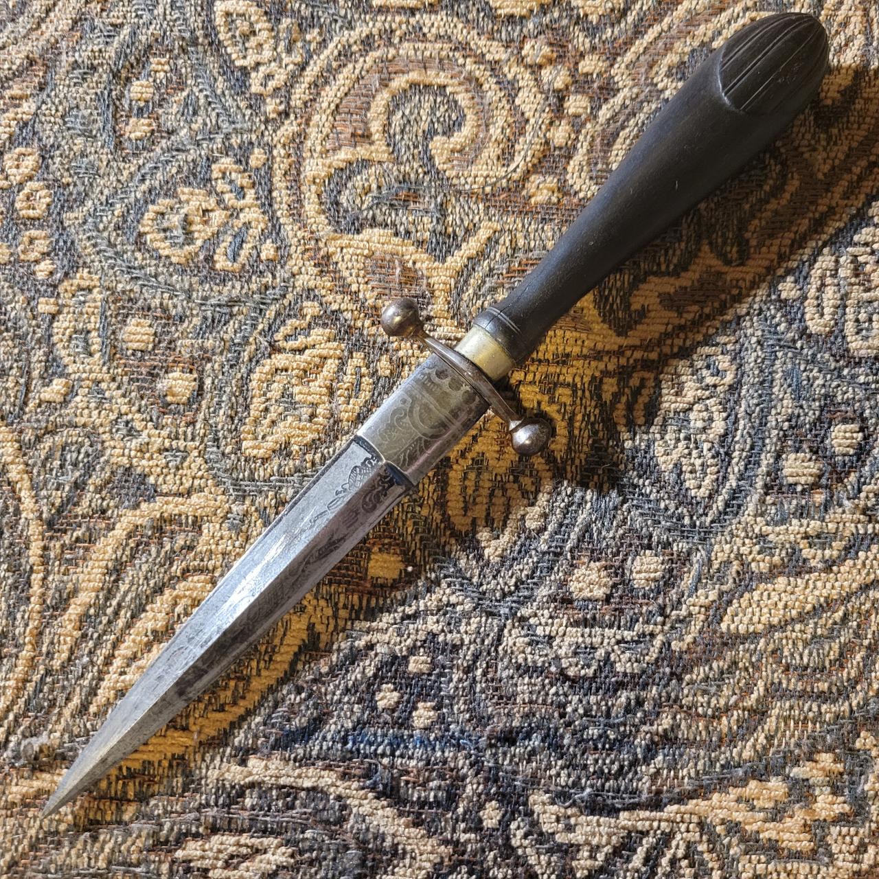

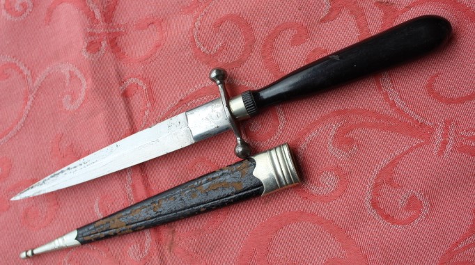

Hello everyone!
I've seen posts from these forums before regarding these type of daggers so I thought it would be the perfect place to ask. I had been looking for one of these daggers since at least 2008 when I first saw one of them at the gotavapen website for the fairbairn sykes dagger. I bought this one on fleebay and unfortunately the seller didn't say the guard was loose to the point it will rattle if moved. It has a good gap. My question is should I risk try to fixing it and if so how? I saw a person on instagram boiling one dagger to melt the resin/pitch keeping the handle attached and then reattach everything again. That dagger however had a bone handle. Mine is ebony wood.
Any advice would be appreciated. I wouldn't want to ruin or destroy this piece of history. But it sucks that when I finally get it it comes damaged like that. I've seen worse though.
If anyone has any information of time period and country of origin I'd appreciate any knowledge you may be able to share.

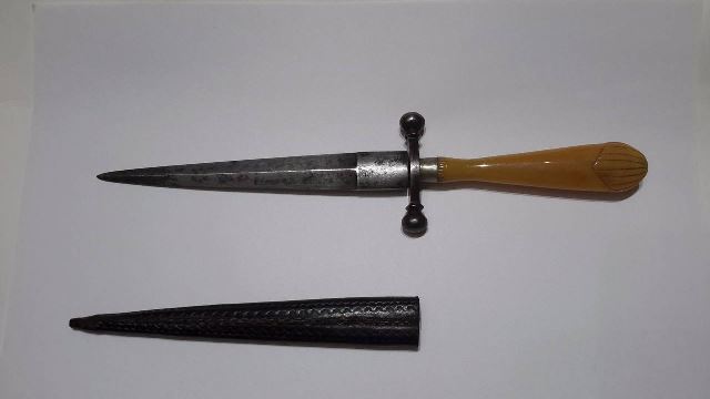

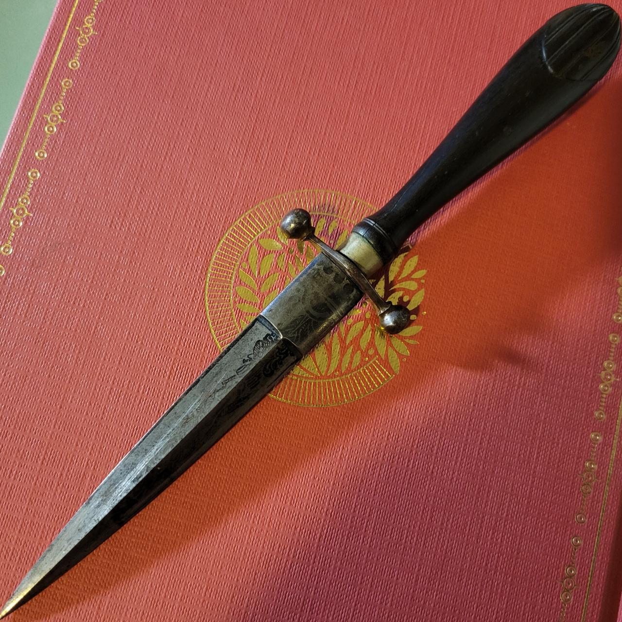

I guess that this dagger is German, from Solingen. I really doubt that the tang is riveted in up from the handle (maybe L_J can confirm) so I would try Ausjulius tip or open the handle and reset it new and strong.
Here a similar one.

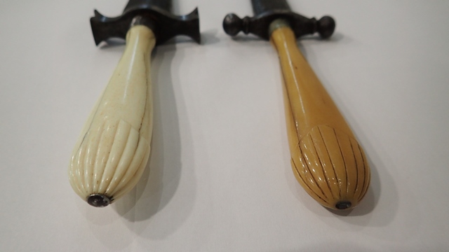

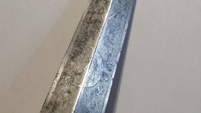

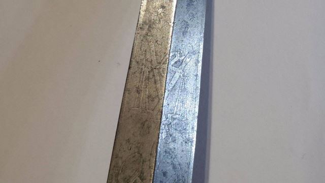

Posts: 147
Hi, Detlef. On the two that I can show, the tang are riveted to the handle. Both have a gap at the guard and it rattles. It is interesting that both are marked with Masonic symbols. Legendary_Jarl, if the handle your dagger is made of wood, then you can try to wrap it with a damp cloth and give it some time. I think it might help. The handle will restore the lost moisture and eliminate the gap.

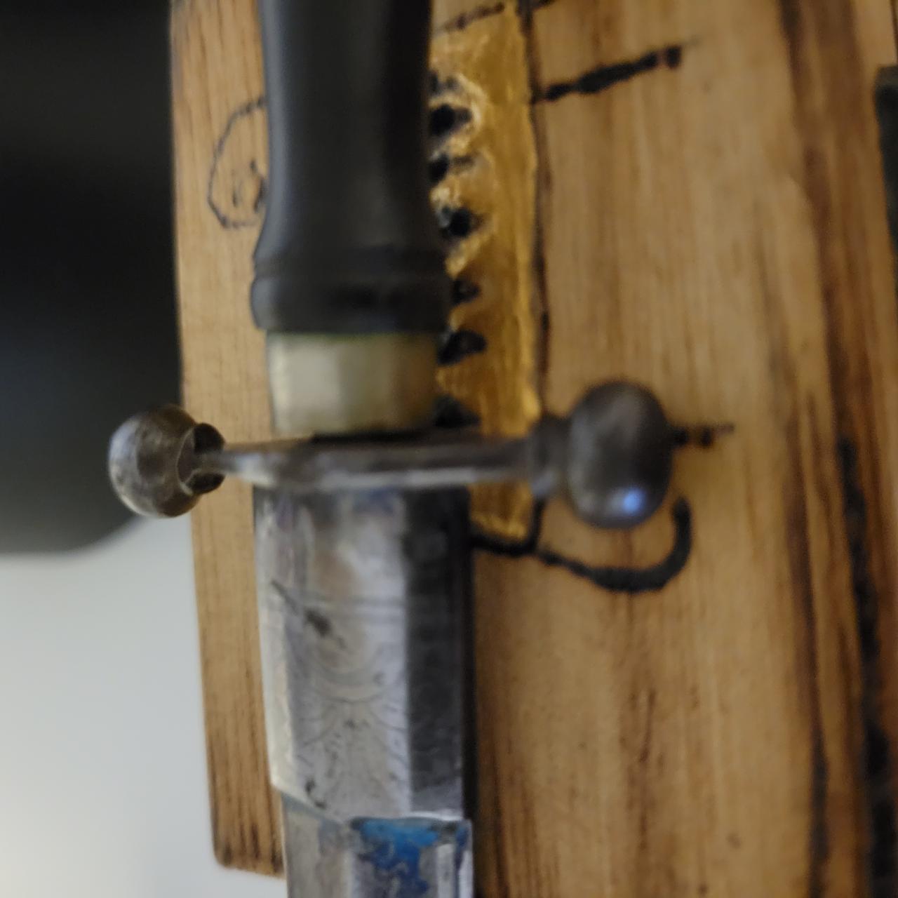

Posts: 12

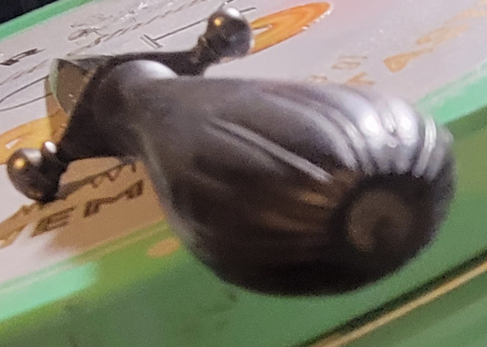

This is the best picture my phone could produce. I guess it was riveted before and it lost it but somehow it is still in one piece?
Will the wood benefit from a light coat of linseed oil?

Yes, peened. A repair is possible but needs experienced hands. So I would follow Saracens advice.
