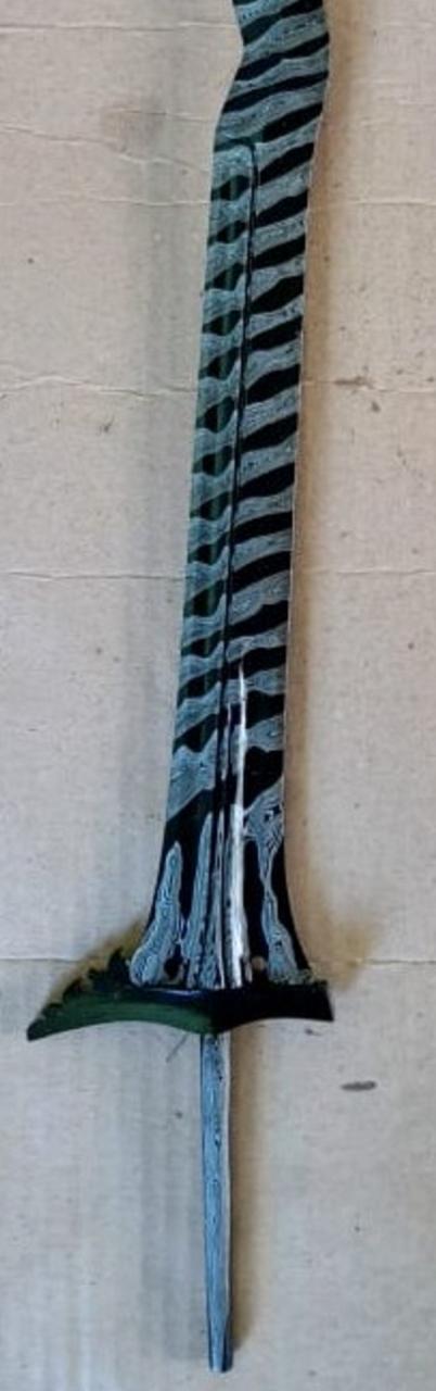

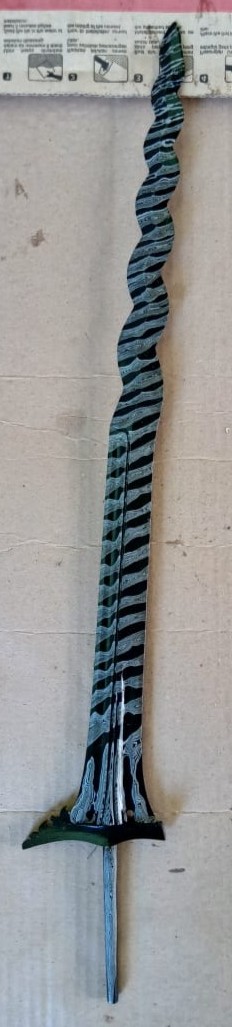

I hate the sound of silence. This is another new keris in made which is just finished. For your comments please especially on the workmanship. Thanks

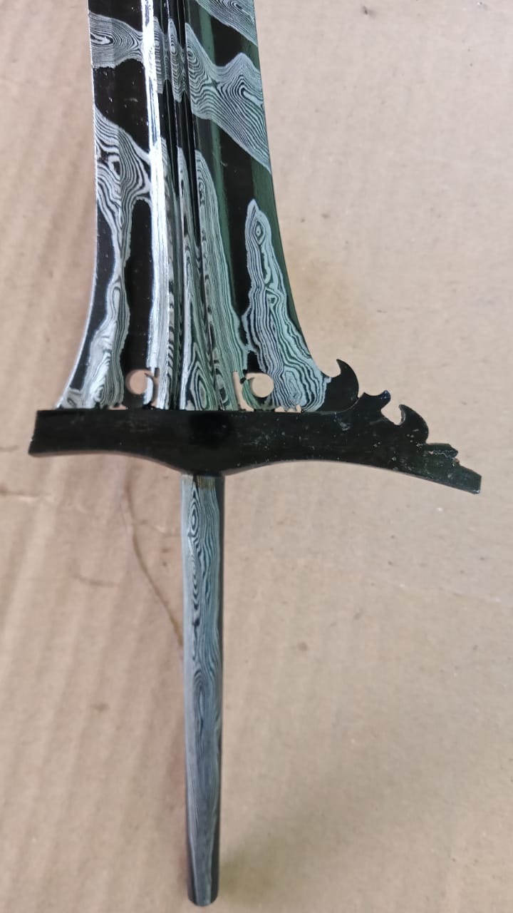

Well, it's 05:21 Wednesday, and since I'm awake and the post not yet commented on...
What is that dhapur called? The ganja looks like a good, tight fit. Don't see any obvious cracks, flaws, divots...cold shuts? No...scale pits; that's what I think I frequently see. The pamor looks like buntel mayit/mayat; I've never seen it wrap around so many times. I see quite a few very recently made keris with pamor that has a certain "smeared" appearance at the edges, but not here. At least, not from what I can see in the photos.
Hold on... If it's a keris ligan, and if "Shiva/Siva Eyes" are frequently found in keris ligan, does "keris ligan" constitute some sort of sub-category of keris in which special rules or none at all apply to dhapur and/or ricikan?

Hi, thanks for the review. Btw, what is scale pits? As for dhapur, my understanding it does not applies to Balinese bilah? Please correct me if I am incorrect.

In respect of the workmanship, it is absolutely impossible for me to comment on that from photographs, even from very high quality, very hi-res images I would hesitate to comment.
I will say that to my eye the overall impression (pawakan) is one of stiffness and imbalance, it looks as if the maker was working at the edge of his ability. But I could be incorrect in this comment, it could just be the angle of the photo.
Did the sculptor of this keris also forge the bakalan?

Hi Alan, thanks for the info. The empu made the whole bilah.
