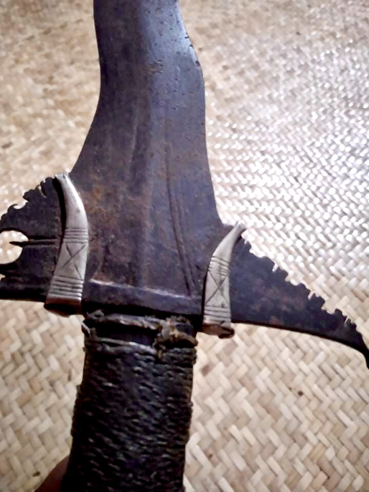

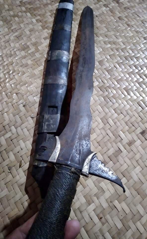

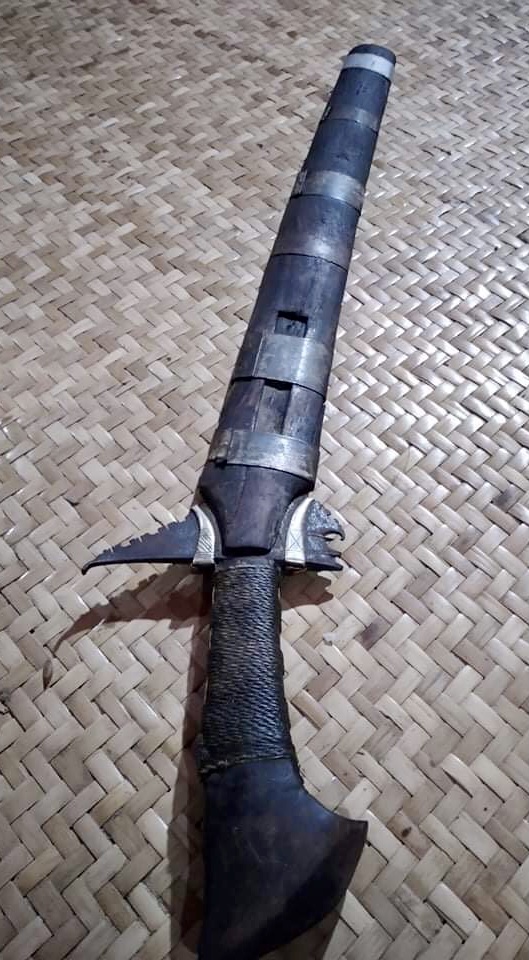

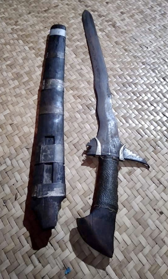

The Tboli prize these old Moro swords and call them “sudeng”. My knowledge of these Moro pieces is rather limited and so I’m hoping to gain as much education as I can from the members here. The piece is not in my possession so the photos are a bit limited for now but am hoping they can get the conversation started. I can ask for others.

Marbel, i don't see anything Tboli about this Moro kris. I have seen such blade fall into possession of other Philippines cultural groups and they are then given hilt and other dress treatments from those cultures. But this kris looks 100% Moro to my eyes.

Correct, it’s definitely Moro.
However as noted, these are often prized and owned by Tboli datus. This piece is specifically owned by the family of a late Tboli datu. The Tboli call this type of weapon a sudeng. I do apologize if my original post was a bit confusing. If removed from its provenance, there would be no Tboli connection. For those interested in the interactions between the Lumad of Mindanao and the neighboring Moro groups, I thought it would be useful to note that these swords are often kept as heirloom pieces by the Tboli and considered there own.
My hope is that I can learn from the Moro-expert members here about what can be deciphered from the photos. Any thoughts on age? The different elements of the sword, hilt, scabbard, etc.

This is a Maguindanao kris/kalis from the beginning of the 20th century. This is a more common form and not a datu style piece, or if it is, was modified years ago.

An interesting cultural piece with good provenance. There are a number of these Maguindanao kris around that have been modified by the T'boli, and are therefore identifiable as cross-cultural items. I have owned several such pieces with cast brass hilts that show a T'boli influence. Some of the other Lumad groups, such as the Bagobo/Tagakaolu, were also fond of Maguindanao kris.
In this regard, all of the examples I can recall were older Maguindanao swords that were more slender than many we see from the late 19th-early 20th C, which had broad heavy blades.
I will post some pictures of Lumad-modified kris in the next couple of days.
The word sudeng may be derived from the Moro/Visayan word sundang, which means "sword," and in the Moro context it is sometimes used for the straight-bladed form of kris.
