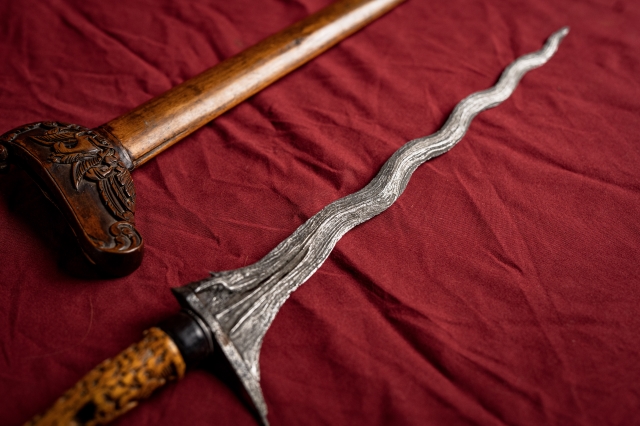

Default Requesting Help!! Identifying the specifics of a Kris
Hello VikingSword forums,
Thank you for allowing me to register as a user on this forum. Already I can say that it's been a great resource for me to gradually understand more about the Kris and it's cultural significance.
I was redirected here from a user on Reddit that had graciously assisted me when I posted some pictures of my Kris. Therefore, I ask help in finding out more information it. More specifically, if I could find out the composition of the grip, the age of the blade and scabbard, and the significance of the hilt in relation to the other aspects of the Kris. Many thanks for your thoughts and time. I look forward to spending more time on this resource.

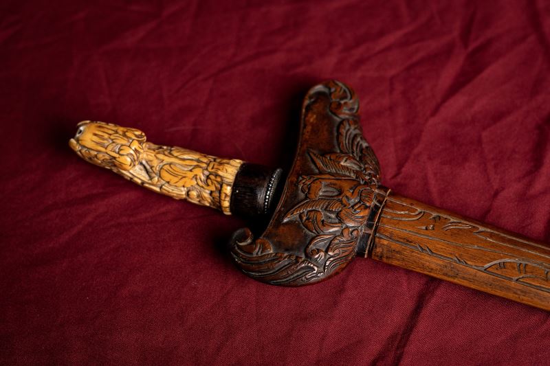

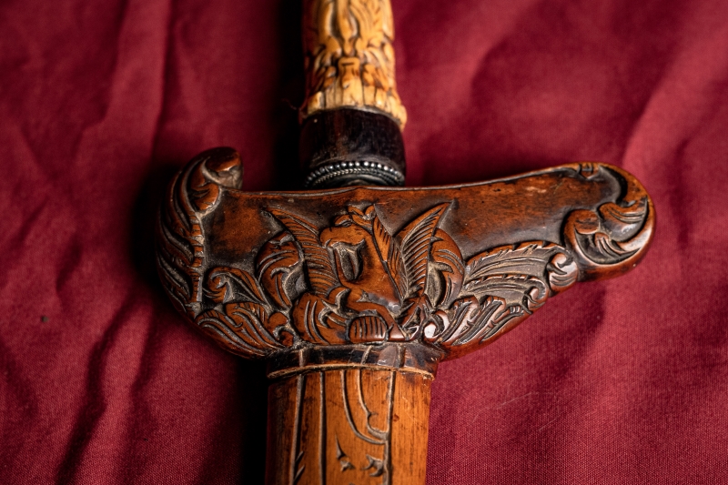

Welcome to the forum Max.

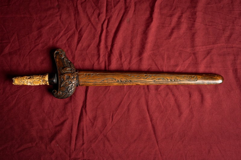

A nice old Madura/East Jawa keris.

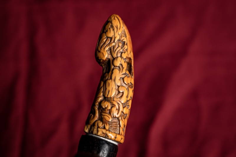

The ivory hilt looks like Kojuk Mrenges, though in a less detailed form. It seems to have some age. Is the base wood or horn. It is possible it is a newer part to replace damaged ivory at the original base of this hilt.
The top sheath is a wood i have seen before but can't name. Maybe someone here knows. This style of top sheath is a bit of a village folk art as far as i understand it. I like this carving. The motif is Si Mega, the mythical winged horse. It is regional emblem for Sumenup.
The gandar (stem) of the sheath looks newer than the atasan. The wear and the carving skills look different. But that shouldn't bother you.

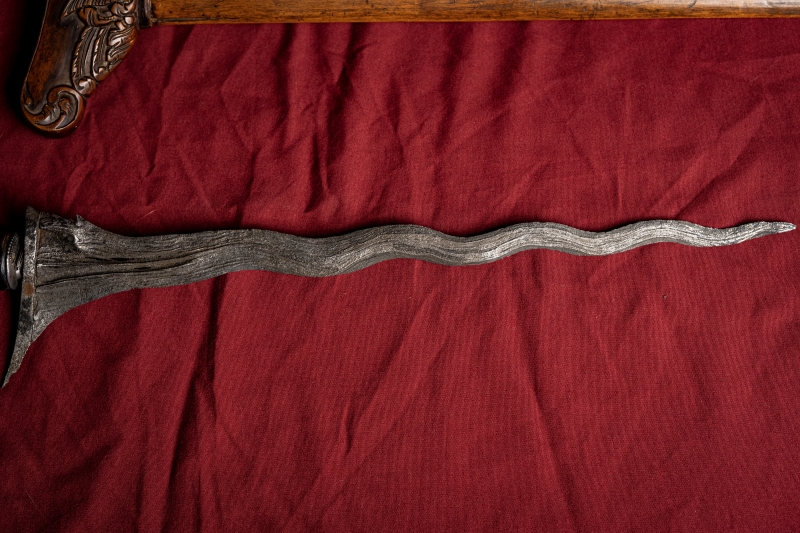

Honestly your photos of the blade aren't very good for analysis, but the blade looks like the oldest part of the ensemble and seems to have been fairly well constructed. I would say it was probably an 11 luk blade, though it seems to have lost it's final luk over time along with its finer details. It would be nice to see this blade cleared and re-stained to reveal the pamor better.
If this were mine i would probably replace the flattened mendak (metal hilt ring) with a new bit of jewelry.

Posts: 1,740
I agree with what David said, the scabbard is in Madurese deng-udengan or gabilan style.

Thanks Jean. Gabilan was the name i was searching my aging brain cells for.

Many thanks to those of you who replied to me. I appreciate it greatly and apologize for not getting back to you sooner. I believed that it would send me an email when someone replied, but it did not.
If by the base you are referring to the top part of the hilt, then I believe it is a dark wood material!
If you would like me to attach more specific photos of the blade, I would be happy to do that! Anything to get some more information on the Kris.
Thank you for the suggestions on cleaning it. I will start off with a toothbrush and slowly see if I can remove some of the staining.
If I can ask one more question, why are there holes in the grip of the Kris? Were those intentional?

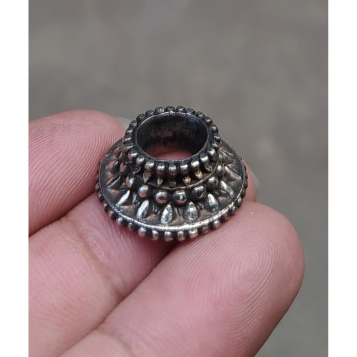

Maybe someone used to working with silver can put the mendak back in shape
Old 17th January 2021, 11:53 PM   #9
Posts: 7,297
That doesn't really make too much sense to me unless it was a particular rare form. Mendaks of good material and construction are relatively cheap to acquire through regular dealers or on eBay. You would probably have to pay a silversmith more to repair this than it is worth.
I can't see the damage. I have seen ones that seemed to have been crushed by impacts. If replacement is necessary then maybe an attempt to tap out the damage would be in order as there is nothing to lose
Has this blade been cleaned to the point it is hard to guess dapor? I was playing around with Tammens and could find a suitable match, but that is a condensed list if I am not mistaken.

If this blade had been made in Surakarta style we could give it as dhapur Bandhotan. Since it is not Surakarta style it misses out on some of the characteristics that we expect to see in a Surakarta keris, but it is still probably close enough to use bandhotan.
You can't see the damage? Looks pretty crushed to my eyes. I am also fairly certain there is material lose. Some of the little silver balls around the edge appear to be missing. I suppose one could take time and effort to try to pop it back up and maybe, if you had the skills, solder some new silver balls in place. But i'm not convinced you would ever be able to make it look like it hadn't been damaged.
Also, from my perspective, bringing a new keris into the family is sort of like getting a new girl friend. If you like her enough you might want to buy her a new piece of jewelry. Again, there is nothing in this particular mendak that i see that makes it special enough to warrant saving. I have bought sterling silver ones with stone inclusions for $25USD and you can find fairly attractive cheaper ones as well. I just don't see why it would be worth the effort to try to restore this one unless you just really want the challenge and are open to the strong possibility of an unsatisfactory result.
David, it might be crushed but with the angle of the photo I can't be sure. My eye for evaluation is still developing. As far as repair goes, I guess I tend to fix things, even things that aren't worth fixing. My friends actually make fun of me for the habit and the time I lose, but sometimes the results can't be duplicated by something new. Most of the silver mendaks I've seen online seem to be in Bali's style.
I certainly understand the joy that restoring things brings to many people. Don't let your friends make fun of you for things that bring you joy.
I won't provide any links to mendaks for sale online because that would break our rules, but if you just google "mendak keris" you will no doubt find many opinions for Javanese mendaks. I can be fairly certain the mendak on this keris has indeed been crushed flat because Javanese and Madurese mendaks have more width to them than what i can see. I cannot be sure of the exact style this mendak is, as there are many variations, but this mendak probably looked something like the one i have posted below.
Bali keris rings are called uwer (or wewer) btw, though sometimes they are misidentified as "mendak".
But my point here goes even a bit beyond whether or not you can restore this mendak (though i seriously doubt you could get a very good result), but more the idea that giving the blade a new mendak could be seen as something of a gift to MM's newly acquired keris, an honouring to the spirit of the keris and an acknowledgement of new ownership. Keris dress is often changed when a keris changes hands. It's just a matter of a different perspective i guess.
Of course, if you are up for the challenge you could always exchange info with MM and he could send you this mendak so you can see what you can do with it. I'd love to see you be successful with such a project in spite of my doubts.

Hello David,
This new mendak looks "die casted". Is that correct ?
Not much of a gift to a very old an genuine keris as presented in this thread.
I really prefer old mendak, as they are indeed like a jewel, a gift to the keris.
Hello David,
Ps, I like this thread about mendak :
http://www.vikingsword.com/vb/showth...=madura+mendak
Sorry, i posted the following as an edit on your post by mistake and then went back and deleted it.
Yes, i grabbed the first shot i could find on the internet in order to show I.P. the general shape of a Jawa/Madura mendak so that he could better understand why i was convinced that the one on this keris is squashed flat. It was not meant as an example of an exquisite or even medium grade mendak. That said however, it would be far better than leaving the one that is presently on this keris in place.

Hello David,
This mendak which you showed us is in bejen style from Yogya (see Keris Jawa book page 281) so not really suitable for this kris...
Old 27th January 2021, 02:08 PM   #19
Posts: 7,297
Originally Posted by Jean
Hello David,
Yes Jean, thanks, i am aware of that. LOL!
As i just explained to Asomotif, i was simply posting a any Jawa/Madura style mendak to demonstrate that the one on the OP's keris was squashed. This is an Eat Javanese keris and Max should seek a mendak that is more appropriate for this kind of keris. Of course, from what i can see of what is left of the mendak on the keris in question, it does not look like it was the proper mendak to begin with. Which is why i wrote " I cannot be sure of the exact style this mendak is, as there are many variations, but this mendak probably looked something like the one i have posted below."
So please excuse my laziness for not researching proper East Jawa mendaks suitable for this ensemble, but that was not my intended point at the time. If max would like to find a mendak more suitable for this ensemble he should probably be looking for ones in these variations.

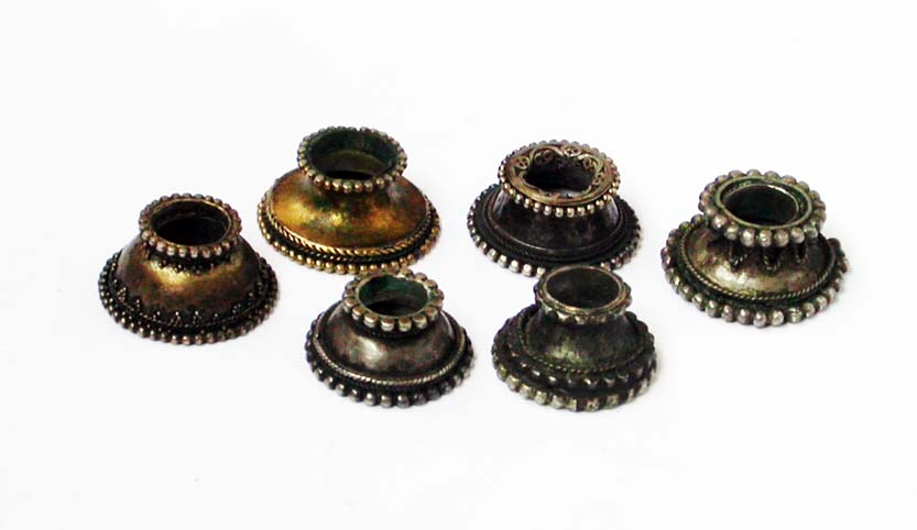

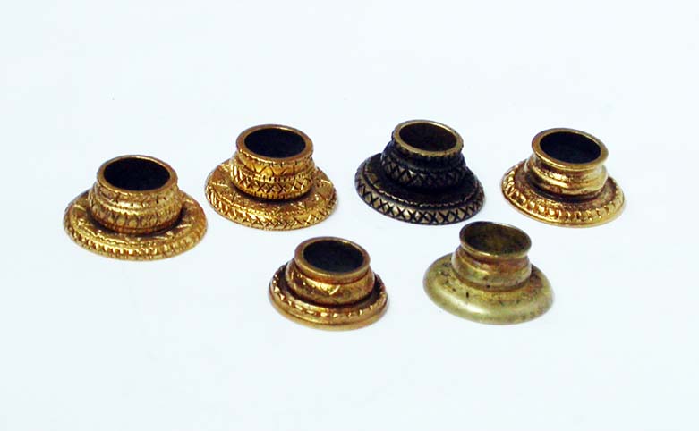

Old 27th January 2021, 07:33 PM   #20
Jean
Join Date: Jun 2009
Posts: 1,740
Yes David, these are very good and suitable pieces! I intended to show some pieces but did'nt as I got very few spares

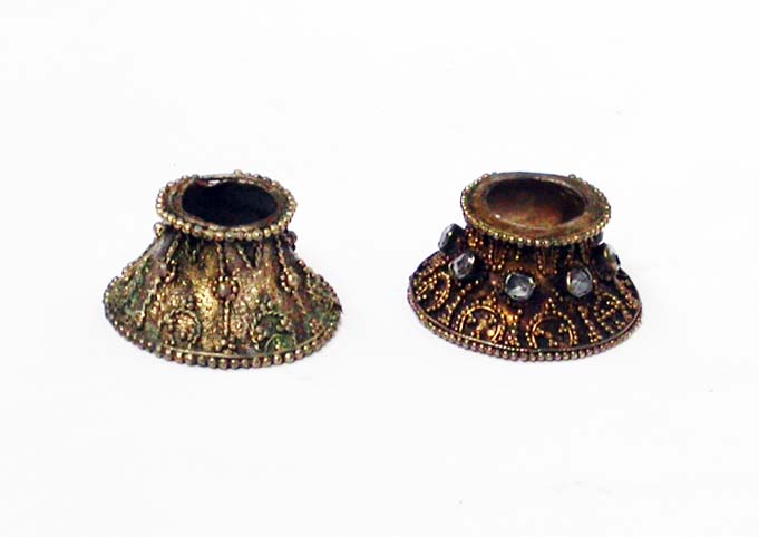

Posts: 7,230
Please refer post #14 & #17
In post #14 David has shown a mendak that Jean in post #17 has identified as "bejen" Jogja (Ngayogyakarta) style.
Jean's reference is Haryoguritno "Keris Jawa".
About this style of mendak.
On Page 39 of Solyom "World of the Javanese Keris" this style of mendak is identified as "parijoto" style. As to whether the mendak shown in post #14 is Jogja style or Solo style, there are minor differences only in Solo & Jogya styles, and it would be necessary to have the actual mendak in hand before it would be possible to state definitively whether it was suited to a Jogja keris or a Solo keris. My personal opinion based upon the photograph is that this current production mendak in Post #14 would probably prove to be better suited to use on a Solo hilt than on a Jogja hilt.
A further comment in passing:- in my experience, this current production mendak would be fabricated (ie, built of several separate pieces)it would not be produced from either a single die nor would it be cast. However, some of those separate parts could have been produced from dies, this is standard practice in the trade and has been for a very long time.
Solyom identifies this mendak style as parijoto, I also identify it as parijoto, both Solyom and I gained most of our Javanese terminology from Surakarta (Solo).
Haryoguritno spells "parijoto" as "parijatha" (see HG page 280).
In fact, "parijoto" is two words:- "pari + joto", it means "swollen rice grains", ie, not cooked rice grains, cooked rice is or "sega" (Ng) or "sekul" (Kr.), but it is dry rice ("pari") that has become wet & thus swollen.
The word used by Haryoguritno , "parijatha", is the name of a little bush that has yellow berries, these berries have a medicinal purpose, I'm not sure what that is, but it is something to do with pregnancy & child bearing. I'm afraid that Haryoguritno got it wrong in this case --- or more probably his informant got it wrong.
There is another problem with Haryoguritno's identification also.
He identifies the mendak style in post #14 as "bejen". In fact the spelling is not "bejen", but "pecen".
The word "pecen" comes from the word "peci" ("pici"), and can be understood as "like a peci", whilst this mendak style is not precisely similar to a peci, it is very similar to a fez (tarbus), so as with many terms used in the keris world we have an oblique reference. Again, Solyom appears to draw exactly the same line of connection as I was taught to draw.
I believe this term of "peci" for the Indonesian national black velvet cap was made popular by Sukarno, the other names for it are "songkok" and "kopiah". The name "kopiah" can be found (with various transliterations) in Old Javanese and appears to date from Majapahit times when it referred to a black three cornered cap worn by warriors, and until now as formal wear for a warrior. "Songkok" is I believe more Malay usage.
In Solo, a "pecen" style mendak must be set with stones.
The mendak shown by David in post #14 is not pecen style, it is parijoto style and it is more likely to be suited to a Surakarta (Solo) hilt than to a Ngayogyakarta (Jogja) hilt.

Hello Alan,
Both the EK (page 350) and the book keris Jawa (page 280) show a mendak model called parijata with peripheral balls of larger size than David's specimen and attributed to Solo, but the mendak shown by David with smaller balls is a different model in my opinion.
And in page 39 of the book "The Javanese kris" the "parijoto" model 119 with small balls is attributed to Yogya (120 also?), and model 121 with large balls is attributed to Surakarta.

Posts: 7,230
Thank you for your comments Jean.
I have not the smallest difficulty in acknowledging that you have every right to your own opinion, Jean. This is the wonderful thing about the Keris:- there is room for everybody to hold an opinion.
However, I am unable to know from a photograph if a mendak is suited to fit to a Solo hilt, or a Jogja hilt.
What I have learned about the parijoto mendak style is this:- any mendak of normal height that has balls of whatever size running around its middle is a parijoto style mendak:- the size of the balls is totally irrelevant.
The mendak shown by David is unquestionably parijoto, but whether it is suited to a Solo hilt or a Jogja hilt I have absolutely no way of knowing.
In the matter of deciding whether a mendak is correct for mating with a Jogja hilt, or with a Solo hilt, the single most important thing is the size of the mendak, not the size of the balls. Usually the base of a Jogja hilt is smaller than the base of a Solo hilt, design differences between Solo & Jogja mendak can exist, but they also overlap, and what needs to be done is match the mendak to the hilt. A mendak that is intended for a Jogja hilt will usually be too small for a Solo hilt, a mendak intended for a Solo hilt will usually be to large for a Jogja hilt. It is totally impossible to know from a photo whether or not a particular mendak will fit a particular hilt unless you have them both in hand, or you know their measurements.
Jean, I think the reference you mean is "The World of the Javanese Keris" ? Solyom?
On page 39 of this book there are 4 different styles of parijoto mendak shown, the common feature which makes all of them "parijoto" is that they all have a ring of balls running around their middles. It is that ring of balls that makes them "parijoto".
Now, Solyom has identified where they were collected, and possibly what hilt they will fit, but we can only take Garrett's word for it, because we do not have anything in the photos to compare them with, nor do we have them in front of us. It is diameter and overall size that determines whether a mendak is correct for a Solo hilt, or a Jogja hilt. The size of the balls, and even the shape of the balls, has nothing at all to do with it.
But still, I must admit, I am a bit particular about details like having a hilt fitted with the mendak that is correct for it, and in fact, the differences between Solo & Jogja mendak are only marginal, so I guess anybody can fit whatever they wish with anything else, if they are happy to do this.
Hello Alan,
It is not my opinion but Haryoguritno's one who distinguishes between the 2 types of mendak, see pages 279 to 281 of the book "Keris Jawa" (and also in the EK pages 289 & 290).
