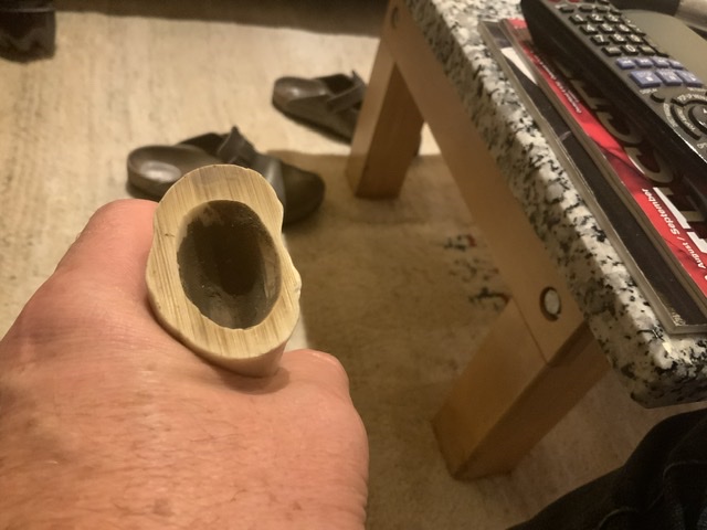

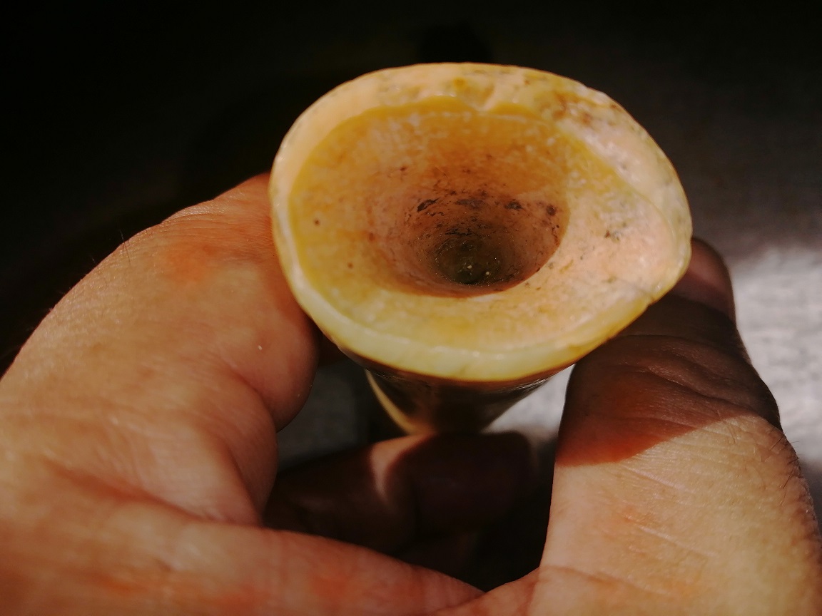

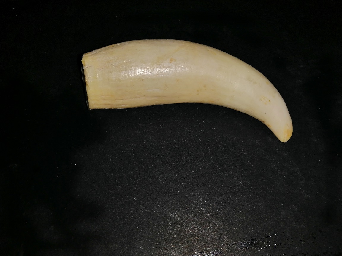

Default IVORY FOR POMMEL

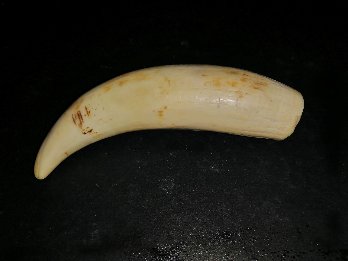

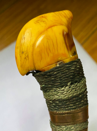

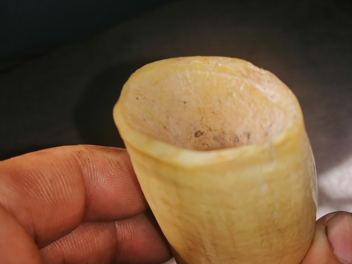

This is supposed to be a sperm whale tooth. Purchased from a seller who informed us that it came from tawi-tawi, from way way back.
My plan, if indeed this is sperm whale tooth, is to use it as a pommel to an old barung or kris (which has no pommel).
I've done some reading and this specimen conforms (in my unexpert opinion) to ivory. The ff are some things I have read on ivory's characteristics:
a) ivory always has parallel grain, like rings on a tree or crosshatch pattern called Schreger lines. On closer inspection, this tooth has both parallel and crosshatch patters.
b) in contrast to bone, ivory has a smooth feel.
Thanks in advance for you inputs.
Yves

Old 12th October 2020, 07:12 PM   #2
thomas hauschild
Join Date: May 2017
Location: Germany
Posts: 150

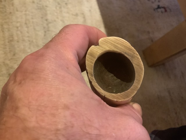

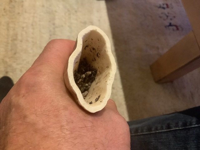

Please show a pic of the root-hole. This will make it a little bit more clear.
thomas hauschild is offline   Reply With Quote
Old 12th October 2020, 07:17 PM   #3
thomas hauschild
Join Date: May 2017
Location: Germany
Posts: 150
Sperm whale real and fake/resin
Old 12th October 2020, 07:19 PM   #4
thomas hauschild
Join Date: May 2017
Location: Germany
Posts: 150
Walrus real and fake/resin

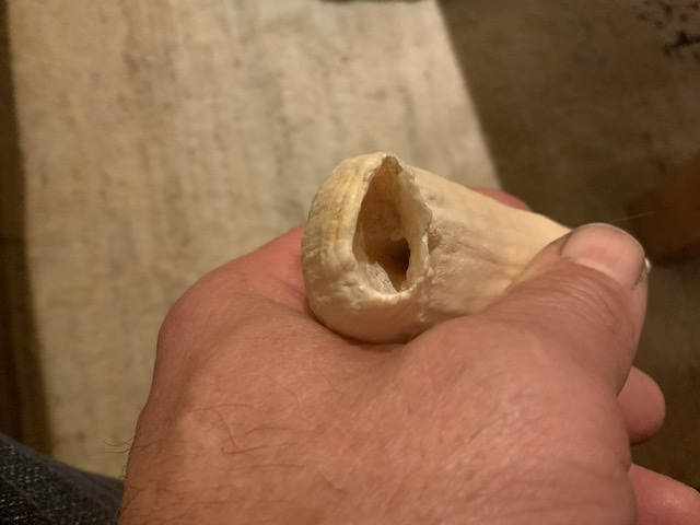

Old 13th October 2020, 02:50 AM   #5
tanaruz
Join Date: Apr 2020
Posts: 283

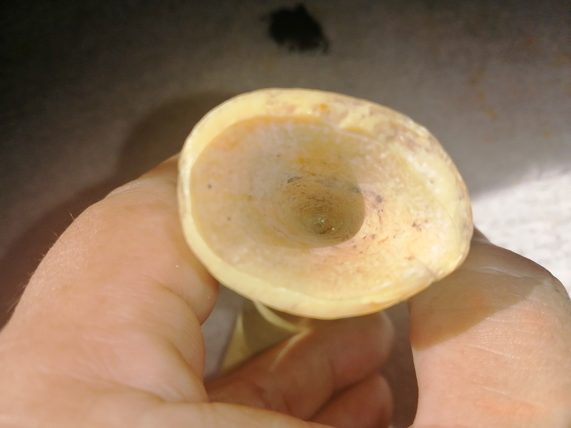

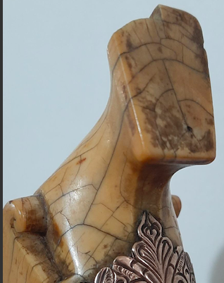

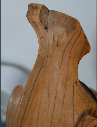

Many thanks for the initial info. Here are some more pics.
Thanks in advace.
Yves
tanaruz is offline   Reply With Quote
Old 13th October 2020, 06:50 AM   #6
mariusgmioc
mariusgmioc's Avatar
Join Date: Sep 2014
Location: Austria
Posts: 1,918
Very difficult to judge from photos alone, but from what I see, it looks like resin.
You can easily test it ether trying to burn a tiny piece of it or by simply polishing it and you'll see how it behaves. If it melts and smells like plastic is resin, if it smells like "dentist" it is ivory.

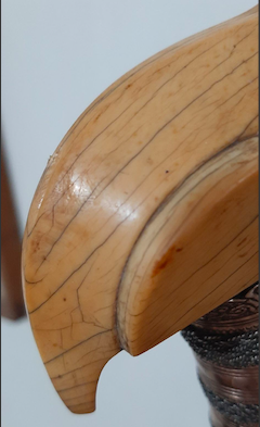

Greetings sir Marius, this thread has aroused my interest. Can you assess my piece as well? I'll try to sand off a portion of the break in the pommel and burn it for verificiation, but for the meantime here's a picture.
Old 13th October 2020, 08:39 AM   #8
tanaruz
Join Date: Apr 2020
Posts: 283
Default ivory for pommel
Hi Sir,
Can you expound on the statement 'how it behaves'? what would be best to use for polishing?
Thanks
Yves
Old 13th October 2020, 08:38 PM   #9
mariusgmioc
Join Date: Sep 2014
Location: Austria
Posts: 1,918
How it behaves: if it melts is plastic; if it smells like "dentist" is ivory.
For polishing you can use sandpaper, 600-800 grit and give it a few rapid rubs. If it is ivory will smell like "dentist."
For final shiny polish you need to go to higher grit (3000-7000).

One photo from the side is not enough. You should post more close-up photos. Generally this type of hilts are made from elephant ivory. You should check for the Schreger lines.
I do not advise polishing/fire testing any finished product. For a raw piece of material is another story.

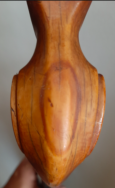

Old 14th October 2020, 01:50 AM   #10
xasterix
xasterix's Avatar
Join Date: Oct 2018
Posts: 714

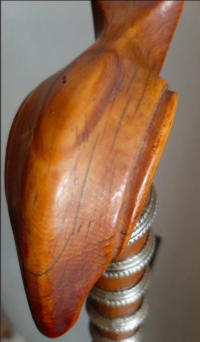

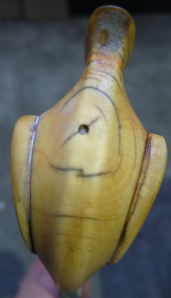

Hullo, here are more pics of the pommel.
Old 14th October 2020, 03:12 AM   #11
Rafngard
Rafngard's Avatar
Join Date: Jun 2015
Location: Minneapolis,MN
Posts: 377
I'm sure members with more experience than I will chime in, but to my eye it looks like elephant ivory, and overall, a really beautiful specimen.
Old 14th October 2020, 05:51 AM   #12
xasterix
xasterix's Avatar
Join Date: Oct 2018
Posts: 714
Thanks Leif! Additionally, if it's not much of a hassle, may I ask everyone to assess my friend's piece, of similar build as mine.
Old 14th October 2020, 06:08 AM   #13
tanaruz
Join Date: Apr 2020
Posts: 283
Hi,
Did some 'polishing'- and it smells like burned 'enamel.' must be the 'dentist' smell.
I did contact an expert on this things. Sent her some pictures. Initially, there's the presence of Schreger lines + crosshatch pattern on the tooth.
And I was advised to bring the item to her for a visual verification.
Thanks and regards,
Yves
Old 14th October 2020, 06:20 AM   #14
tanaruz
Join Date: Apr 2020
Posts: 283
Hi again,
forgot to include another test which I did (upon the instruction of the jeweller).
I got a needle, had it red hot on the fire and tried to pierce the tooth. - and voila, it did not went into the tooth.
Best
Yves
Old 14th October 2020, 03:09 PM   #15
mariusgmioc
Join Date: Sep 2014
Location: Austria
Posts: 1,918
The geometry of the cracks is consistent with ivory.
From all I know there are some ivorine resins that crack, but without round/circular cracks. Round/circular cracks are specific to ivory as they follow the growth rings.
Hi Marius,
Disagree again with you, soory! The sperm whale tooth look real to my eyes but agree with you that's difficult to judge from a picture alone.
Old 14th October 2020, 08:48 PM   #18
Hi Yves,
Sperm whale tooth shows no Schreger lines so far I know, only elephant ivory shows this lines.
Old 14th October 2020, 08:49 PM   #19
Elephant ivory!
Old 14th October 2020, 08:50 PM   #20

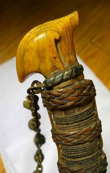

Also elephant ivory.

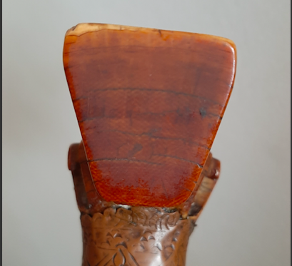

Posts: 714

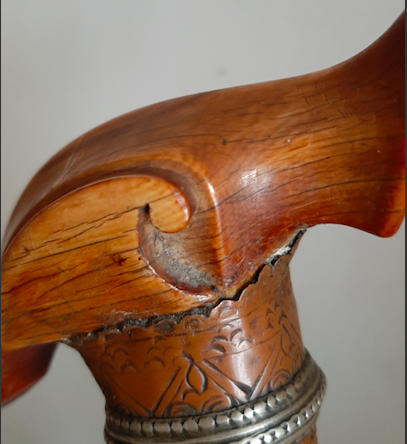

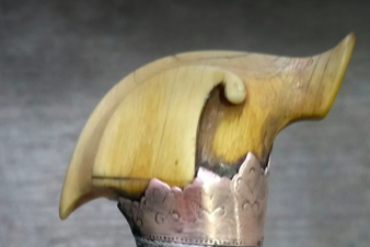

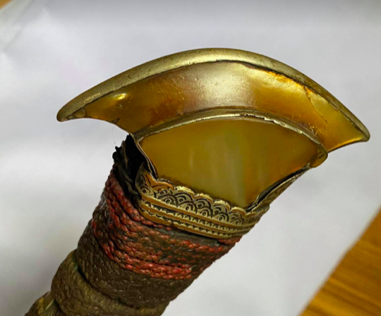

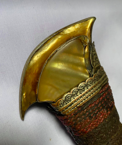

Here are other samples, from another friend's collection. The one with the reddish hilt intrigues me, as it's a standout from the other ivory-looking samples. One of the hilts is also unique, having a string of hawk bells tied from the base of the pommel up to the gangya as a makeshift guard.
TIA for anyone who'll assess! Much appreciated.
Old 15th October 2020, 02:59 AM   #23
Posts: 7,403
Xasterix, the Maguindanao pommel looks like aged Mother-of-Pearl in silver frames to me. I have seen it darken like this.
The other pommels are ivory. The red coloration is the result of the presence of sulfur which oxidizes the ivory from red to a dark reddish brown or a honey-is brown.
I find the T'boli bells interesting.

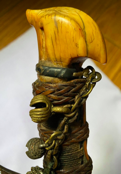

Old 15th October 2020, 03:15 AM   #24
xasterix
xasterix's Avatar
Join Date: Oct 2018
Posts: 714

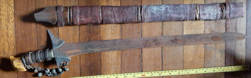

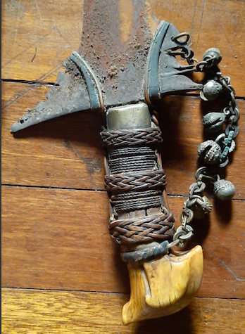

Thanks sir! Here are "raw" pre-restoration pics of the hawkbell-guard kris.

Posts: 377
That is a really interesting piece. I don't think I've ever seen anything like it.
Old 17th October 2020, 06:21 AM   #28
Posts: 7,403
This again proves a lot of trade between Philippine groups. Fascinating isn't it?

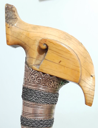

Old 13th May 2021, 08:21 AM   #29
xasterix
xasterix's Avatar
Join Date: Oct 2018
Posts: 714

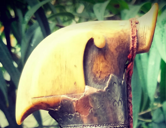

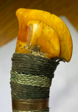

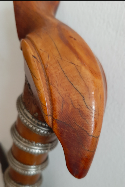

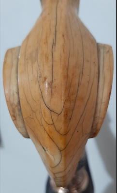

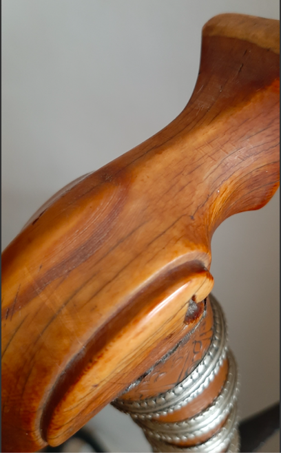

Hello everyone...would like to ask your opinions on this pommel. I'm still in the process of restoring the rest of the kris, but I suspect this is ivory. Would appreciate your inputs, thanks!
Old 13th May 2021, 10:44 AM   #30
Athanase
Athanase's Avatar
Join Date: Mar 2016
Location: Paris (France)
Posts: 432
It's clearly Elephant ivory. Very nice patina.
