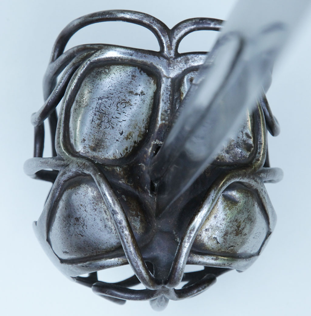

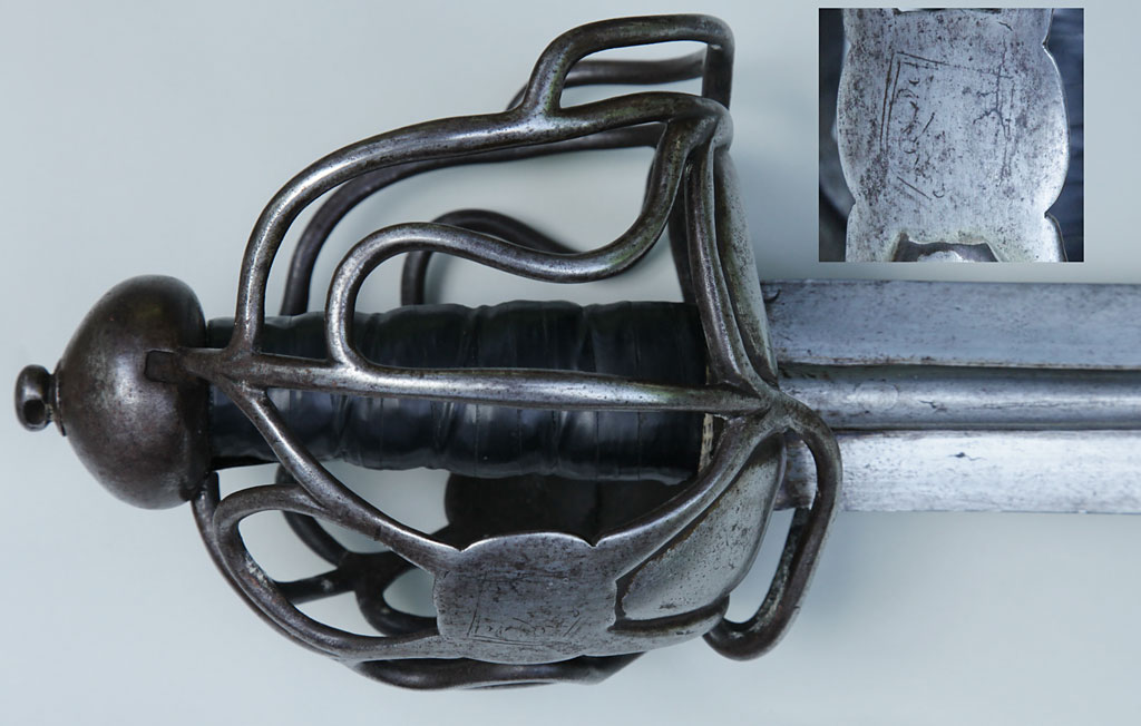

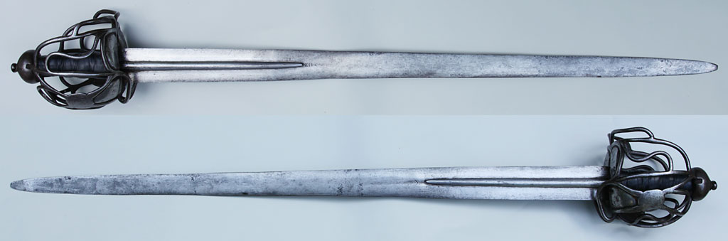

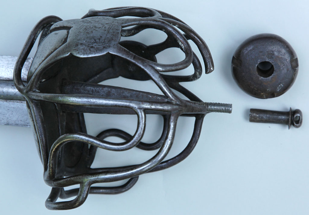

Following a discussion in another thread I promised to present an example of a threaded tang on a British sword dating to around 1600. Having dismounted the pommel, I am doubting that the actual threads that I now see are pre-Victorian. We do know where this sword was in 1881 as it is illustrated, likely with artistic 'restoration,' in Drummond's Ancient Scottish Weapons and it was sold with the W. Wareing Faulder collection in London in 1889. The sword disappeared for about a century until it resurfaced at Christie's in May, 1994. The current academic opinion is that this sword, as presently configured, is English from around 1600 with a reused 14th century blade and this attribution depends considerably upon the pierced, threaded tang button (a feature seen on the Twysden baskethilt at the Met). The Baron of Earlshall did not exclude a Scottish origin in 1996 (Park Lane Arms Fair catalogue, pp. 30-38) but he had largely come around to the English attribution in 2016 in The Scottish Basket Hilted Sword, vol 1, pp. 464-470. I am hardly in a position to argue with the authorities in this field, but I have always wondered if this sword is not an object intended for the same uses as the Scottish 16th century two handed swords.
Old 6th June 2020, 04:54 PM   #2
Lee
Lee's Avatar
Posts: 1,004
Wink Technical details
However, the sword has clearly seen some use and substantial wear and it was clearly made for and shows evidence of use and not mere parade display. The plano-convex stiffening rods are attached to the forte of the blade proper by rivets, but are welded to the tang, showing some respect and attempt to preserve the original heat treatment. Overall weight is just shy of 5½ pounds (2.487 kg) with the balance point 4 inches (~10 cm) forward of the guard. The blade is just over 38½ inches in length (97.7 cm) with an overall length of 44¾ inches (113.8 cm).

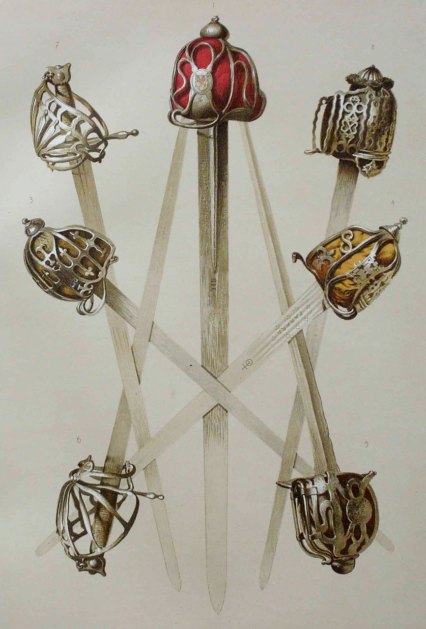

Lee, thank you so much for this excellent demonstration on the topic of the early use of threaded tangs !
Also for the wonderful photos from Drummond a book I always dreamed of having!
If I may just add an unrelated note on that illustration, the hilts in the uppermost left and lower left of the six shown are actually Italian schiavona not Scottish.
In the time of Drummond's work it had been presumed that the Scottish basket hilt had either derived from the schiavona or been closely related. It was later of course shown that the two hilt firms were structurally different and in fact not related as seen in the 'lattice' type character of the schiavona .

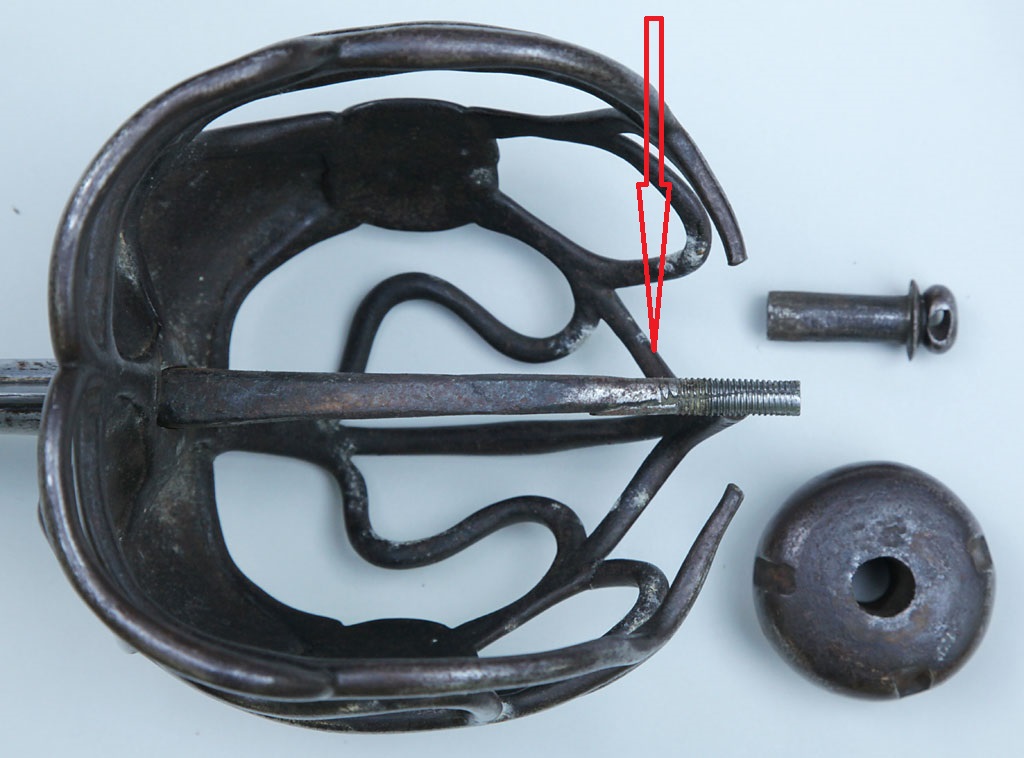

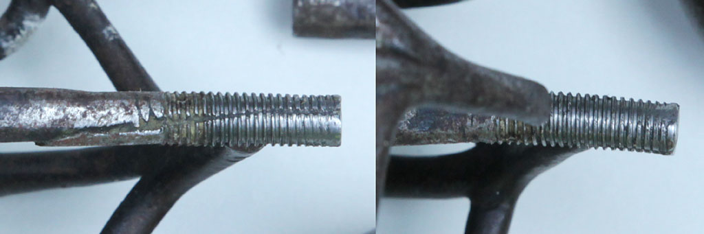

Here are closer-up up views of the threading. I wonder if the obvious diagonal weld line in one of the views indicates material added at the last restoration to 'beef up' the end of the tang so that the same threaded tang button could also be re-threaded inside.
I have also wondered how much of the state of condition that we see in Drummond's drawing published in 1881 was the artist's reconstruction of how he thought this sword had once appeared and how much may be Victorian era restoration that has now perished. There is also evidence that there had been considerable decoration on the forte of the blade that has long been almost completely rubbed away. Further down on each side of the blade there are running wolf marks that I failed to photograph. Published accounts regularly speculate that the 'ail' inscription just beyond the reinforcing rod might be the end of a longer now hidden inscription, but I believe that it was added around the same time as the basket hilt and rods.

about the obvious diagonal weld line at the end of the tang, im not sure this could also be a line from forging its hard to tell for sure.

The scarf weld is fairly apparent. There were definitely lathe screw threads of size well before the Victorian age and certainly in the 18th century. If you have, or can borrow some thread gauges (look like notched feeler gauges), a clear match might place it to a standard thread pitch, tpi, etc.
By the mid 18th century, there were some standards for interchangeability.

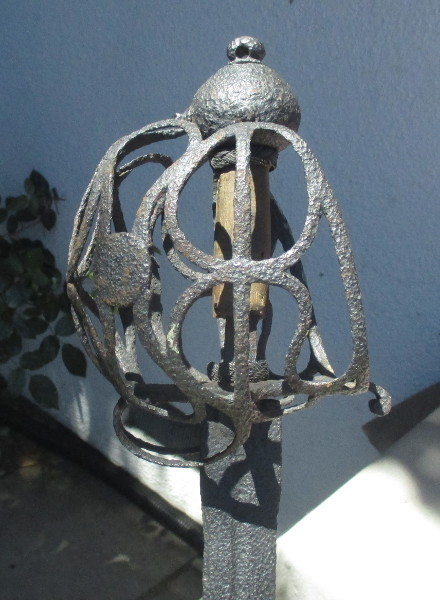

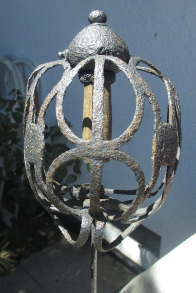

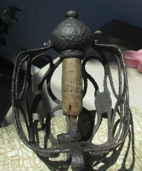

I have an excavated basket ca.1600-20 that also has the threaded capstan. I'll dig around and see if I can find a photo and post it here.
--ElJay

Found the photos!

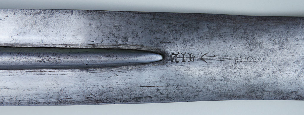

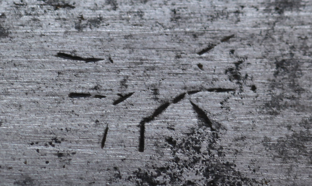

Yes, very much the same 'onion' shaped pommel and threaded tang button! How do you attribute this excavated sword?
Also, belatedly, here are photos of the running wolves and seriously rubbed blade decoration.
