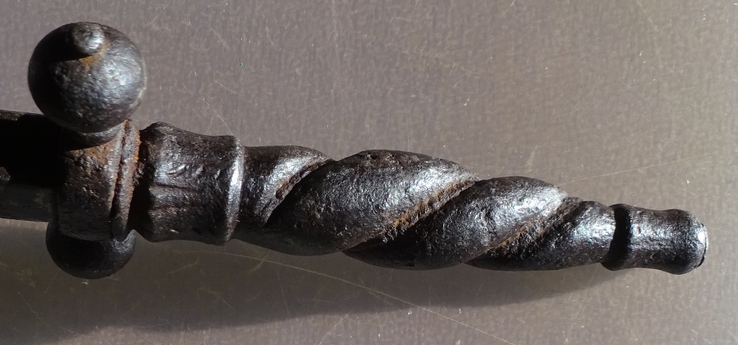

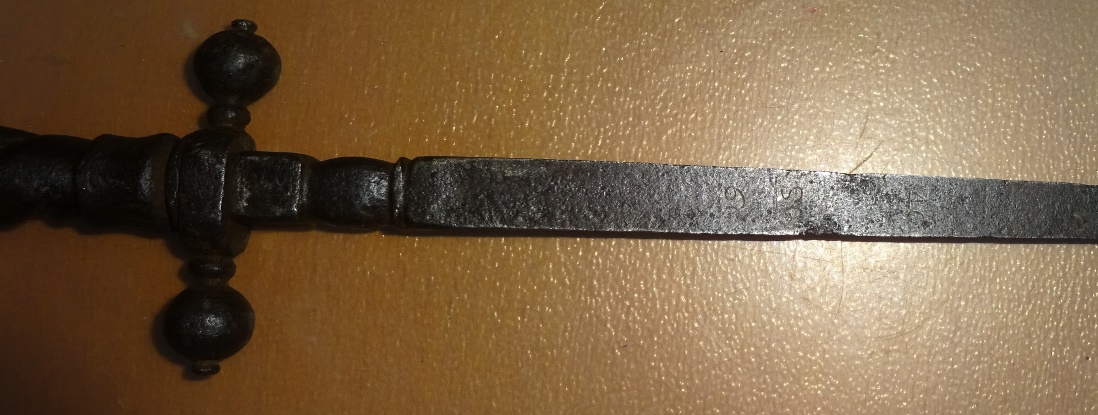

What do you guys think of this one ?
Looks like it has a clear maker's mark
... A genuine item ? .

Awesome piece, Fernando! Looks like the real deal to me as well! Any numbers on the blade? (Gunner's piece?)-
Old 26th September 2019, 06:03 PM   #4
Thank you for the kind words, Gentlemen.
No Mark, not a gunner's stiletto (AKA Fusetto).
I will have to find some lid to the mark.

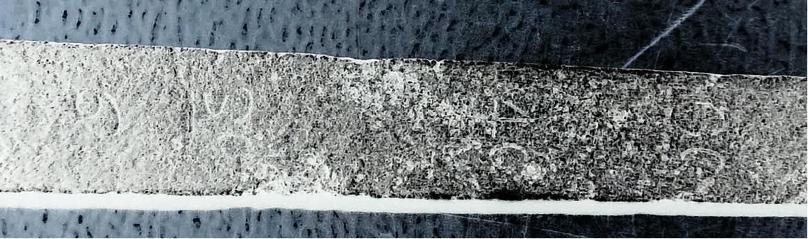

Old 2nd October 2019, 06:01 PM   #5

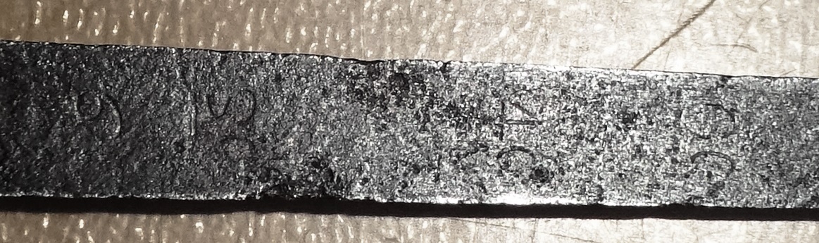

Default Looking better ...
Amazing !
Be it because of the patina 'crust' or due to the unusual superficial marking depth, i did not see at first some of the gauge numbers still showing on the blade.
Considering that, as often written on the subject, these markings were often used to give a gunners look to the stiletto, as those as simple weapons were forbidden to carry by the authorities, one could think that in this specific case, those superficial numbers were intended to serve as a disguise ... my guess.
So, for what 'officially' counts, this stiletto is indeed a gunners fusetto, also called a centoventi, such was the name for they were popularly called, due to the numbers in the gauge going up to 120 (centoventi in Italian).
Given the work put on the dagger and the early style of the digits, i would dare to attribute its age to some time in 17th century.
But of course, i am ready to be corrected.

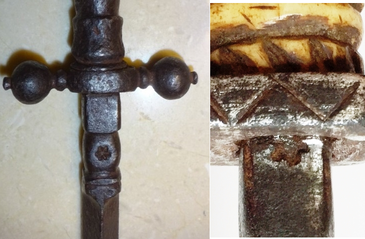

Hi Fernando,
I have stiletto with the same maker's mark:
http://www.vikingsword.com/vb/showthread.php?t=24775
alex8765 is offline   Reply With Quote
Old 3rd October 2019, 04:49 PM   #13
Originally Posted by alex8765
Hi Fernando,
Alex, may i suggest that the mark in your beautiful stiletto does not look the same as the one in mine.On the other hand, i wonder if yours in Gyngell's work, as one of the 16th. century

Thanks Fernando,
Yes, the mark on my stiletto does look like Gyngell's work.

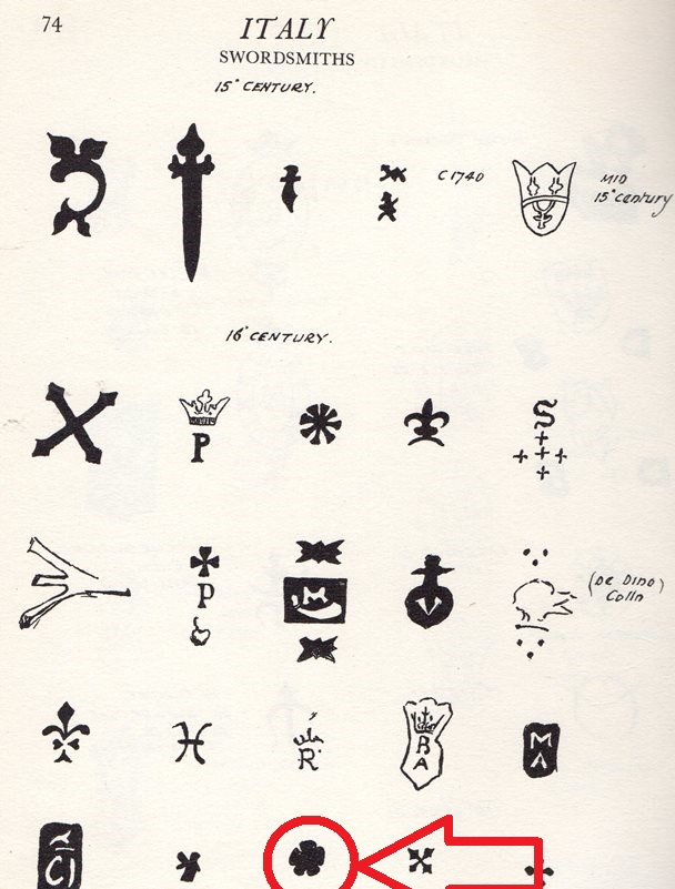

Hi Fernando,

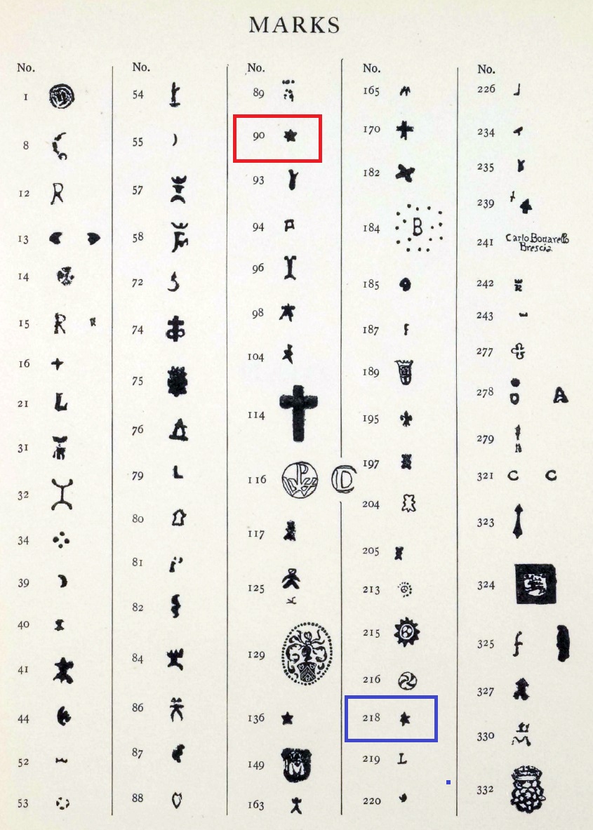

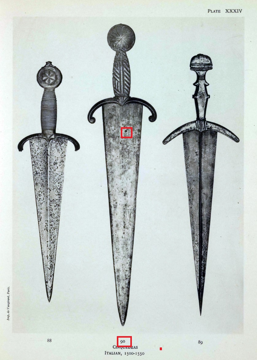

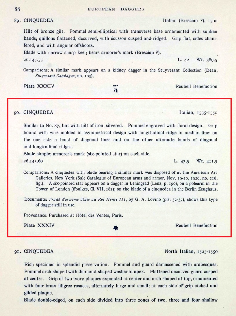

I just found these in Dean Bashford's "Catalogue of European Daggers".
Old 4th October 2019, 03:53 PM   #17
Hi Fernando,
Thank you so much Alex,
Yes, those six pointed stars, specially the one on the #90 Cinquedea, "look" like it.

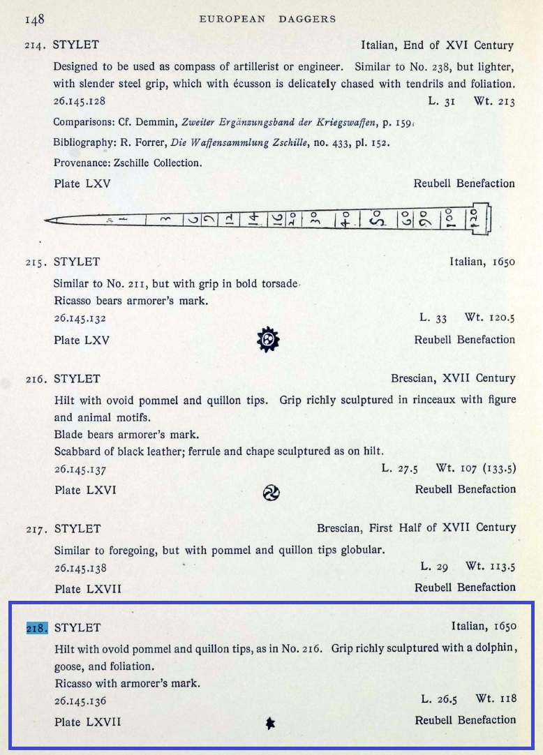

I have been digging into the mystique that involves this type of daggers, namely their name, their typology and their purpose.
Concerning their name, i am amazed to have found one more; stiletto, fusetto, centoventi ... and now regola; the last two obviously referring to the ‘scales’ marked between notches in the blade.
As typology (if i may call it so) it appears to descend from the famous misericordia.
The purpose; starting by their sharp point, we may select one or all of three uses, cleaning the cannon touch hole, piercing the gunpowder bags and plug the touch hole in case of retreat in battle.
And at last, the more controversial ; marked from 1 to 120 (apparently always 1-3-6-9-12-14-16-20-30-40-60-90-100-120), is often being conotated with the calibres measurement, probably as it looks like the immediate simple inferrement. But looking at assumptions made by those considered experts in the matter, this is rather improbable according to some and even stated as being something else by others.
From Daghe & Coltelli “Apparati per la tavola e la guerra nel Rinascimento europeo”
… other versions of the same dagger, reported notches on the blade ("stiletto centoventi") and it was said that it was also an instrument used by gunners to measure the calibres of the guns; but this interpretation, contested by many experts, for the disparity of the measurements and the arrangement of the same on the blade, left space also to another legend: being a weapon easily concealable and for this very often prohibited, that the excuse of professional use could be a valid reason for possession.
Or ...
From “Quaderni Friulani di Archeologia VII/1997 by FABRIZIO BRESSAN”
The shape of dagger is recognised in fusetto or centoventi, the style at one's disposal to the Veneti gunners used approximately from the middle of the XVII century to the whole Seven hundred; the weapon is distinguished for one characteristic staircase, in notched numbers from 1 to 120 (why the name) that, carved on one of the faces of blade they were representing a reminder of calibres (to note, not their "measure") used by artilleries of the then Serene Highness.
Having that said, and considering that, at the period, such concealable daggers were highly prohibited to carry around, as per abundant published material, we could gather that, the markings on the blade, were only a subterfuge to illude the law, by giving them a professional attribution; their actual utility not being the issue.
