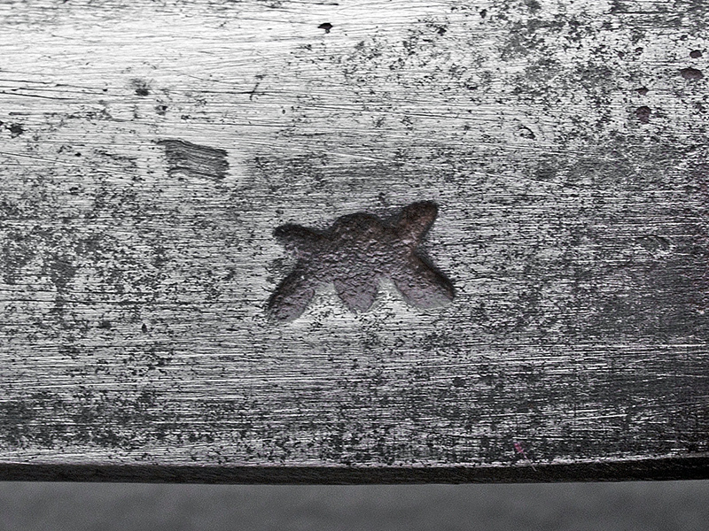

Hello Everyone,
can someone help me out, point me a direction (to a book or another source) or may know anything about that mark on an Italian Sword dated ca. 1580. Wheter it is a makers mark, inspection mark or whatever. It is the only mark on the blade, at the Ricasso. I have seen similiar ones from/out of Veneto but never a single one like this.
Thanks!
Ray

You are right in that this is a mark showing in Italian (Veneto) blades of the XV-XVI centuries, as indeed these often appear in a multiple mode and not one alone. I would venture that this is more the type of region or quality mark and not a smith's signature.
However these are all guesses; other members will show up with more knowledgeable comments about it.
Meanwhile we expect you to show us pictures of the whole sword, to let us see what we are talking about.

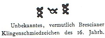

I found this mark in a German book: "Wendelin Boeheim, Handbuch der Waffenkunde". The translation is: Unknown, probably mark of a blade smith at Brescia 16th century.
corrado26

Thank you Udo for furnishing these entries from the most referenced compendiums of these many markings found on blades. It is really helpful to have these to view for readers who may not have these resources.
As Fernando has well noted, these markings, commonly termed 'twig' marks are seemingly collectively used in Italy (typically North) by many producers and often in varied configurations. While we are uncertain of the exact meaning or purpose of these stamps, they do seem to serve perhaps as some type of guild or production mark possibly for identification or compliance reasons.

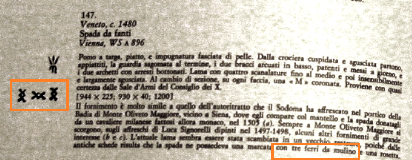

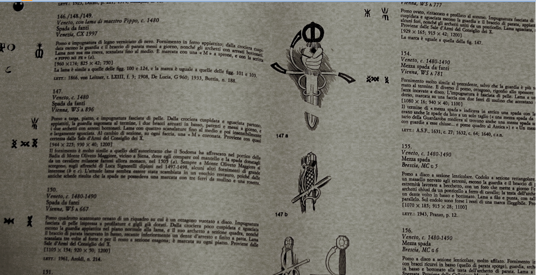

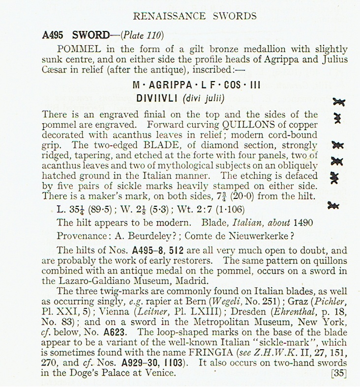

"Armi Bianchi Italiene" by Boccia & Coelho (1975) has a great appendix which includes many of these marks in configurations, which will illustrate the kinds of variation.
Actually I have seen numbers of blades with singular marks like this, but they have never been deemed aligned with a particular maker.

Apparently you guys skipped over a "detail" in that Ray is already aware that these (Veneto) marks exist, although in numbers of more than one; what he is asking is whether we are familiar with them only showing in one single presence; reason why i didn't post images of the 'multi' ones in the first place. Also we haven't yet had a picture of the whole sword, to then enable us to weave considerations on it.
But let me then play the accomplice and upload a couple pages of Armi Bianchi Italiane, where these "ferri di molino" (as they call them) appear. Pity this great work authors do not define the purpose of these marks.

Thanks for the Boccia & Coelho pages Fernando. I agree in most cases it is beneficial to have images of the whole sword, but for me I am OK with this image for now. I guess the reason is that this singular usage may indicate a 'trade blade' character rather than a completed sword matter.
To clarify what I meant by that designation is that it seems the singular use of this stamped mark on a blade seems to indicate Italian manufacture, but obviously that cannot be stated for certain. It simply has not seemed to me that these 'twig' marks turn up on German or other blades, and particularly not in singular case.
I think that these type marks are more of a mundane administrative device than the more distinctive makers or guild marks, which were often a matter of record as they involved compliances and ordinances. For example, these may indicate batches of swords involved in a specified contract or order.
I have seen these single marks of the twig type on blades, on schiavona and another even on a kaskara (backsword blade most unusual on these). It would seem of course that the 'blade' was independent of the sword assembly in origin in these cases, obviously with the kaskara

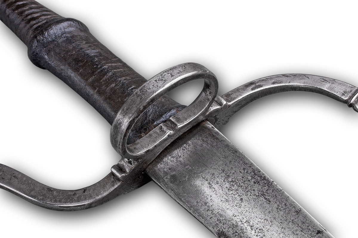

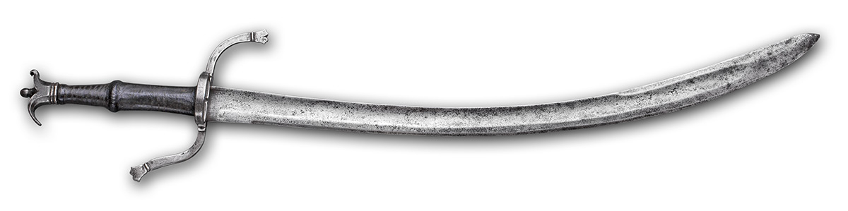

Thanks a lot guys, that was really helpful and is interesting.
Fernando is right, i was or am aware of that or similiar marks but i have seen them only in triples yet like in the pics of Fernando and corrado, not just one single mark. What i was wondering is if the single mark is the same maker/source as the triple marks or maybe something different that was copied or was similiar by accident.
And here is a pic of the sword in total.

Splendid !
Sorry my ignorance; isn't this a Storta ?
I am not qualified to judge on this sword's properties but, i would dare to sustain that, its 'lonely' ferro di molino mark looks very real. But what do i know ? . Only that i could swear that a mark/s with the same shape, depth and all, resides somewhere in our forum.
Old 18th September 2019, 11:44 AM   #11
BladeMan
Join Date: Sep 2019
Posts: 6
Thanks fernando!
And yes, that is a (two handed) Storta.
Length is 92 cm with a 70 cm blade, PoB is 13 cm and the weight is 1011 grams.
BladeMan is offline   Reply With Quote

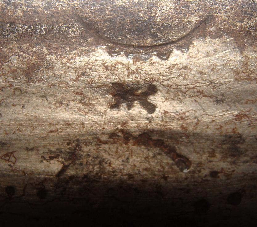

I also agree on the mark. It's on several Italian blades in my collection, and appears singly as well as in groups.

Thank you Ray for sharing this amazing storta (well called Fernando!).
The interesting raised rib in the grip reminds me of zweihander swords of the period, and it is tempting to wonder if this may have been en suite.
We know that rapiers often came in sets in this manner with alternate hand daggers (typically termed left hand daggers ).
As far as the singular use of the well known form seen here, as Fernando has noted, surely we have seen this instance before, in fact many times, but finding it will take some of the sleuths here. I know it is possible as I am always amazed at how some of the guys here find stuff posted some time before, Rick and Fernando himself are the two that come to mind in pulling up these exemplars.
Ray, actually that is a well placed observation, that perhaps the mark (though with some commonality it seems in the makers community) might have the same origin as some of the multiple groupings. Again, as we know these marks were not to a specific maker, possibly their use in number or varied configurations might have been peculiar to a certain one.

@fernando, Yes it is in my collection.

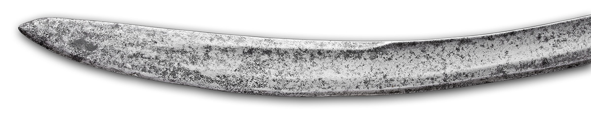

The blade actually widens up towards the tip just a little at the last quarter, right where the blade becomes double edged.
But yes, it's overall narrower and deeper curved then the majority.
Frankly, those "anomalies" is what makes the most attraction for me.

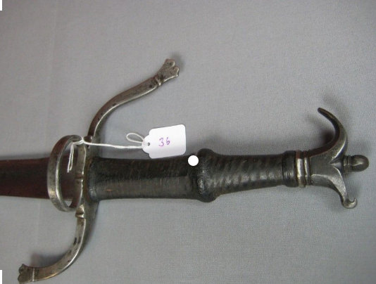

Beautiful sword! Curious that it has a relatively short blade, but a two-handed hilt. Although many Lange Messers had a long hilt, which is utilized in fighting with that particular weapon. Perhaps there is an overlapping of traditions between Germanic lands and northern Italy.

Yes interesting with two-handed hilt. May we have measurements, please?

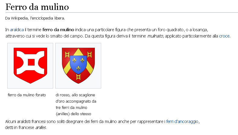

Actually in seeking more on Andrea Ferara for the discussion Philip has suggested, and searching through notes, passim, I found some interesting reference to the Italian mark of the OP here.
It is apparently termed MARCA A MOSCA and colloquially 'the twig'.
According to a discussion post from 2010 (Javier Ramos, SFI, 5/24/10) this markings was apparently an arsenal mark from Venice.

I noticed this storta some time on a German website , I believe it was offered by Historica Arma and/or Fricker, did you acguire it recently ?
best,

Posts: 10,857
The ink spot has proven invaluable in networking to other discussions and threads concerning these Italian marks, which as shown may be referred to as 'twigs' or 'marca a mosca'.
My reason for bringing up the suggestion of the single mark being a possible arsenal mark for Venice is that it was an interesting possibility which seemed worthy of mention in a discussion with notable scope in examining these.
As I noted in my previous post, the aspects of this suggestion in which I might dispute the 'arsenal' possibility would be that these turn up on rapier blades, distinctly a civilian weapon of these times.
Also, I would wonder, which arsenal, that of the Doge of Venice? or perhaps the Papal arsenal ? or were there more?
I also realize that I have suggested that these 'twig' (for the sake of discussion) marks were exclusively Italian, which is incorrect, as in my thread of June 2010 I noted the fly marks (aka twigs) were indeed duplicated in Germany. Clearly the German makers applied the known Italian marks spuriously in the same fashion as those of Spain.
Clearly there will be multiple colloquial terms used for these and similar marks in various regions and transliterations. It is of course one of the frustrating perils of the study of arms over many centuries and in many cultures with many languages. I think Philip well described this situation with regard to Italian circumstances as case in point.
There is also the circumstance of assigning certain marks to certain areas in addition to attempting to align them to a particular maker, which has its own futility. In Italy, the Veneto regions encompassed not only Venice, the capital and port, but Caino, Brescia, Belluno, Ferrara and others even Milan.
In the regions of Genoa, which included Lucca and others, it seems the so called sickle marks became the known device inexorably linked to Genoa, yet some authorities believe its use began in Lucca. In those western regions of North Italy the 'sickle' device also became used in multiple and oddly configured arrangements on blades. It has often been suggested that the Genoan association was due to that being the departure port for the blades of these regions.
With these instances, it would seem that these distinctive central devices may have become collectively associated with regions as described. It is notable that in many instances of works on weapons, a mark of these types is often associated with the region to which the sword it occurs upon is attributed. Thus a sword mounted in Brescia, but with a blade from other locations in Veneto, becomes Brescian.
As an interesting anomaly, having distinguished the marca a mosca (twig) to Veneto regions, and the 'Genoan' sickle marks to the centers there, a blade curiously found on a straight blade tulwar has the sickle marks with the twig in the center. Now theres a conundrum!!
