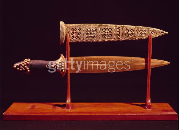

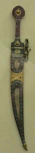

On the other side, in Iran one sees quite a lot of quaddaras with kindjal-like hilts, see for example the first picture below - quadara of Nader-Shah.

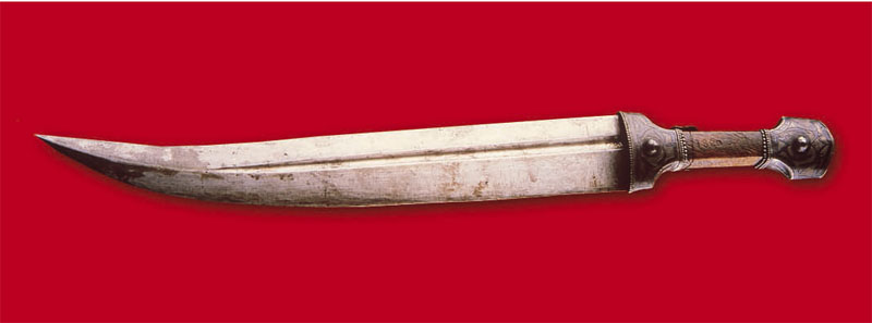

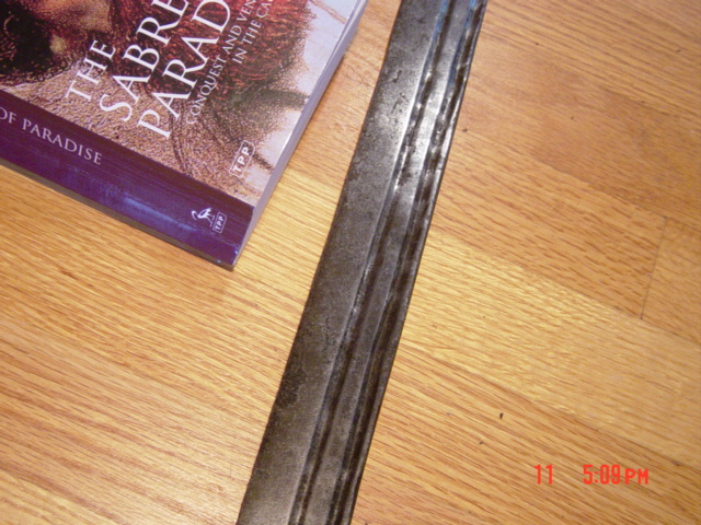

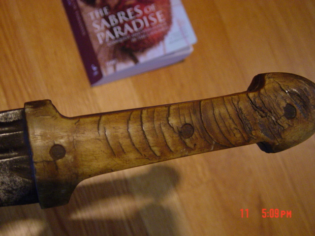

But now we come to the most interesting part - Caucusus. Besides small knives, I have seen only two types of quadaras coming from Caucasus. First type (2nd picture and http://www.oriental-arms.com/photos.php?id=514 ) - essentially straight caucasian single fuller kindjal with three modifications - first the fuller is even more off-centered than usual. Second the tip rapidly bends to one side. Third, one of the edges is oftenly blunt. The caucasian provenance of them, in my opinion, is well established - just to take these two the first one (russian Tula's arms museum) has a typical caucasian niello hilt, second one has a typical caucasian goldwork on the scabbard.
quadara-kindjals of this type do not have touchmarks.
