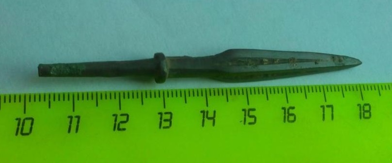

Colleagues,
Sometimes archaeologists and amateur metal detectorists find bronze arrowheads dating from the Middle Ages (at least, such finds occur in the western part of Russia). It is obvious that at that time bronze arrowheads hardly had a combat purpose. I heard that some specialists make assumptions about their ritual purpose. What are your thoughts on this? |
