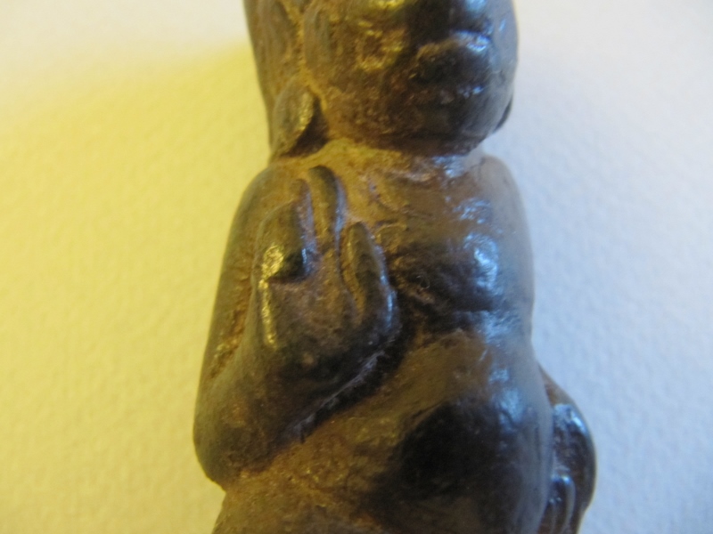

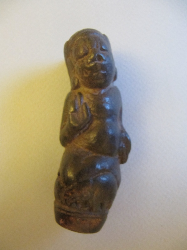

Bronze keris hilt, perhaps Javanese? 8 cm. Does it depict a priest or deity?
The right hand pointing upwards, resembling the Buddhistic 'Gesture of Protection' (abhaya). The left hand pointing downwards in a similar gesture; an elephant depicted at the base, on the front.
Any information from some of the many experts on the Forum would be welcome.

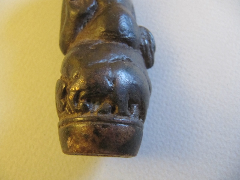

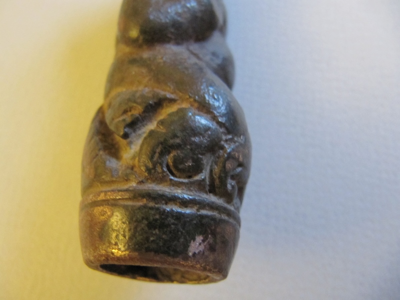

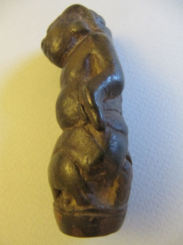

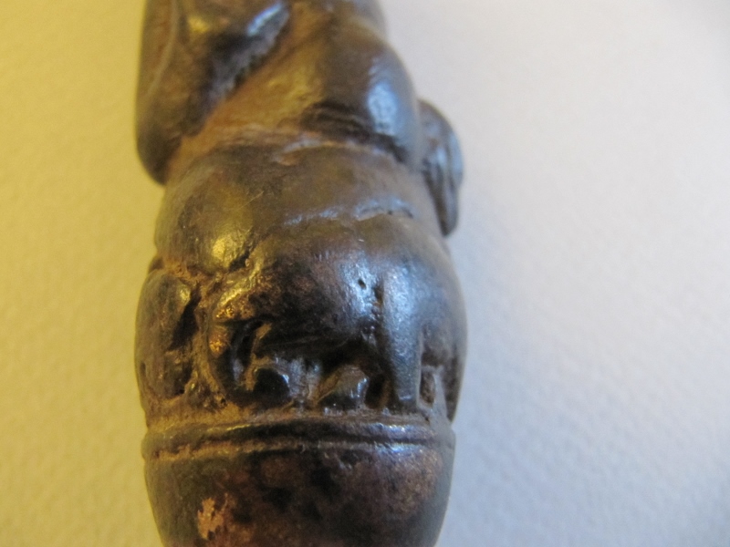

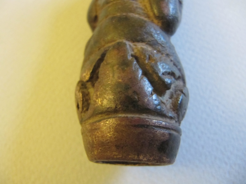

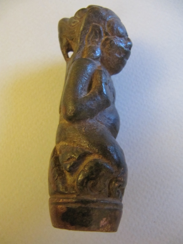

Tim asked me to extend thanks to all who responded!
He seems to have problems with logging in and I hope he'll be back soon.
I'm adding a few more pics he send me for posting; Tim will try to take some more.

I'm getting the impression from the images that Kai has posted that there is a Tumpal Throne involved here.
Old 9th June 2019, 08:54 AM   #12
Post
Yes, Rick, some of the tumpal motifs have been preserved in this design.
There also seems to be a garuda mungkur at the back of the head.
I'm fairly sure there are fangs - we need sharper pics for verification though.

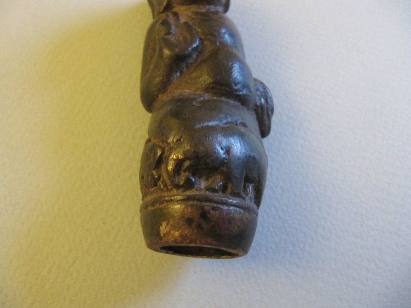

There seem to be 2 elephants depicted at the front.
The hilt sure does seem to have some age despite metal castings being notoriously difficult to appraise. However, I don't see any of the common motifs/details of very early carved hilts and suspect this piece is later work.
Tim, any resin (or wood) inside the hilt?

I notice that the pesi hole is very wide, any missing materials inside?

It seems the question of the mudra was never resolved.
From the photos - and perhaps on item-in-hand as well - it's difficult to see the exact positioning of the fingers.
As fas as I can tell, the middle and ring fingers are extended.
The thumb is visible, though I can't see what the index finger is doing.
And the pinkie seems a little strange to me. It gives the appearance of being bent (due to the thickening of the material), but going by length that doesn't make sense.
Of course it could be that the casting was imperfect. Perhaps only 4 fingers were cast. Perhaps the design of the mudra was not carefully considered by the maker.
