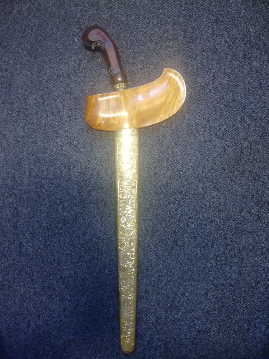

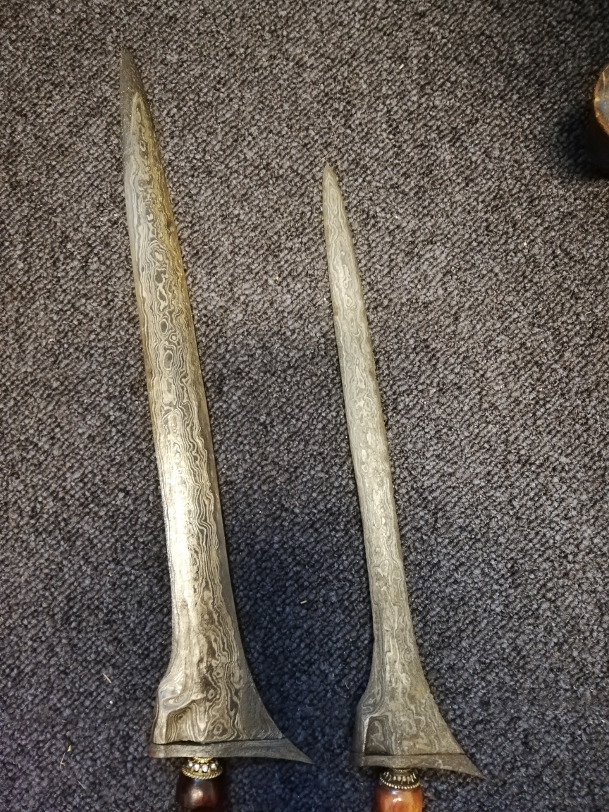

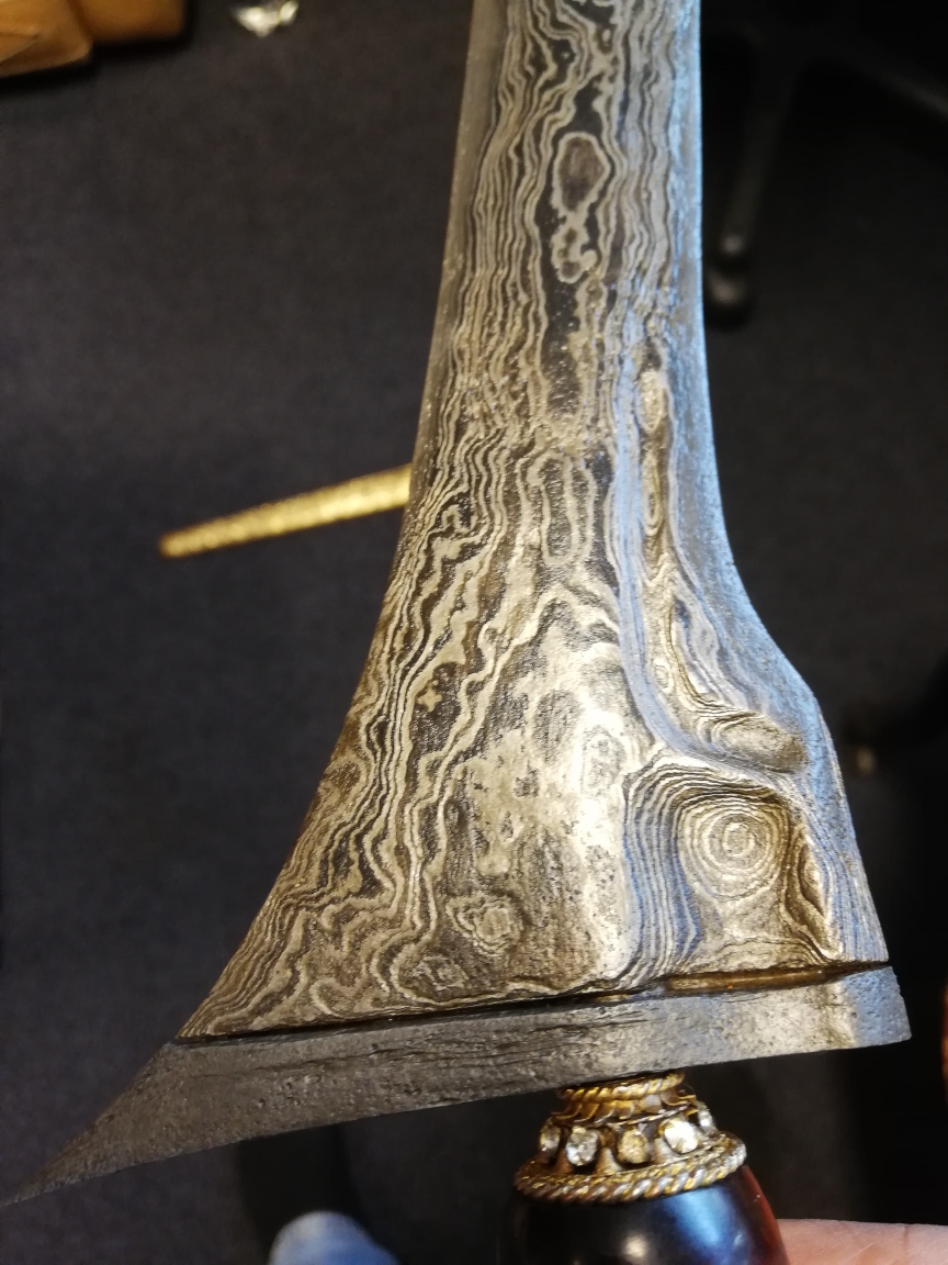

I've got a really oversized keris that should be from Solo.
I don't know if this keris is realy solo or more north coast, i've put a normal Solo keris next to it to see as comparison.
The dress looks very Solo to me.
please comment

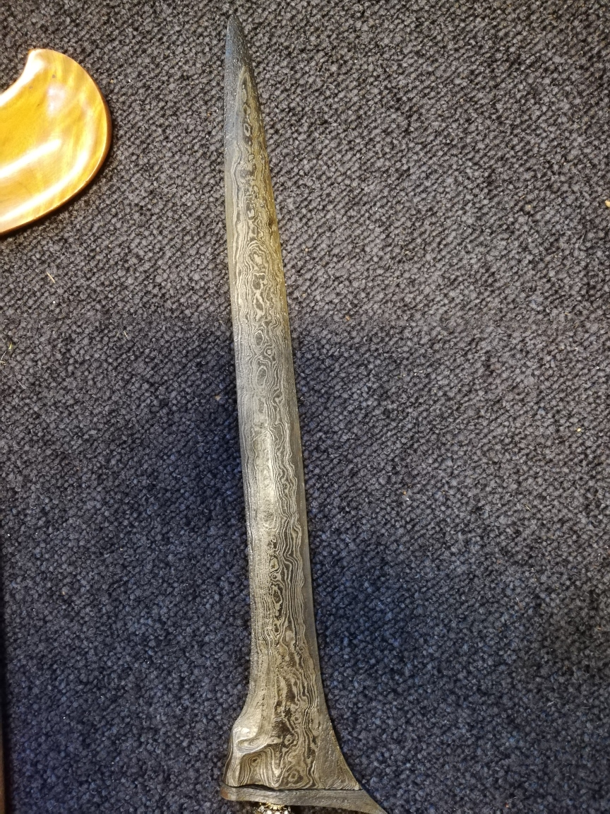

The scabbard & hilt are in Solo style indeed, but the blade with ganja wulung rather looks in Tuban or North Coast style, it seems to have age but other opinions are welcome.
Old 4th June 2019, 10:41 PM   #3
Posts: 7,229
I tend to agree with you Jean.
There were some mighty big blades that came out of the North Coast, and also from the far East of Jawa.
However, I'd very much like to see a photo looking straight down onto the top of the gonjo before I'd be prepared to name a tentative classification.
Dress is certainly Solo.
Incidentally, the normal size keris, although it may have an indicator that could be regarded as Solo is also extremely unlikely to be classifiable as Solo.

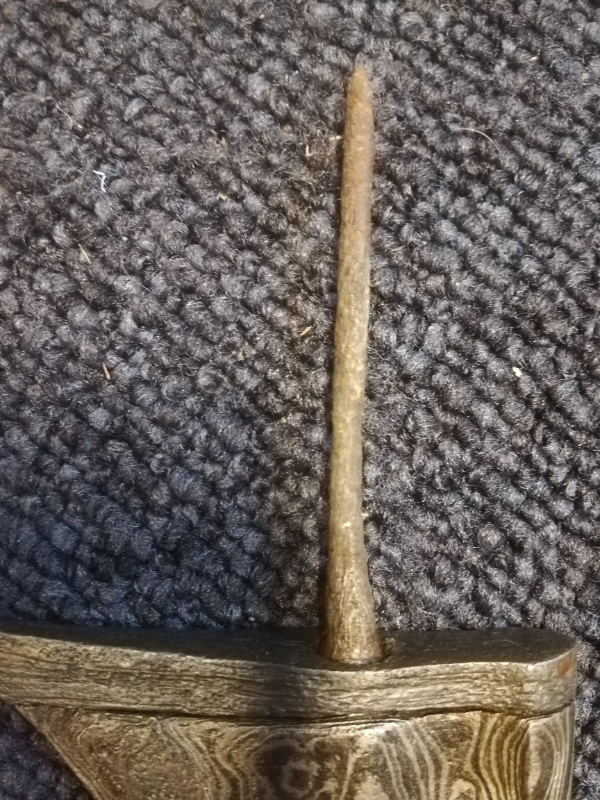

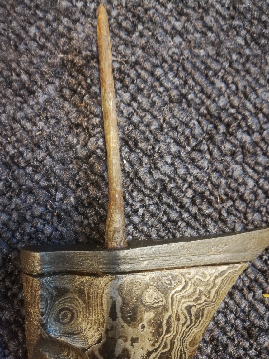

Here some peksi pics
David Gallas is offline   Reply With Quote
Old 5th June 2019, 02:05 PM   #5
Posts: 7,229
Pesi David.
In Javanese "peksi" means "bird".

sory about the pesi and the pics, another try....

I am not able to classify this blade from a photo. The gonjo is not acceptable as Tuban, it has West Jawa elements, and elements seen in extreme East Coast Jawa gonjos. The same is true of the wilah itself.
Javanese, yes, more likely than not, but from a photo I can go no further.

Thank you for your replay Mr Maisey. The east Javanese option could be very plausible. Because the last owner from Indonesia was Madurese from east Java. The keris was discussed here by some specialists and they classified it as PB 9 Solo, what i doubted...
Old 6th June 2019, 06:58 AM   #10
Posts: 7,229
David, I cannot confidently give a classification (tangguh) for this big blade from a photo, but I can very confidently say what it is not, and it is most definitely not a Surakarta blade. Not one single tell relates to Surakarta.

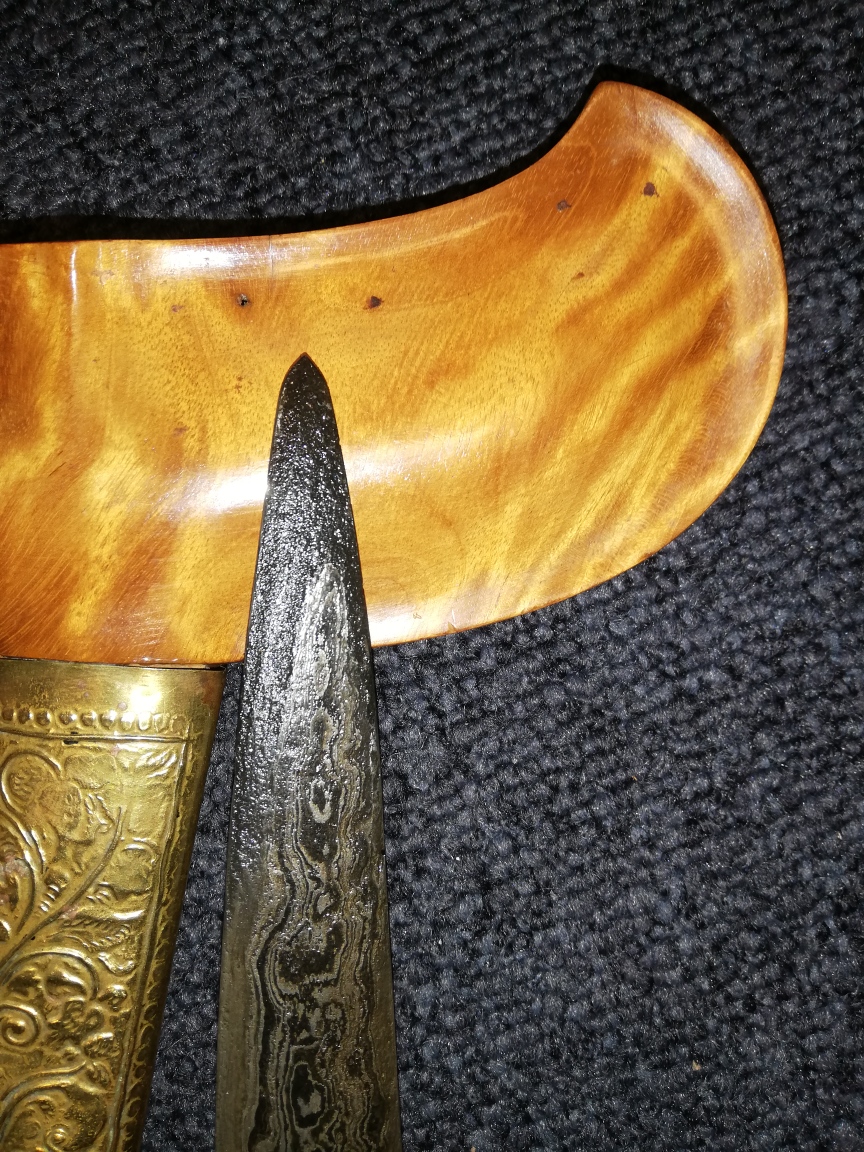

Alan - what about this gonjo makes it unacceptable to be classified as Tuban?
From having seen the photo and before having read further, Tuban was my guess. My reasoning was the rounded sirah cicak and the buntut urang tapering to a point.
jagabuwana is offline   Reply With Quote
Old 16th June 2019, 07:28 AM   #15
Posts: 7,229
If this gonjo had what we call nguceng mati form, with the tail coming back to a distinct point, I would be prepared to accept the slightly pointed sirah cecak as Tuban, its not really rounded enough for Tuban, but it would pass with a push. However, that gonjo tail has a slight curve and the end is more or less squared off. This is not acceptable for Tuban.
There's another thing too, I cannot really see the blade cross section, I'm not sure if it is ovoid enough for Tuban, in a couple of pics it looks like it could be slightly raised down the mid-line of the wilah, not really an ada-ada, but not rounded either.

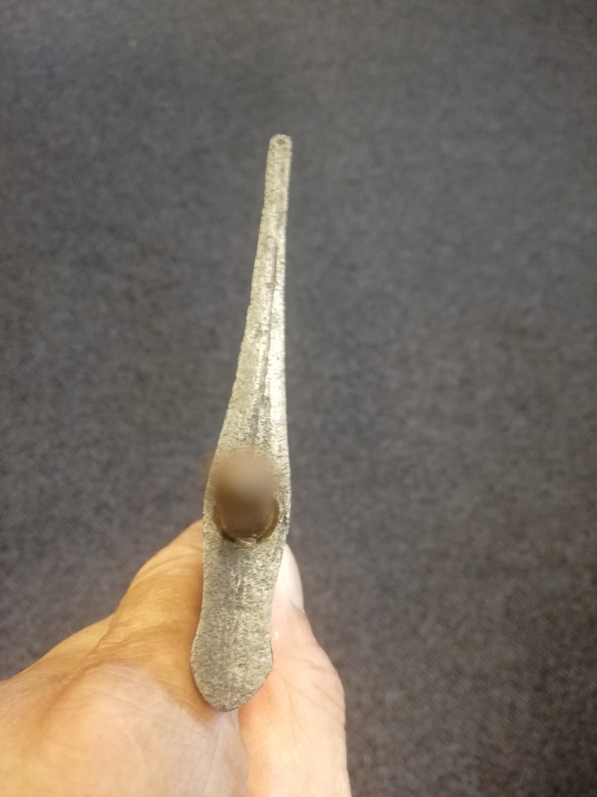

I wonder whether this gonjo wulung is original, look at the mating with the blade and the neat & oversized hole around the pesi with a rustic wedge?
Old 16th June 2019, 09:50 AM   #17
Posts: 7,229
The gonjo might not be original, but this is an old blade, and gonjos on old blades are often not original, the gonjo itself is old, the erosion seems to be more or less similar to the wilah erosion, the wedge is quite OK, the hole in the pesi could be a whisker smaller, but if the gonjo was removed during maintenance, something that is not at all unusual with older blades, natural erosion would account for the larger than necessary hole.
I can see nothing in this keris to cause me to question it, I'd accept as is, even if the gonjo was not the gonjo put onto it on day one --- and there is no way of knowing that with any certainty in the case of this keris.
