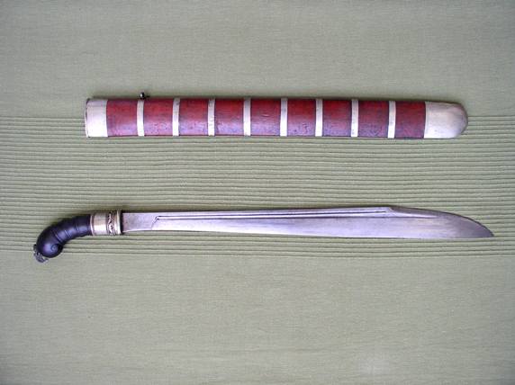

Anyone specifically knows what this type of sword is called?

Sure, i'd call it BEAUTIFUL!
.....though it could be a "sundang"....

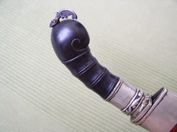

Hmm...I've handled this piece... A beautiful blade. Congratulation! The hilt, typical of a parang nabur but with a shorthened crossguard on both sides. See link for examples of the hilt crossguard...
http://www.eriksedge.com/INDO126.html
http://cgi.ebay.com/ws/eBayISAPI.dll...y=20085&fkxs=1
http://old.blades.free.fr/swords/parang/par04.htm
I doubt that it's a hulu "iku mie", Acehese 'Amanmeru' or a Batak form as well.
The blade however looks like a mandau blade.
Just my 2 cents opinion.

Thanks for the pictures Shahrial. Yep, I see that the hit form is indeed the same as the parang nabur, but the blade form is definitely not.
I think the blade was forged locally, and not of indo-persian origins. Though the overall profile is like that of a mandau, it lacks the very slight arc we often see in mandaus, and also, I believe mandaus are bevelled on one side of the blade only. This piece is bevelled on both sides, thus allowing for ambidextrous use. Also, the tips of mandaus often have some 'extra' features adorning it, not 'clean' like this blade.

Hi this is an Parang Nabur it is an malay sword that also was in use by the seadajaks.
the guard is missing you can see that they cut it off.
This form is not often but as you can see the straigt one that is in the book off Zonneveld and in my collection

Hey Shahrial, don't worry about it. Our 2 cents do not devalue; they contribute to better understanding.
I agree with the opinion that this piece is a parang nabur with an unusual blade form. I read in Zonneveld's book that not all parang nabur has the D-guard, but in this case, the D-guard and quillon was probably sawed off at some point in time. However, I thought it sort of improved the 'aesthetics' of the blade when it is unsheathed -- the hilt flowed more smoothly into the blade. I do recognize that it does look a bit funny in its sheath, with the wood on the scabbard mouth showing.
The straight blades in Zonneveld's book, and that in Dajak's collection actually has a bit of convexity to the cutting edge. This example of mine is completely straight. Could it be case of this blade being 'salvaged' from another sword-type? Does anyone recognize this blade form in other types of Kalimantan or Malay swords?

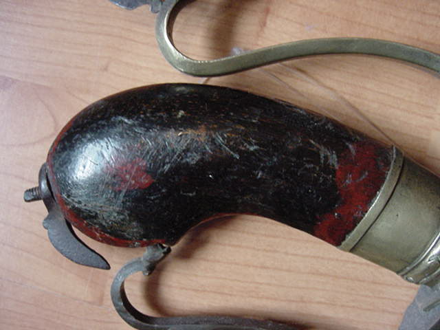

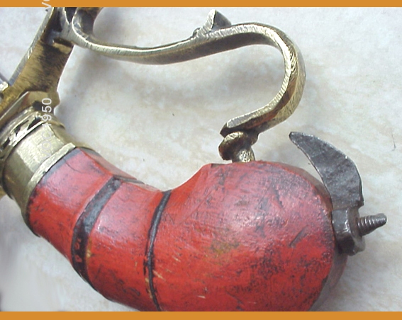

I was informed of a closed ebay auction (by a fellow forumnite - Derreck) for a parang nabur. Hope Derreck does not mind me attaching the picture for discussion purpose.
I noticed that the D-guard in the picture is attached to a white brass nail that seemed to be hammered into the pommel. My parang nabur's hilt had no traces of such a nail insertion. Is it that not all D-guards for parang nabur ends up being nailed to the pommel?

NO not al see pic there are much types but to me it looks like the handle is not the original it maybe a replace handle

Hmmm...maybe that explained why there's no hole for the horn hilt's D-shaped guard. Probably the guard had been cut before the hilt replacement. Hence, no reason to put a hole there...(just speculating)

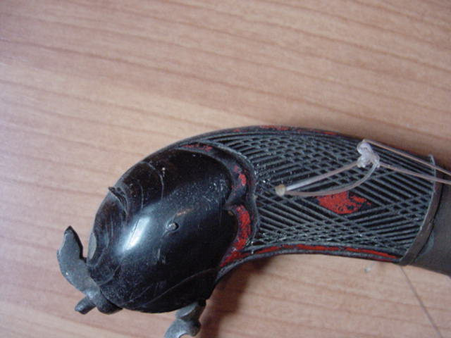

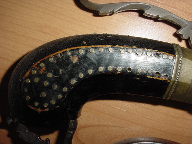

wooden handle easy to replace the metal part not because it is normally one piece diffucult to get it together
the wooden handle as I can see from the pic no sign off use
As you can see when it is in the scabbard there is a piece missing cutting off is the easy way
Look at these handle s all have sign off use

I think the D guard was probably connected with the nail at the end of the hilt. Btw, is it a nail? I think the "nail" is actually the end of the blade tang that is screwed to make sure the hilt dont slip off. If the hilt ist new, maybe the last owner only made a hilt for it and suit the old brass part for it. Probably..
