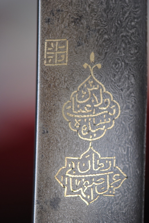

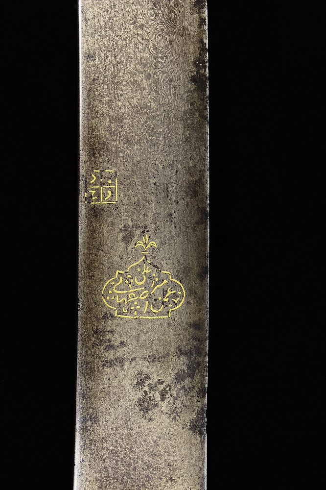

In two recent threads, one on Shamshir markings and the other on Arab spears, certain elements of markings found on them were interesting as they suggested talismanic properties which would be an interesting topic for discussion. In the spears case, there was a lozenge design which seems to have been widely used in such manner, and served as an apotropaic against the evil eye.
On the shamshir, the usual dual cartouches, the upper an ogival spheroid typically with ruler of the time or other information or other exhortations , while the lower typically had the makers name and date....are seen.
However to the left and above is a square with abjad letters in a grid, and known as a 'Beduh' square. These talismanic devices are often regarded as 'magic squares' and represent various number combinations which invoke the appropriate properties required.
I would like to look into these 'Beduh' squares further here, and determine more on how they are typically intended on sword blades; how widely were they used (if outside the Arab world and Mughal India) and examples of blades bearing them.
I would also like to learn more on the lozenge device and its significance in motif and designs on weapons in the Arab world.
Attached is the blade of the shamshir posted by William Fox with the typical cartouche configuration and the 'Beduh' square upper left. I am curious about the grid of only four squares, it seems most have nine.

The inscriptions read as follows:
Upper cartouche: Abbas, Servant of the Ruler of the Nation
This is a very typical formula and is found on the preponderance of such blades.
Lower cartouche: Work of Zaman Isfahani
A known, but not common, maker. Zaman of Isfahan is often referred to as the "son of Assad Allah" but that, like most of the lore, should be taken as praise, rather than representing a literal relationship.
The lateral inscription: Victory from Allah and conquest nigh!
This is a popular Islamic phrase often found on weapons.
An above average blade, congratulations to its owner.

Oliver thank you so much for giving us this translation from the shamshir blade I posted, which is presently being discussed as well on the concurrent thread 'shamshir translation'. It is interesting to see the Buduh square along with these cartouches.

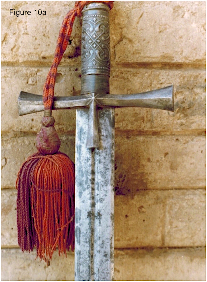

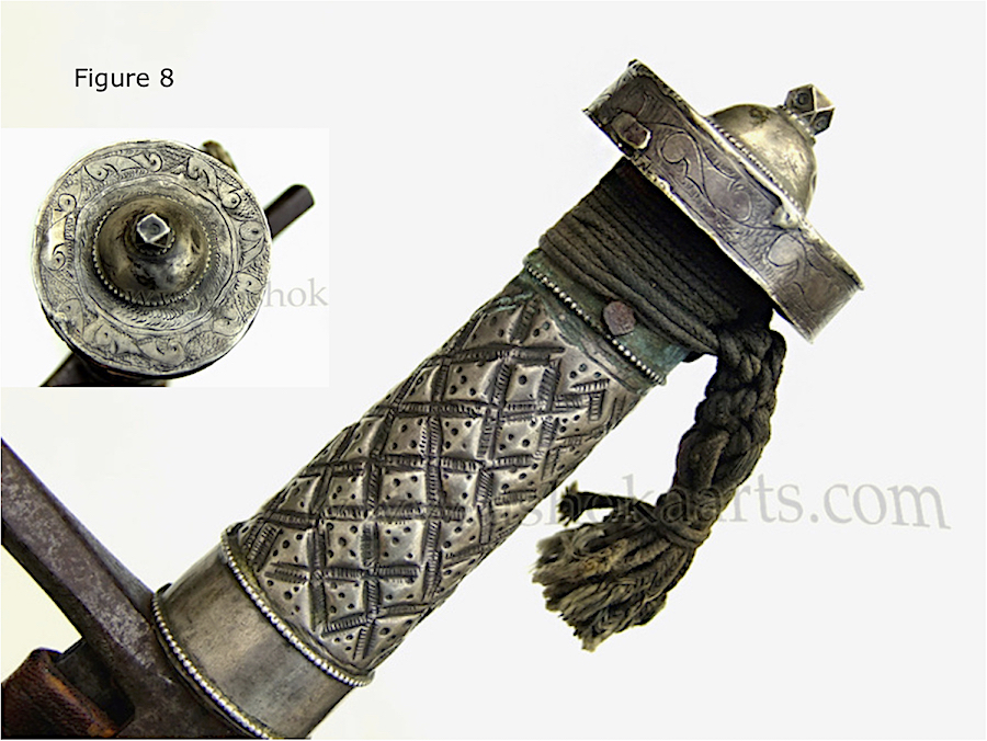

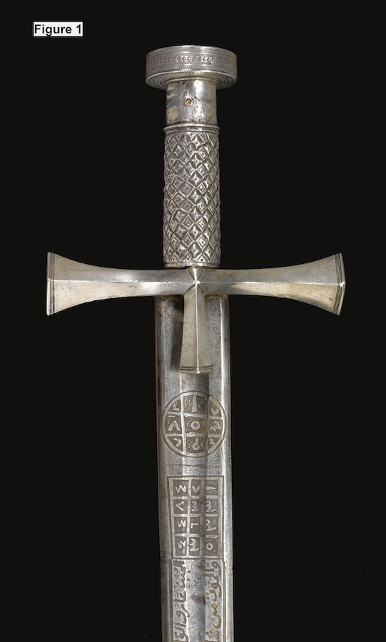

The Sotheby's image of an Ali Dinar sword (c.1916) from shows magic squares on the blade.
(Help. I cannot attach images (Figs. 10a, 8 & 1) from the Kaskara Silver Dress essay) to this reply. The Manage Attachments button does not open.)
Ed
ESSAY HERE

Old 27th January 2019, 12:05 PM   #15
Originally Posted by Edster
--- (Help. I cannot attach images (Figs. 10a, 8 & 1) from the Kaskara Silver Dress essay) to this reply. The Manage Attachments button does not open.)---
This should not happen; why don't you try again later, Ed ?

Old 27th January 2019, 02:01 PM   #17
Fernando,
It still doesn't work, even on this post. Would you be so kind as to extract those three images from my essay and insert them in the post? ...
Done !

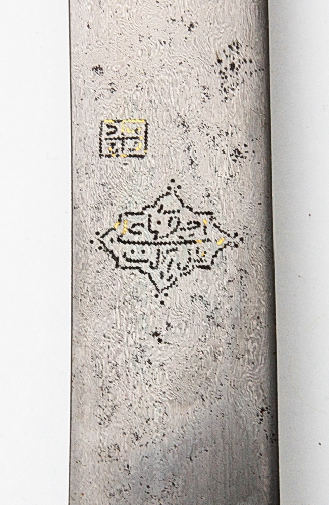

Old 27th January 2019, 04:12 PM   #20
Jens Nordlunde
Jens Nordlunde's Avatar
Location: Europe
Posts: 2,718

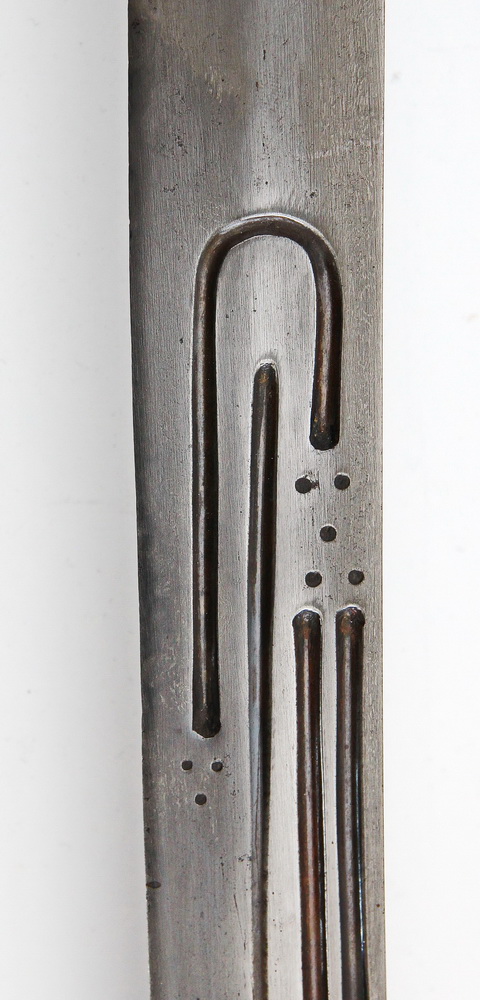

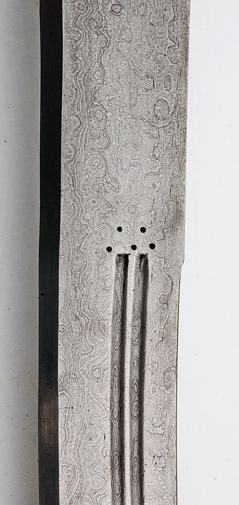

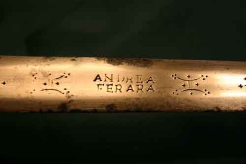

Here are two more Buduhs.
Old 28th January 2019, 12:20 PM   #21
Ibrahiim al Balooshi
Ibrahiim al Balooshi's Avatar
Join Date: Jul 2006
Posts: 4,408
Ibrahiim,
Thanks for posting these two great links. The Graham article may have unlocked the mystery of the silver grip govers in my Kaskara Silver Dress essay!! The Star & Comet motif may be explained in the Dotted Cross and Stars within the Seven Seals. Likewise, the Squares could be an interpretation of the Dotted Cross as well. This may be a stretch, but so far it's the best explanation available. I'll revise the essay to include this speculation.
William,
Ed
ESSAY HERE
Hello William.. Indeed interesting as the 4 and 5 dotted cross are applied to the hilt. the budu square is excellent and clearly placed. I note the square is placed above and left of the main cartouche and this seems standard. It is interesting that the letters are related to a numerical progression which I think was first indicated after magic squares were transmitted to the Arabs from the Chinese and then relayed in the other direction back to China later.
Old 28th January 2019, 12:40 PM   #22
Join Date: Jul 2006
Posts: 4,408

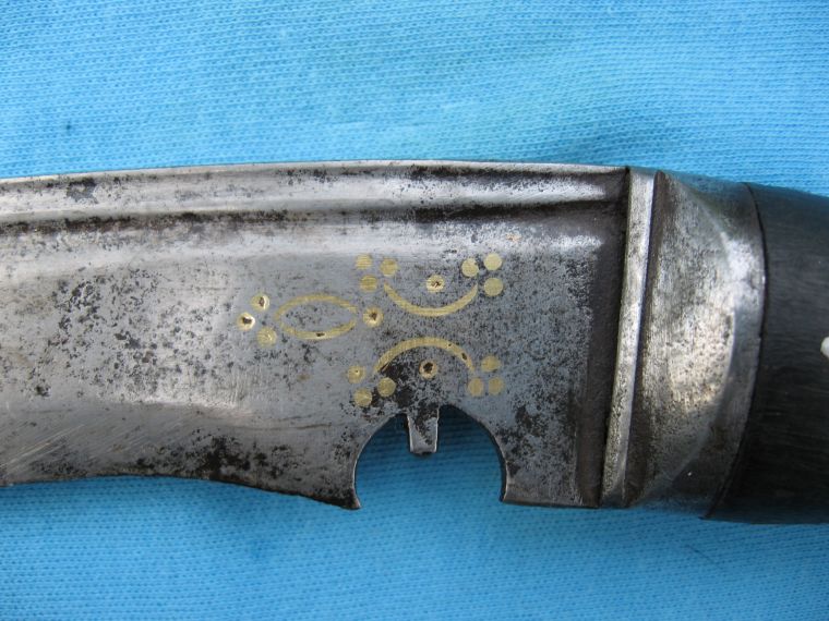

On the lower sword I note the inclusion of the three dots on the 4 points of the cartouche .
Three dots appear on all manner of blades and including Nepalese and Persian as well as Indian. These marks appear to indicate the Trimurti form yet evidence also points toward something else; Tamerlane.
On Islamic blades the geometry seems to be one of protection against evil spirits and in other regions the dots placed not only on blades but on hilts presumably blocking evil from entering the blade from either direction.
Tradition indicates that on a set of Islamic prayer beads there are often three beads included at the end of the string to stop the devil climbing up!
Below; Islamic beads plus 3 to ward off evil spirits and the Tamerlane three dots...

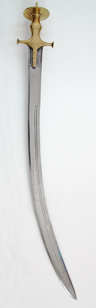

Reference A;
http://www.vikingsword.com/vb/showth...ghlight=TULVAR
In support ...a sort of world order of three dot insignia I searched for three dots on a blade and extracted this from http://greatdreams.com/three/three.htm ~
Quote."This symbol a triad or trinity. It is a symbol of the unity of body, mind and spirit. The symbol is of universal significance - it is found throughout history and all over the world. It was popularized early in this century by the Russian-born artist, philosopher and scientist Nicholas Roerich. (http://www.roerich.org). It can be interpreted in many different senses: spirit/mind/body in a circle of synthesis; past/present/future enclosed in the ring of eternity; art/science/religion bound in a circle of culture
The oldest of Indian symbols, Chintamani, the sign of happiness, is composed of this symbol and it can be found in the Temple of Heaven in Beijing. It appears in the Three Treasures of Tibet; on the breast of the Christ in Memling’s famous painting; on the Madonna of Strasbourg; on the shields of the Crusaders and coat of arms of the Templars. It can be seen on the blades of the famous Caucasian swords called "Gurda" and on the swords of Japanese nobility.
It appears as a symbol in several philosophical systems. It can be discovered on the images of Gessar Khan and Rigden Djapo; on the "Tamga" of Timurlane and on the coat of arms of the Popes. It can be seen in the works of ancient Spanish painters and of Titian, and on the ancient ikon of St. Nicholas in Bari and that of St. Sergius and the Holy Trinity. It appears on the coat of arms of the city of Samarkand, on Ethiopian and Coptic antiquities, on the rocks of Mongolia, on Tibetan rings, on Buddhist banners, on the breast ornaments of all the Himalayan countries, and on the pottery of the Neolithic age.
The symbol of the triad or trinity has existed over immeasurable time and throughout the world. It can be understood as a key to the integrity and interdependence of all existence.." Unquote.

This is an excellent grouping of the scope of the use of the three dot symbolism in various cultures and contexts, which of course though not necessarily universally the same religiously or symbolically in detail, the three is key.

The great danger here is that members may consider the three dots as explained whereas these are only suggested since the variety of possibilities is vast>>>and covering an enormous timescale as well as all the main religions the world! many of these possibilities are unrelated while some are probably loosely connected and even connected to mysterious cult followings like Free Masons etc. What seems clear is the Talisman effect in protecting the blades although instances where other artifacts seem designed with # dots such as in ceramic wares from Iznic Turkish wares.
Below a few examples on blades and the chart of three dots and including the sawback or eyelash feature seen in many regions. The 3 dot form may also be a simple ruse to raise the price in indicating a high quality blade in the same way as placing important features on a blade such as ANDREA FERRERA or The name of a famous maker...or a Wolf or other inscription on a blade> Naturally the holy script of religion can be added as Talisman on blade hilt or accoutrements as in Mahdi shirts, allam battle banners and flags and unusual weaponry such as Mace.

The sword shown below was owned by Shri Jodh Bahadur/Rao Jodh II of Salumbar/Udaipur/Mewar, and is dated VS 1927 - AD 1870-71. Born AD 1833 and ruled from 1863 to 1901(?).
The three dots have been used almost as if they were closing the fullers as it is often seen.

You may be able to see that one, and only one of them at the end of the blade, is 'closed' with three dots as well.
It is interesting that the inscription under the disc, as well as the one at the back of the blade, gives the owners name and the place.
Rao Jodh II was the 24th ruler of Salumbar, and the history about how Salumbar was started is quite interesting - with a coconut and a misplaced joke.

Jim,
The five dots are share one of the dots, have a look here.
This blade is quite unusual, as one side is wootz and the other side is pattern welded with only two fullers along the blade.
