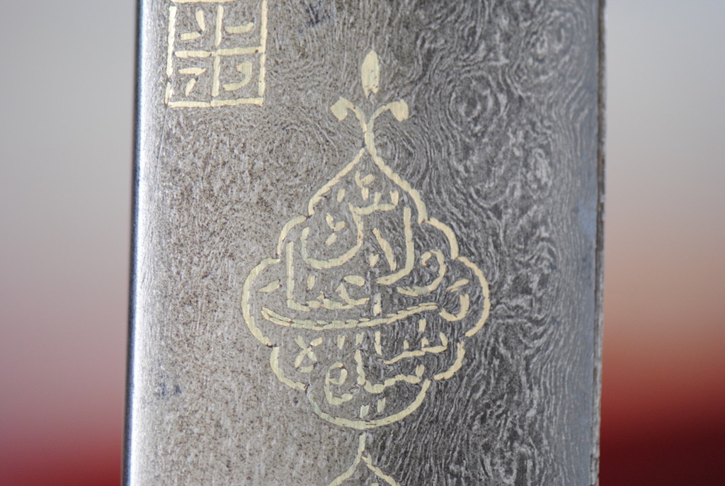

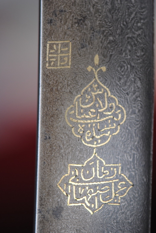

Dear Sirs,
Please see attached some close up photos I have taken of the calligraphy on a Persian sword that I own.
I was wondering if anyone can help with the translation of the various parts of this calligraphy.
Many thanks for any help.
Will

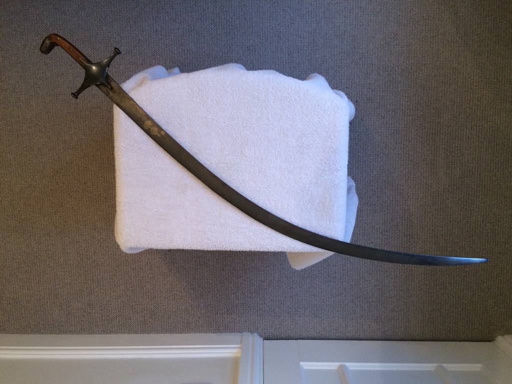

Hi William.

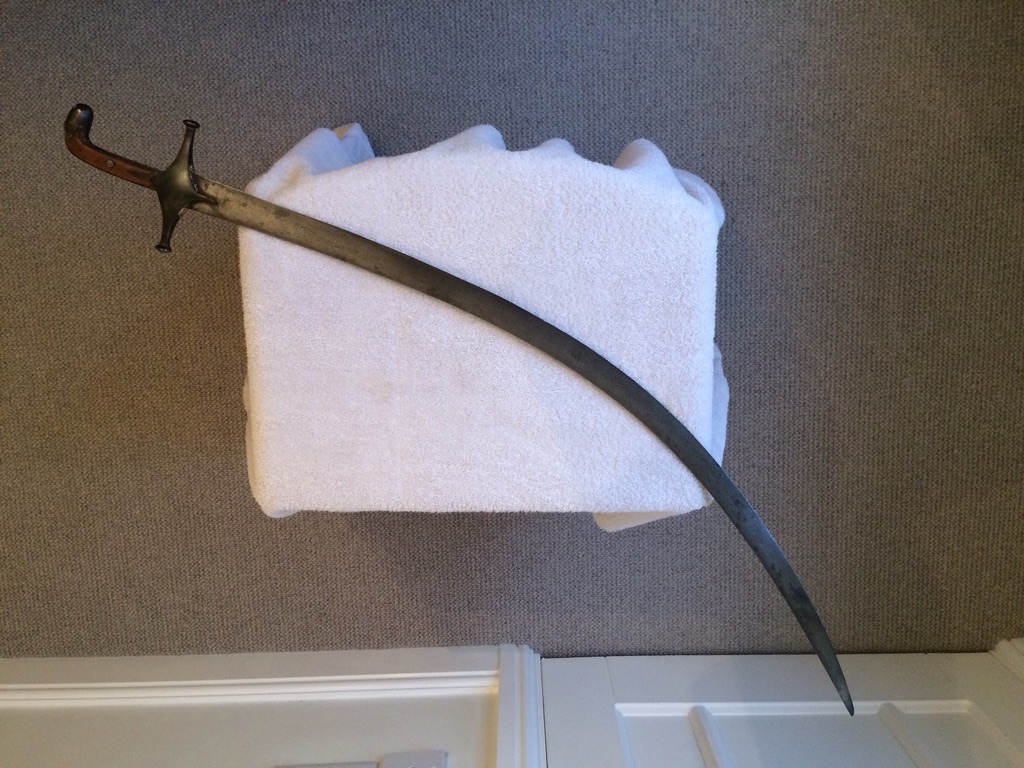

Per Forum Policy, we require a picture of the complete sword for identifying inscriptions. Please see the sticky at the top of the Forum page.

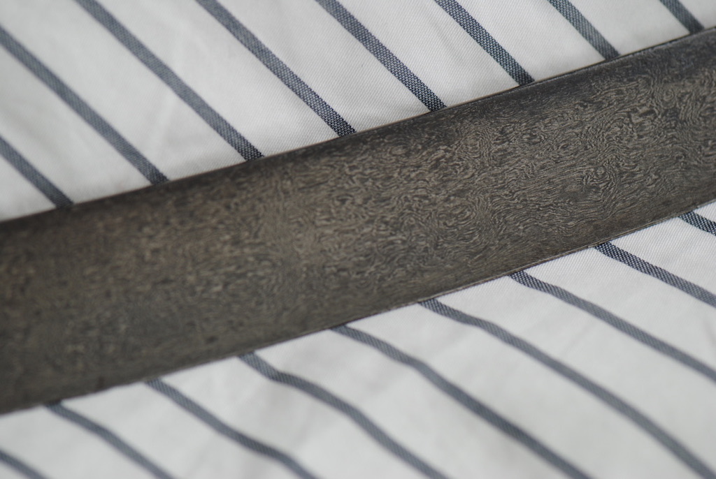

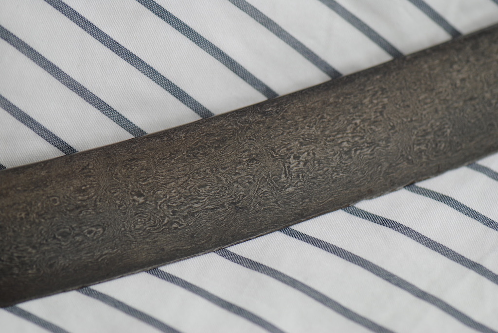

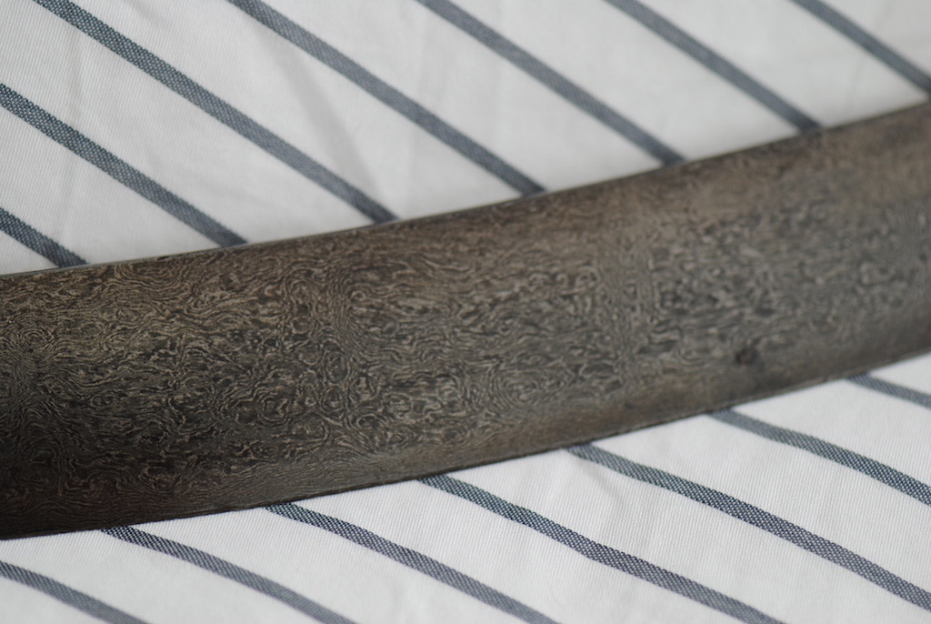

I have uploaded obverse and reverse of the sword, and also some close ups running along the blade.
The cross guard is also made of crucible steel, but there is the faint trace of a gilded pattern on it.

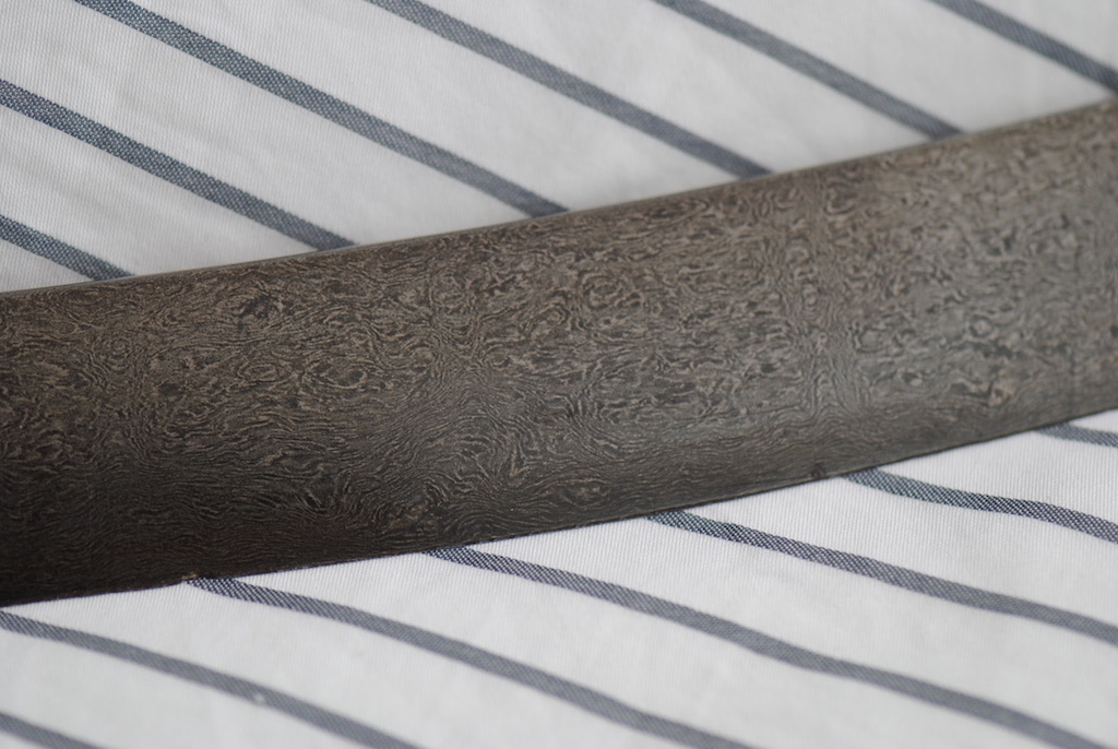

That is a Shamshiir and is expertly done in a dominant ladder pattern. I will have my interpreter have a look at the script although it is bound to be one of the standard famous artisan style inscriptions even though to me what is just as important is the magic square treatment ...Talismanic and great to see on this blade.
I suspect the hilt has shrunk away from its metal mounting but you might be lucky in repairing that with continued treatment and oiling...
I will get back to the translation in a day or two...

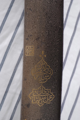

Some points on the Translation. As with many translation puzzles I always try to get a couple of translators to have a go at these cartouches and inlays... They are so interesting.
Firstly I have broken it down as the more difficult are in the cartouch but the lower one appears to give the makers name The Work of etc... I will try to have that done in due course...…Whereas there is Persian in the cartouche the long line of work below is from the Holy Koran and is in this case Arabic.

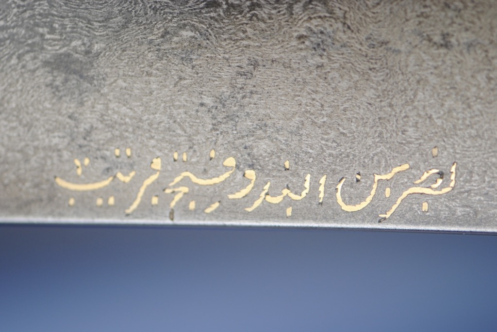

On the longer line of Arabic script I give an example phonetically as nasrun min allah wa fathun qareeb which means essentially ..With Gods help we will win this battle. I think that is a reasonable line of writing to have on a blade...

So the Arabic script running along the blade says: "With Gods help we will win this battle."

There is no Abu. It say Amal e Zamaan e Isfahani. the other seal says Banda e Shah e Welaayat , Abbas. please search my other posts in this regard, as I need to get back to studying, good looking sword by the way.

I thought I had seen this weapon before... at Reference C. however it is nice to see such an interesting blade again … The first time round I placed the detail below which hasn't changed much.. and again to echo the point that Jim has spoken about on the magic squares … and noted in Reference B.
A superb rendition on such weapons is at Reference A.
From the original sword thread on EAA two years ago~
Quote"With octagonal grips covered in black shagreen leather, steel pommel and guard of characteristic form. The blade Shamshir (lions tail), forged of wootz steel and inlaid at the forte, VICTORY FROM GOD AND CONQUEST NIGH, together with a baduh or magic square, and a polylobate cartouche containing the maker?s name, WORK OF ZAMAN ISFAHANI, a well-known smith said to have been a student of Assad Allah. Mid-18th century".Unquote.
There is further detail on another website by the world renowned Oliver Pinchot of Imperial Auctions and this Forum where the discussion as to true signatures including Zaman Isfahan exist and the variables concerning their authenticity... and indeed if there was a sword maker called assad - allah
Please also see~
http://auctionsimperial.com/om-the-...of-assad-allah/
Indeeed it would not be the first time that a spurious name appeared and went on for several centuries for example ANDREA FERRERA...and in its many spellings. It would be interesting to discover if Zaman Isfahan was simply an extension of the expertise of one such sword making school/workshop (Assad - Allah) so that the tradition of the name on a sword was simply extended in time.
In fact looking at http://www.vikingsword.com/ethsword/shamshir/ this on Forum, by Lee Jones, whose detail indicates that the sword can be clearly compared. Note that the life span of the sword maker, Assad - Allah, would have needed to be in excess of 500 years !!
