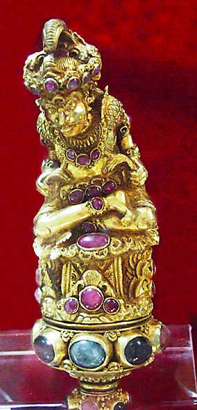

Hi, I'm a new member and glad to join this forum.
Basically my interest is Indonesian Keris handle.
Simply I just want to know,
How to make a metal handle?
It is easy to imagine, when craftsman wants to make a handle made of wood or ivory, they will directly carve from the material by using tools such as chisel.
As for metal handle, especially solid gold handle like a picture below,
does goldsmith make a cast first then carve the details?
Or directly carve the gold?

It would be nice to see a larger picture that shows more detail.
How many grams does this beauty weigh?

Welcome to the forum Kinary.
I agree with Rick, better photos are vital especially if you are interested in exactly how this particular hilt was created.
I do know that such hilts are not always solid gold. Often with gold hilts you have sheet metal that is worked over a wooden base. But i don't know that that is the case with a hilt such as this. Just keep in mind that the same technique is not used on all metal hilts. Some may be cast, others hammered over a wooden or resin core, etc.
This is a really nice looking hilt btw. Is it yours?

Thank you Rick and David,
This is not my handle, a collection of Neka museum.
I don't have other pictures on this specific hilt, but what I want to know is general knowledge of making, especially about Balinese solid gold hilt.

A solid gold handle would be made with the lost wax casting method. Such a handle would be extremely heavy and would cost probably 12,000 (or more) dollars in gold (not counting gems); then the maker would charge for his labor on top of all the other costs.
If you wanted to cast most of the detail you would probably need to use a centrifugal casting device which would spin the mold at high speed to force the molten metal into the fine details; even then the casting would need further carving and detail work.

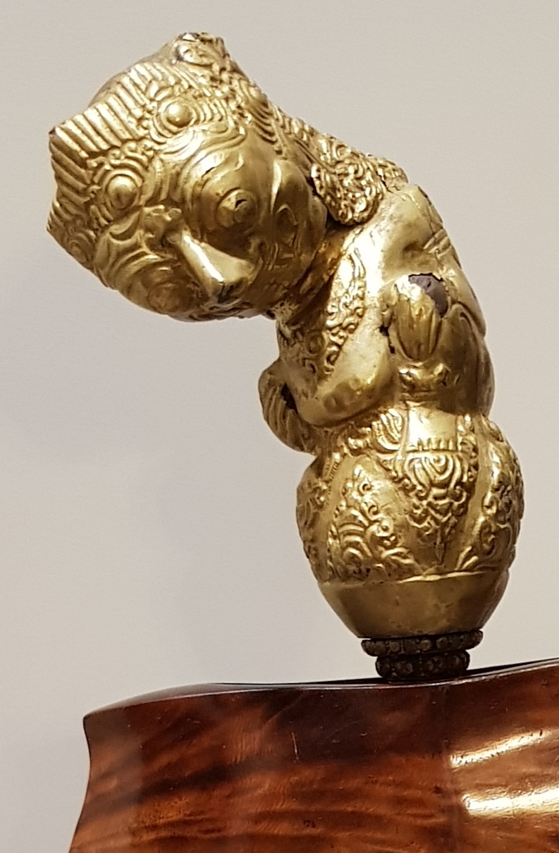

From my experience and some other info, yes you still can order new gold handle Bali keris. If they can make the silver, they can make in gold but surely the risk become higher if order from scretch. Meaning: you prepare or paid the gold, you have to trust the maker 100%, hopefully finished as agreed and you like the result. Its a long journey as situation can changed a lot in between.
Quality of workmanship is an issue once done. Either you like it or not happy.
If you are new or not really have a good information, its much easier just buy finished one and pay as agreed. They do changed hands but very rare. As good one ( quality- questionable: how deep is your understanding of quality)
, old, rarerity, sought after- high demand as any other items we know always high price
Attached my hilt, just another sample. From side you can see the material is thin and material used is kind of wax, dont know what to call-may be Allan can help. They mold and cover, once cold its inner core harden and can be modelled. Similar to some pendok process in Java

I have usually seen the gold over pitch approach. The pitch is roughly molded in the general shape and then thin gold plate/sheet is placed over the shape and then stamped and chased onto the gold. The pitch(ish) material takes and then holds the new indentations in place. Thus the form takes shape (every pun intended ) and you have a hardened gold covered hilt.
There are some details I'm leaving out, but this is the simplified explanation.
