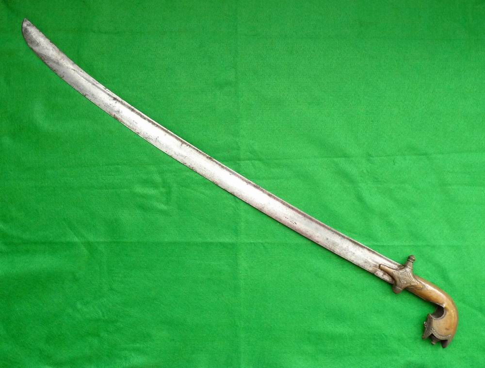

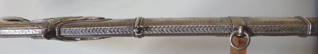

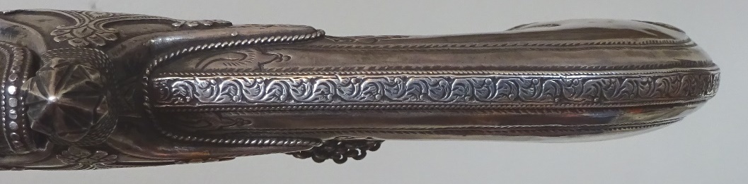

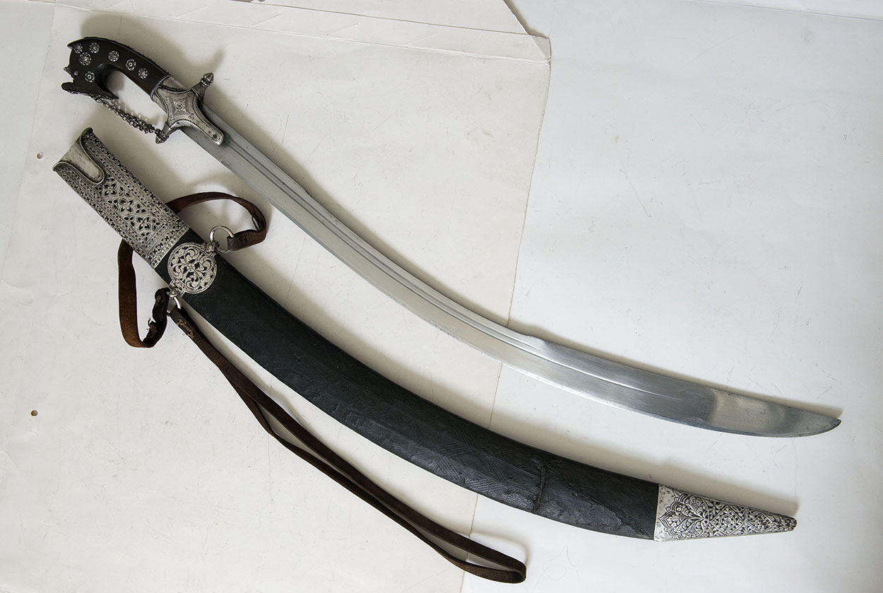

Default Is this a common Arab Saif ?

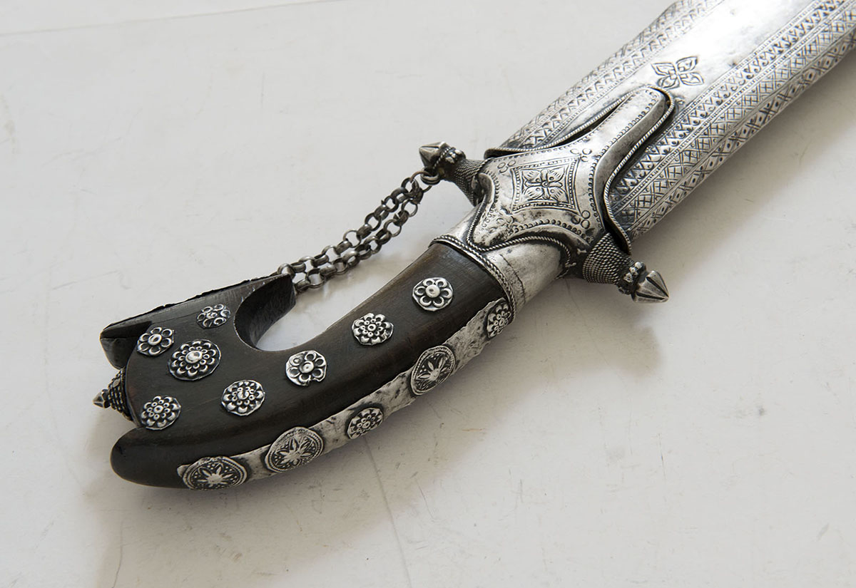

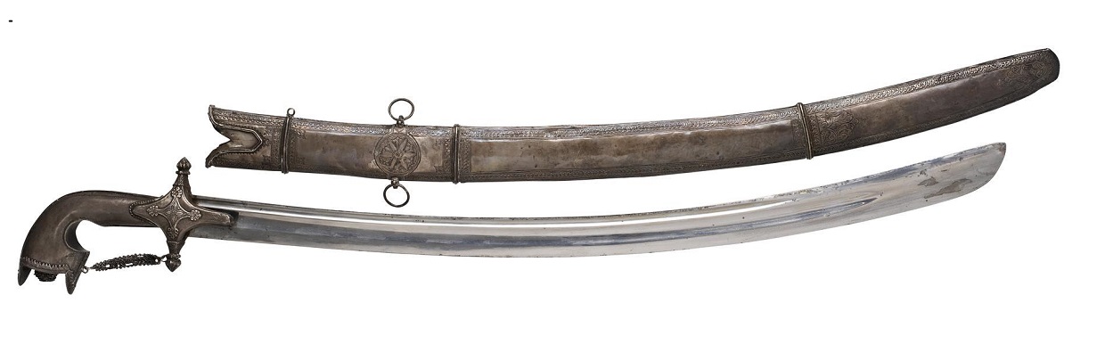

I have travelled a couple hundred Kilometers to convince a guy to sell me a basket hilt sword from his collection and came back with this item, instead; not even my collecting area. I know it doesn't make sense but ... i found it appealing .
So far as i have read this is a South Arabian Saif, hoping it has some age, like mid 19th century ?. Handle and scabbard in silver, fully decorated. The one fullered slightly curved blade is rather strong, with its 39 mm. width, 6 mm. thickness and 69 cm. length.
The langets are a bit twisted (more one than the other) but i will have the local silver smith to straight them up.
Would you Gentlemen care to add your comments on this sword ?

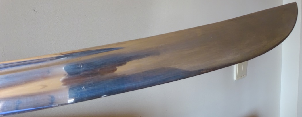

is the blade chromed? Not the area of my collecting but a very nice sword. It would be a mess when the blade is indeed chromed!

Very nice saif from Southern Yemen. Elgood shows a few swords like this on pages 13 & 14 of his book on Arab arms, and Hales shows some on p.245, including a picture of the Sultan of Lahej and his retinue with such swords. Both authors express a belief that these swords were actually manufactured in Hyderabad for the Yemen market.

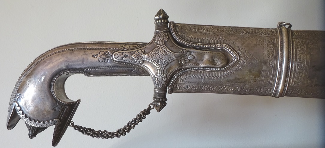

What intrigues me about these saifs is the hilt, which has a grip that resembles the Omani/Zanzibari nimcha, but with an Ottoman influenced crossguard instead of multiple branching quillons.

Very nice sword Fernando. I always wanted one of these when I was collecting Omani stuff.

Fernando you're a lucky man, this sword is superb.
Teodor is right and provided the good references.
But I don't think that these swords are from India but from Yemen.
They might have been used in India but not produced in India...

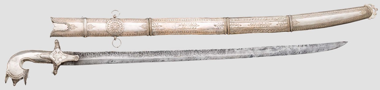

Fernando are you sure that you didn't buy the one from the Royal armouries?
Its almost the same and dated from 1771-1799...

There was a wide range of the “ luxuriousness” and this one indeed belongs to the upper 10%.
But IMHO we should all be enriched by seeing the whole gamut.

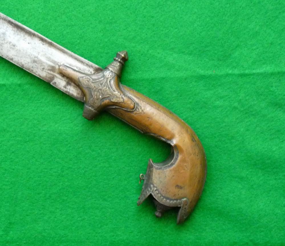

OK then, here is my rather mundane example.

Not chromed Detlef, only polished ... possibly with a power tool.

What intrigues me about these saifs is the hilt, which has a grip that resembles the Omani/Zanzibari nimcha, but with an Ottoman influenced crossguard instead of multiple branching quillons....
Thank you Teodor; i am learning. I don't have those books; my only Elgood is on firearms. When i kew this was called a saif, i went on my Tirri and saw something of the kind in page 99. Oh, but i wish i had the pictures you mention from Elgood and Hales, specilly the one with the Sultan of Lahej.
Ah, the hilt top resembling the nimcha, Omani Zanzibar and, don't forget, Moroccan; the riddle of the egg and the hen, right ? Bu the way Teodor, can you quote futher paragraphs from those authors on the Hyderabad origin subject ?.

Its almost the same and dated from 1771-1799....
Well, i was not expecting my example was as old as that in the Royal Armouries, but i will be most pleased that it dates as from the 19th century...

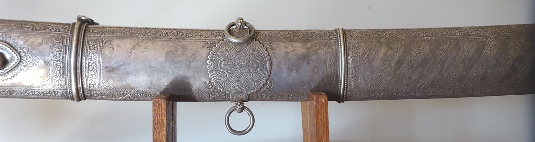

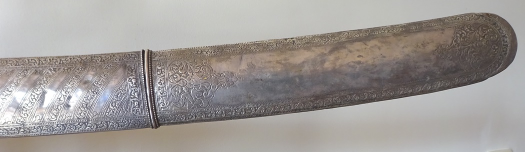

Fernando scabbard has some similarities with other Yemeni scabbards.
And if you look closer you'll see a consistency between hilts and scabbards...

Should I comment this blade?
A last point I think that Fernando blade is chromed not polished, but i don't see any problem with that.

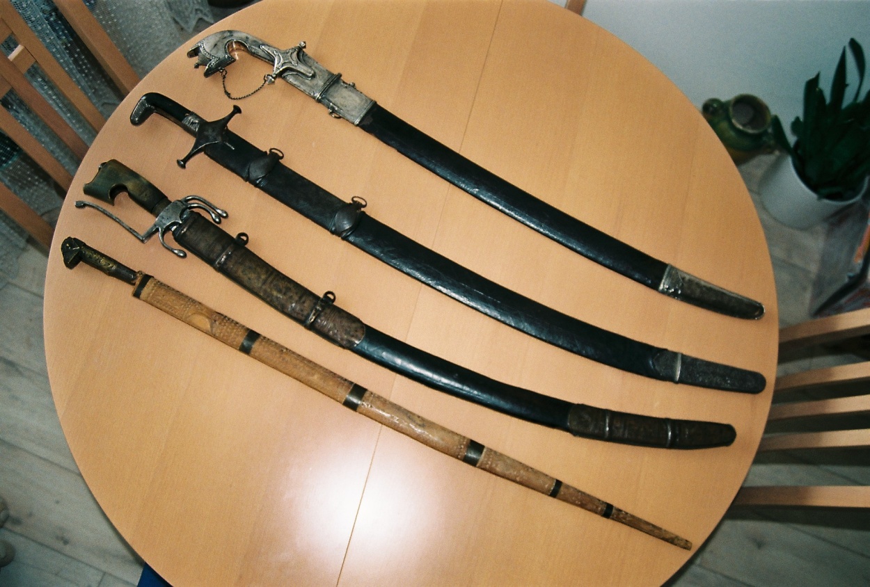

Martin Lubojacky
Join Date: May 2008
Location: Czech Republic
Posts: 862

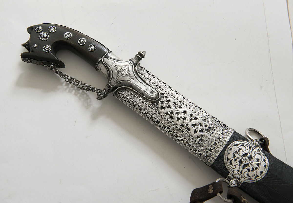

I think you have bought extra-piece of its kind Fernando. Congratulations.

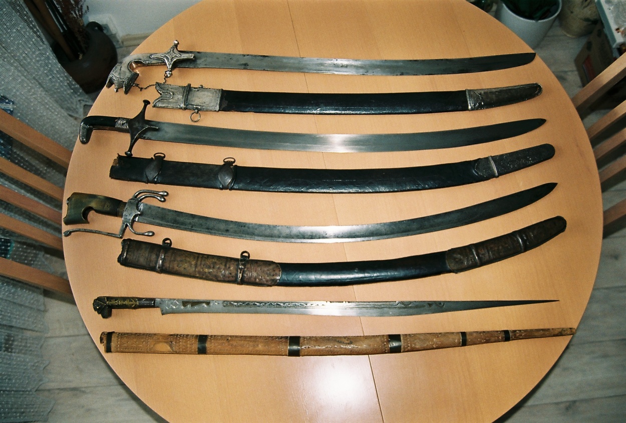

I hope I may add picture of the similar sword I bought years ago from Artzi, to your thread. I think my blade was made in Arab country - there is some mark like "V" on it. Unfortunately I have only old photos on flash disc with me (on the top of it in a group with another sabres, - I can make another pictures/closeups - but in July earliest).

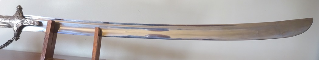

I think your blade is not chromed. Could possibly be nickeled. (But maybe also only highly polished.)
Old 22nd March 2018, 06:13 PM   #20
I am extremely pleased i was not counting with such contribution from all of you Gentlemen.

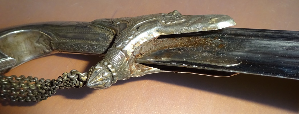

May i add that:
I understand when Kubur says that there is a consistency between (the decoration of) hilts and scabbards.
And may i say that, definitely the blade is not chromed or nickled, but highly polished. I take it that my jeweler friend and the silver smith we went to straighten up the hilt langet would have noticed that. The first confirmed this morning that the blade is polished and the second has discussed with me the methods to "unpolish" it ...not to "unchrome" it.

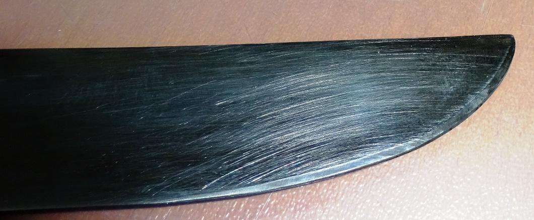

Fernando, I would also be interested in some good "unpolishing methods". Maybe fine pemza powder mixed with oil or water ?

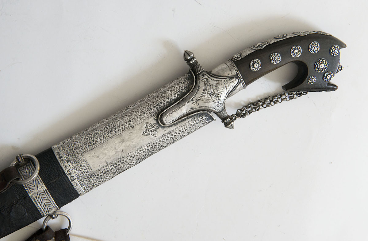

Posts: 785

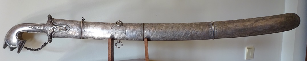

Fernando: it is not a common Arabian Saif, but one of the best Saifs I have ever seen! A great sword, congratulations!
I would like to add my humble example to the thread since this thread shows many reference examples. What makes it specially interesting is a blade with yelman.
You may try for "unpolishing" a very fine sandpaper with 2000 grit or a 0000 steel wool.
Old 23rd March 2018, 01:22 PM   #24
Thank you for your kind words and the pictures of your excelent example, Tatiana.
Thank you also for the unpolishing suggestions.
Martin's idea for wet/oiled pumice powder would be a different method.
Eventually my local silver smith also suggests steel wool or, as alternative, a (dishwashing) green scourer pad.
In any case, i am not yet ready for such adventure and for the meantime, will leave it as it is.
Your sword is very interesting, a combinaison of Yemeni and Zanzibari swords...
With an imported Indian / Afghan blade (these blades have a yelman).

From the photo above it is also obvious that the Royal Armouries wisely chose to leave the high polish on their example alone.

Dissadvantage of the fine sandpaper (e.g. 2000) is, that when/if its surface is choked - you are starting to polish (instead of unpolish). On the other side - if the paper is new, you risk scratches (even in the case of 2000 grit) visible from certain angles. That´s why the fine pumice stone powder on the wet/oily and soft mussy textile should be (only my opinion) more regardful and should give steadier result... I think

I have seen a few of these. A polished or burnished blade is not uncommon, and for that matter common to many Arab swords. I think it is most probably how the original owners would have wanted it, so beyond cleaning, I would leave it as it is.
