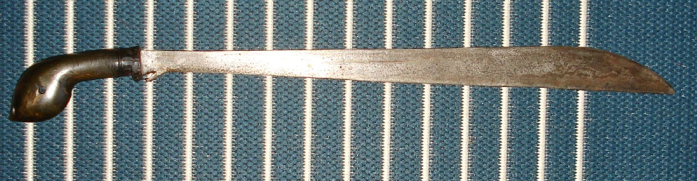

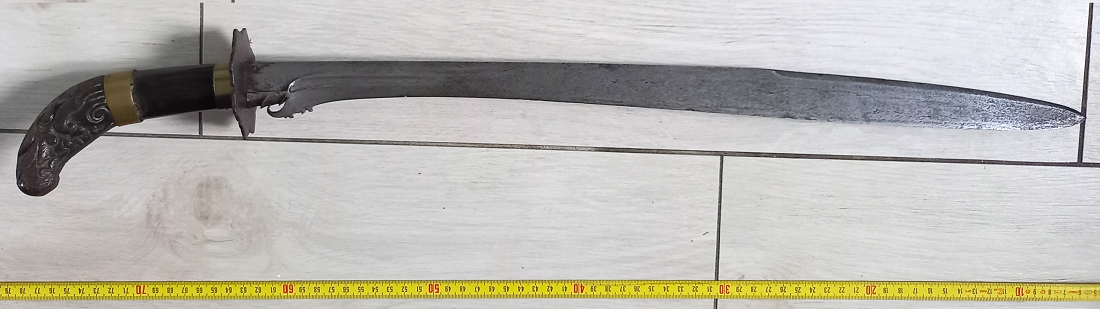

Here is my birthday present received a few days ago.
It has some points in common (at the handle) with a pedang of palembang hinterlands posted a few days ago, but the shape of the blade is very different.
The blade is very wide at its base (1,5cm) but especially it has a Kembang Kacang and a very nice pamor that looks like pamor "Udan mas" of keris.
There is some remaining red paint at the base of the floral part of the handle.
The sheath seems a little more recent than the rest of the sword.

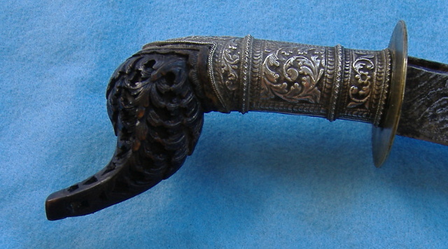

sadly I am not able to post pictures from this sword since it's not mine but the owner is a member of this forum, I will give the member a hint, maybe he will post pictures from his sword.
Old 21st February 2018, 06:28 PM   #9

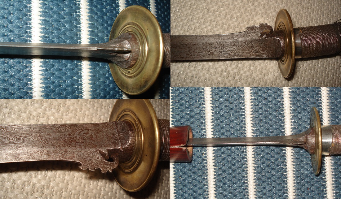

Originally Posted by Sajen
..sadly I am not able to post pictures from this sword since it's not mine but the owner is a member of this forum, I will give the member a hint, maybe he will post pictures from his sword.
After contacting my friend I am allowed to show pictures from the blade, the pictures are from the auction. It's for sure a Sunda sword.

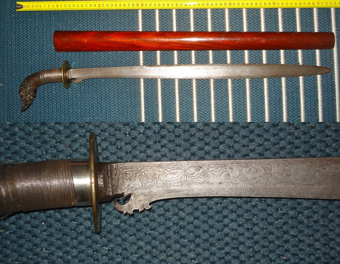

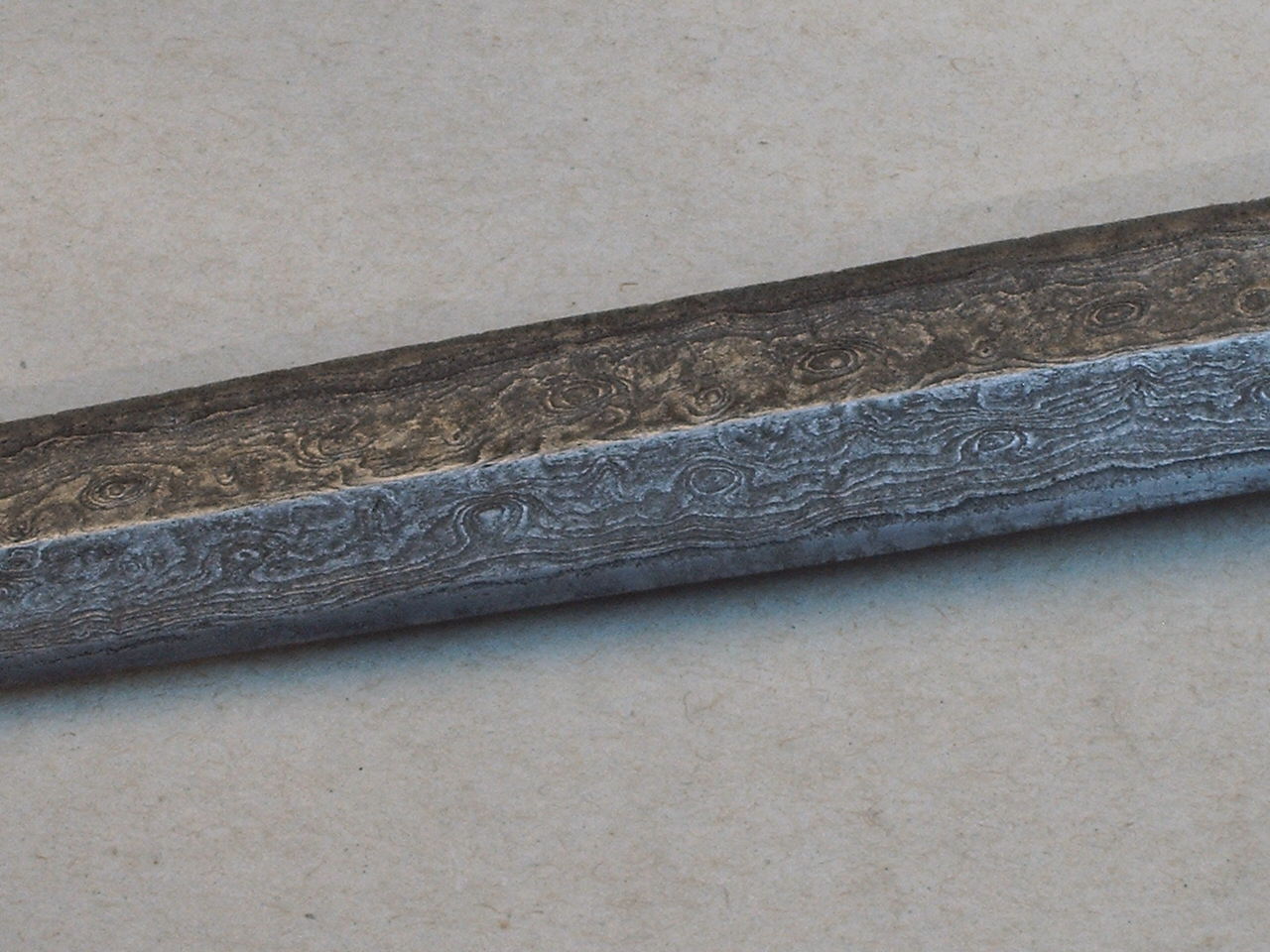

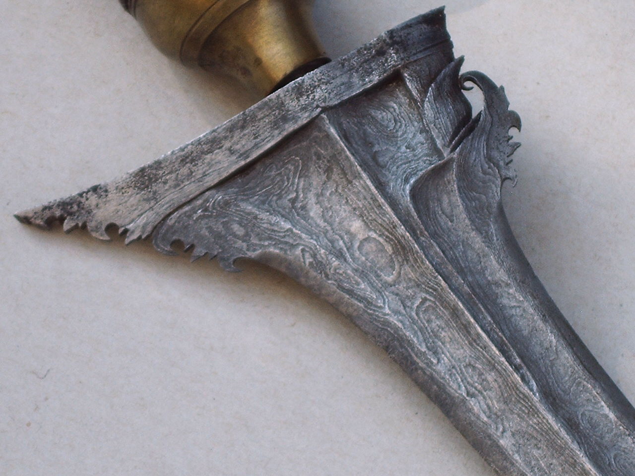

With one week late, the pictures :
Old 13th March 2018, 08:59 PM   #23
Hello Séverin,
what a beauty! Can you post pictures in this quality from the whole sword?

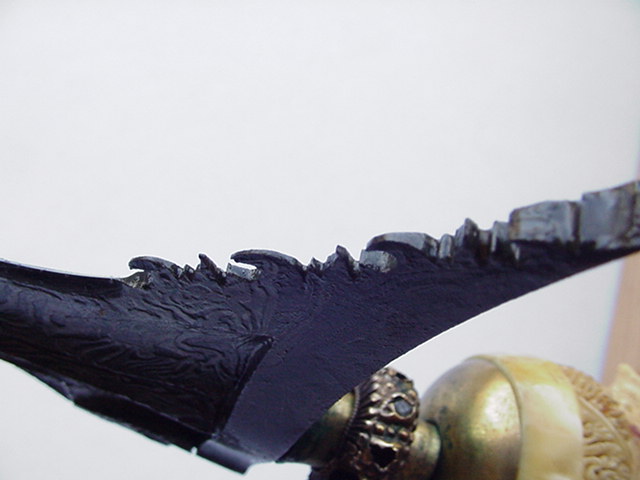

Séverin,
thank you for the pictures.

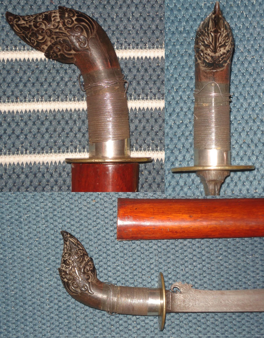

I attach two pictures of a Palembang Keris. They show the typical "thick" Greneng and Jenggot, the edge loosing its sharpness just before Ri Pandan (that's why we more often see a complete Greneng surviving on Palembang Keris) and the Udan Mas-like Pamor treatment.
The Jenggot on you Pedang also is "thick" - till now I haven't see a Sundanese or Cirebon or Javanese Keris with this feature, and my main interest is Keris.
Maybe we could encounter this feature on a Pedang from Sunda - I don't know.
Old 14th March 2018, 12:33 PM   #25
Gustav
Join Date: Jun 2009
Posts: 1,346

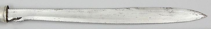

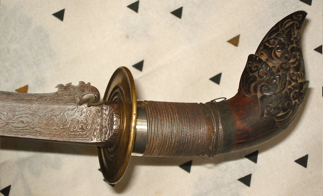

And a picture from the now defunct UBB Forum, which even better shows what I mean:

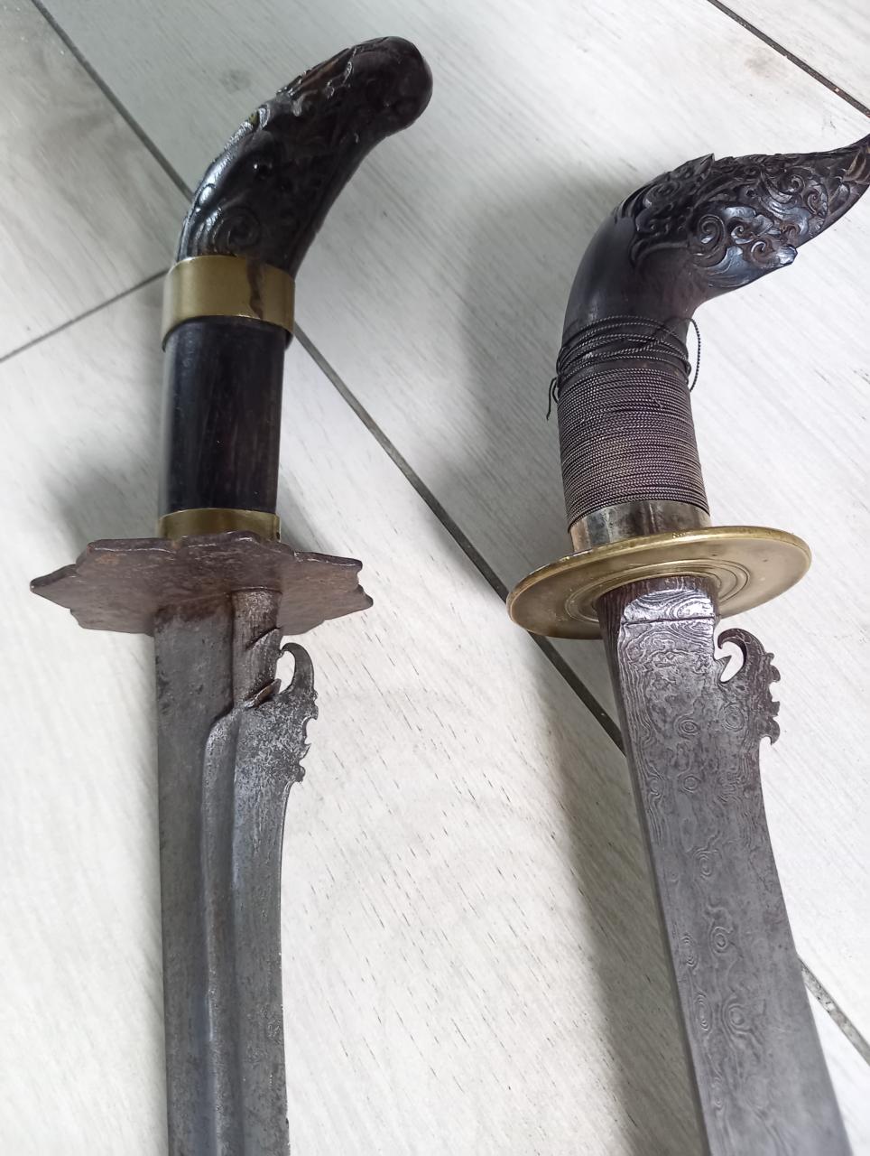

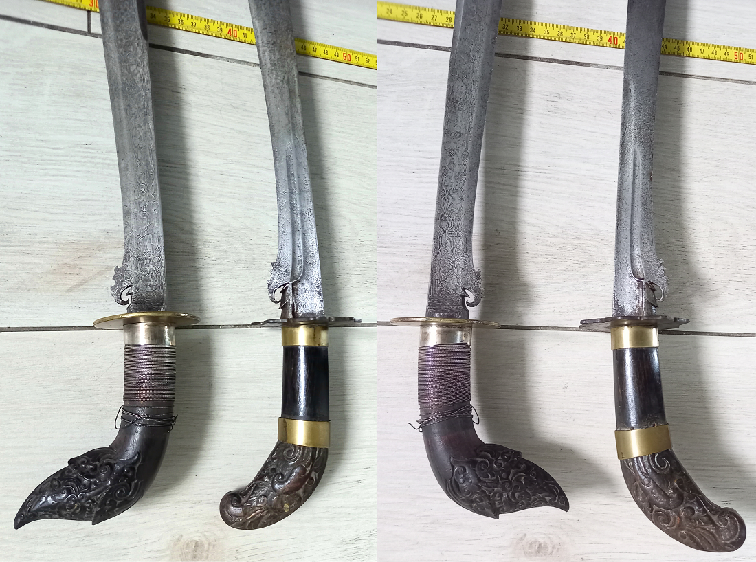

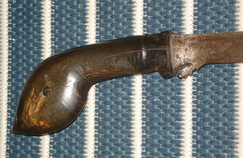

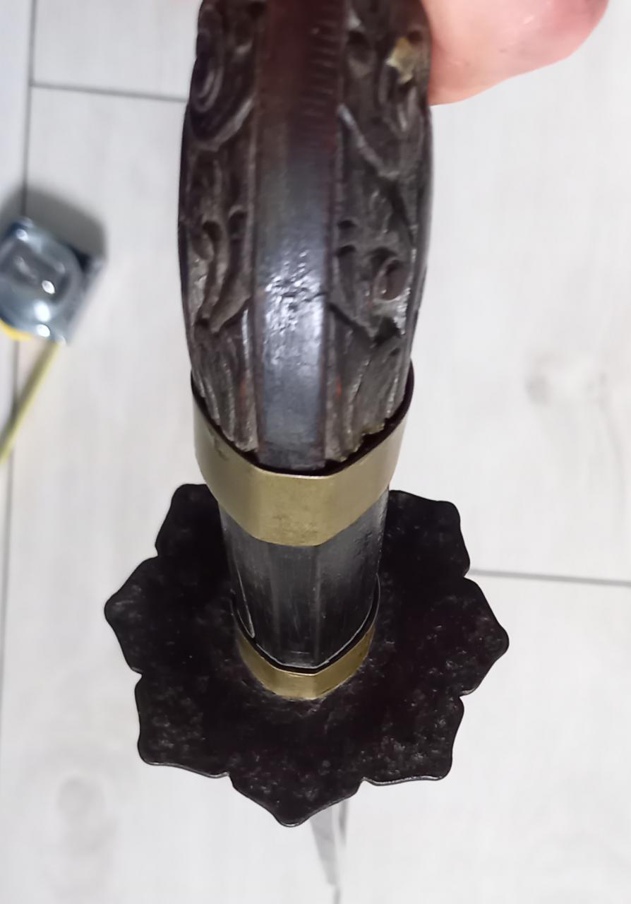

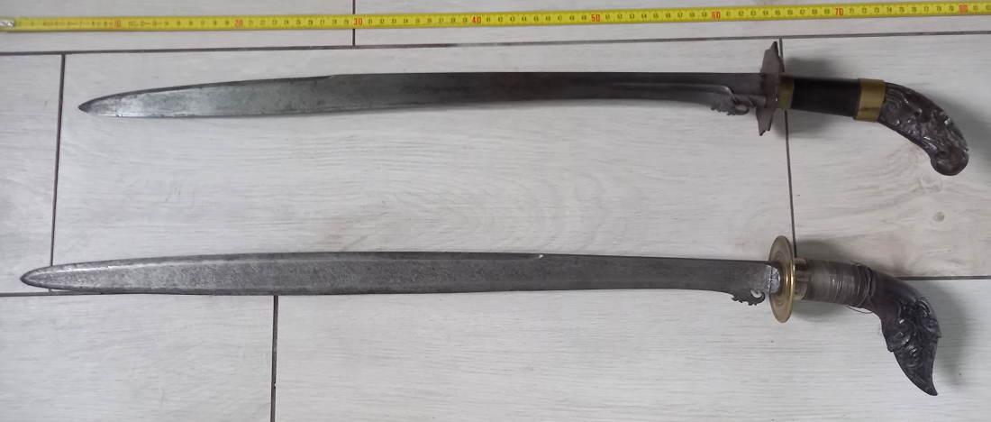

I recently received a new pedang from Sumatra that looks very similar to the one at the beginning of this topic.
The handle is a little different, the iron guard forms a flower with 8 petals.
The blade is imilar but more detailed and better made in the "ricikan" area.
Old 5th May 2024, 03:33 PM   #27
Hello Séverin,
Another very nice pedang! Congrats!
Old 5th May 2024, 06:37 PM   #28
