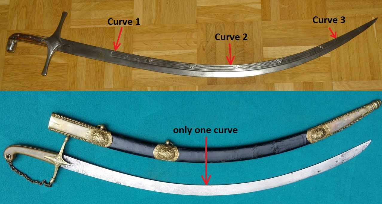

The great secret of the Persian Shamshir is that the blade got at least two curves instead of one on European blades!
Please look at the first picture with the curves now. My Shamshir got three different curces, the smallest radius is shortly behind the middle of the blade.
The German copy of the Shamshir got only one curve.

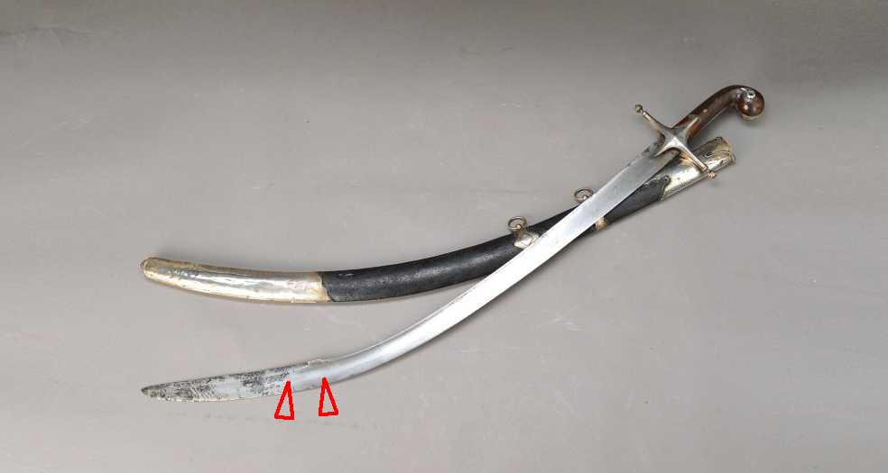

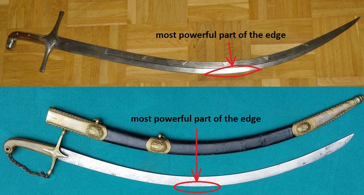

This leads us to the next picture, the most powerful part of the edge. The most powerful part on a curved sword is the "deepest" point.
I highlighted the areas in the second picture.
It is clear to see, that the most powerful part of the Shamshir is closer to the point.
Closer to the point results in more velocity, which results in more kinetic energy and more impact power.
Another very important effect of the two radius design is that the blade hits its target in the right moment, when it reaches its highest speed.
This is ideal, slightly curved back plus a small radius for maximum impact power.

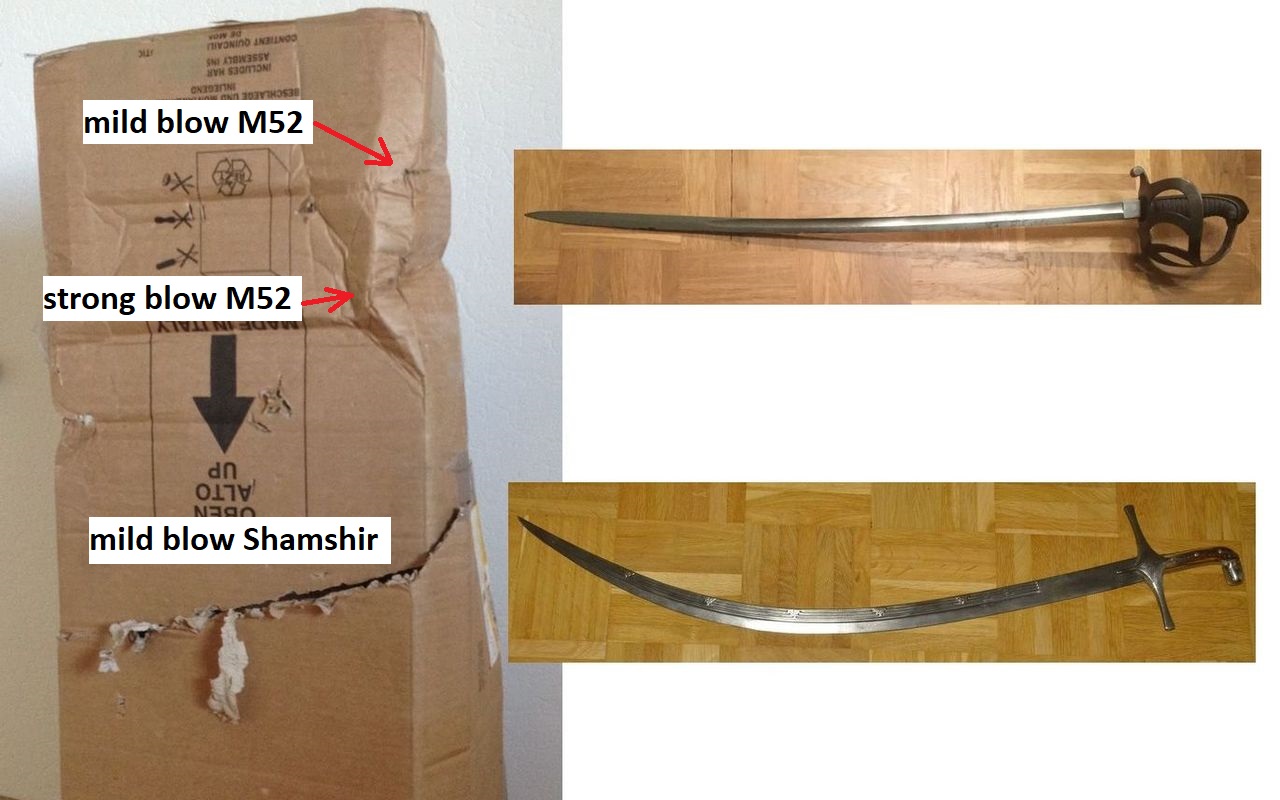

As an evidence for my opinion I added a picture of the cartonage in which the Shamshir was delivered.
It was a mild forehand-blow with the untouched Shamshir, which was not really sharp. But to my greatest surprise, the massive cartonage was almost cut in half.
I tried the same with a mid 19th ct. German M52 saber (850 gramms, blade 85 cm long), which was brutally used on battlefield.
The M 52 also was much sharper and thinner than the Shamshir but nothing after the first blow with the same speed. I made a second attempt with the double speed, resulting in a little bit of damage.
I know, the comparison is not 100% meaningful, but we see total destruction after a mild blow vs. nothing (german blade was much sharper).
I am sure, if I do the same thing with my French M1822, which is much bigger and heavier than the Shamshir, the difference would still be breathtaking.

"how do you define separate curves? "
Sorry, this is obviously to see and I also highlighted it.

Nah, that's only the tang: E. g. your real shamshir starts out with a (slightly) curved edge already. However, I don't believe this has any importance since this part of the blade won't do much cutting...
That won't cut it as I tried to explain: If you prefer to dissect a continuum, you should define working criteria (when striving for reproducible results).
