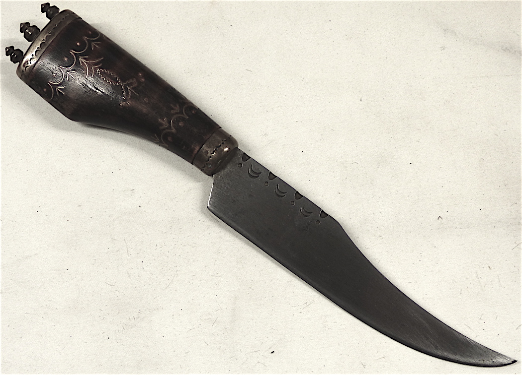

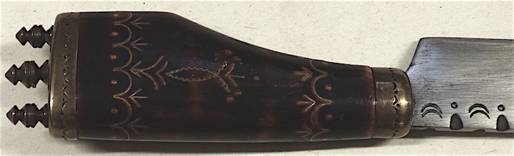

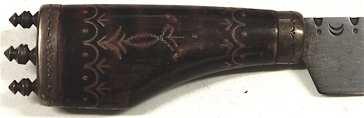

There are a few of these around and they come up online fairly often. Somehow I have it in my head that they are Uzbek or Uighur in origin, but I cannot find anything about them online and I have searched here with no luck so far. OAL = 10.5 inches.
I know that someone here will be able to identify it precisely.

hello Ian
this knife comes from Slovakia.
nice piece, congratulations

Chregu:
Thanks very much for your prompt response and clear identification. I've had this knife for many years and often wondered where exactly it came from.
