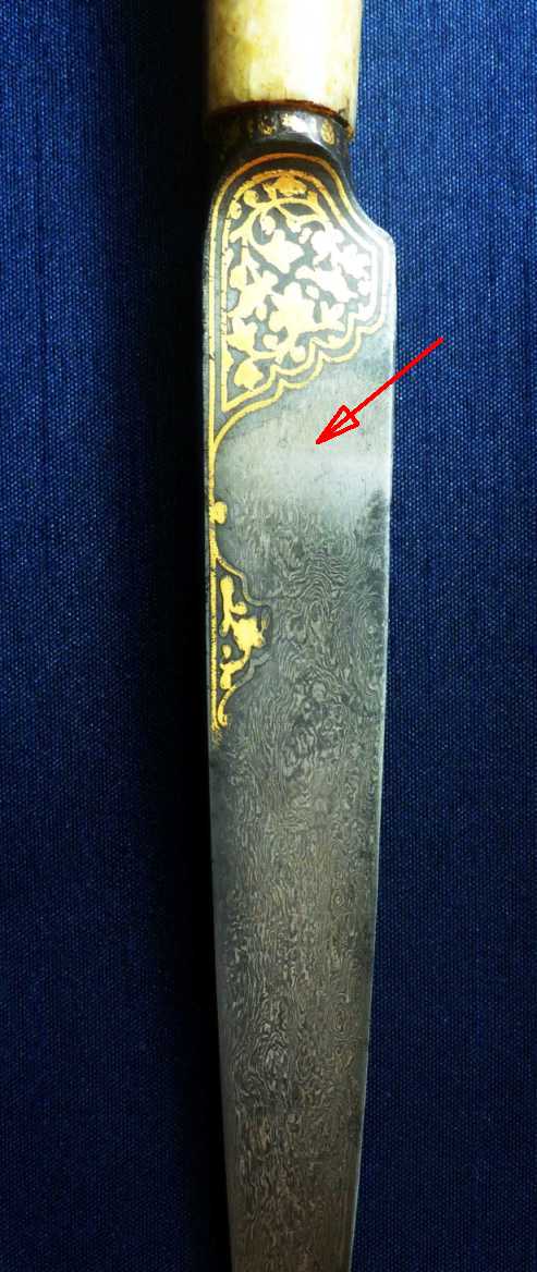

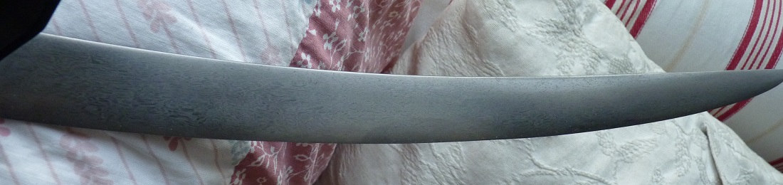

I am once again in need of assistance when etching. I have etched an indian sword in my possesion. I have etched with ferric chloride at about 30%. The sword etches very quickly, about 5-10 seconds will give it a good dark etch.
Now to the problem. There is an area that etches diffrently then the rest of the sword (see picture) the area is on both sides of the sword. I tried ligthly polishing it and the etching again, and repeated three more times. But the result was only slightly better.
I do not think it is a forging flaw. Maybe some result of heat treatment, but the why would the are around it be lighter.
I am thinking that maybe there was rust on the blade and someone sanded away the rust and this is why it looks this way.
I was thinking that if I polished the blade with starting with a rougher polishing paper 400 then upp to 2000 the blade would etch lighter but more uniform. BUT since I dont really know that that will work I am unvilling to try.
I know that there are members on this forum that has had a lot of experience with etching and I am hoping that someone has encountered something similar and is willing to share there knowlege. So In your opinion should I just leave it as is or is there a way to etch it more uniform. If I polish the etched blade it the flaw will become allmost invisible while the pattern is still visible. But we all want that dark etch, dont we

I encountered exactly the same problem a few times already. I tried etching with Nital, FeCl and even with a dilution of Perma Blue but the faded areas would stay the same.
My conclusion is that the difference is caused by some kind of heat treatment that affected the structure of the wootz.

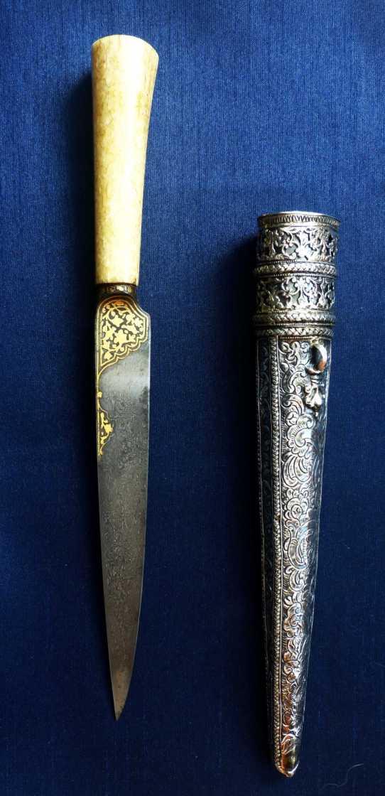

I am attaching some photos of a Persian Kard displaying the same problem. I also have this on a Persian Shamshir.
So my opinion is that you should leave it as it is.

I polished 600 grit to 1200 grit to 4000 grit polish paper on this one. The first etching was with lemon, that worked fine. But since it showed this area of bad etching I repolished and etched the last 1/3 of the sword with ferric chloride just to see if it produced a better result on the problem area. It did not.
So I have to repolish and etch one last time. I will most likely etch it with lemon. Ferric chloride give a darker pattern but I agree with Thomas, Ferric is not fun to work with and I have had problems getting good etchings on other blades I have.

Thats a great looking dagger Marius, that chaotic wootz sure is facinating to look at.

That looks very much like someone heated a spot on the edge, either to straighten a deformation, or in attempt to re-harden a spot.

This is quite possible. These white spots are result of overheating, either during or after forging. They become permanent part of wootz structure/pattern and once they're formed there is no way to 'remove' them by different etchants or develop better wootz pattern or contrast.
