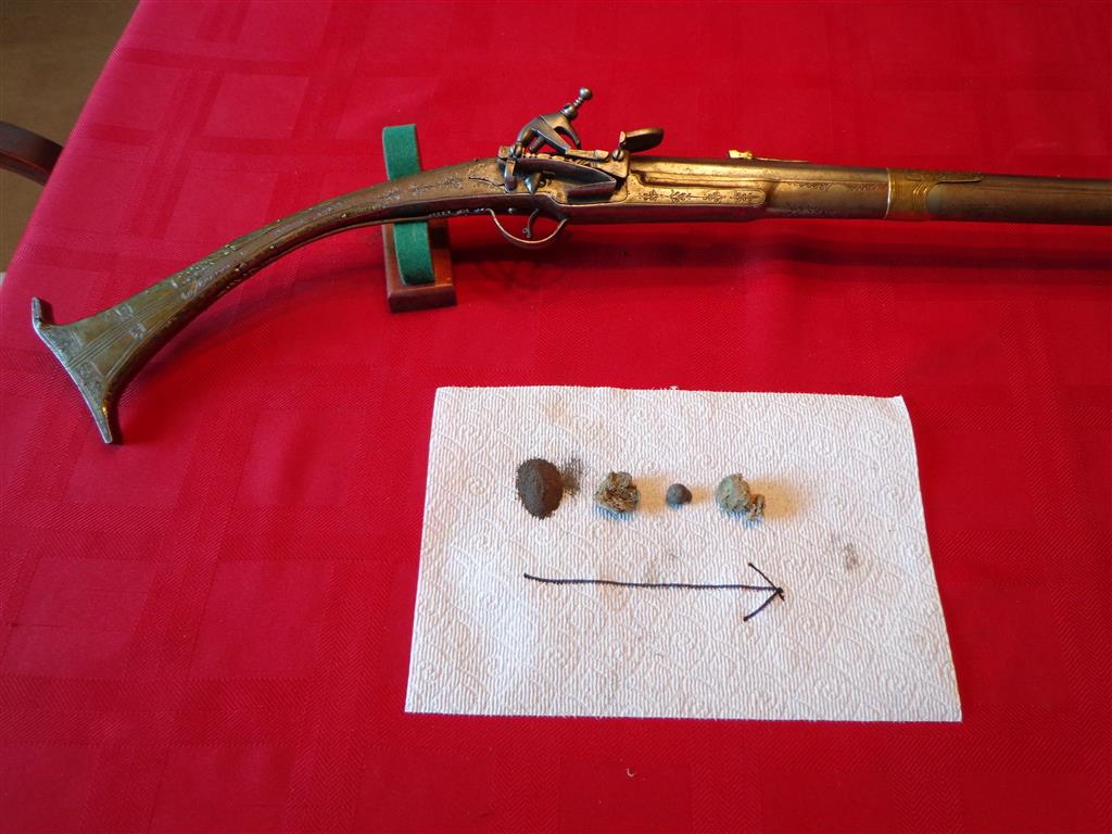

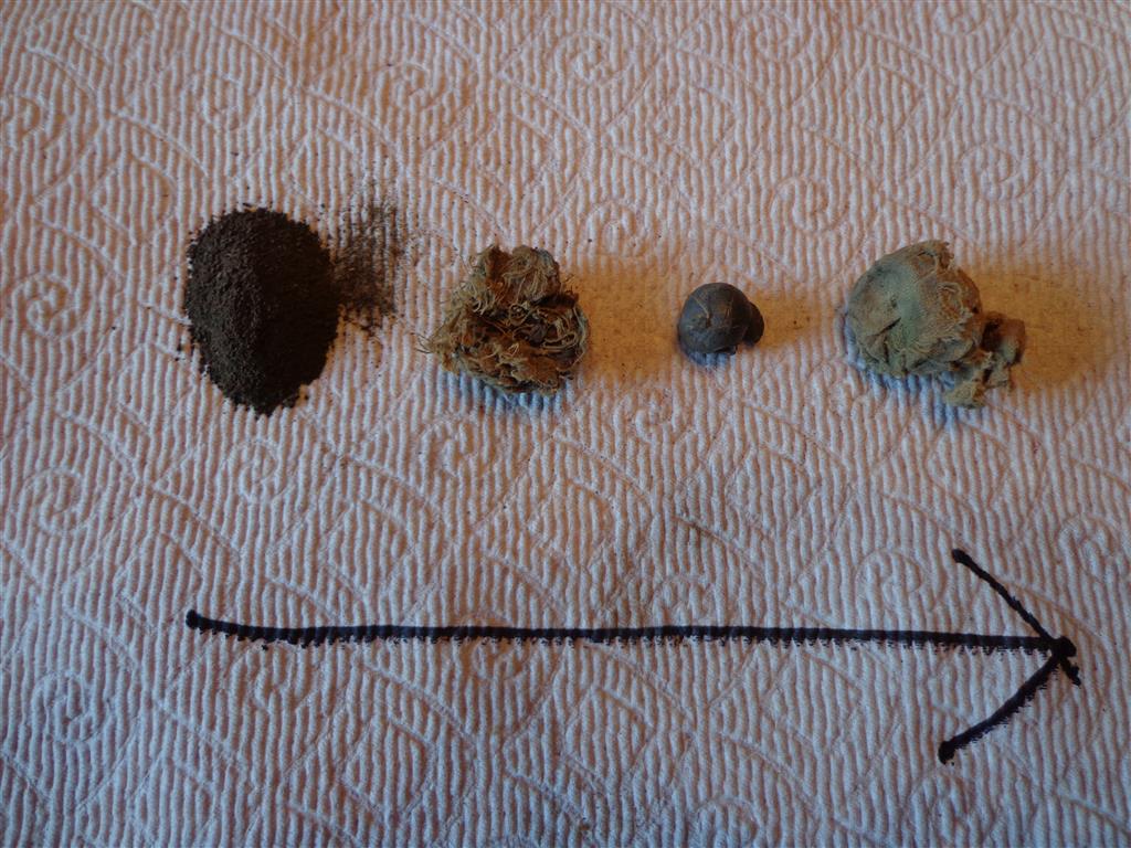

As long as we are on the subject of powder, I thought I would post this photo below. A short while back I bought an Albanian Tanchika long gun that still had a load in the barrel. Fortunately, in this case I was able to extract the load from the barrel without disturbing the contents. The powder is of the corn variety, but the grains seem a bit inconsistant. Even though I traded the gun, I still have the contents. Interesting to see how they loaded the gun. The ball was considerably undersized which allowed me to keep the contents in such good condition after the extraction.

2. Not surprising that the powder recovered from the chamber of that Balkan gun had uneven grain size. It's likely that a lot of the powder made locally was handmade in mom-and-pop village operations, which didn't have the machinery that commercial or military powder mills were equipped with at the time. However, the stuff no doubt worked well enough for the purpose. It seems that these cultures had their own methods for grading the quality of local powder (there is mention of a grading scheme in Delhomme's report on Moroccan gun manufacture that I cited in a prior post), so they must have had a way to optimize the use of the product available to them.
