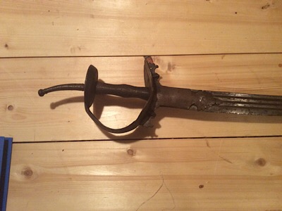

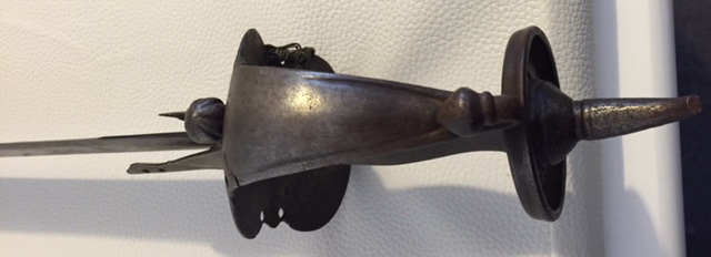

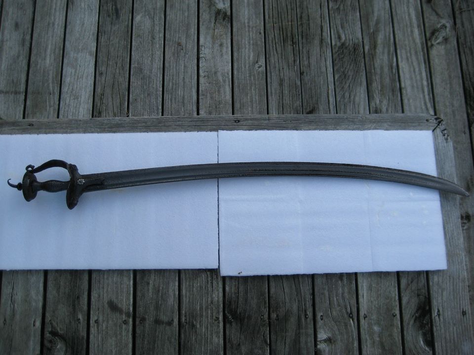

Hi

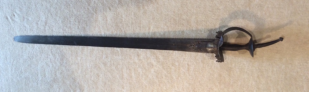

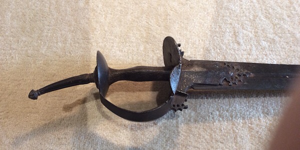

Just picked up the attached sword in my local antique shop.
It was quiet rusted when I got it but cleaned up well
Nice sword in just the condition I like it with lots of age shown there are some star stamps on the blade but the pictures did not come out great.
There is also a small hole in the fuller where I presume a nail once mounted the sword in an old collection,
Blade length of 80 cm
Found some evidence of previous gold leaf on the handle which was nice to find

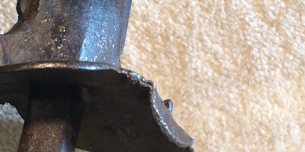

What I found interesting is the damage on the guard, took a lot of energy to do this, i was going to straighten it out but then I noticed the guard is made of two layers which you can hopefully see in the photo. I would have imagined that the guard would all be made from the one sheet interesting that they took the time to laminate it.
Would anyone hazard a guess on the age of this sword? And would yo go Firangi or khanda
Many thanks and a happy new year to all.
Ken

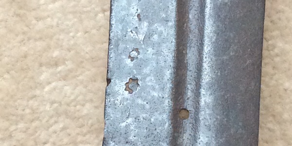

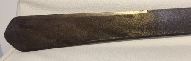

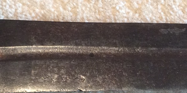

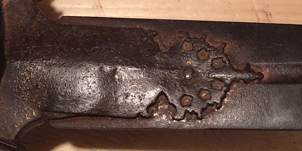

Close up on blade stamp, finally got decent shot
Ken

Firangi. 19th century with an older blade....
My two cents.
Happy new year!
Marius

i think Elgood call them khanda because the hilt is a khanda style.
Firangi means only Franks, Crusaders or strangers
Because the blades were imported from Europe.
But like you Marius I would call this sword a firangi.
Ken your sword is very very beautiful, please send us a zoom on the ricasso and also the marks...

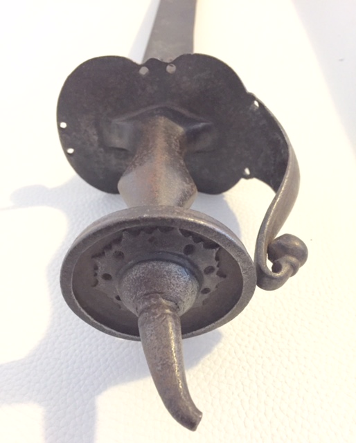

Hi All
Thanks for information
I will hopefully turn up a spatulated tip sword to get a definite Khanda
But these have eluded me so far in my hunting. I am v happy all round with this find though and the Indian weaponry collection is expanding nicely.
I need more Dhals though here again are in short supply in Ireland

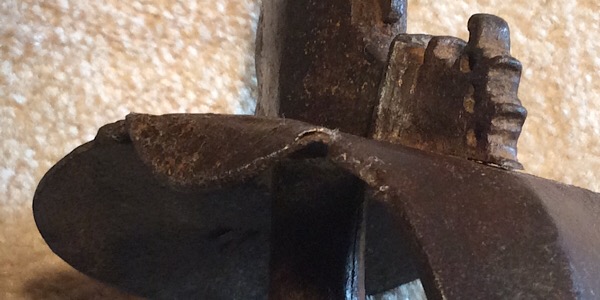

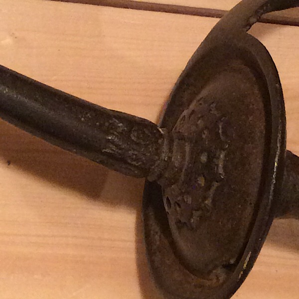

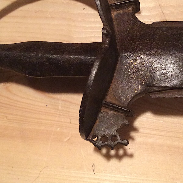

I have attached some further pictures but I am unable to get any improvement on the blade markings you will see more of the remenant gold on these images
Kind regards
Ken

After seeing the detailed photos, I would estimate both the hilt and the blade to be 18th century.

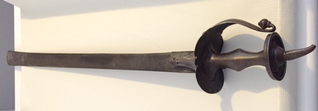

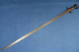

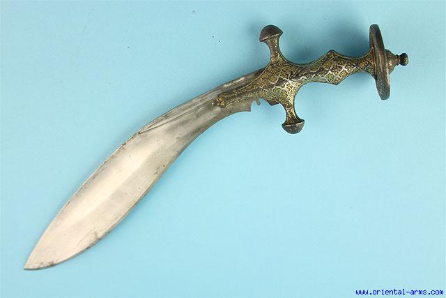

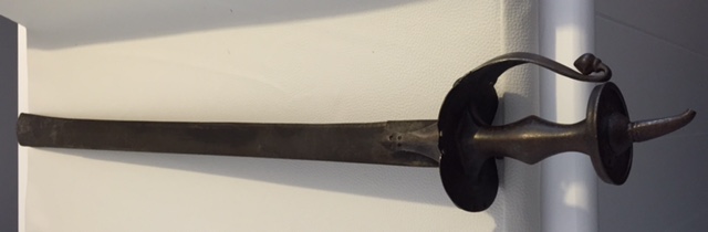

Default 2 KHANDAS IN MY COLLECTION
HERE ARE 2 KHANDAS IN MY COLLECTION
KIND REGARDS
RAJESH

I believe the blade, not the hilt defines the sword, and a typical Khanda is considered as having a straight blade with wide, spoon or diamond shaped tip.
Based on this, I consider the second sword shown by Rajesh a Tulwar.
If it weren't like this, then all the swords/knives below would be Tulwars but I would rather call them "Firangi, Tegha, Indian Kukri, and again Tegha."

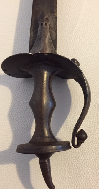

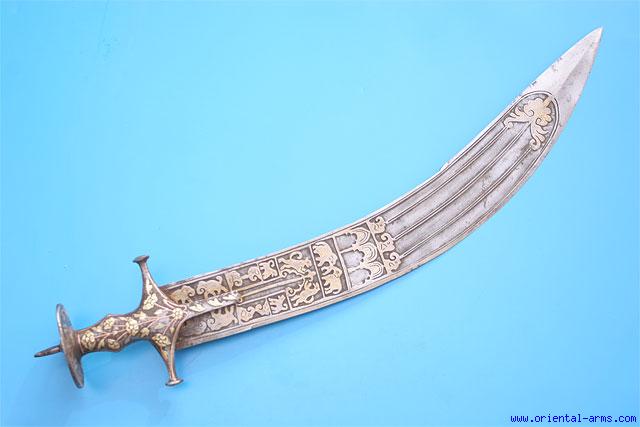

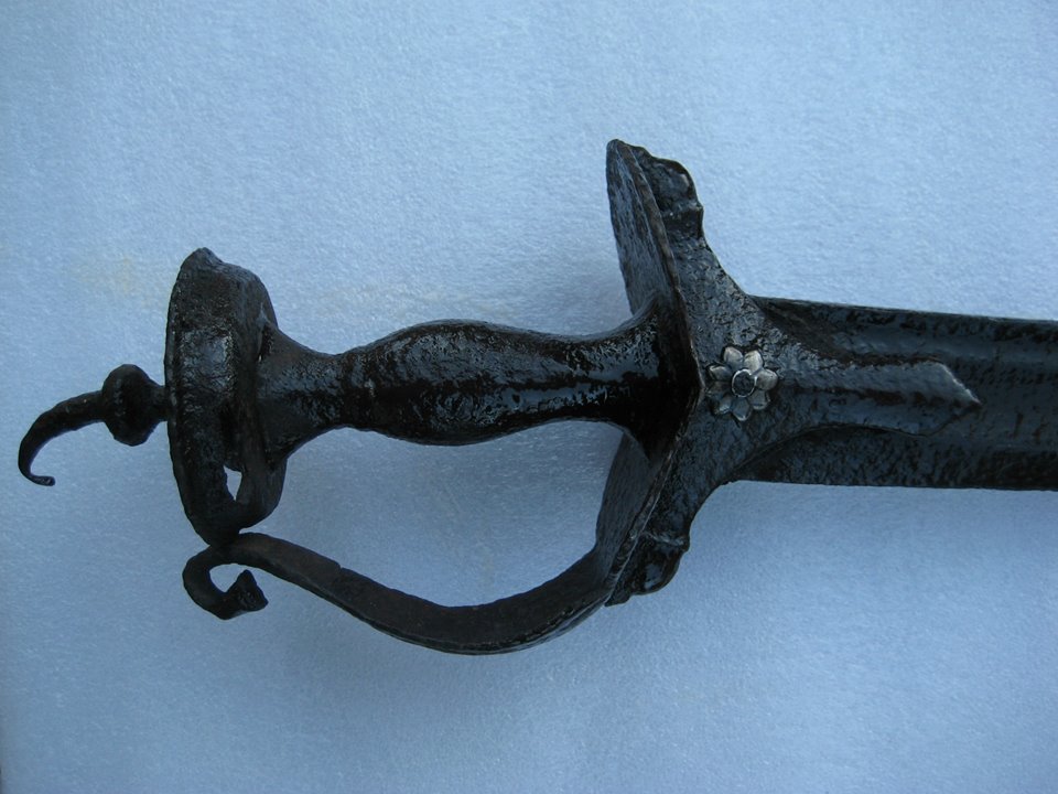

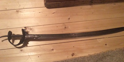

I have 4 swords with this hilt type 2 with straight and 2 with curved blades I must get them all out and compare the nuances and complexity.
One is a foreign curved blade so is it a Firangi Tulwar , pictures below
I have come across to the world of ethnic Indian arms from the world of British swords and Imperial German bayonets because of the complexity of finding out what you have and the fun of research that goes with such pursuits so I can't complain!
I am off to the shop on Saturday as seemingly more items have arrived in which might be of interest. Pity it is January when funds run low but I will just have to grin and bear it.
Ken
