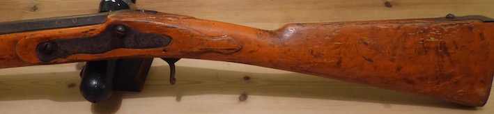

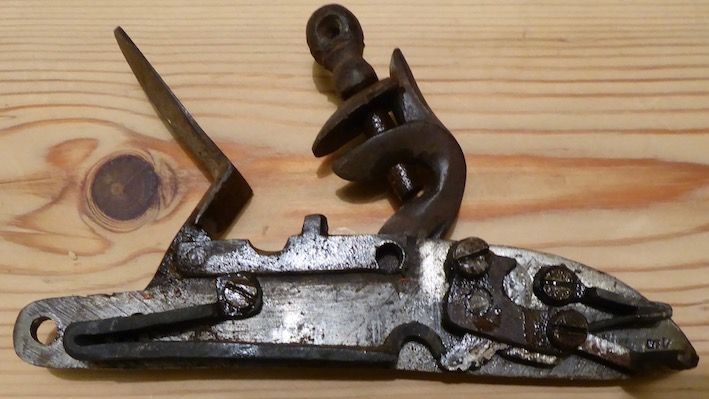

Hi Guys,
This flintlock is puzzling me. Apart from somebody thinking it would be a good idea to paint the stock orange the font of the word London on the lock seems to be more modern than the gun would suggest? Although I'm not clued up on that sort of thing. The barrel has proof marks on the top, have not looked underneath yet as lots of pins to extract, looks to be a crown over BP and a crown over BV along with the number 22. The inside of the lock has an S and a V and what looks to be CC as well. It is approx six feet long and fully stocked with the correct length of ramrod. The keepers for the ramrod are also pinned through the stock. It looks overall to be a reasonably well made thing but definitely utilitarian. Any help would be great.
Norman.

Looks like a "trade musket", made for the African colonies and similar. Nice piece. Don't know much more about them, but I think they were made even into the late 19th/early 20th centuries ??
I am sure others can tell more...

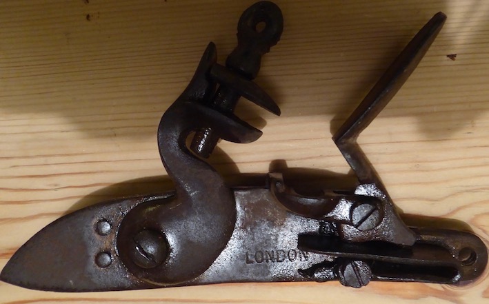

Youv'e got a riddle there, Norman.

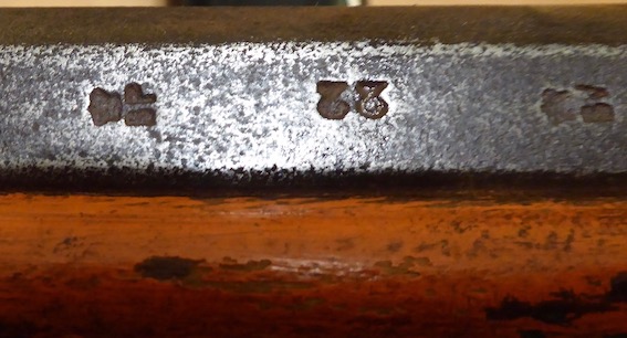

I may be completely off track but, this lock being flint, the barrel has the marks of Birmingham Proof house and inspection Viewed, implemented as 1904 .
Then the LONDON font would be consistent .

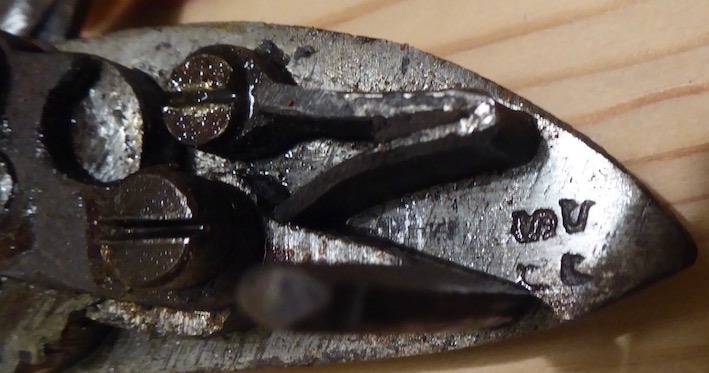

Hi Colin and Fernando,

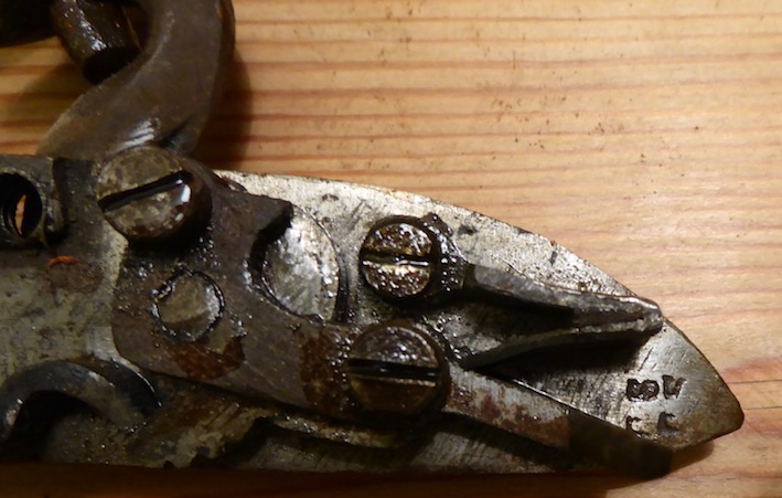

Thanks for your replies.The BP and the BV certainly point to 1904 and onwards. I am surprised that trade firearms may have been flintlocks and not percussion locks at that late date but I guess that not having to have percussion caps would be a plus when you can't just pop into the local gunsmith for supplies. Thanks again,
My Regards,
Norman.

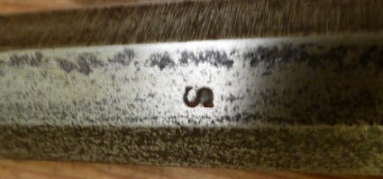

P.S. A better close up of marks inside the lock.

Now that is an interesting gun. And as Fernando mentions, a bit of a riddle.
The overall profile and hardware of this gun look very similar to the English made trade guns exported to North America by the thousands, and sold by companies such as Hudson Bay and others, as you noted. Sometimes referred to as a "hardware store" gun. Plain and rugged for the early North American frontier. Your's looks very similar to ones from the late 18th to the first half of the 19th Century that were so popular during the North American fur trade period. And as you noted, there was little change in these guns for a long period. It seems most were traded to the North American Indians. The Indians would even paint the stocks, usually blue or red. Sometimes even painting a decoration on top of that in a vine pattern. I thought of this when you mentioned the "orange" stock. LOL The locks were usually English made and the barrels (made in various lengths) were often of Belgium make.
Now the Riddle: The 1904 and latter proof date on the barrel paints a different picture than above. While the gun shows definate use, it appears to be in reasonable condition. This could be one of the earlier variations of the trade guns sent to South Africa during the first half of the 20th Century, utilizing surplus parts - as was often the case. If so, it does not surprise me it ended up in your neck of the woods. LOl The orange-ish stock stain is a mystery to me. But all of the original South African trade guns I've seen look different. The stocks look more like European or North American 1860's. This gun looks like a knock off of the early 19th Century. Curious.

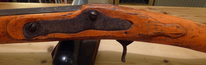

Hi Rick and Fernando,

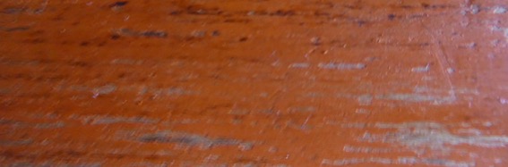

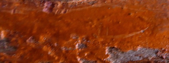

The orange hue is thick paint, not a stain, of a particular virulent hue so as far as I can ascertain definitely modern and chemical and not earth colours. I had thought that some moron had thought the orange would go better with their sense of decor as all of us no doubt have come across perfectly good items sullied usually with gold and silver paint used to 'enhance' their appearance. I will attempt to remove the barrel from the stock over the coming days and maybe there might be more info underneath the barrel. I have to say as it looks like it is an early 20thC piece I've got to get rid of that orange. Thanks again.
My Regards,

Norman - I think the orange paint was put on at time of manufacture to make the muskets more appealing to the natives. I've seen pictures of trade muskets in an African weapons book somewhere, and the stocks were painted red. I had a trade musket myself several years ago almost identical to yours (long since sold), and as I recall the stock is made of beechwood in two parts with the join halfway along the barrel, which can work apart over time... Maybe the paint was also meant to cover up imperfections ?
Colin

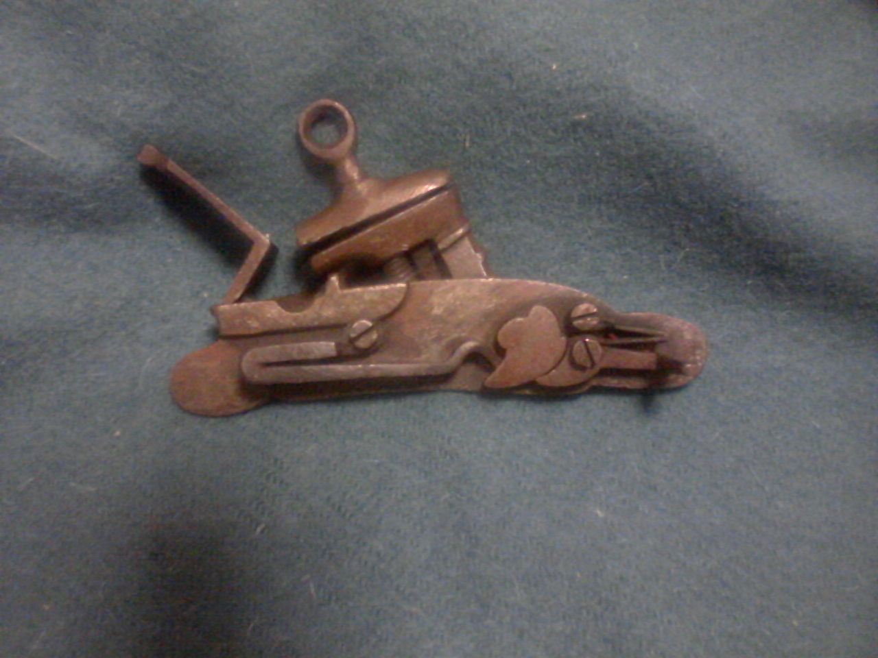

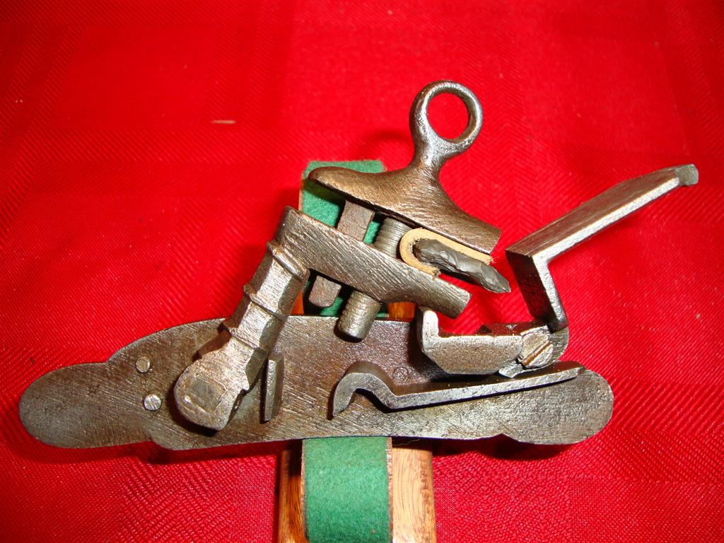

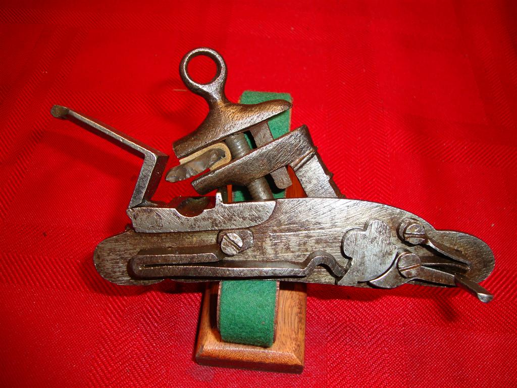

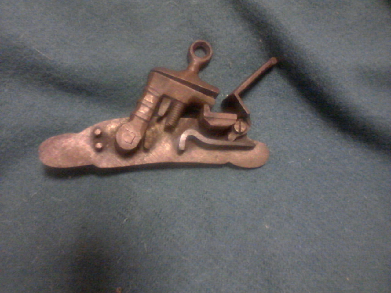

Here is one of those trade locks I believe was used with those "Lazarinas". It's a crude copy of the Portugese locks.

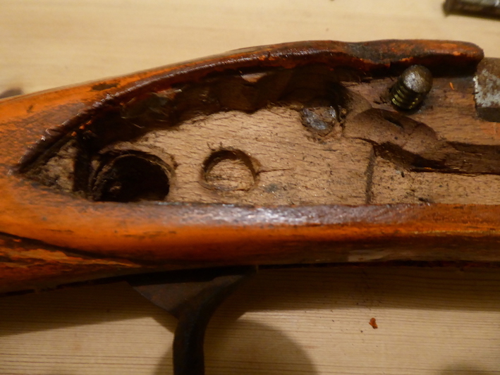

Yes, if you can remove the barrel, that might give us additional clues. I'm loosely wondering if the 1904 stamp might possibly be a re-stamp approval of an older surplus barrel ? A question: It appears the breech plug tang screw enters from the top. Correct ?
If it is determined the orange paint was not original to the gun, and is a later 20th Century addition, I don't see any reason to not remove it. Nothing to lose.

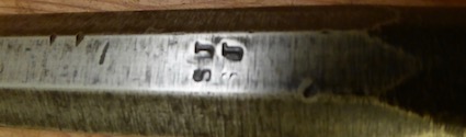

Have removed the barrel and there some additional marks but I guess there are just initials, no earlier proved marks. Rick the barrel plug tang screw does enter from the top. Colin the stock is all one piece and you might be right about the orange being done for export but I can't find any evidence to determine yes or no and I must admit it's a pretty awful paint job but who knows.
Thanks to you both for your continued interest.

Hiya Rick, I think you just solved a bit of a mystery for me. I have had this gun lock knocking around for years, and assumed it was Balkan in origin.....

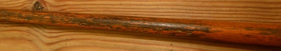

Evidence of a previous finish possibly! On close inspection there appears to be the possibility of black/brown paint or if not certainly a different finish under the orange This is the ramrod where the orange paint is worn.
Norman.

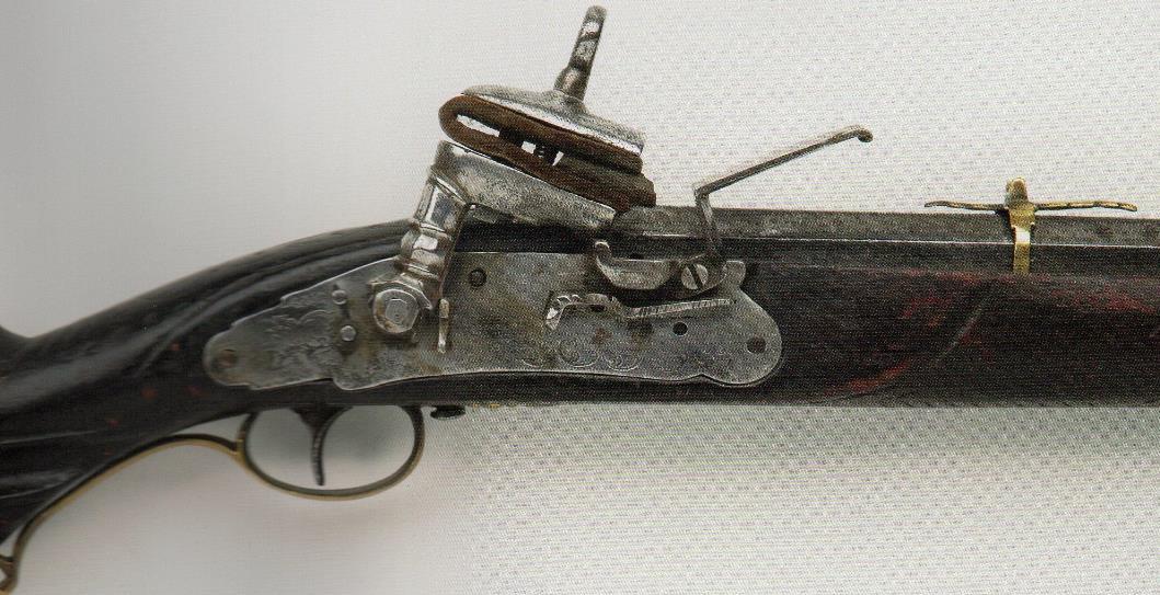

Default With Norman's permit
One (three screw) Lazarina lock plate, shown in "As Armas e os Barões" by Eduado Nobre.

Hmmmm. These additional stamps under the barrel don't seem to help us. But then, my knowledge of markings is very limited. As long as you have the barrel off, could you post a couple of pics of the muzzle end and the octagon section of the barrel ? I'm assuming the barrel is octagon at the breech, fading to round ? How long is the barrel itself ? I know, I'm just full of questions here. LOL
OK. So the breech plug screw on this gun enters from the top, and probably threads into the trigger plate itself. This is a later feature. On the earlier guns the breech plug screw would enter from the bottom securing the front of the trigger guard and threaded into the breech plug tang.
Hard to believe there was a market for smooth bore fowler barrels at that late of date. But the proof mark is there. Hmmm. Maybe Britian was still making these barrels for hobbyist/sporting use (?) Possibly someone had this gun made utilizing old parts and adding a new barrel (then) for sport shooting ? Just speculating. With that photo of the ramrod, it is obvious the orange paint was added later. Possible for some decorative purpose as you mentioned earlier.
I'm starting to think this gun never left the Continent. If it were not for the late proof mark date (and the orange paint) the entire gun looks just like many of the trade guns exported to North America during the first half of the 19th Century.
Hi David.
Yes, your lock is identical to mine, and came from the same batch. The story as told by the late Turner Kirkland was these locks were made (in Belgium I think) sometime before 1950 for sale to South Africa. Well, the sale never went through. So in the early to mid 1960's Turner bought the entire lot for little more than scrap metal cost and posted them for sale in his catalog, mainly as a novelty item. I seem to recall the price was around $12.50USD then. I do remember them in the earlier catalogs. Why the maker chose to copy an early Portugese lock design is unknown. Possibly for the simplicity. So any of these locks you see all came from this same lot. Occassionaly, one will show up for sale on Ebay and the like. Notice there are no holes in the lock plate for mounting. And I've never seen a gun with these locks.
So they are not really a replica per say. Just made at a very late date.

Ohhhh......I wish that gun were in my collection. Notice the lock similarities. LOL

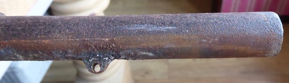

Hi Rick,

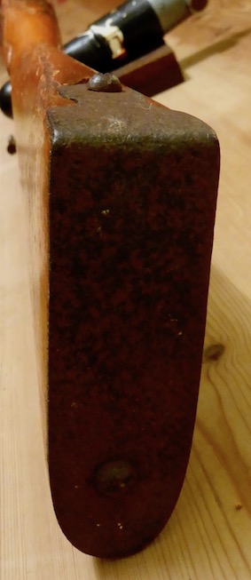

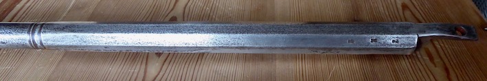

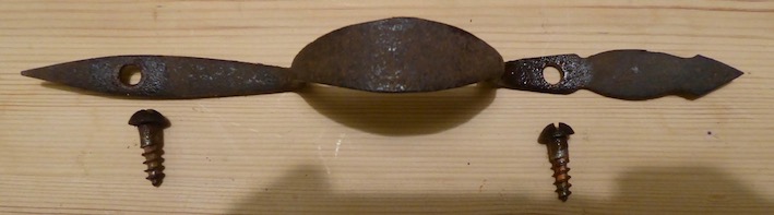

The barrel is 52 inches long, excluding the tang, and I have attached the photos you requested. The barrel does indeed go from hex to round. I have discovered that the proof marks are from 1904 to 1925, I suspect that in this case it would probably have been prior to 1914 if for no other reason than there was a huge surplus of modern arms after this date and if indeed this is an African trade item I doubt if they would continue to be happy with the antiquated technology of the musket. Thanks again for you help with this piece.
My Regards,
Norman.
P.S. The photo of the muzzle end is indicative of the found condition of all the metal parts of the musket.

Hi Norman.
Thanks for the additional barrel photos. OK. Octagon fading to round. The most common style. The most common barrel lengths on these "Trade" guns are usually 36" to 42". The longer ones such as your's are more rare. And more desired among collectors.
I'm wondering, even at the turn of the 20th Century, if all gun barrels wheather muzzle loading or modern (for the time), old or new, had to be proof-marked ? Even for civilian use in the Kingdom ? Possibly your barrel is older and re-stamped latter ? But it doesn't look that way. Hmmmm. Don't know.

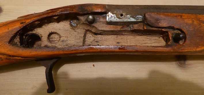

One other thing I do notice. The wood, at the inletting of the lock mortise looks old. But not old enough to be first half of the 19th Century.
The lock looks to be of good, plain trade gun quality of the original period. As well as the style of iron butt plate and trigger guard. I can't imagine their would be enough of these locks/parts surplus to build some type of production for African trade guns.
So, at this moment, my best guess is that this gun was built sometime after 1914 for civilan sporting use, utilizing an older lock, butt plate, and trigger guard, with a later barrel.
In any case, it's sure an interesting piece.

Yes, the lack of mounting holes and the unpolished finish seem to indicate that's where the production ended. And just stored away in a warehouse and forgotten. LOL
Notice also, there is not even a half-cock/safety notch cut into the tumbler. Seems like they were trying to cut every corner making these. LOL

Be careful if you remove the paint. red lead paints can look a quite bright orange & can be bad for your health.
