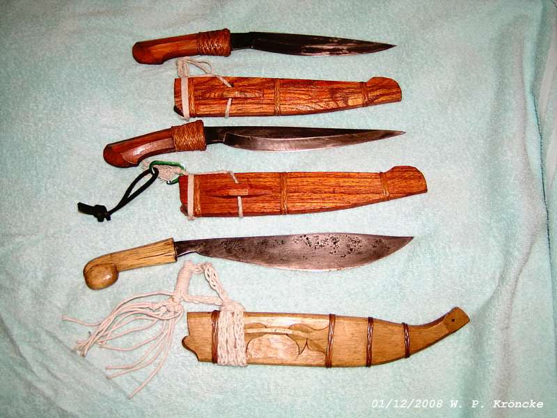

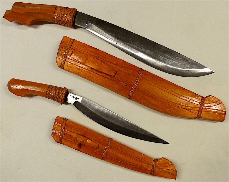

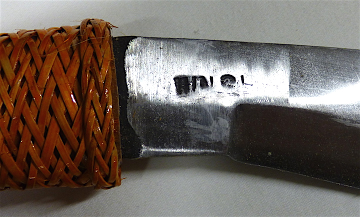

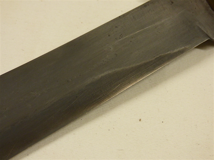

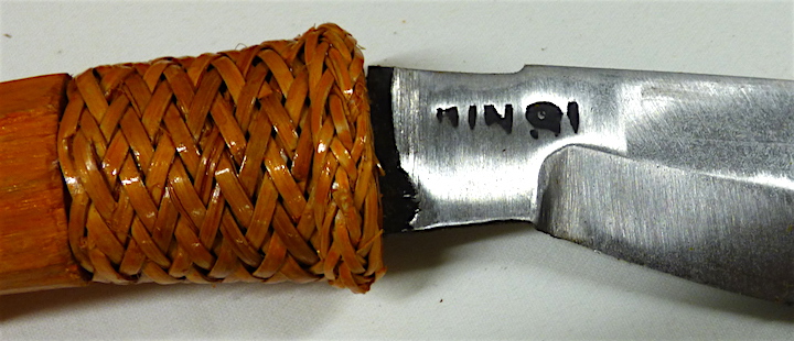

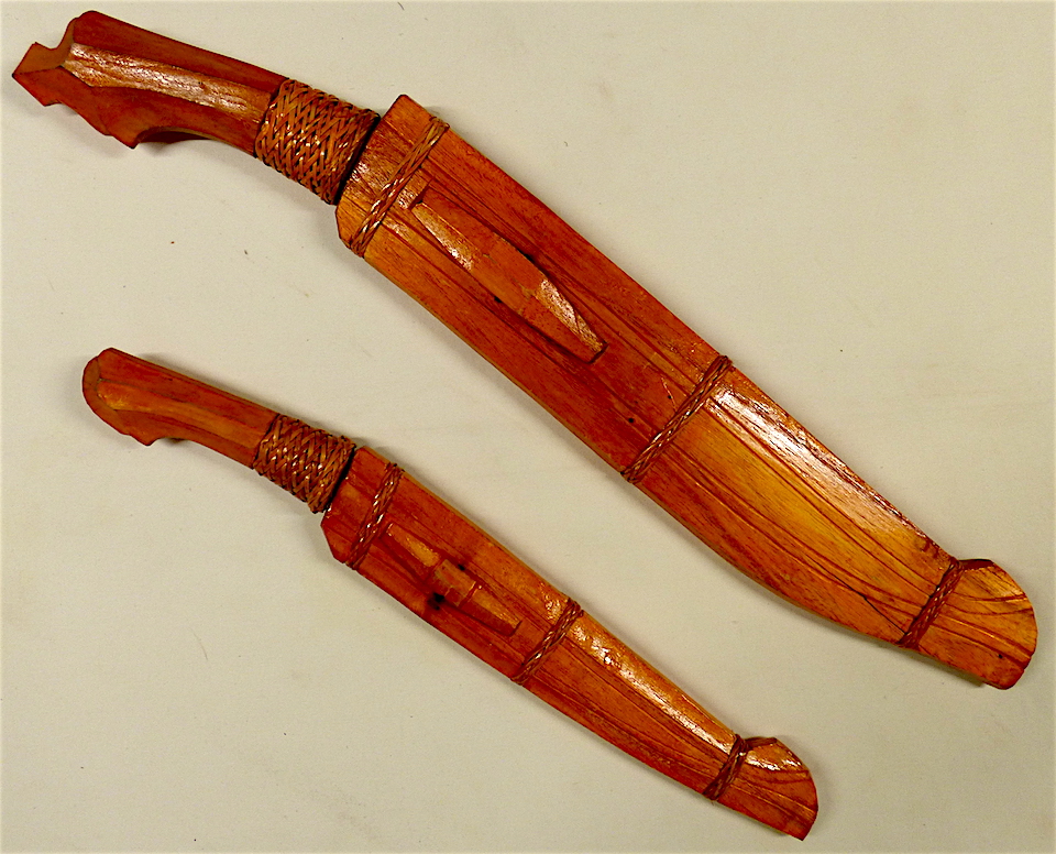

Just to add some context to current Filipino knives, here are two that I believe are from Mindoro and were made recently. They are almost identical in style and have the same mark ("MIN81") stamped at the base of the blade. It appears they were made at the same time by the same person.
These are high quality blades, both well sharpened with a single bevel to the edge (in the manner of most Visayan knives). The handles are good and tight to the blind tang. Good working knives, practical and inexpensive, that would serve as a weapon if necessary.
Ian.

I have a pair of those too, garabs, nice working knives, right-handed chisel edge (single bevel). Also, have a similarly edged, scabbarded and gripped ginunting and a pinute sword. I gather they are HC tool steel... All made by DaSilva.

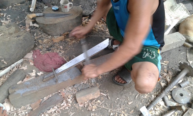

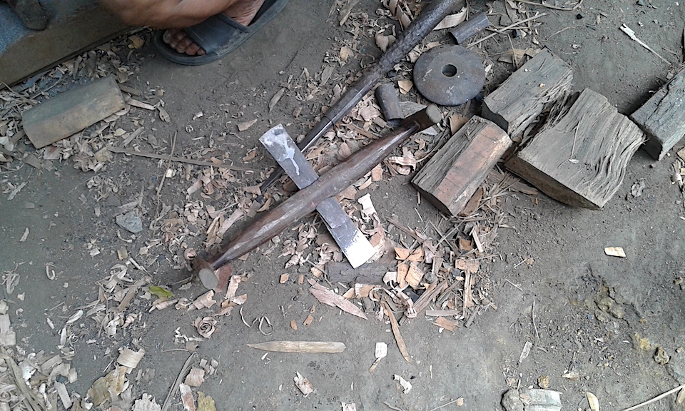

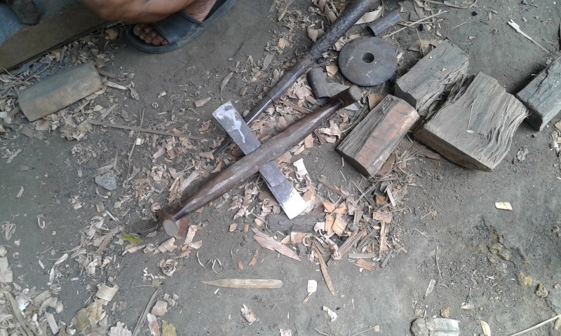

Thanks for the information. Some of this I did not know. Do you have a picture of a metal plane--I'd be interested to see one and get an idea of how it was used.
it is an example of a Visayans metal plane
if you want i can find videos of it being used
Ian.
hi, yep they look ok , but they are not native mindoro knives they are made by settlers. probably visayans form the lowlands.
but the general rule of thumb is the further from modern life you go in the phillipines the more likely youll find a good knife.
https://ibb.co/m3keKw https://ibb.co/deiS6b
Thanks ausjulius. Interesting looking tool. It appears to be used like a draw knife or shaver. I would appreciate a link to the video you mentioned.
Ian.
PS: I've attached the pic in your link for the Forum's files--these links tend to get broken and we lose good information in our archives unless the pics are uploaded to this site.

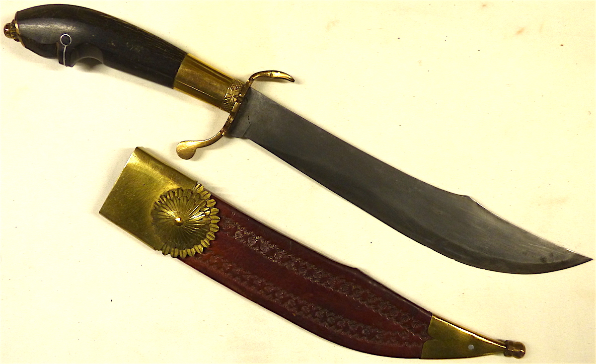

Old 29th December 2017, 06:48 AM   #26
Posts: 4,748
Here is a relatively recent (late 20th C.) Ilokano knife which is well made. The blade shows a clear hardened edge that I think reflects quenching rather than an inserted edge. The sheath is nicely tooled leather with brass fittings. Hilt is made from horn with metal inserts.
This example reflects ongoing skills in the manufacture of certain Luzon blades.
Ian.

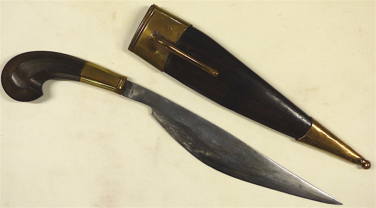

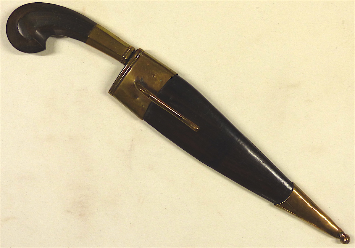

Old 29th December 2017, 07:39 PM   #27
Posts: 4,748
Another mid- to late- 20th C. piece. This is a Visayan plamingko from Panay. Again, an excellent blade with a hardened edge (I've not etched it but the hardened edge is apparent in the hand, although not seen in the picture). Good quality hilt and scabbard as well. Nothing fancy, just a well made and very functional knife--just as effective as a gunong.
Ian.
