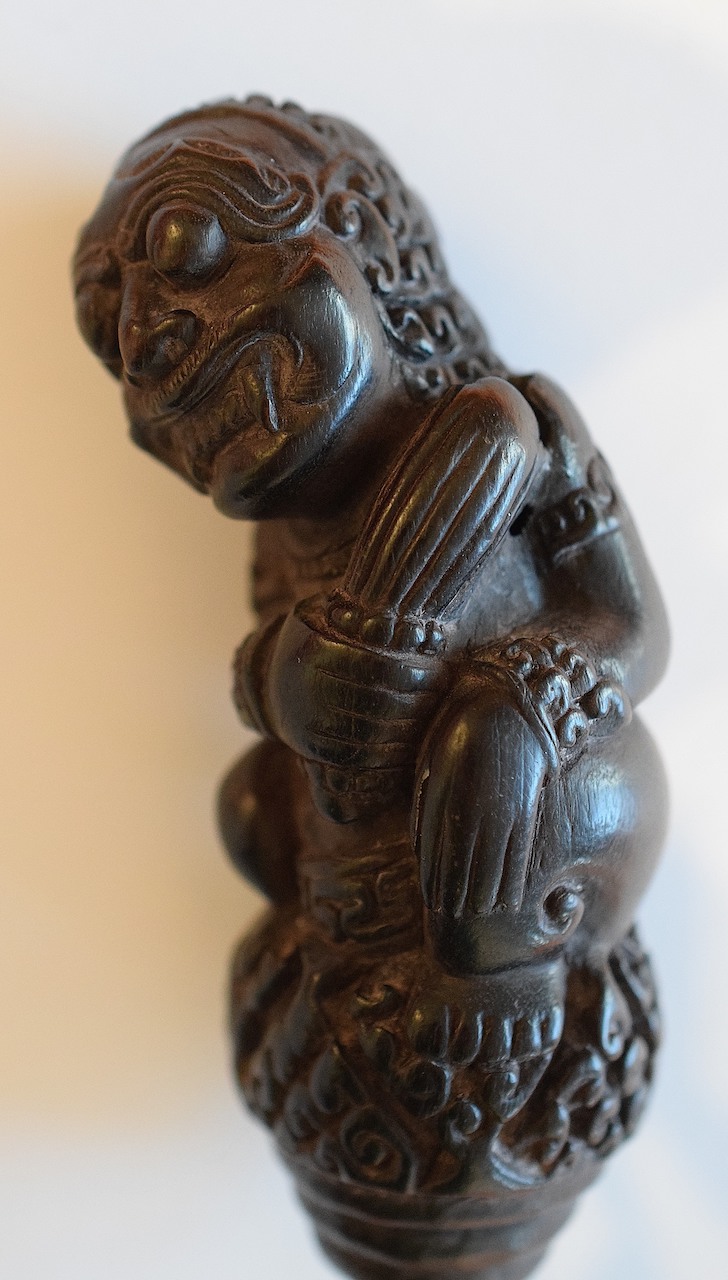

Here is the grip of my new Kriss.
The sheath is very much worn (it is broken and half of the wrangka is missing) but it looks like Cirebon's style.
I think the handle comes from the north of Java but I'm not sure because I've never seen a similar one.
What do you think?

Yes, it looks a rare and old specimen of raksasa hilt from Northern Java, congratulations!

Hi Jean. I'm wondering what about this hilt makes you specifically identify it as a raksasa?
Definitely a lovely, old and unusual hilt. I would agree that it looks Northern Jawa. And i just love the face on this guy!
Hi David,
I used the generic term raksasa to mean a forest demon covered with vegetation, this hilt is similar to the buta bajang style (squatting ancestor with bulged eyes) but with a different face, hairdress, and decoration which makes it peculiar. It is also different from the raksasa style hilts with crossed arms (see pic).

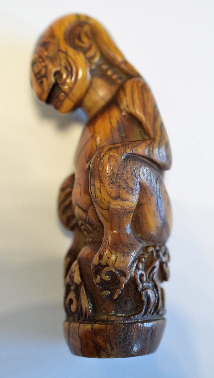

another Cirebon hilt

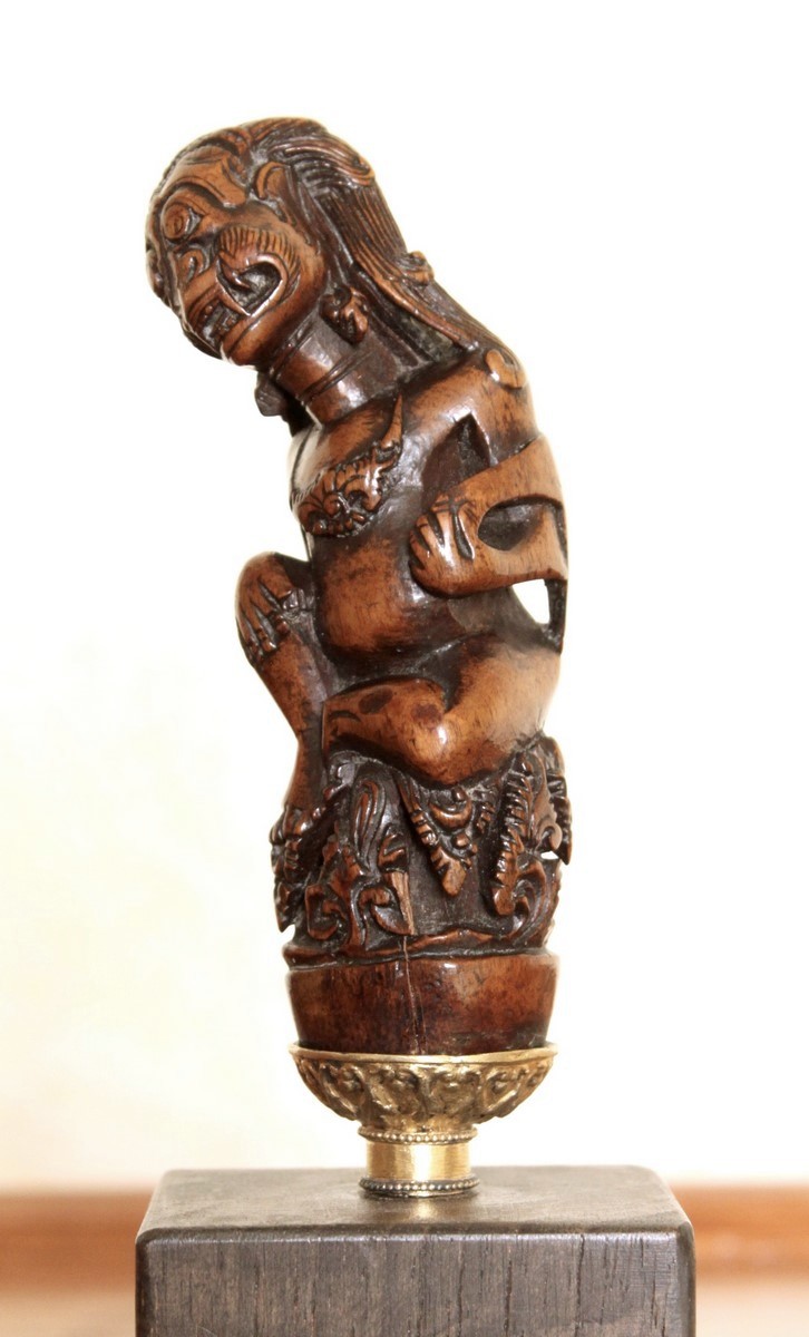

Location: Italy
Posts: 928
another Cirebon

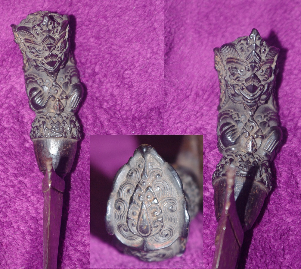

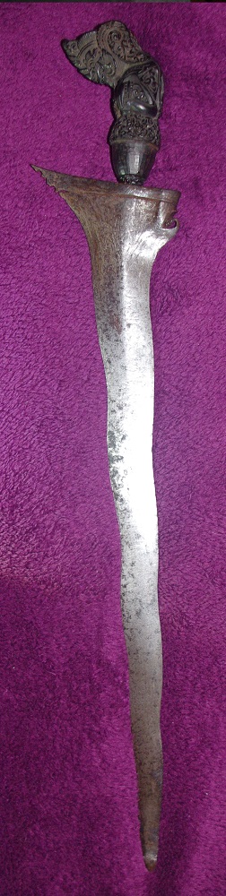

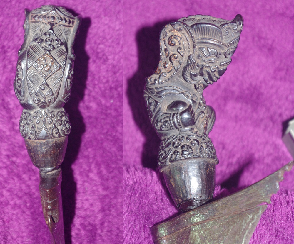

I attach the pic of an old raksasa hilt (holding a human arm in his left hand).

Hello Marco,
Very nice hilt, especially the piece from #7! This one appears to be considerably older than the other examples in this thread - maybe you could add close-ups from the other sides here or in a separate thread, please?
What makes you narrow down their origin to Cirebon? (Vs. Banten or any other other cultural centers in the sphere of Sunda influence? Or other busy trading ports along the coast of northern Java, that is?)
And, yes, I'm still hoping on Christmas for finally reading your book...

Originally Posted by kai
Hello Marco,
Hello Kai.The hilt was on the pesi of an an old blade with a Cirebon sheath and the Yogya seller had only very old keris all from Cirebon area.

A couple of observations about the original hilt:
The little finger of the right hand seems disproportionately long with a wicked looking hooked nail.
What could be the semi spherical object be that is cradled in the right arm; the head of a child?
For me it's his knee.

Hello Rick and David,
That's definitely his knee: The traditional position of the right hand is the shin close to the knee (sometimes it pretty much covers the knee, too); the lower leg is visible (with only the feet hidden among the foliage). [The left hands usually rests on top of the left knee though.]
The pinky of the right hand always shows an extension which should be the long finger nail (these tend to curl towards the tip when growing longer; in this carving it's more pronounced than usual). [On the left hand, the thumb usually shows what seems to be an extended finger nail...]
Those are definitely fangs if you compare them with less stylized examples; even in this more stylized representation the animal-like, flared lips are clearly visible around the fangs (indicated by the traditional "striped" area).

Hello Marco,
Was he of Cirebonese ancestry? It's rare to have such info on provenance available, indeed!
Still, these hilt types may not be limited to Cirebon since there are also a bunch of keris from old European collections that combine such hilts with scabbards attributed to other sultanates along the Javanese North coast.

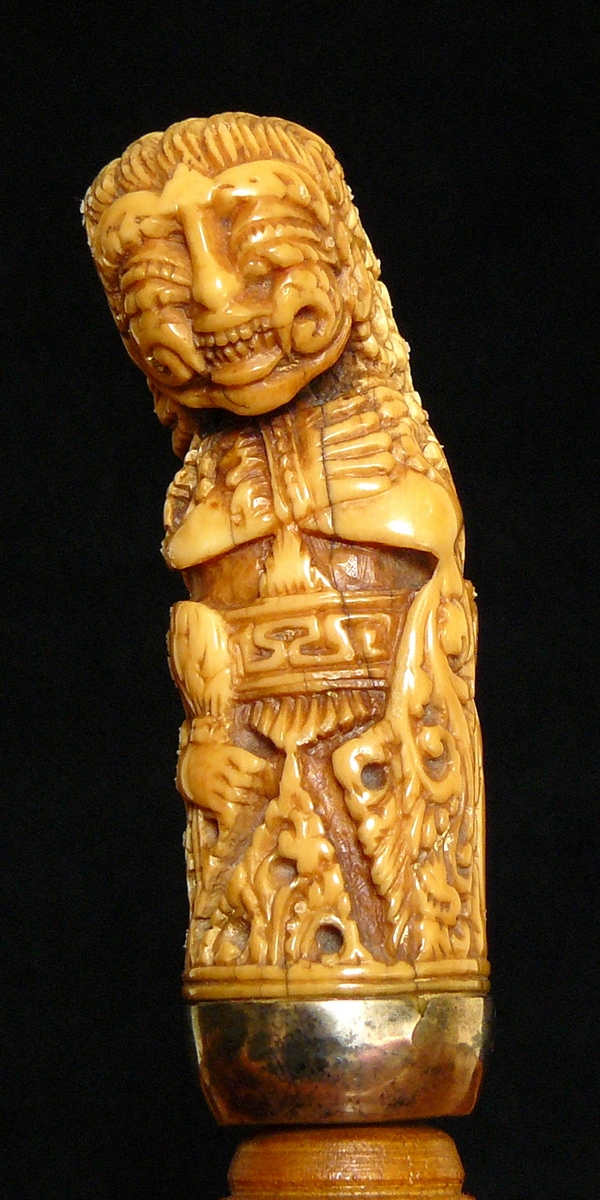

Old 28th November 2017, 02:40 AM   #23
Posts: 7,303
....I simply do not know enough to permit me to identify any more than this, nor to hazard guesses at things I do not understand.
Thanks you Alan. Please note that i never asked you to identify this figure. All i have done is question if the figure should rightfully be called a raksasa. Everything you have just written seems to me to support the validity of my questioning.
Old 28th November 2017, 03:06 AM   #24
Posts: 7,255
David, if we are to place a name on anything, anything at all, we engage in a process of identification.
I have indicated that I cannot identify the figure in question, and nobody else seems to be able to identify it either, but in general terms it does seem to fit the broad parameters of what many collectors would call a raksasa --- or whatever --- hilt.
Personally, I'm a bit hesitant in using the R word, I suppose if we're speaking Collectorise its OK to call everything that looks a bit demonic a raksasa, but for something like this hilt, I'd probably opt for "figural". If we don't really know what something is it is possibly more polite to retreat into our own language and use descriptive terms rather than inaccurate or garbled terms.
Old 28th November 2017, 03:50 AM   #25
Posts: 7,303
I believe we are in complete agreement here.

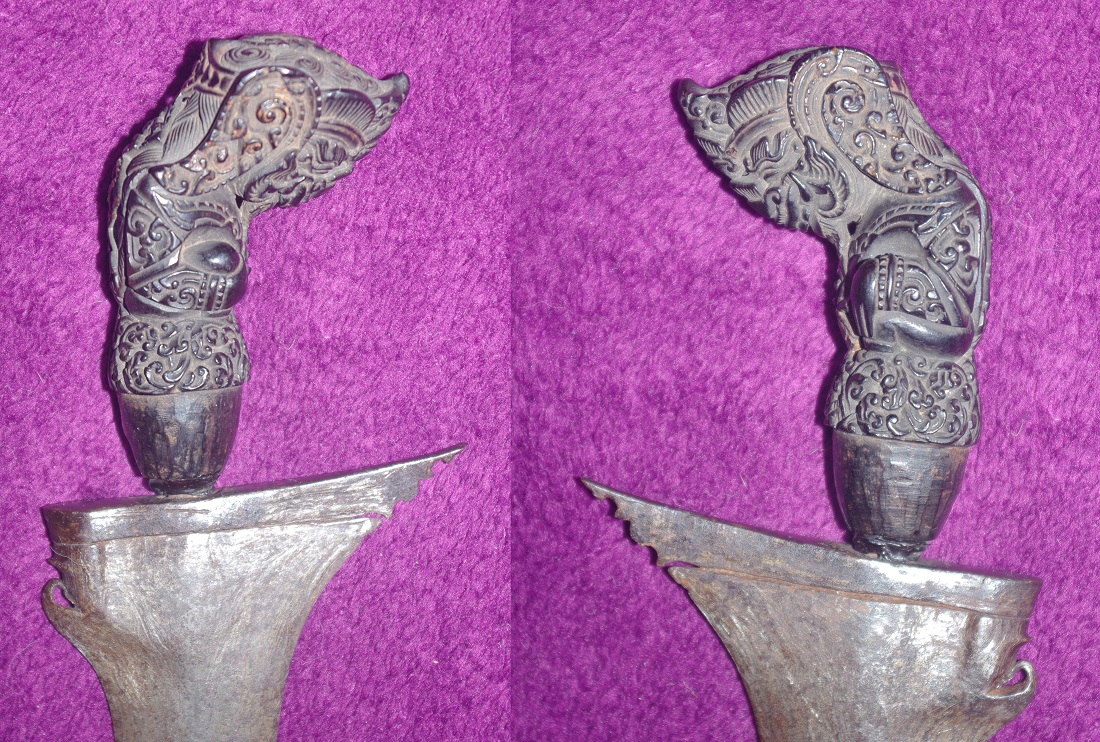

Old 28th November 2017, 09:19 AM   #26
Jean
Join Date: Jun 2009
Posts: 1,740
Just for reference I attach the pics of 3 old Javanese figural hilts with a less elaborate headdress and a standard curly hair style.
Old 28th November 2017, 09:41 AM   #27
Posts: 7,255
I think the people I know would probably give that style as minat jenggul Jean.
Old 28th November 2017, 01:15 PM   #28
Jean
Join Date: Jun 2009
Posts: 1,740
Thank you Alan, I never heard this name, what does it mean?

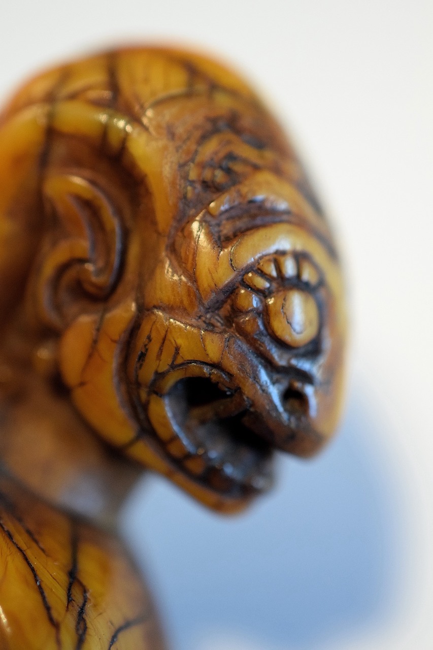

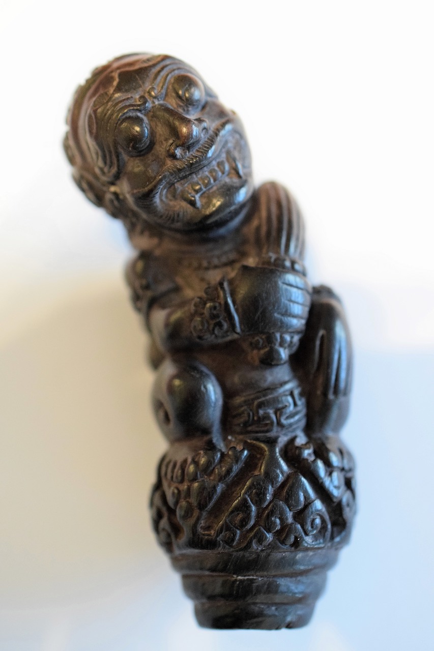

Old 28th November 2017, 05:45 PM   #29
Posts: 7,303
So why are these demons used as hilt figures? Are they all demons? Maybe they're guardians? Or maybe they really are demons and their purpose is keep the really bad guys away from the sacred Meru.Lots of room there for discussion.
This is indeed an interesting question and perhaps one we can only speculate about. At the risk of making a cross-cultural faux pas, as clearly the diffferences between Eastern and Western thought are vast, we might compare concepts of demonology in such renaissance era writings at the Key of Solomon and the Lesser Key of Solomon (which make claims, however spurious, of dating back to the biblical king himself). These books deal with sigils and signs used to call various demons and put them under human command to to the bidding of the conjurer. Yes, perhaps a dangerous and reckless endeavor. But perhaps the idea is somewhat similar, that these Javanese demons, raksasa and otherwise, can but controlled symbolically in these represented forms to protect and serve their human masters. Maybe an off-base idea, but an notion none the less.
Old 28th November 2017, 07:50 PM   #30
Posts: 7,255
Jean, Minat Jenggul is something you hear linked to the wayang. As a direct translation it can be understood as "appropriate/suitable/right/correct - leader/ top man/boss), but I am uncertain exactly how it is used in the wayang. I find wayang pretty boring, probably because I cannot follow the language real well, the dalangs mix up archaic language with modern Javanese at all levels or even BI and break off in the middle of stories to make jokes and comments about current affairs. For me, the whole thing gets very confusing.
