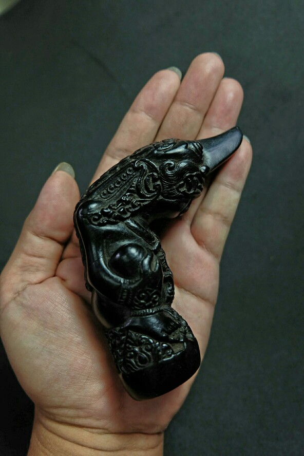

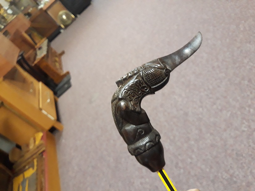

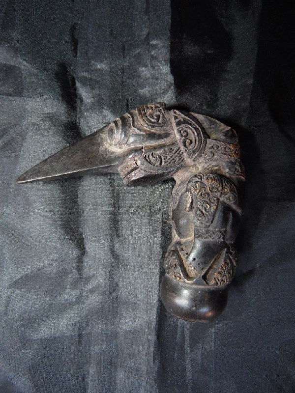

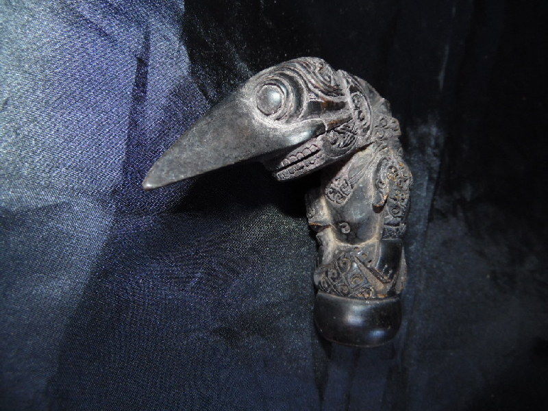

I have always been curious about the origin of the coteng form Thailand. Coould it be inspired by the Rajamala hilt form Cirebon Java? I enclose an old example of a Rajamala hilt which strongly resembles a Coteng.
alexish is offline   Reply With Quote
Old 10th September 2017, 08:23 PM   #2
Posts: 9,765
Hi Alexish,
very good possible and I think that this was discussed here before and I think that others like Kerner has noticed this resemblance before when I remember correct.

Originally Posted by Sajen
Hi Alexish,
Yes, this has been discussed here before. If i am not mistaken Shahrial did some comparisons on these hilt forms some time ago. I'll try to find that thread.

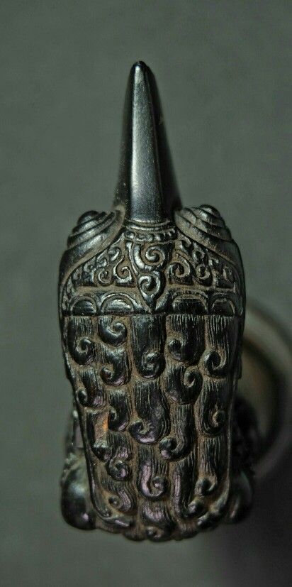

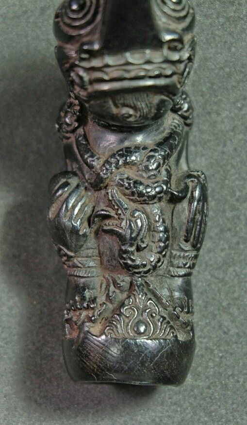

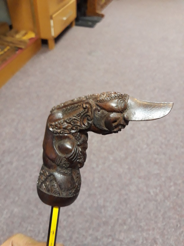

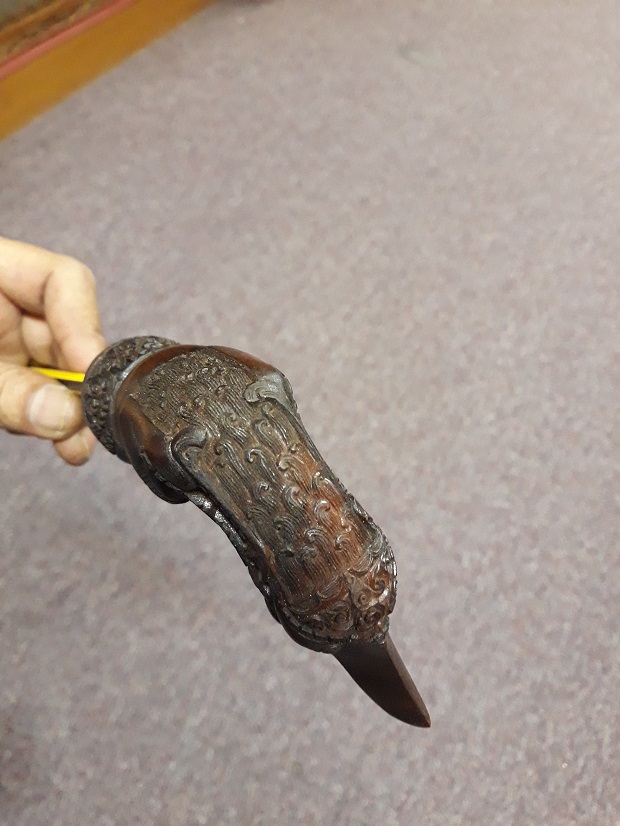

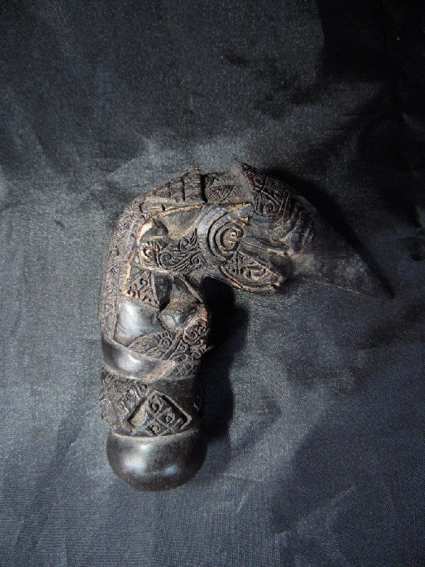

I hereby enclose another example of a Cirebon/Tegal Rajamala handle.
Sorry Alexish,
this isn't a Tegal Rayamala hilt, it look like Sumatran hilt with some Malay features to my eyes or a very unusual Coteng hilt.

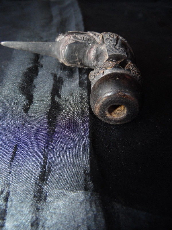

Here a hilt from my own collection.
Old 11th December 2017, 04:25 PM   #6
Posts: 7,289
To my eyes i would consider this a coteng hilt. Like Sajen, i also do not think it originates in Cirebon.
Old 11th December 2017, 10:38 PM   #7
Question
Sorry to disagree, this isn't any genuine coteng hilt; I also don't see any features that suggest a Sumatran origin.
This looks like rather poor, later craftsmanship to me. I'd guess at a maker from Java/Madura...
Kai, you may well be right, but you are not necessarily disagreeing with me. I should have been clearer. When i said i would identify this as a coteng hilt i was not considering whether or not it was an old original or a recent copy. I was referring more to the style of hilt. Frankly i don't know enough about coteng hilts to determine the age of this hilt or exact origin, but the elements of the hilt were clearly designed it appear as a coteng hilt might, especially around the mouth, eyes and nose. What i was most trying to debate was that i do not think this is an example of a Cirebon hilt as Alexish has suggested.
Old 11th December 2017, 11:39 PM   #9
Posts: 7,218
I know very little about cotengs, I know a little bit about North Jawa.
In my opinion this is not a hilt from Cirebon, nor from the Pesisir in general.
Workmanship looks fairly crude.
I feel that it has been carved from a light, rather soft wood and stained or lacquered, in which case we might be looking at something from the 1970's-1990's.
I have no idea at all where it might be from.
Old 12th December 2017, 06:55 PM   #10
Posts: 9,765
The same I can say about my comment, I only want to state that it isn't a hilt from Tegal. But have to agree about age and craftsmanship with Kai and Alan.

I agree with others but would consider South Sumatra (Lampung) as the most probable origin for the hilt shown by Alexish in post#4 or at least a possible one.

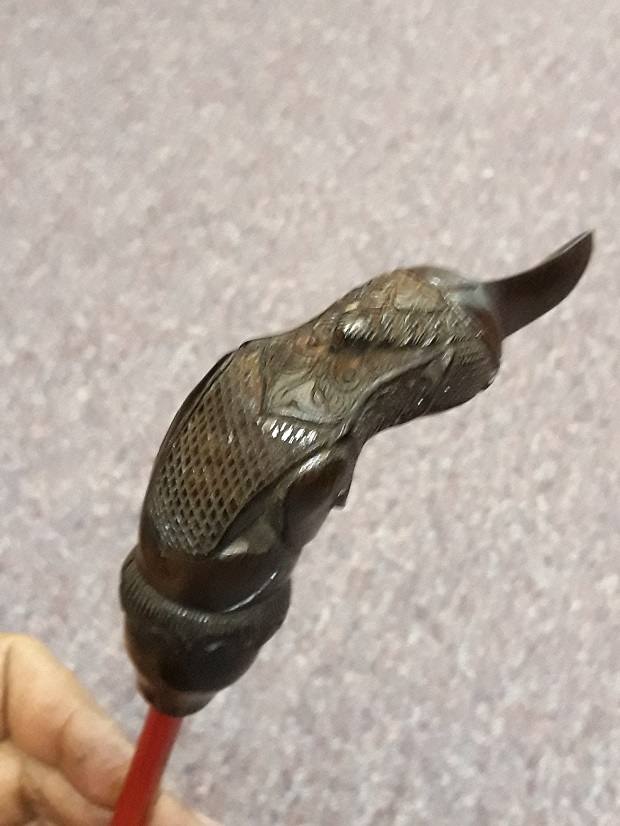

Dear Collectors,

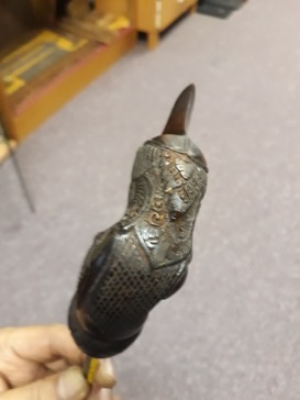

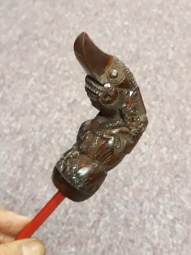

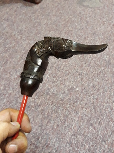

Here is a brand new Rajamala hilt carved in Madura, based on the design in the first post.

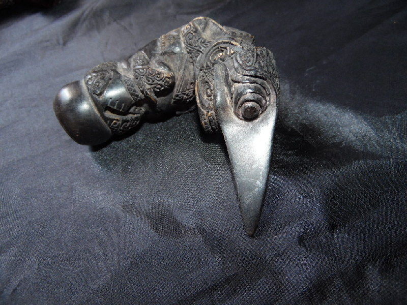

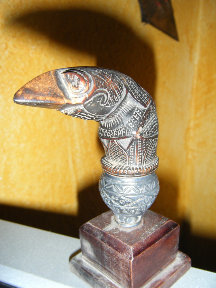

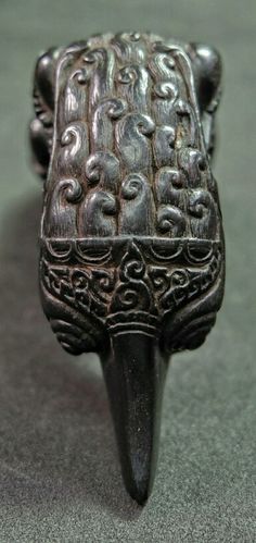

Here is also a newly-carved Sumatran (Palembang) version of either a Rajamala or Coteng Hilt, which was also made in Madura. This is based on a figural hilt in a previous post:
http://www.vikingsword.com/vb/showth...t=figural+bird
To be brutally honest...
me·di·o·cre
ˌmēdēˈōkər/Submit
adjective
of only moderate quality; not very good.
"a mediocre actor"
synonyms: ordinary, average, middling, middle-of-the-road, uninspired, undistinguished, indifferent, unexceptional, unexciting, unremarkable, run-of-the-mill, pedestrian, prosaic, lackluster, forgettable, amateur, amateurish.
