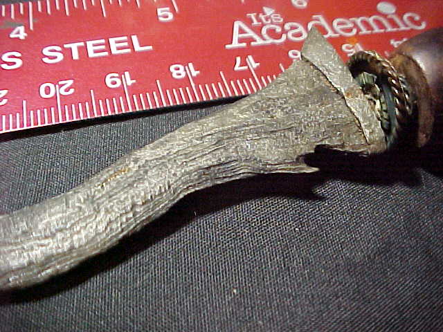

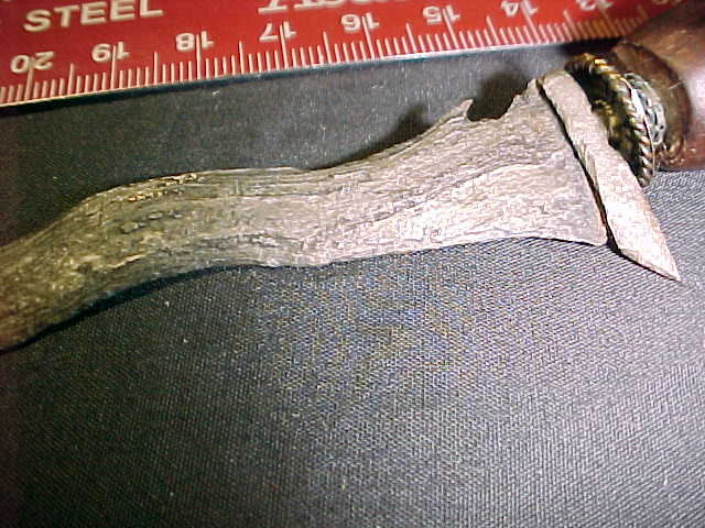

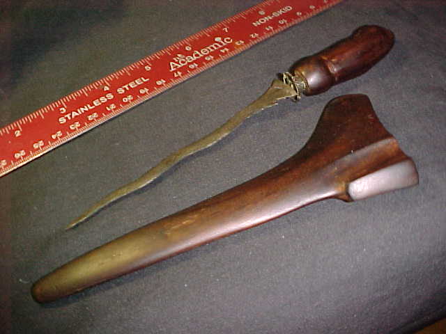

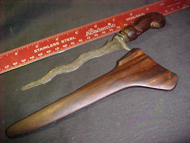

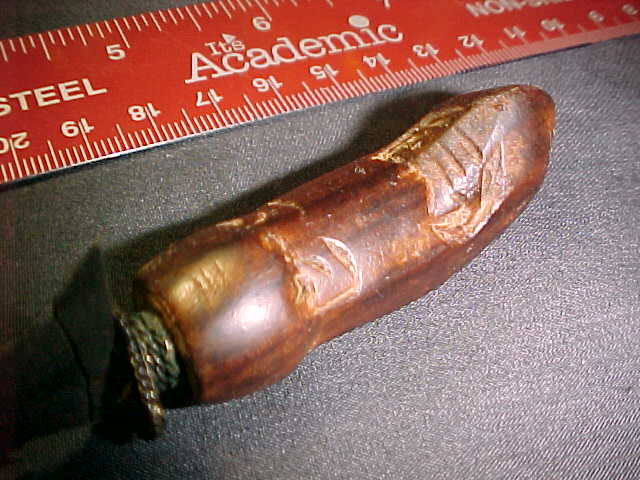

here's some pics, i put some polish on it and it darkened it.

Well, this is dressed, at least, as a Javanese keris. Keris selit are, AFAIK, a Malay thing. And generally speaking they tend to be of a somewhat higher quality than this piece.
I think this might more correctly be considered a keris patrem. Could have been intended either for a woman or a child i suppose.

Terry, i might also point out that the mendak, that bit of jewelry between the hilt and blade, is on backwards. The hilt is also facing 180 degrees in the opposite direction. This will all look a bit better if you remove the hilt, flip the mendak over and replace the hilt facing in the opposite direction.

sorry again, not very well made! How long is it? Maybe a patrem or jimat keris, maybe forged from an old blade? David is correct, a keris selit is a Malay dress keris.

Detlef, there is a ruler in some of the photos so it looks like it might be about 6 inches long for the blade. I will say that generally patrems are not usually works of high keris art. Could be jimat as well i suppose.

Gentleman, thank you for your expertise. I have always liked this weapon form but never held on to any. I have fixed the handle as suggested and does look more correct. I am a novice in indigenous people's weapons and appreciate your patience. The piece looked much better before I put wood gold on it. Blade is approximately 4 3/4 inches long. I thought the blade was very nice for how small it is.

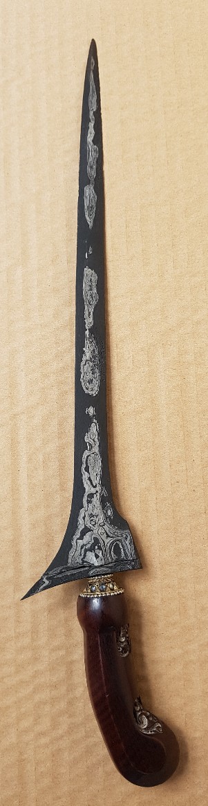

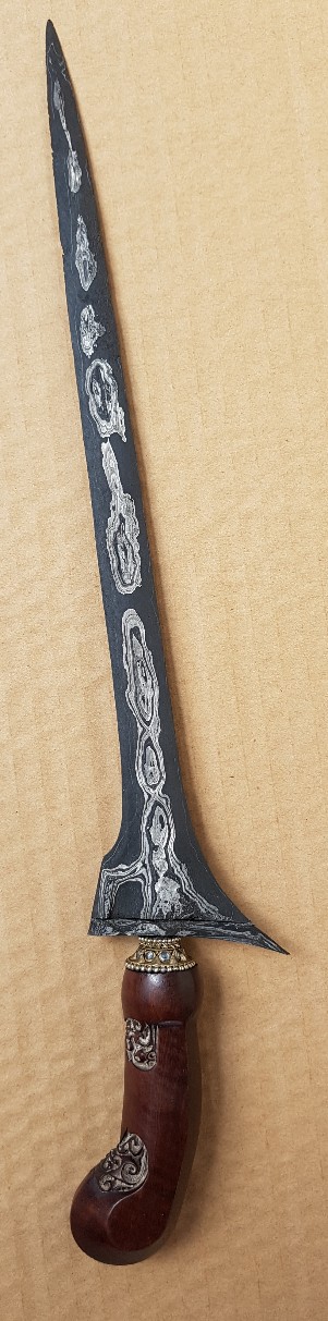

From what I know keris for woman or a child is called patrem. Do you have any idea how to determine whether a patrem keris is made for a woman or a child?
Attached is my patrem keris. It is 29 cm long.
Thank you,
Joe

If the blade alone is 29 cm long, it is not really a patrem but a short kris IMO. Patrem kris blades are usually about 20 cm long.

I would agree with this, unless your 29 cm measurement is for the entire keris including the hilt.
Bejo, i don't know of any particular way to determine if an actual patrem was made for a woman or a child.
Thank you for your opinions,
29 cm is from gonjo to the top of wilah.
Any idea how do we call a keris that has smaller size than it's usual tangguh?
Let us say, a Majapahit keris with size 29 cm is quite normal. But, for a Mataram keris 29 cm is quite uncommon. (From my experience, the normal size will be about 34-37cm).
I have tried to compare this keris with other Mataram keris. Although they maybe are from two different Mataram tangguh(In my opinion the small one was younger than the other). The small keris has smaller size of gandik (pejetan and tikel alis) than the normal one. You can check the attached picture below. The normal one has 36,5 cm size.
Thank you,
Joe

Michel, i don't necessarily disagree with everything you say here, but i am fairly certain that there are indeed many instances of patrem being made specifically for women. AFAIK, they were generally woman of some status, not the common folk and again, AFAIK, this is specific to Jawa and Madura (possibly parts of Sumatra as well). I personally own patrem that can indeed be traced to their original female owners. These should not be confused with the keris used in dance performance which general seem to be of a normal size (at least the ones i've seen). But it is just impossible to speak about the customs of keris cultures in any general manner because what was/is done in Jawa, for instance, is not necessarily so in Sulawesi or the Peninsula or elsewhere. However, i believe you can find many smaller keris throughout Indonesia that do indeed serve the purpose of grown men, not boys or women (frankly i have always been a little skeptical about keris for children as i would think that as you mention, a keris would not come to a young man until he was of a certain age and fully capable of owning a full sized keris. Keris are not, after all, children's toys).
In many parts of Indonesia the size of the keris reflects upon the man and owning a petite keris would not necessarily reflect favorably upon that person. I have also seen different measuring methods that are used to make sure that a keris is made to the "correct" size for an individual, sometimes based upon the size of certain body parts such as the thumb. Usually those methods would not produce a patrem sized blade except, perhaps, in the case of an extremely small individual.
Of course, on the Peninsula and, i believe, parts of Sumatra you have keris selit, which are usually small and a bit fancy. But i do not think that the keris selit is meant to be a person's only keris and is really more a secondary item of dress than your most important keris. Please correct me if i am wrong.
I am also aware that many dukun have been known to own smaller, usually rather crudely forged keris blades. Or, at least, many small, crudely forged blades have been presented as dukun keris on ePray regardless of the truth behind it. Certainly many collectors find the notion of owning a dukun blade attractive, so it is difficult fro me to discern between truth and hype in these cases.
There is also the case of talisman keris or jimat keris, though these are generally even smaller than the usual patrem.

Johan, the hilt of this keris is simply very low quality work, it approximates a Jogja tunggak semi hilt, it is not worn down, just not much good to begin with.
Yes, the blade does appear to be old, yes, it might have lost some length due to age, but what we have in front of us is as it is now. It was never of much quality even when new, and and the dress it has been put into doesn't do it any favours.
I don't really care about what name anybody wants to put on it, call it a patrem if you will, call it a cunderik, call it a curigo, when all is said and done, it is a keris. Put it in a $2000 Solo ladrang and call it a wangkingan, its still a keris.
Frankly, if it was mine I'd re-dress it in some halfway respectable sandang walikat, so that in the future, whoever gets it next might feel inclined to hang on to it, rather than use for a packing piece, or recycle it as washers.
The thing is this --- at least in my eyes it is --- this is a keris that at one time somebody put time and effort into making. It might well have been made in a village, and made to the order of somebody who could not afford the work of an empu or a pande keris, so he just went along to the local smith.
The bloke who ordered it was proud of what he had when he got it, the maker had done the best he could. Over time it deteriorated and nobody respected the effort nor the intent that had gone into its creation. It deserves another chance. Keris are living links to the past, and they were not all objects of art made for royalty, some were simple representations of what simple people believed were keris and what they could afford.
We need to respect those who have gone before us, and part of that respect is the preservation of cultural belief. There is far, far too much focus in the entire keris world on the beauty of major works of art. The keris is deeply embedded in the culture that gave it birth, understanding both the culture and the keris involves more than the superficial appreciation of art.
In very simple terms we cannot hope to understand the Javanese keris unless we can understand the way in which Javanese people who observe the ways handed down to them by their forebears, see the world. This humble little keris was once alive, and should be given the chance to live again.
